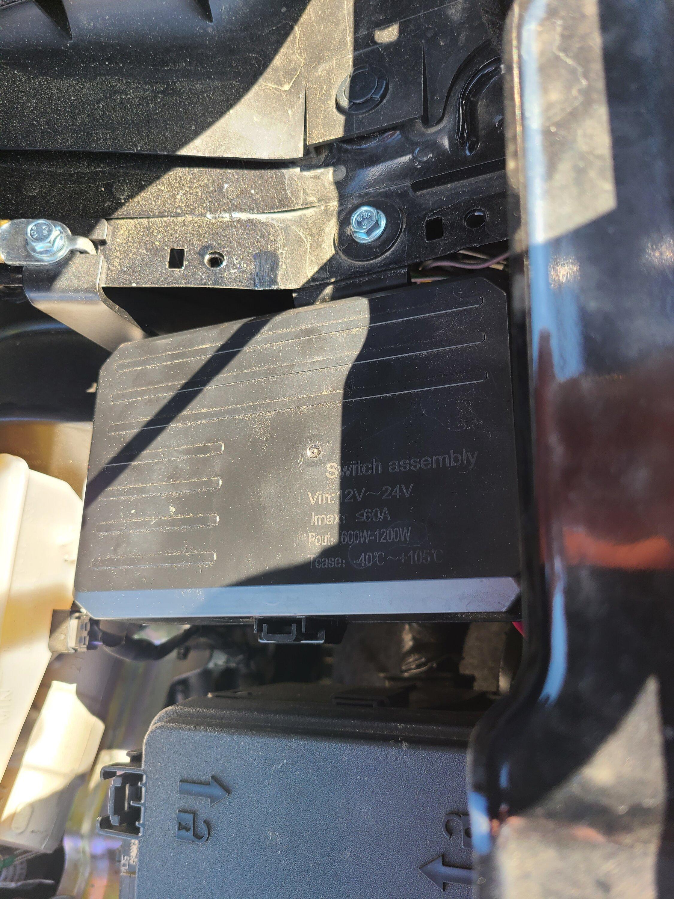

I was at the super celebration in Wisconsin and iag was selling basically what is below but it had its own mounting brackets that they sold with it. It was a little expensive but I bought out anyway. They said they would have more in 30 to 60 days
8 Gang Switch Panel Kit, Auto Power Plus Circuit Control Box Electronic Relay System Universal ON/Off Touch Switch Box with Harness and Label Stickers for Truck ATV UTV Boat Marine

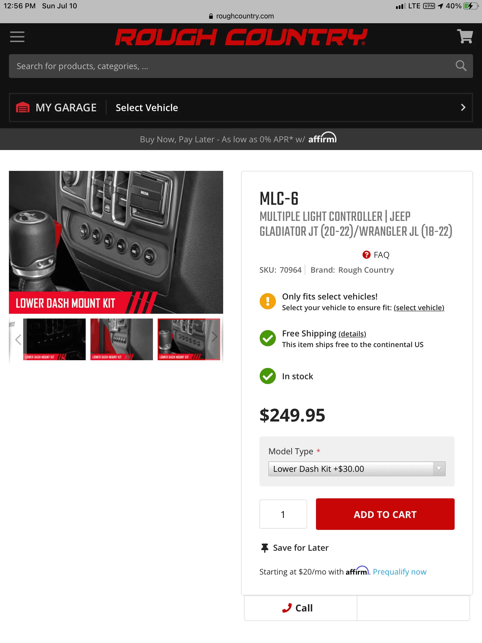

Thanks for the replies everyone! I texted Rough Country and they finally got back to me today. I was told they have an MLC-6 integrated kit coming out very soon for the broncos. Hopefully it looks as flush as the jeep one.

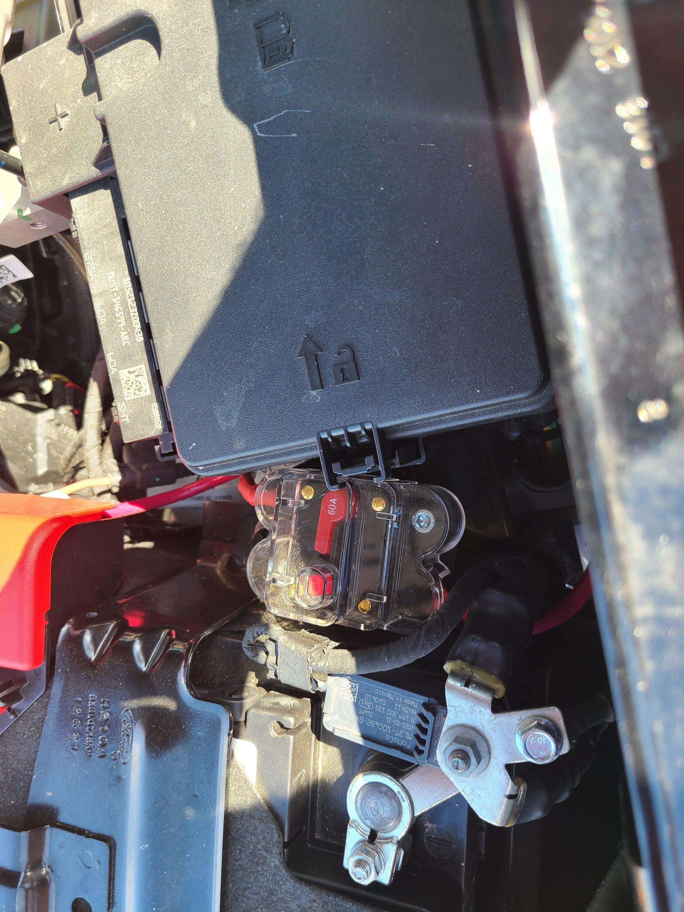

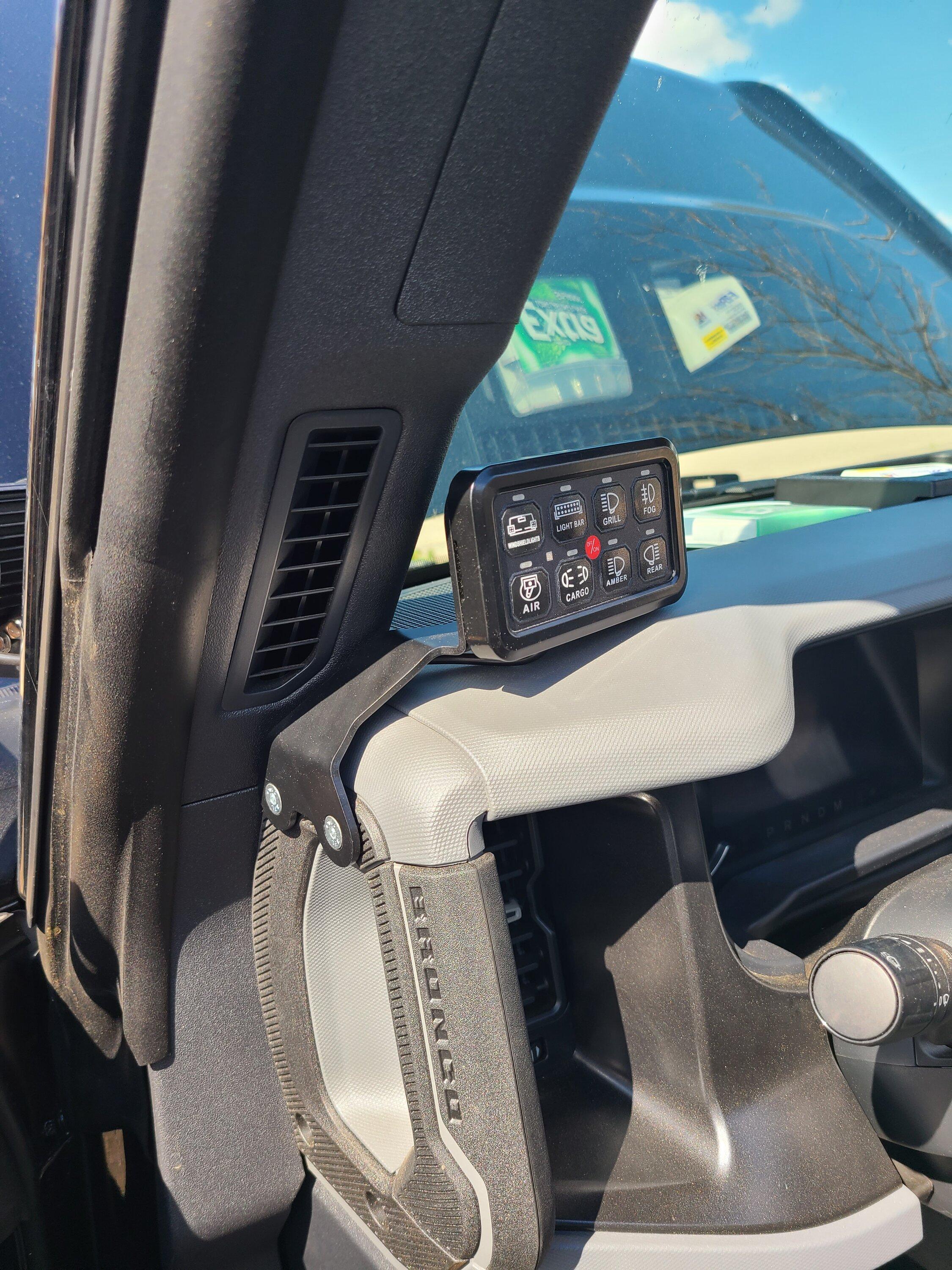

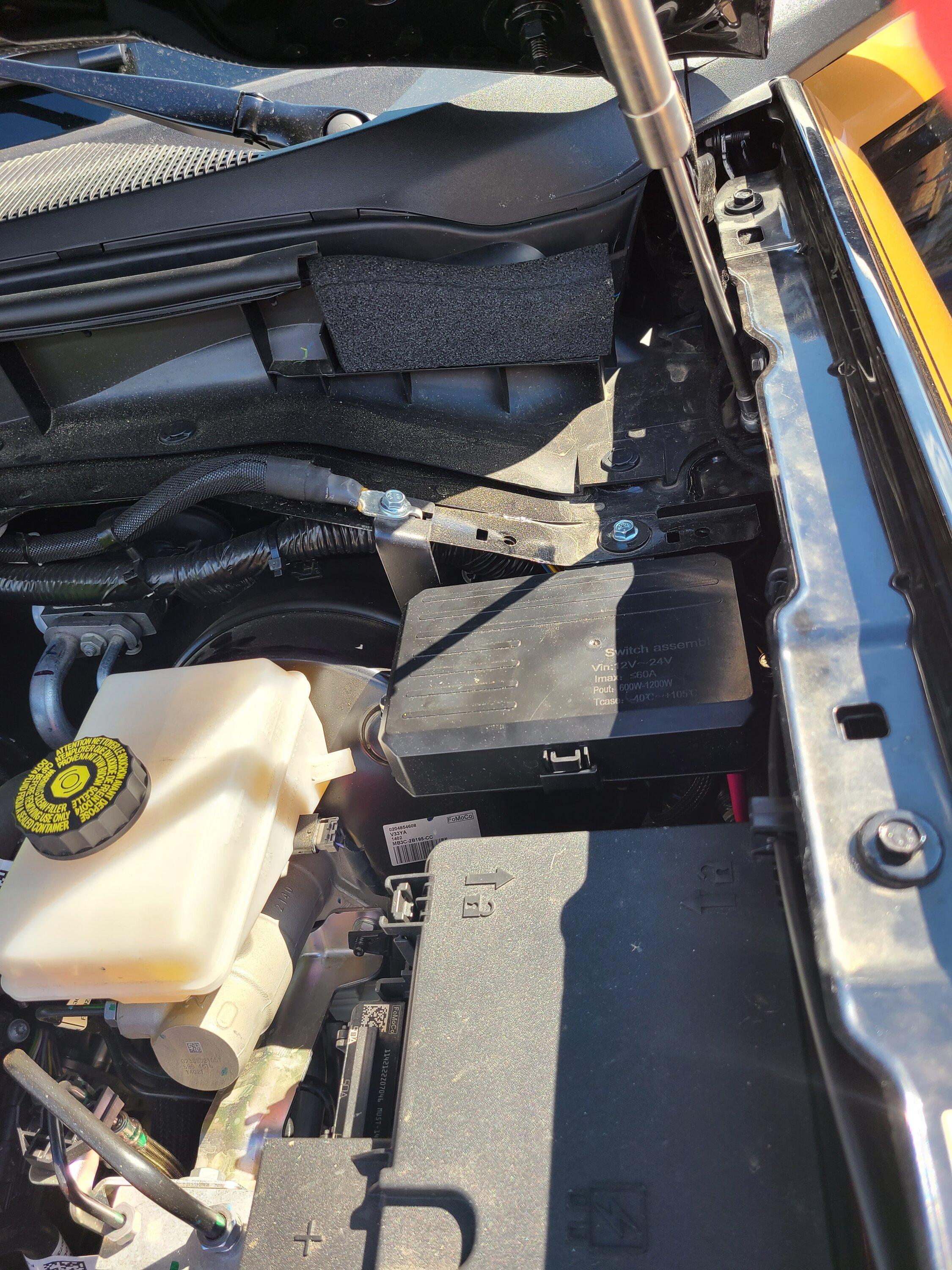

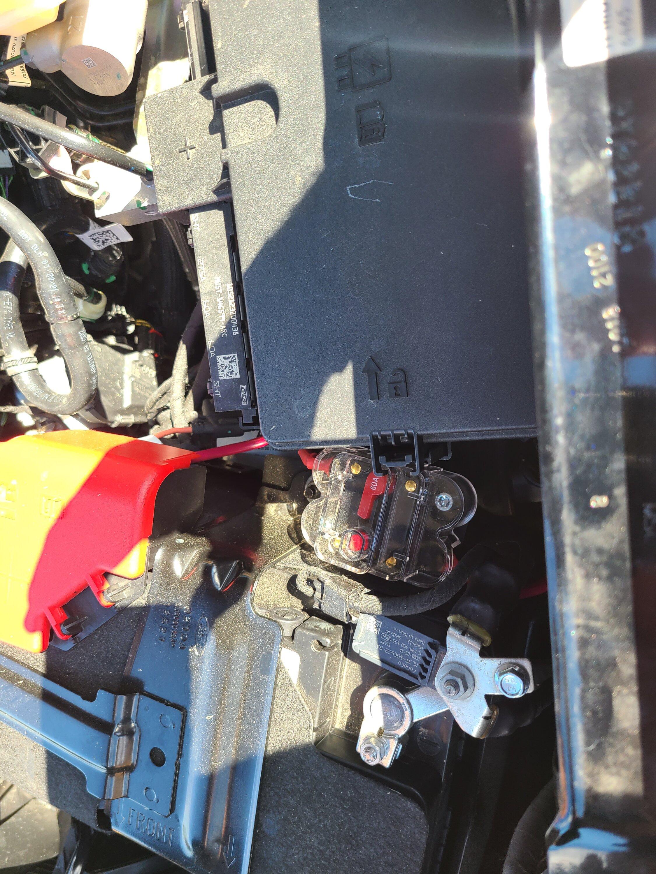

Ford Bronco Plug and Play AUX Controller? 20220709_160135
Thanks for posting these pics. I bought just the mounts from them and have been trying to figure out where they're intended!

No problem. Have you figured out how the wire runs from the unit into the engine compartment? I am waiting for them to send the full directions
xim
Rob
Jan 24, 2021
Wisconsin
'21 Bronco Big Bend

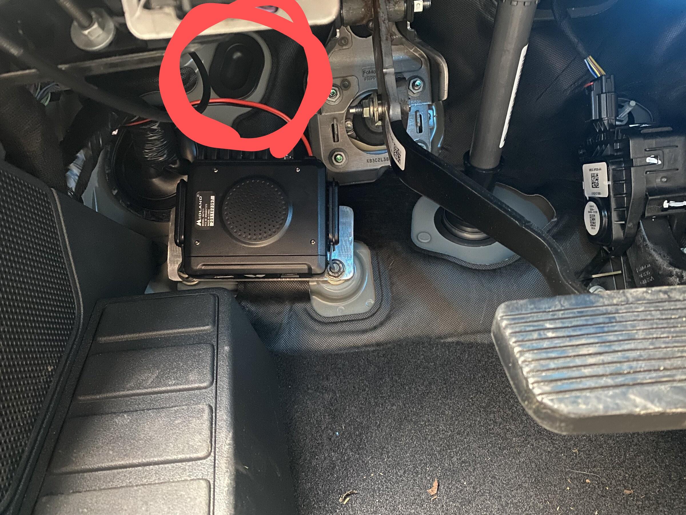

Yes, there's a grommet that comes under the driver's get under the dash. Pops right out, put a small hole in it and shove the wire through and put it back. Works slick one you see it
Edit: added picture
Edit: added picture
Thanks so much! I have been waiting like a month to try and figure this out. I really appreciate it.

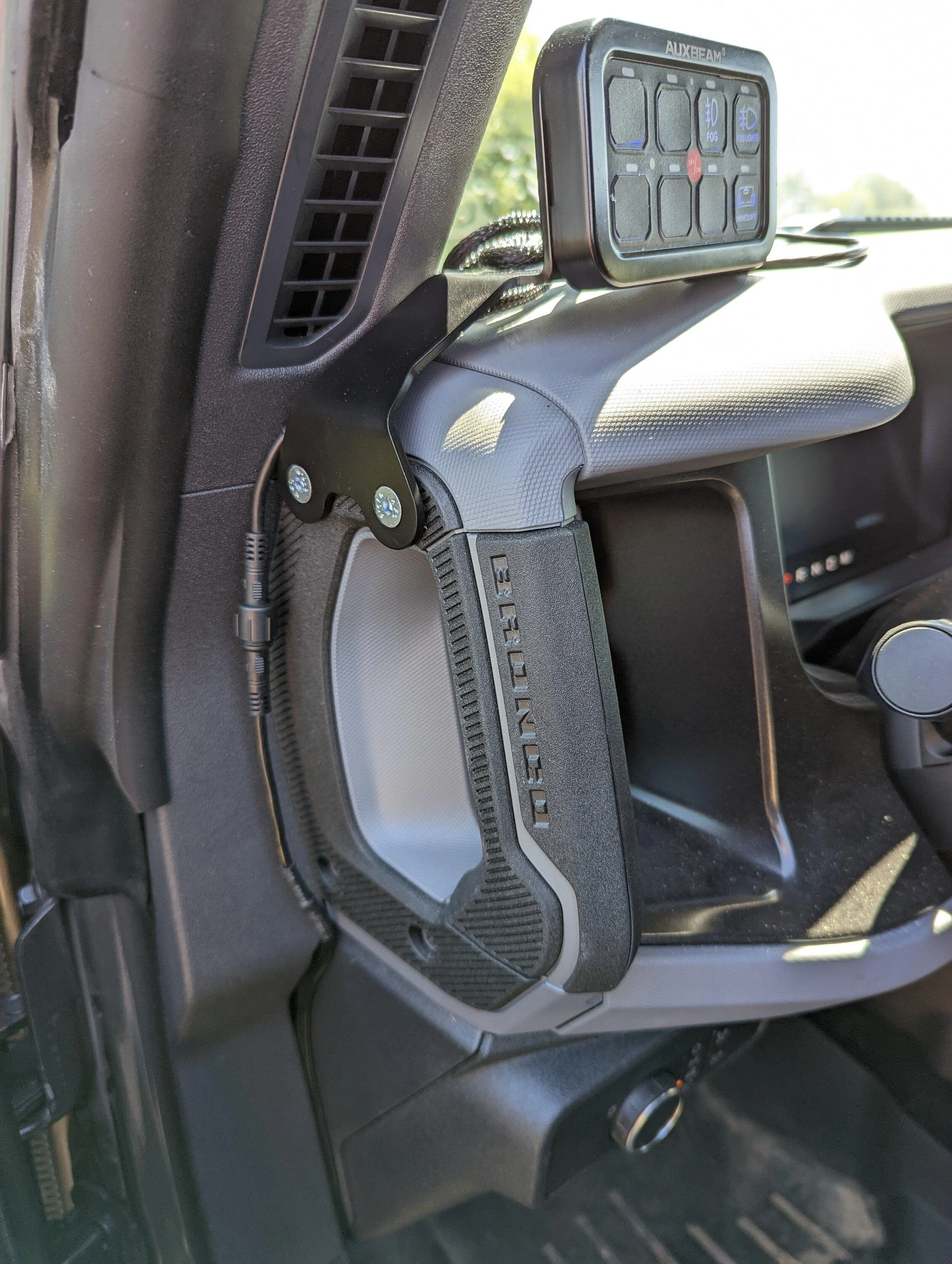

I actually just got an email from IAG that they will be sending the directions to me and that they are just finishing them up. I can share them when I get them if you need them. Also just a last question. Do you plan on running the cord behind the grab handle or does it run just down the side of the center console?
Thanks
xim
Rob
Jan 24, 2021
Wisconsin
'21 Bronco Big Bend
Thanks
I'll try to take a picture of it if I can get a good one. I just kinda tucked it in by the lower dash pieces, and ran it up along the handle for now. I had an extension cable for the auxbeam that I added as well, and that's coiled up behind it on the dash
Thanks...were the wires that came with the mount not long enough?
xim
Rob
Jan 24, 2021
Wisconsin
'21 Bronco Big Bend
I didn't have the mounts when I wired. So my under the hood things are in different places. I'm hoping to modify what I have to more like the mount intentions, might not need the extension then.
My wires along side of the dash
