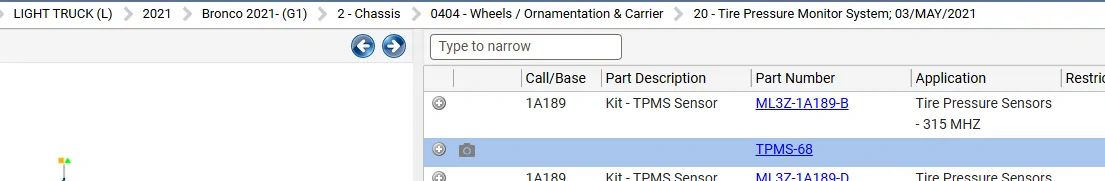

i`m going with wrong ones........
These are the oem ford ones. Maybe im wrong for doing this but i've always gotten Schrader sensors as i feel like they are a consistently good quality and never had an issue ever, while i have had issues with oems and also the chinesium ones.
what i was really asking about was the learning process for a new sensor on these vehicles. The sensors i got are the correct htz, claimed to be preprogrammed and we listed as a correct replacement for oem.
With that all being said, after all the drama of me trying to get these to work yesterday in the rain, this morning, as i was driving i hit 50mph and the sensors all started reading. They are now working. i didnt have to do anything else to them. Its weird but hey, if its stupid and it works, it aint stupid.
Thank you for the input though, i appreciate it.
