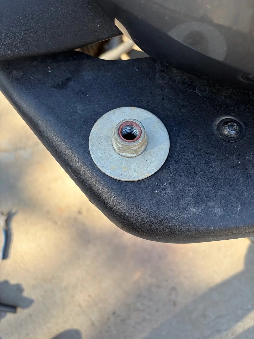

Right after I grabbed the socket for the first plate, I notice this guy just setting down in the front plate.
Ford Bronco PSA - check your torque marks IMG_0313
He’a just setting there. Nothing holding him in, no lip on the plate, he isn’t hung up on anything. Just chillin’

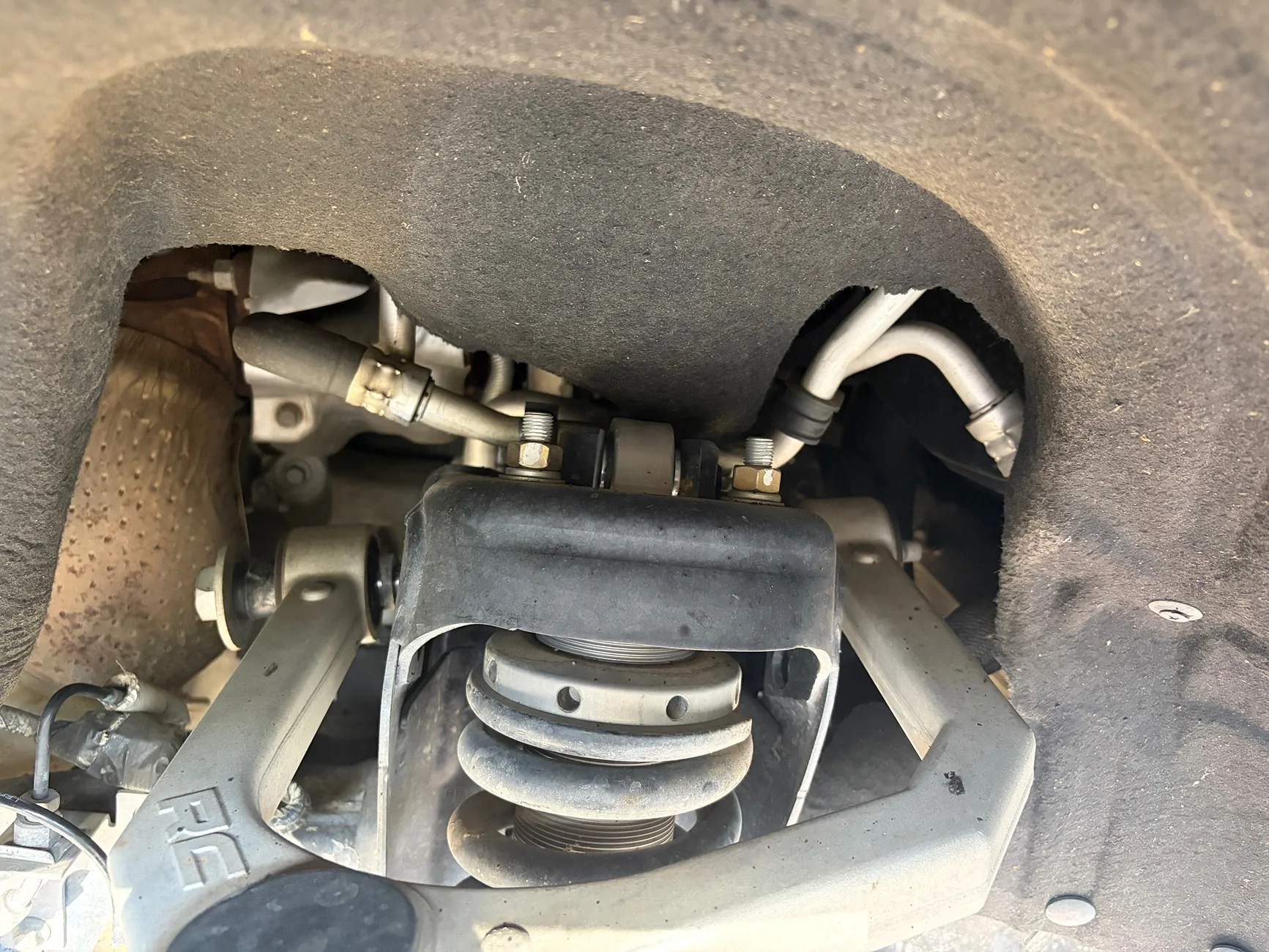

So… I wonder what it goes to. I start looking around. I don’t immediately recognize this bolt. But I had done the FDU earlier this winter… those all look good though. My sta-bar bolts are in my pocket (I had pulled them for the run and was gonna re-install them while I was under here). I start to pop the hood thinking it must be something in the engine bay, when I notice out of the corner of my eye:
Ford Bronco PSA - check your torque marks IMG_0314
I’ll be hornswaggled. I didn’t install these UCAs, and I had never unistalled them, but after 86,000 miles I can’t really blame the installer any more — these did have torque marks and I just hadn’t been doing a good enough job of checking them.

Well, I needed new UCAs anyway, the bushing in this one is obviously shot (can see it in pieces by the head of the bolt there). It all snugged back up when I put the nut back on, but I will have to bump up my purchasing timeline some I reckon.

Dang…..very fortunate it stayed together. Could have been a bad deal😳 Glad you found it when you did!!

Wow you definitely got lucky! Those things seem to want to work loose.
I started getting a clunk every now and then when we were out in Moab, and finally figured out that my driver's front UCA was just barely loose. Can't believe you didn't have any noise. I kept snugging it up, but didn't quite have the exact right tools. I've since fixed that problem.
