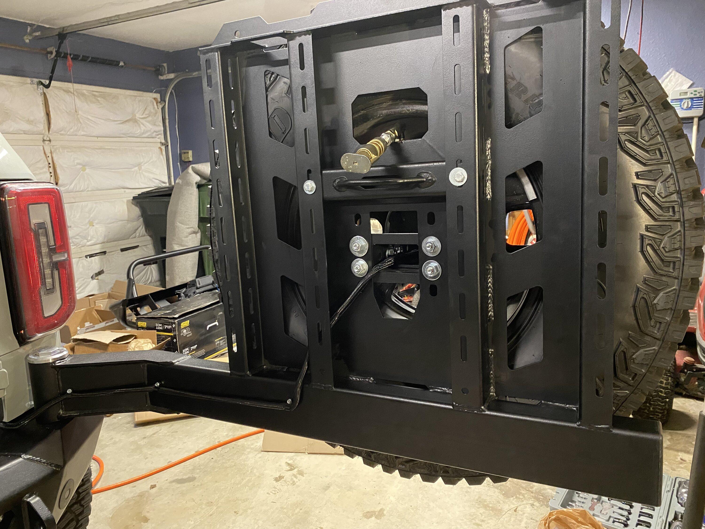

I ended up buying the LOD and installed over the last couple days. For a can mount, I was going to buy the multitool mount and then bolting up a lockable jerry can mount to it. I'm not a fan of the one LOD offers.
QQ, do you have the coax camera wire? How'd you run the wire and make the connection? The instructions aren't great on this part for the coax. Right now, I have it coiled up on the bumpstop and connected behind the swing out until I figure out the best route... I don't really want to go through the vent and was thinking I might be able to pull the wire grommet out and then remove the factory camera wire from the grommet, just drop it back inside the tailgate and then make the connection sitting inside (following the routing in their instructions).

Sorry just seen this…
I do not have the coax style. I did not use. (Let me know if you need it if it will help with your set up.)
I like the idea of going through the original grommet (like stock)

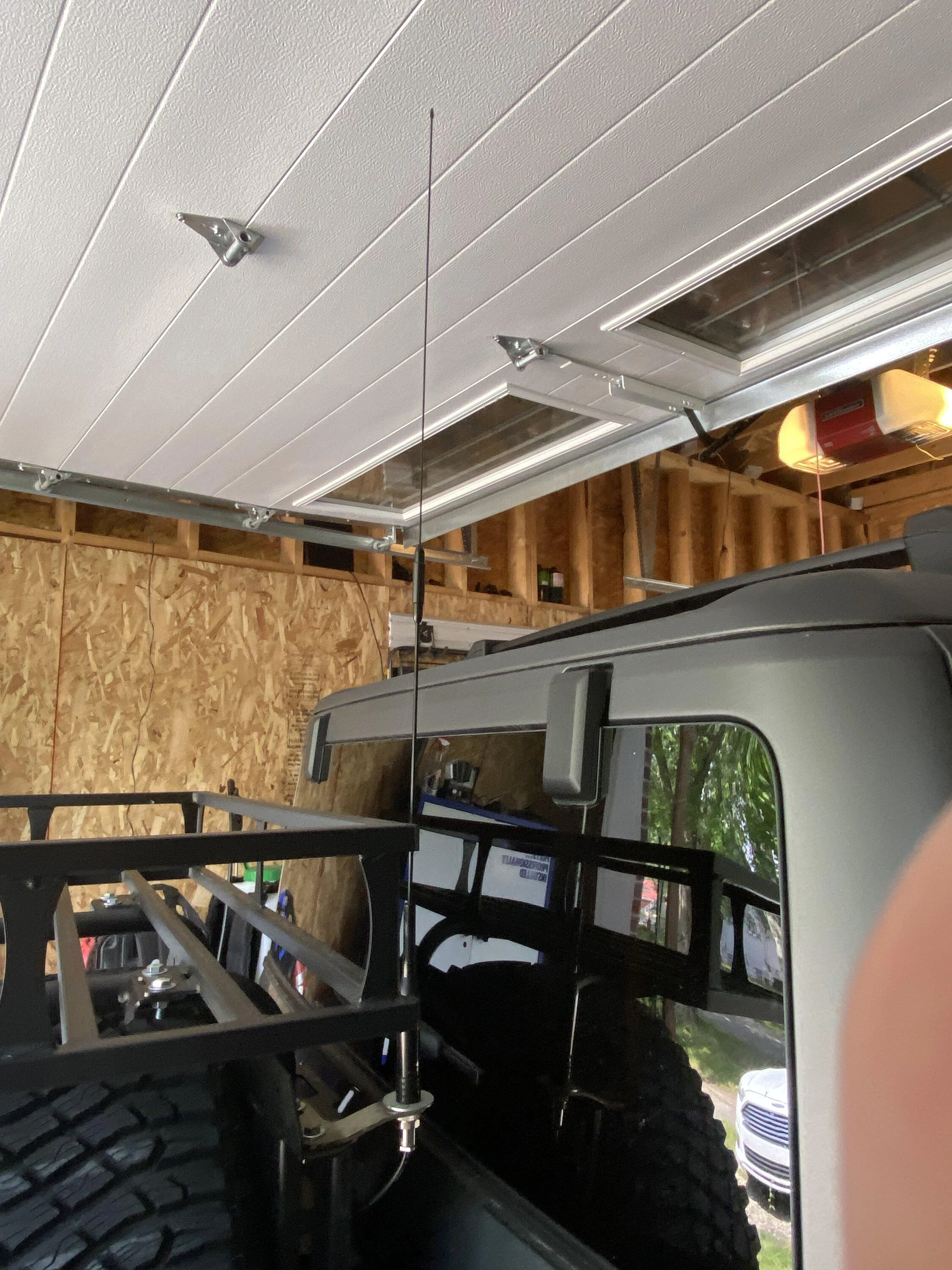

Although I did go through the vent,I ended up creating a bracket and drill a couple holes to mount GMRS antenna.(still have to paint)
I have not extended my camera wire yet. I did not want to cut the stock harness. Right now it is stock, so I can not swing the tire away from the tailgate.
Similar to you I have not figured out what I wanted to do. however I may end up creating my own extension using after market plugs.
please post a pic of what you end up doing with the jerry can

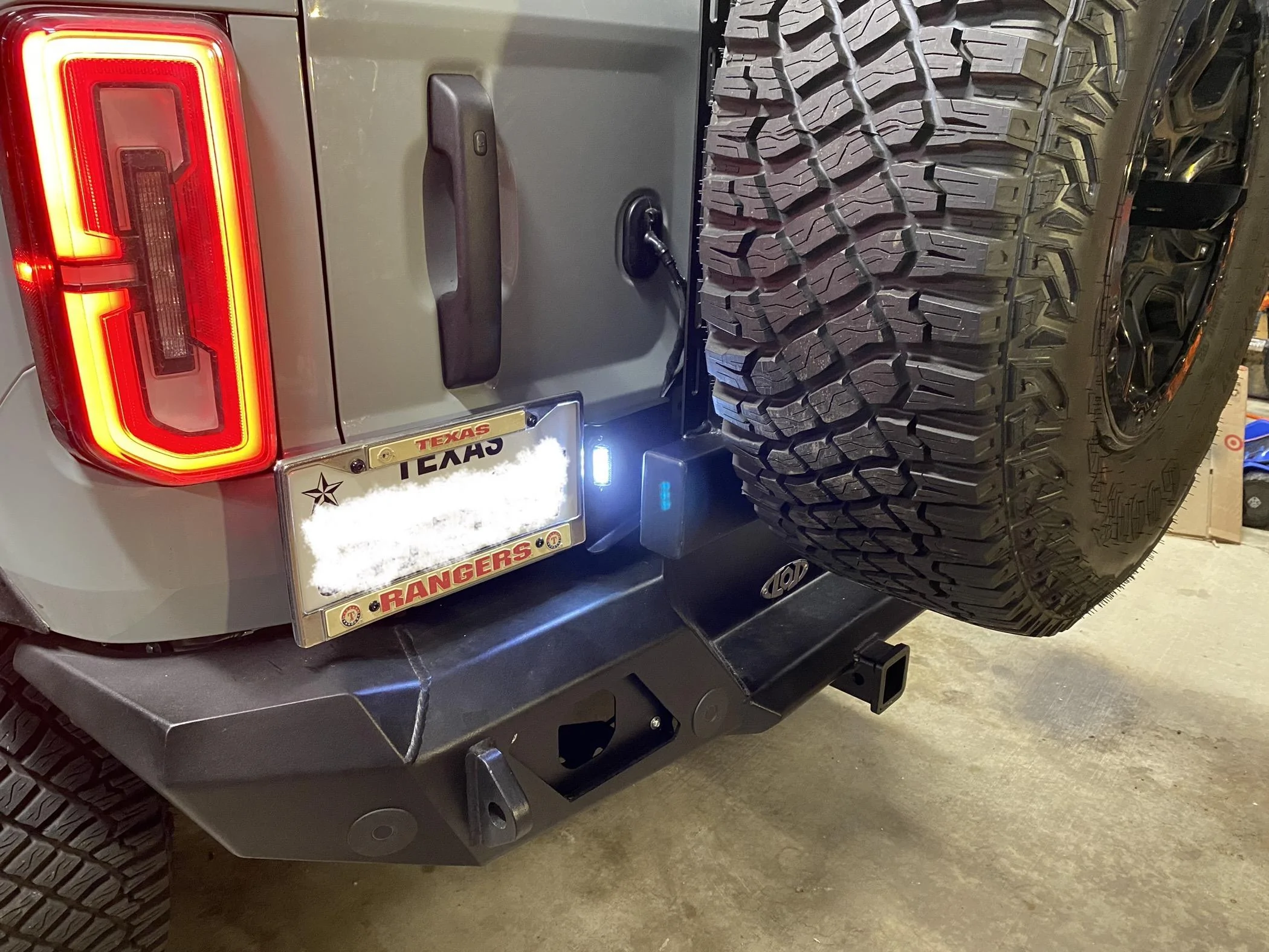

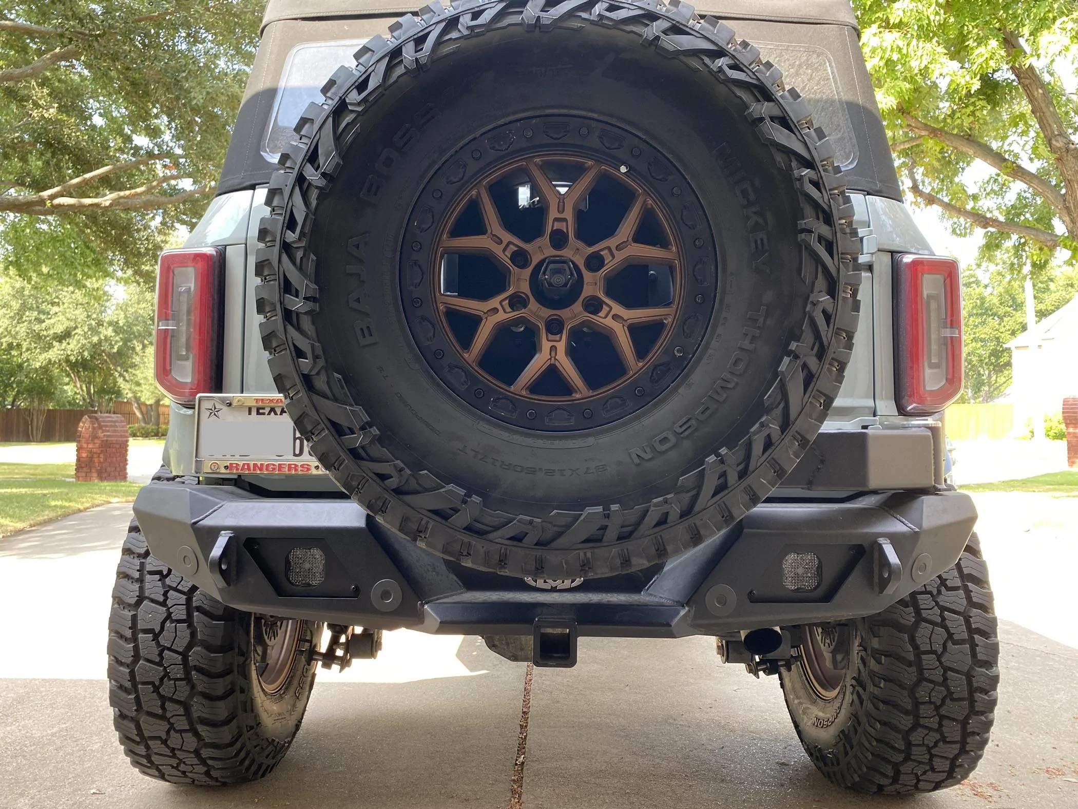

still experimenting with license plate mounting. I fabbed up a prototype mount to see if I like this location
Ford Bronco Rear Bumper show off thread IMG_2545
Ford Bronco Rear Bumper show off thread IMG_2548
Ford Bronco Rear Bumper show off thread IMG_2546

How does that tray bolt up?

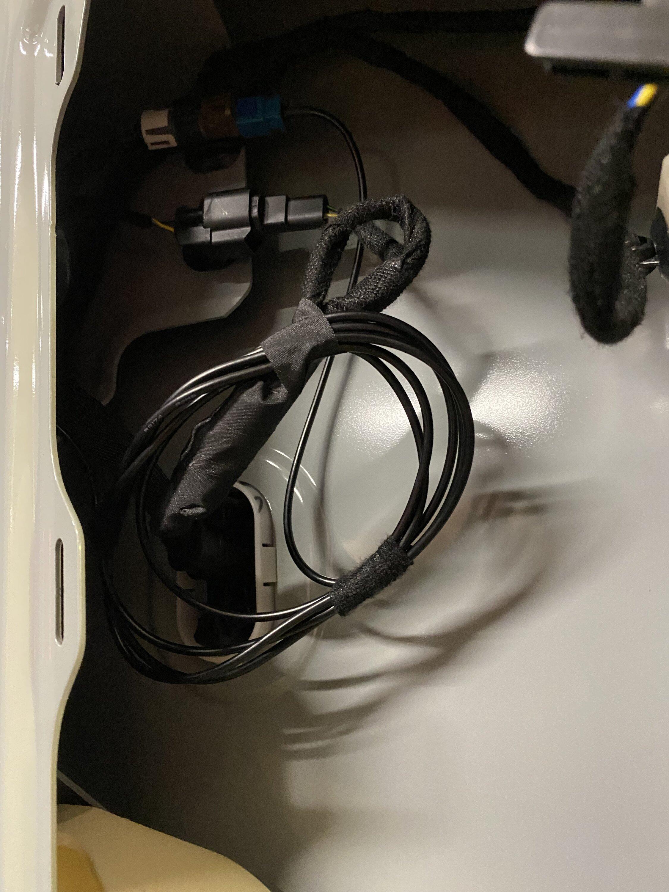

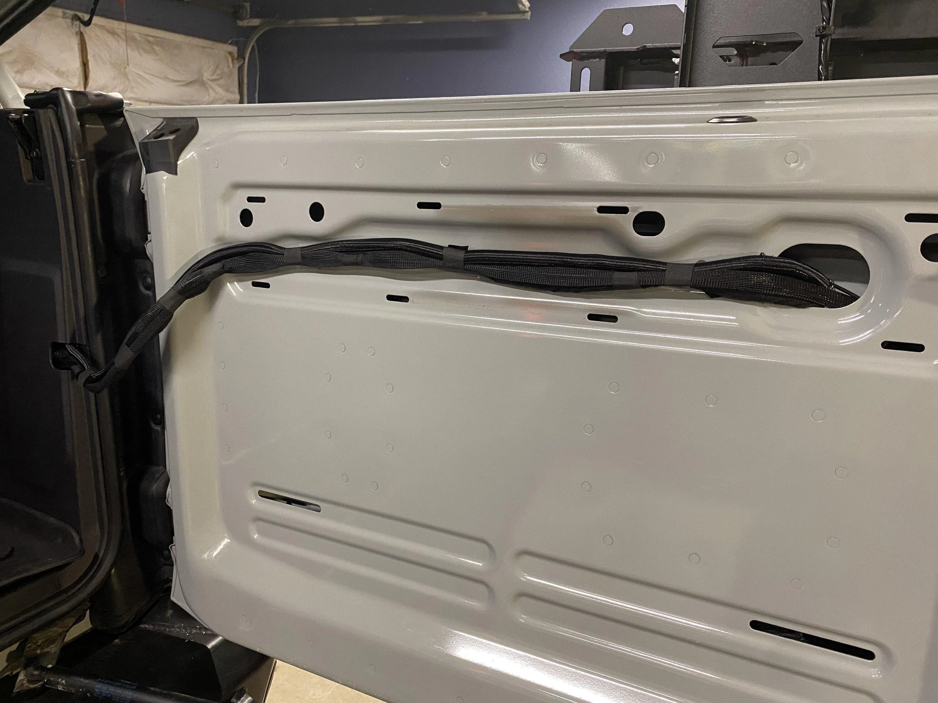

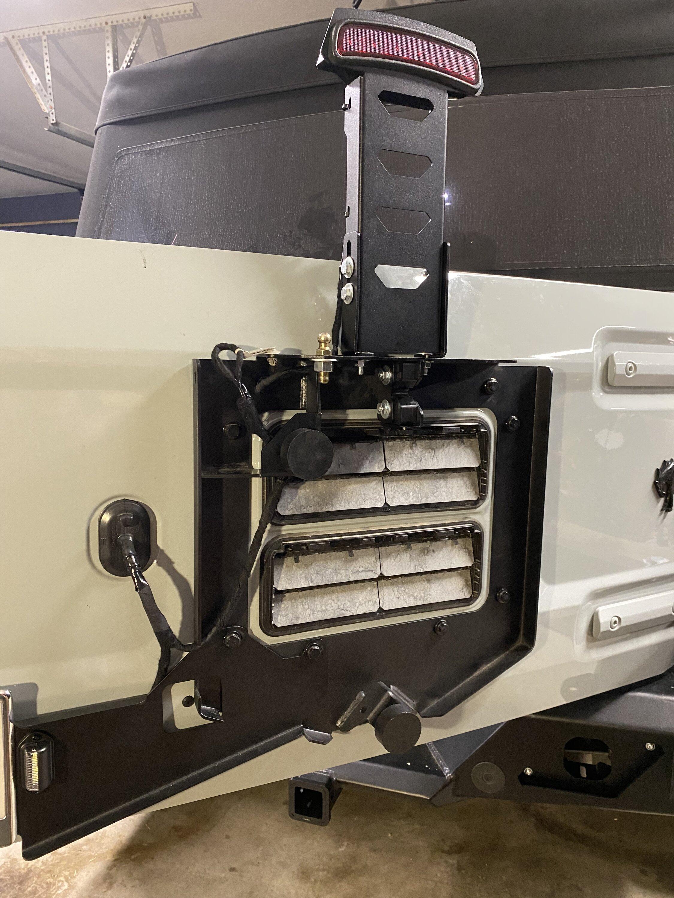

I ran the license plate wire and the camera cable similarly using the wire channel in the back of the tailgate. At first I ran the license plate wire through the vent in the tailgate, but then redid it and ran it through the same tailgate grommet as the 3rd brake light and OEM camera wire. I touted per their guide, just wish they had more pics of this part and more info about the camera connection, took me a bit to figure out, but it makes sense once you look inside the tailgate.
https://lodoffroad.com/assets/pdfs/BRC2100 BRONCO REARVIEW CAMERA KIT.pdf
Ford Bronco Rear Bumper show off thread IMG_6316
Ford Bronco Rear Bumper show off thread IMG_6318
Ford Bronco Rear Bumper show off thread IMG_6323
I almost undid the entire harness that was taped together to remove the OEM camera cable, but ended up just folding over the plug ends and taping it up real well in case I needed it later and to protect the plugs. You don’t need to use it at all. The LOD supplied camera cable connects into the plug inside the tailgate, once you disco the old one. Be sure to tape up the excess cable inside the tailgate.

The license plate wire was routed similarly, close to the above guide, through the tailgate wire channel, but the cable runs under the trim edge of the cargo floor.Then I dropped it through a small hole I punched through the tailgate weatherstripping, the method in the guide and down the edge of the LOD filler plate and next to the light plug. I then T-spliced it into the license plate light wire, just before the plug. This way I still have the OEM plug if needed.

*Be sure to use proper trim tools so you don’t break any clips! I went nice and easy, didn’t break a clip…

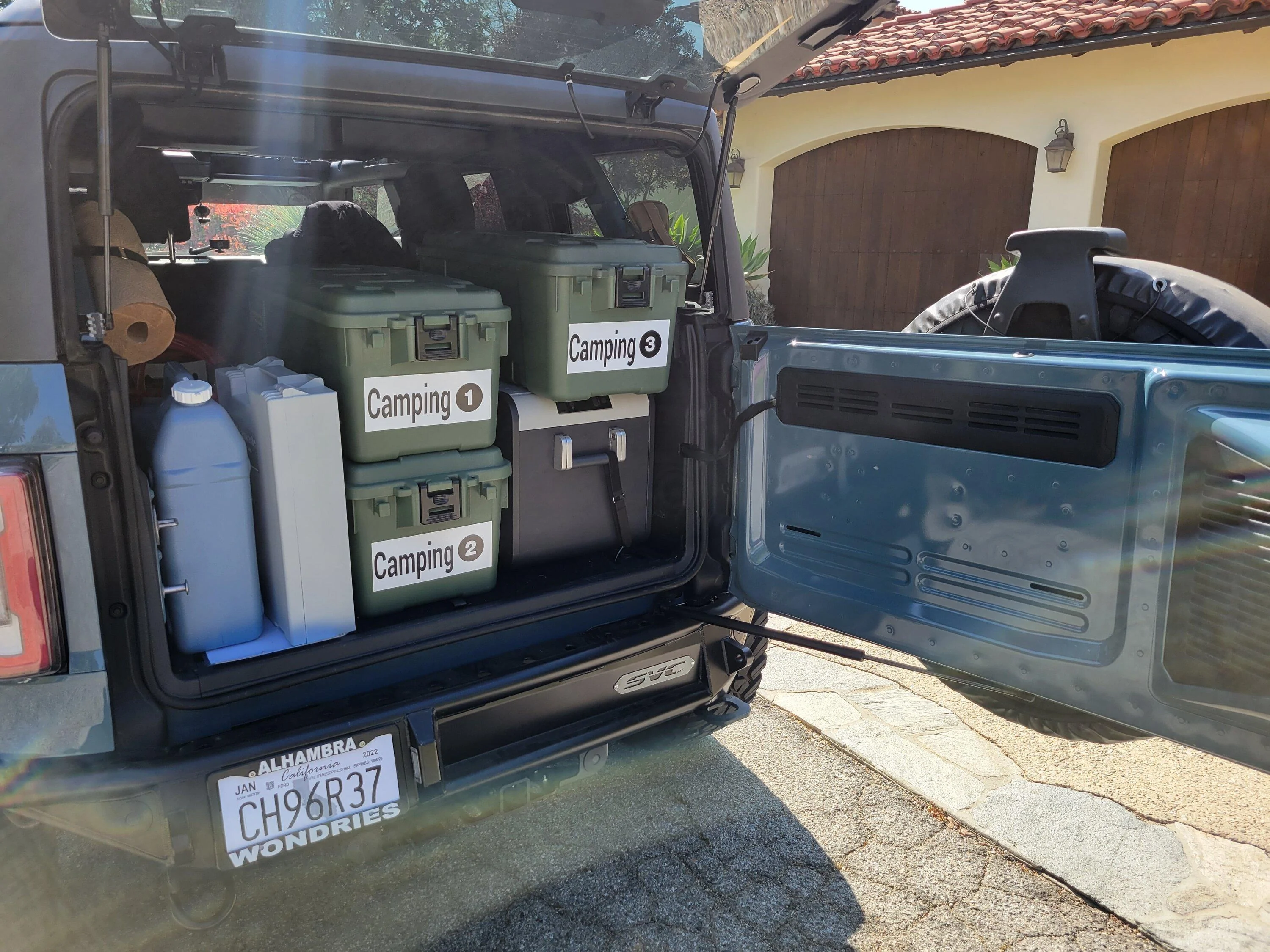

Are those green boxes to hold your camping stuff?
You guessed right! I have racks full of these storage totes, it's the only way I can find what I need.
theres something said for locking into a system and buying only one type of tote/box system for sure
