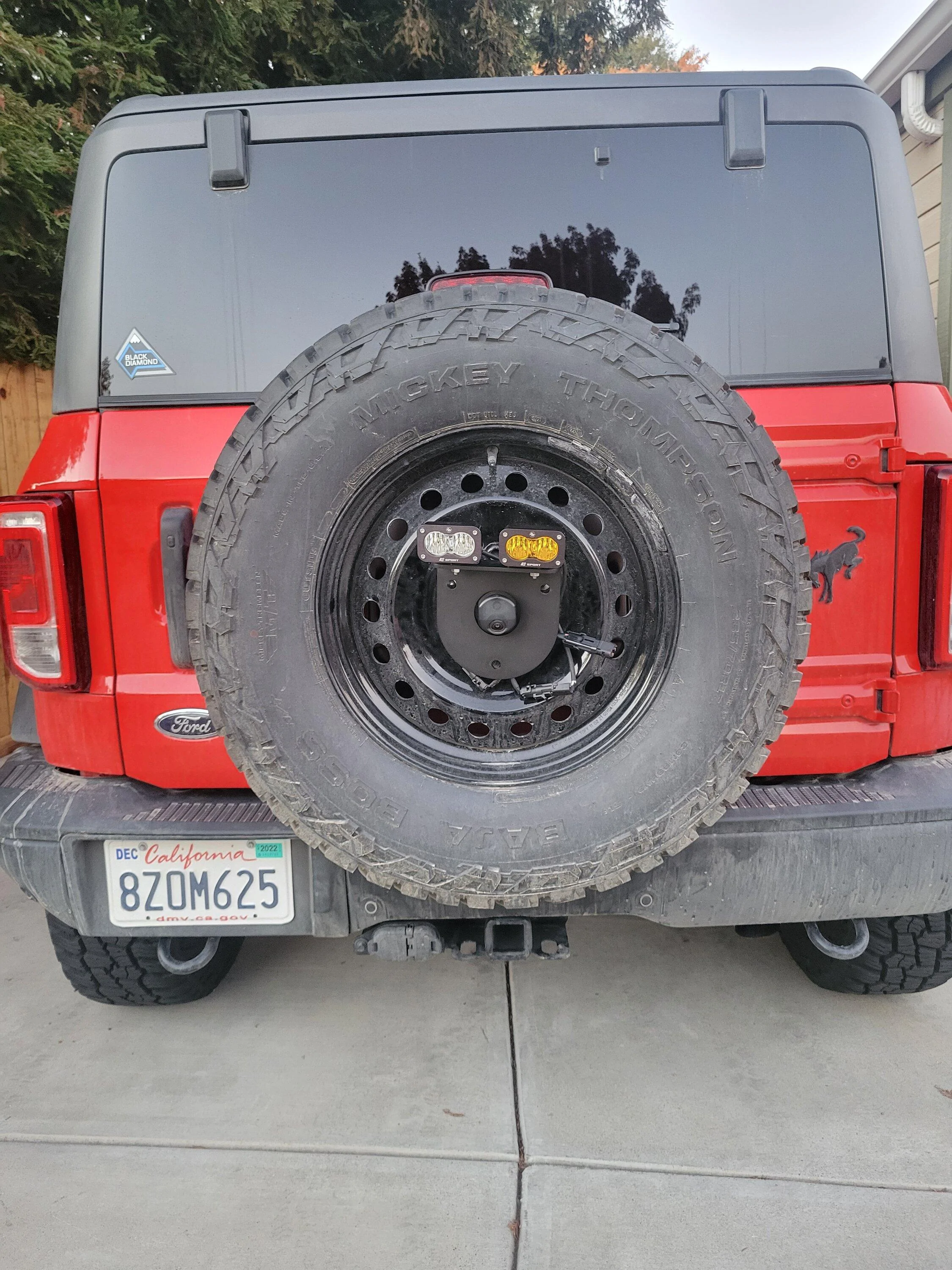

here's another vote for the Diode Dynamics rear pod kit - super easy to install, looks great, fits with stock or aftermarket wheels, and perfect functionality. now I'm thinking I need to get the amber covers .... hmm ... anyway, here's mine:

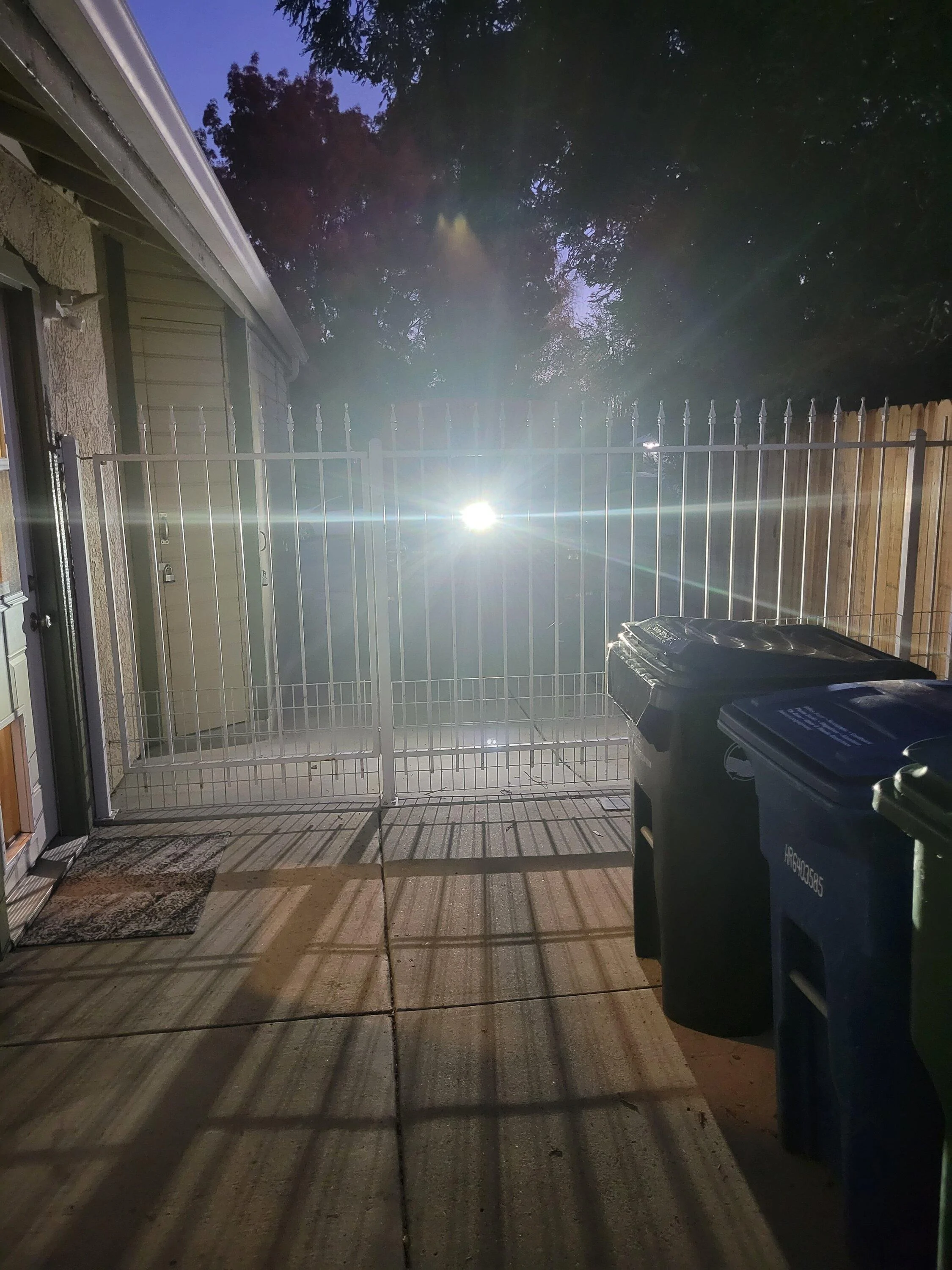

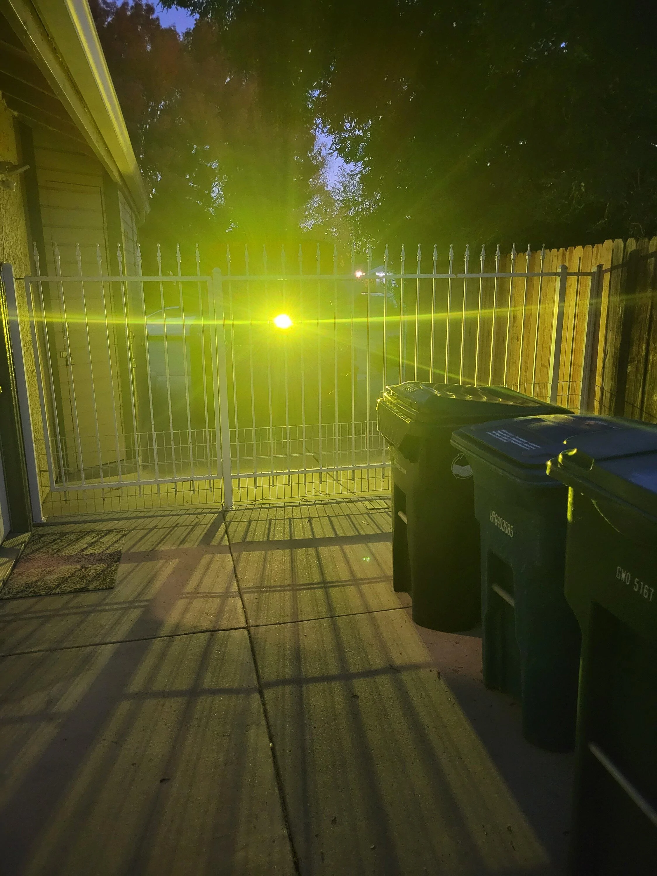

I have the Bajaj design reverse lights too and they work great...I put a amber lense on one and left the other clear.Going to run each light separately to my switches. The amber one is used for a chase light and the white for camp or extra light backing up.....
In these pictures the lights are not mounted there sitting loose and wires ran to battery just to test them out...
Ford Bronco Rear Ditch (LED) Light 20221112_170220
Ford Bronco Rear Ditch (LED) Light 20221112_172121
Ford Bronco Rear Ditch (LED) Light 20221112_172013
