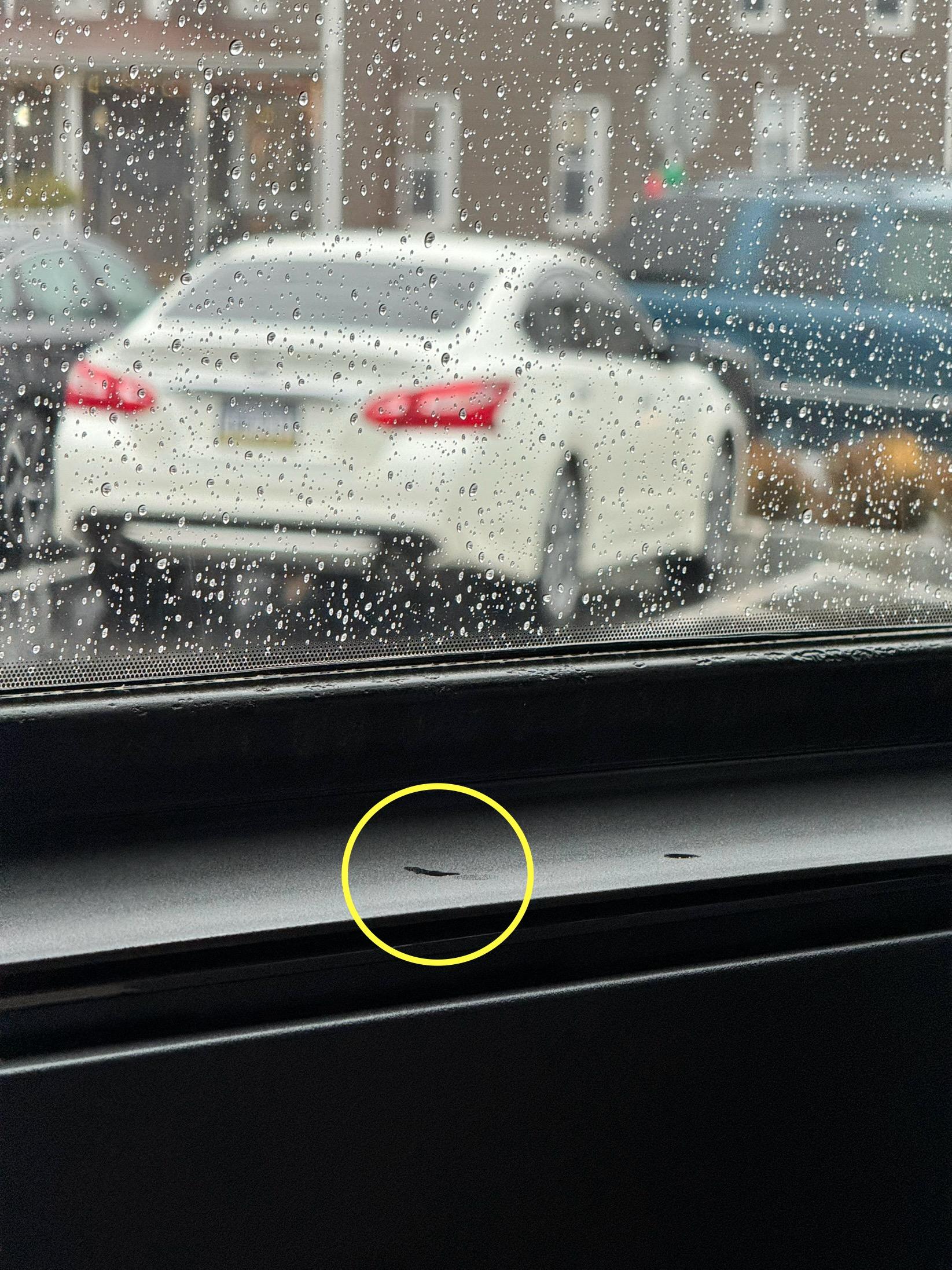

My 2-door also leaks near the rear window. Was in for service last week and claimed to have fixed it, but still leaking. Back to the dealer.

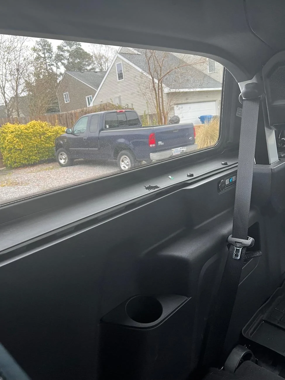

Ford Bronco Rear side window leaks IMG_1784

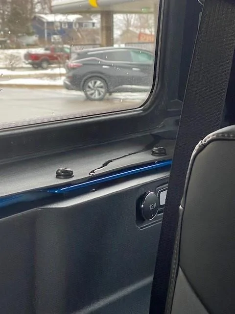

Mine is in the shop now w/3100 miles for the same reason. Passenger side leak in two places. They are removing the window then cleaning and re-applying the bead to seat the window back in.

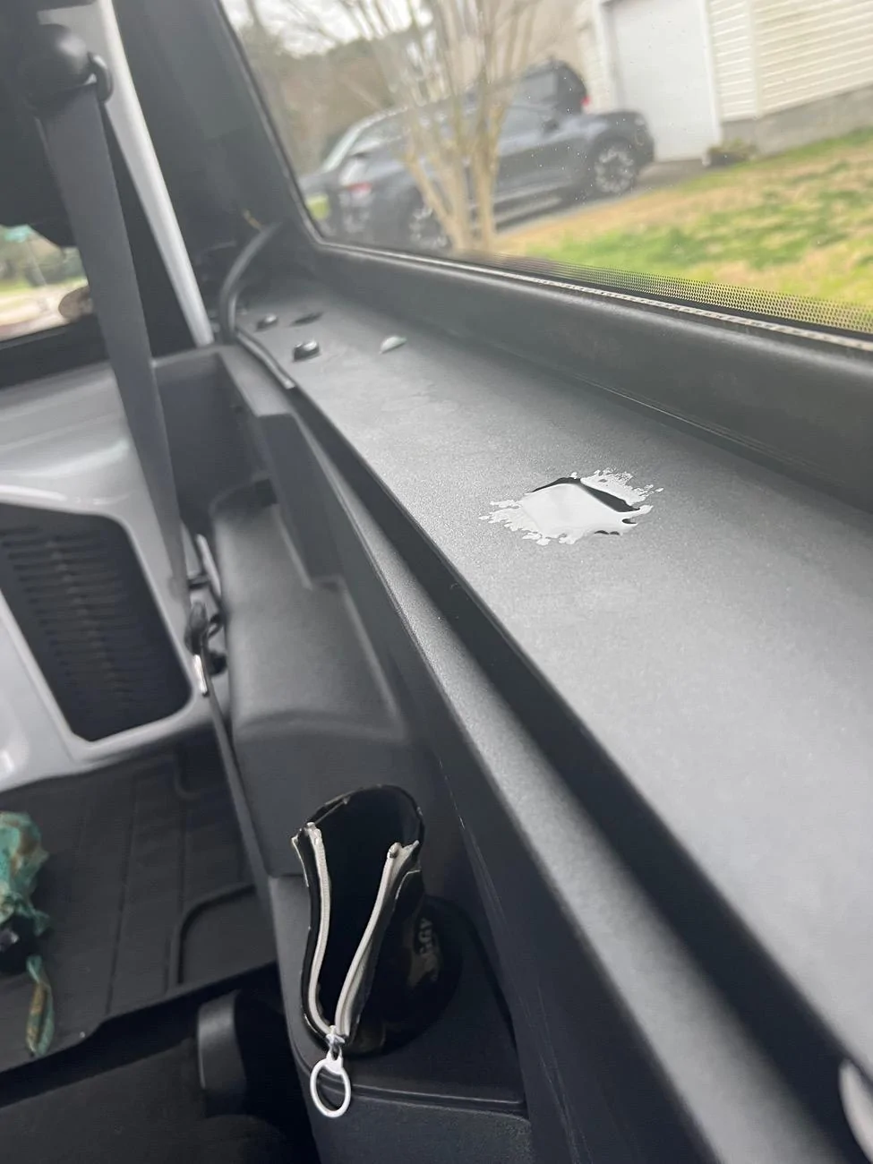

I fixed mine using flowable silicone via a syringe to leaking areas.

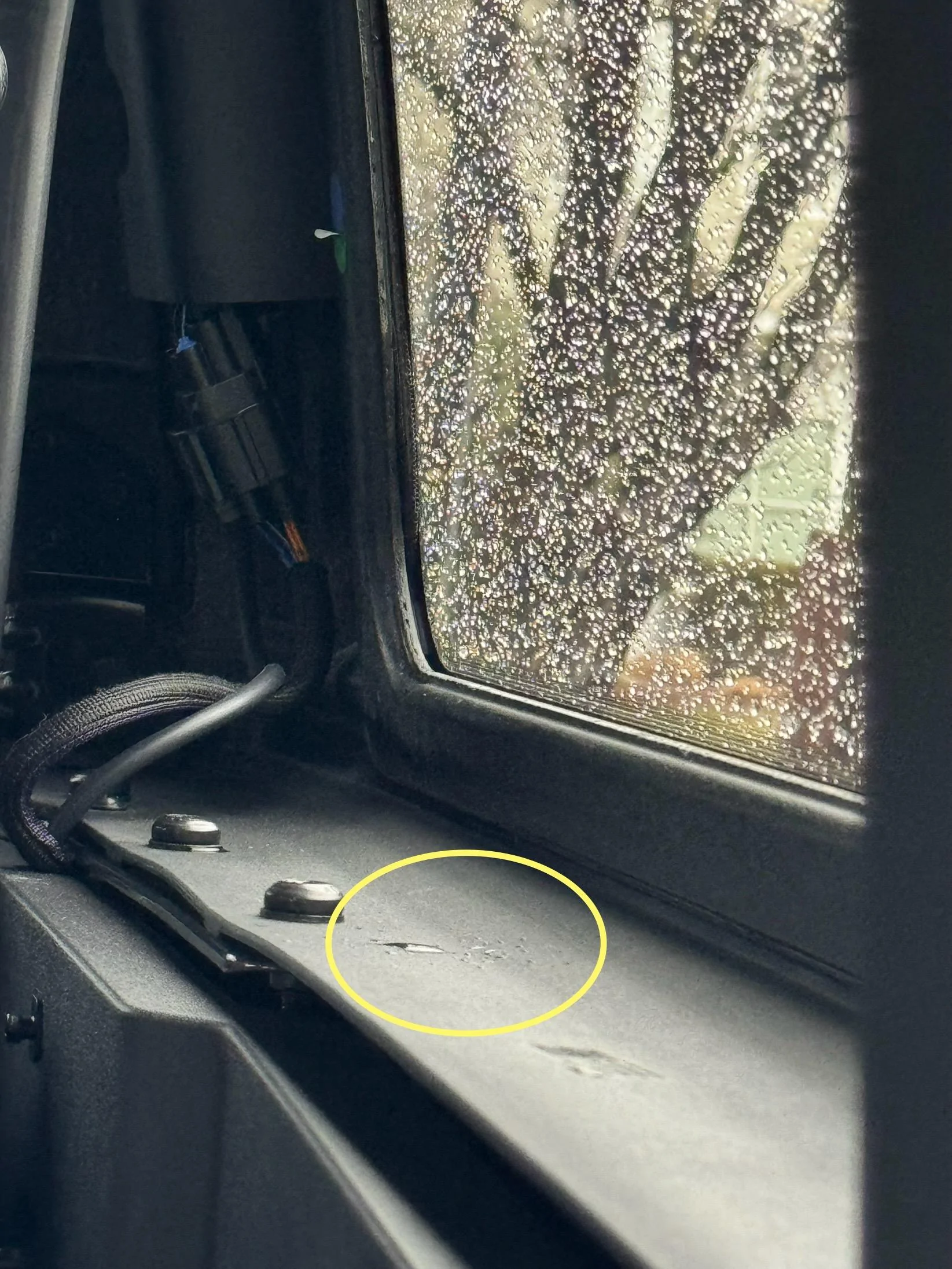

Ford Bronco Rear side window leaks IMG_1976
Hi there! I can look into your Bronco's leak concern on my end. To get started, could you please send a private message over with the name/location of your local Ford dealer and your Bronco's VIN?

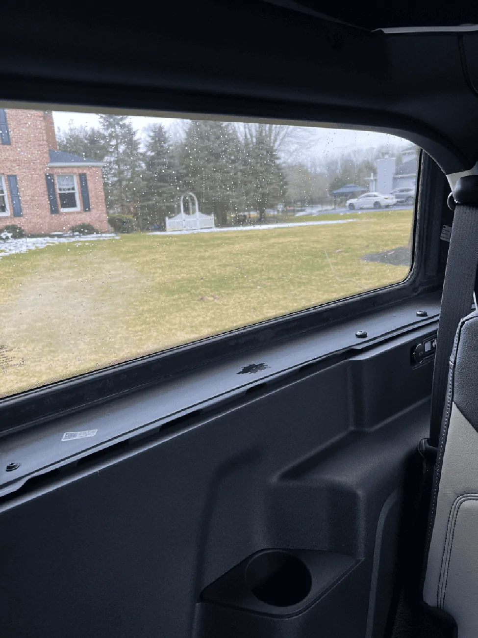

Can I join the club?
Ford Bronco Rear side window leaks IMG_0569
Ford Bronco Rear side window leaks IMG_0568
