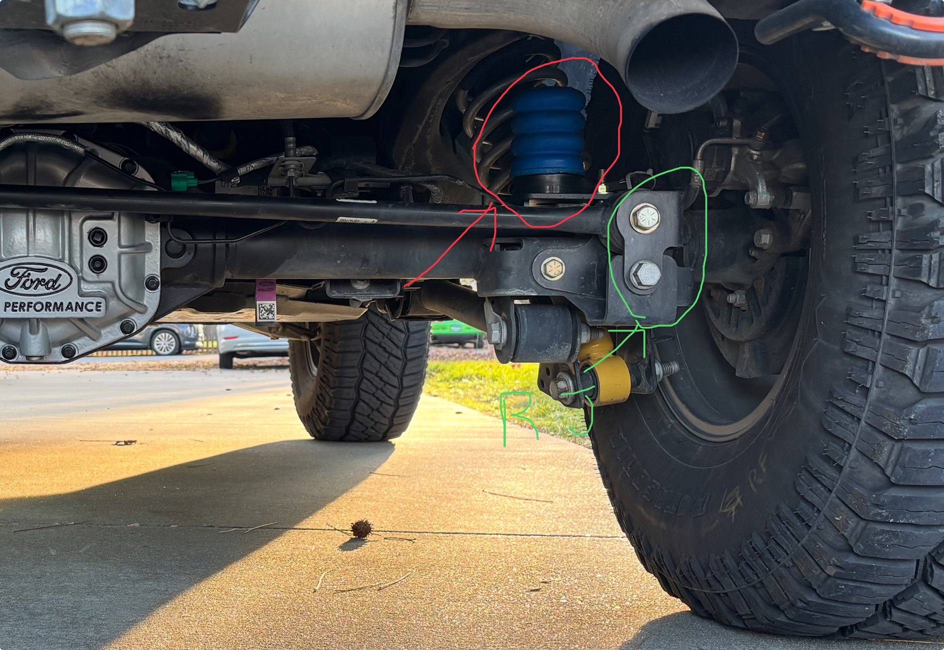

If your that worried about frame contact, get a pair of these

Only problem I see with those is it limits your articulation, if that matters. And may not for many. A larger bump stop inside the shock coil would also accomplish that.
Good point.

All true. The sumosprings are adjustable, to some extent, as it applies to how far into articulation they make contact. These are ready handy for hauling heavy gear loads without fear of bottoming out your suspension.
