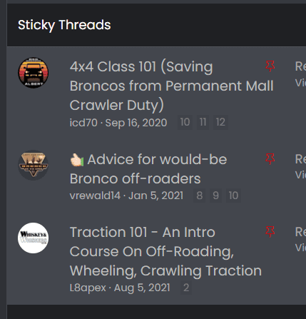

When in doubt: Start with reading the sticky thread in this sub-forum as it contains a BUNCH of great information and links.
https://www.bronco6g.com/forum/threads/advice-for-would-be-bronco-off-roaders.10779/
Ford Bronco Recovery Strap - Where do I start? 1656003358105
https://www.bronco6g.com/forum/forums/off-roading-overlanding-camping-technique-planning-trails.50/

It certainly is a balance of search and new posts but man your link was a gold mine of info. This is my first 4x4 vehicle and I am brand new to Off-Roading. Thanks for posting this direction to the sticky thread, some great nuggets in there!!!
I'm new to this as well (but don't even have a VIN yet!), these links and other people's input/experience has been super helpful.
When those threads went sticky it made it tons easier to find things.
