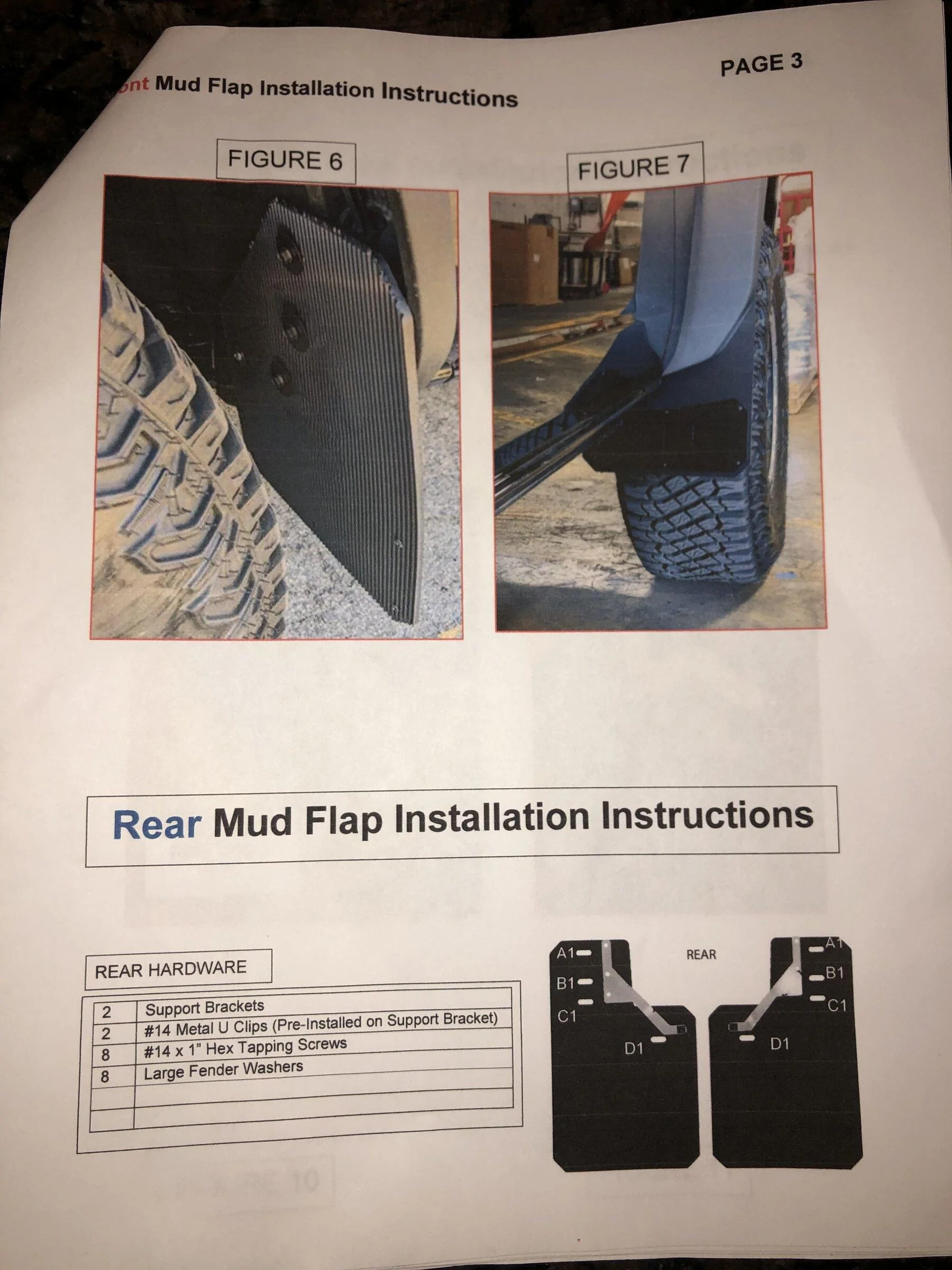

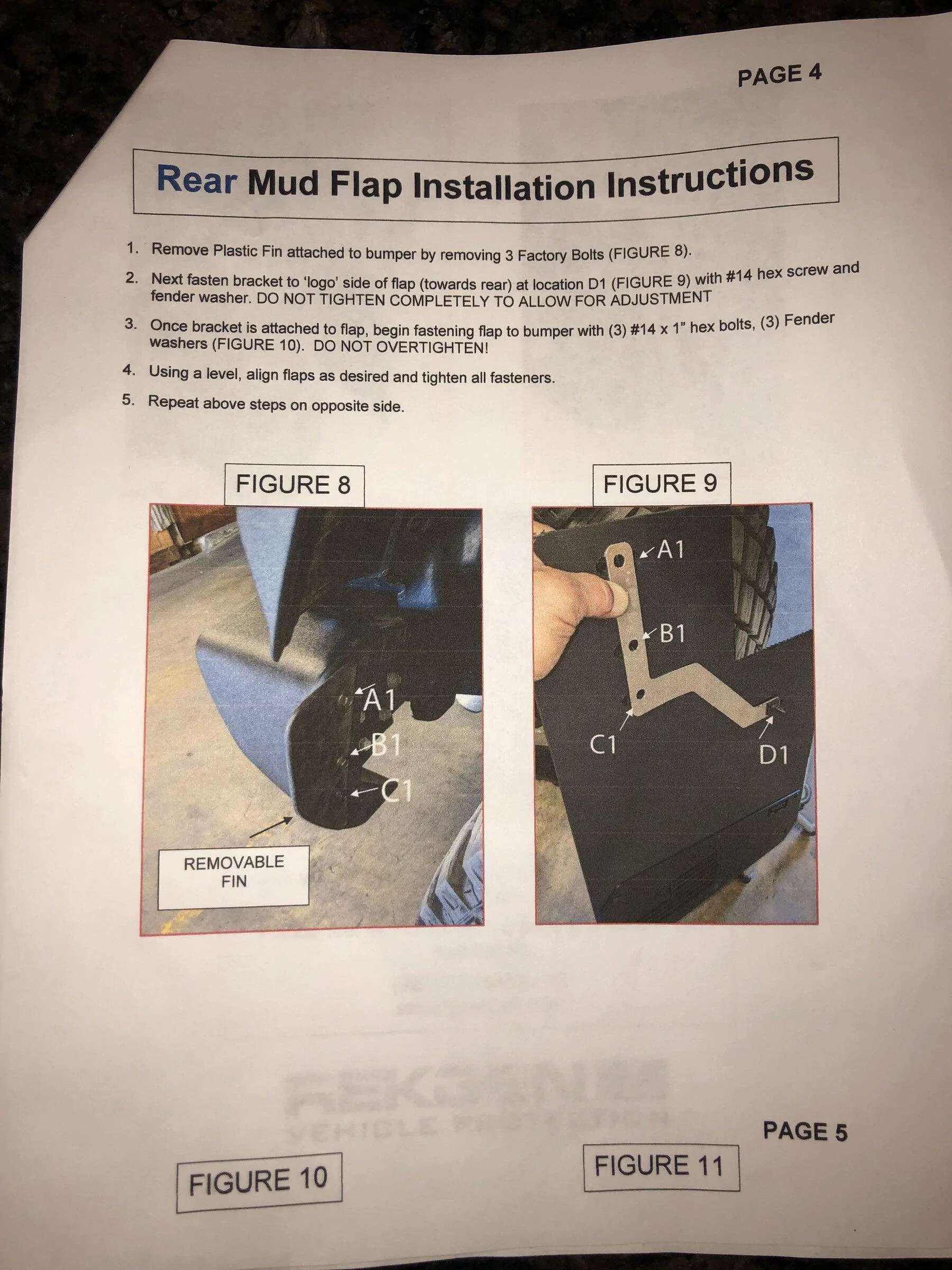

Just got the rek gen trophy sport flaps but it didn't come with any instructions. I was able to figure out the front flaps, which was no drill install. I do wish they were a little longer. I think I still get spray but will not know for sure till they've been on some muddy roads. I couldn't figure out how to get the rear ones on without drilling. Can anybody enlighten me on where they attach without drilling?

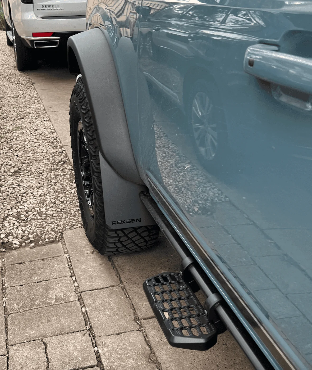

Got my RekGen front flaps (standard) and installed them. Really like them, even though I'm not a fan of mud flaps (but no choice). They are not stupid long; a solid length from a visual standpoint, which helps them blend in a little better. Will have to see how they perform. They fit nicely and very easy to install. From a materials standpoint, they seem very well made. Solid strength, pretty thick but some flexibility. Hardware is good quality. I see no impediment to modifying the attachment hardware to allow quick temporary removal for off road (will be working on that solution next week). Wish I ordered these originally instead of the other brand.

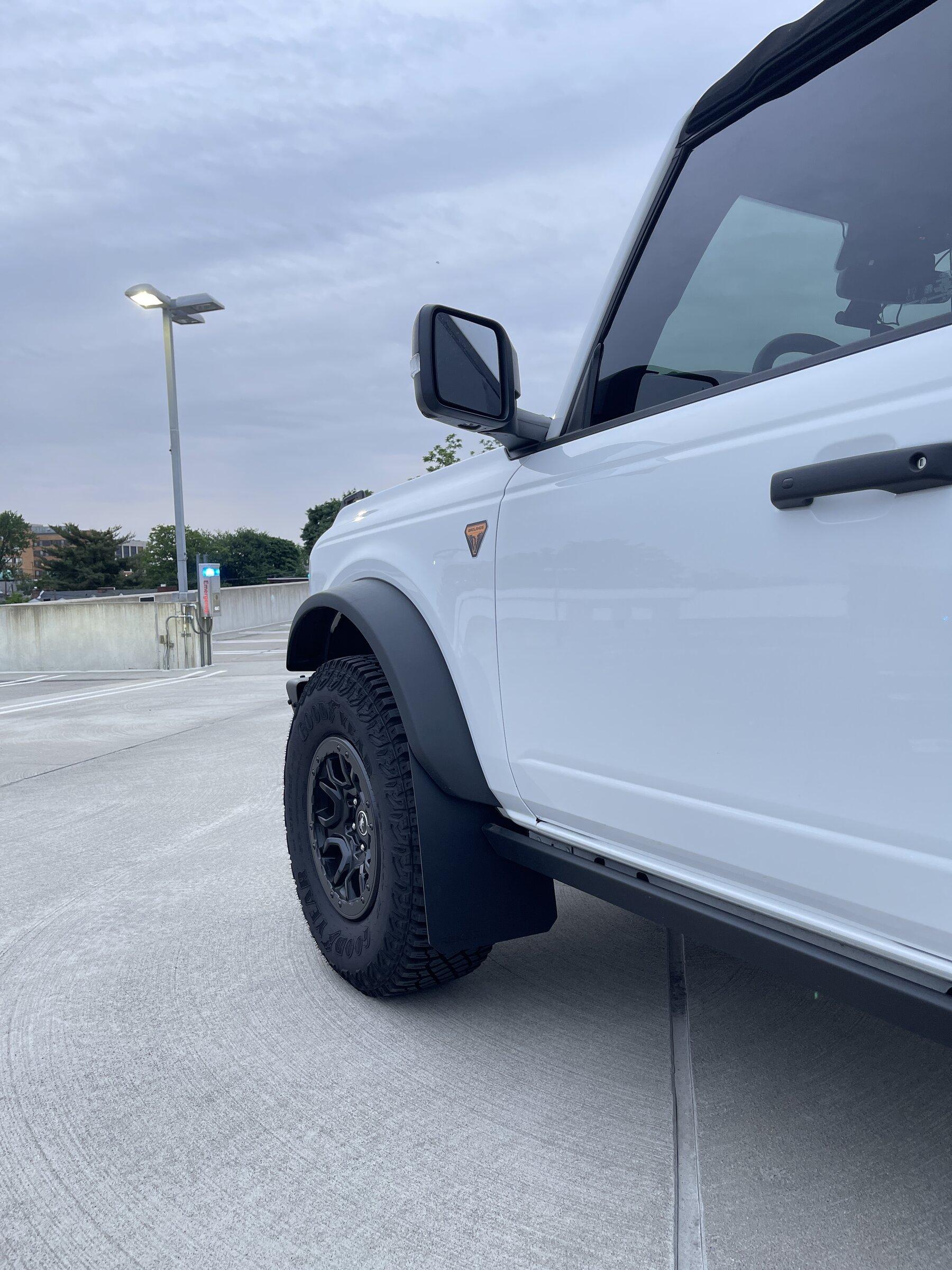

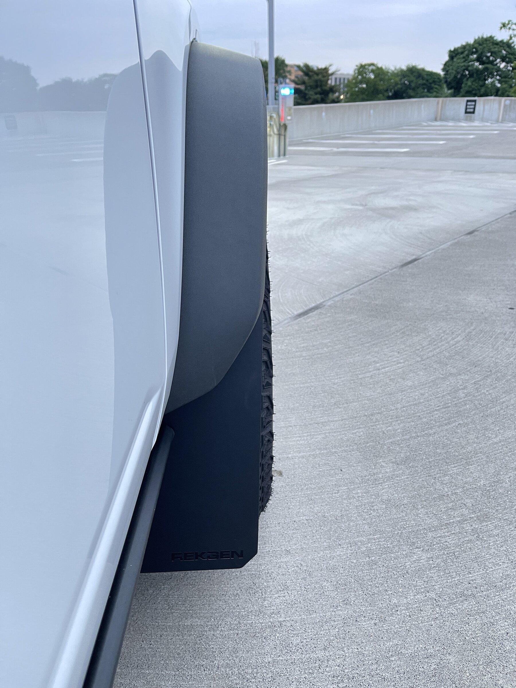

I just installed the Rek Gen Trophy Sport XL length mud flaps. Little longer than the standard ones but not too long at all. I really like the way they look and the added length should help block rocks these tires throw at the side panels. Once they release rear mud flaps for the badlands steel bumper, Iā€™ll buy those as well! Highly recommend.

In some pics, they look perfect. In others, they seem a tad long (Ā”OlĆ©!):ROFLMAO:
Iā€™m just playing aroundā€¦. I have the regular Trophy flaps coming tomorrow. If they donā€™t do the job though, Iā€™ll just buy the XLs and call it good, as I do believe these are the best-looking and most durable. Even removing them for crawling, while not as quick as the RBs, wouldnā€™t take terribly much longer.

I also bought the Rekgen Trophy Sports for my Bronco. The rear flaps are almost as easy to install as the front flaps with the instructions. I took a pic for you, but apologies for the bad lighting. Let me know if you have trouble reading these or have any questions.
These mud flaps are working great, great quality, and look really good too! Super happy with them!

haha yeah depending on the angle they look a bit long. I like the look of the regular length more but right now Iā€™m more concerned with protecting the side panels. I already got a pretty good gash from a rock that was thrown at the door from the tires so after that I decided long mud flaps were the way to go.
I get itā€™s a Bronco and should get dirty and bla bla bla whateverā€¦ dirty is one thing. Chipped door paint is another.
