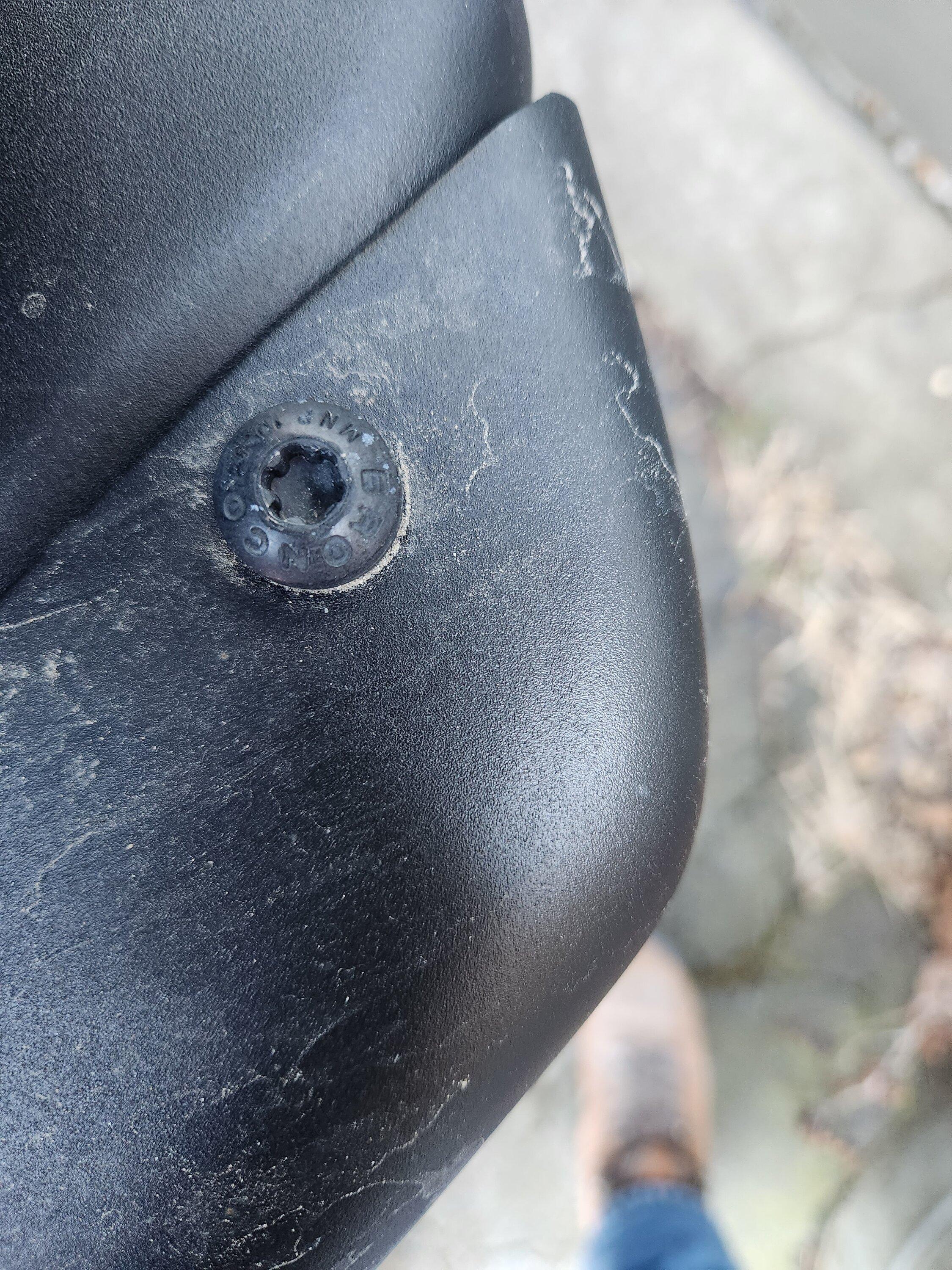

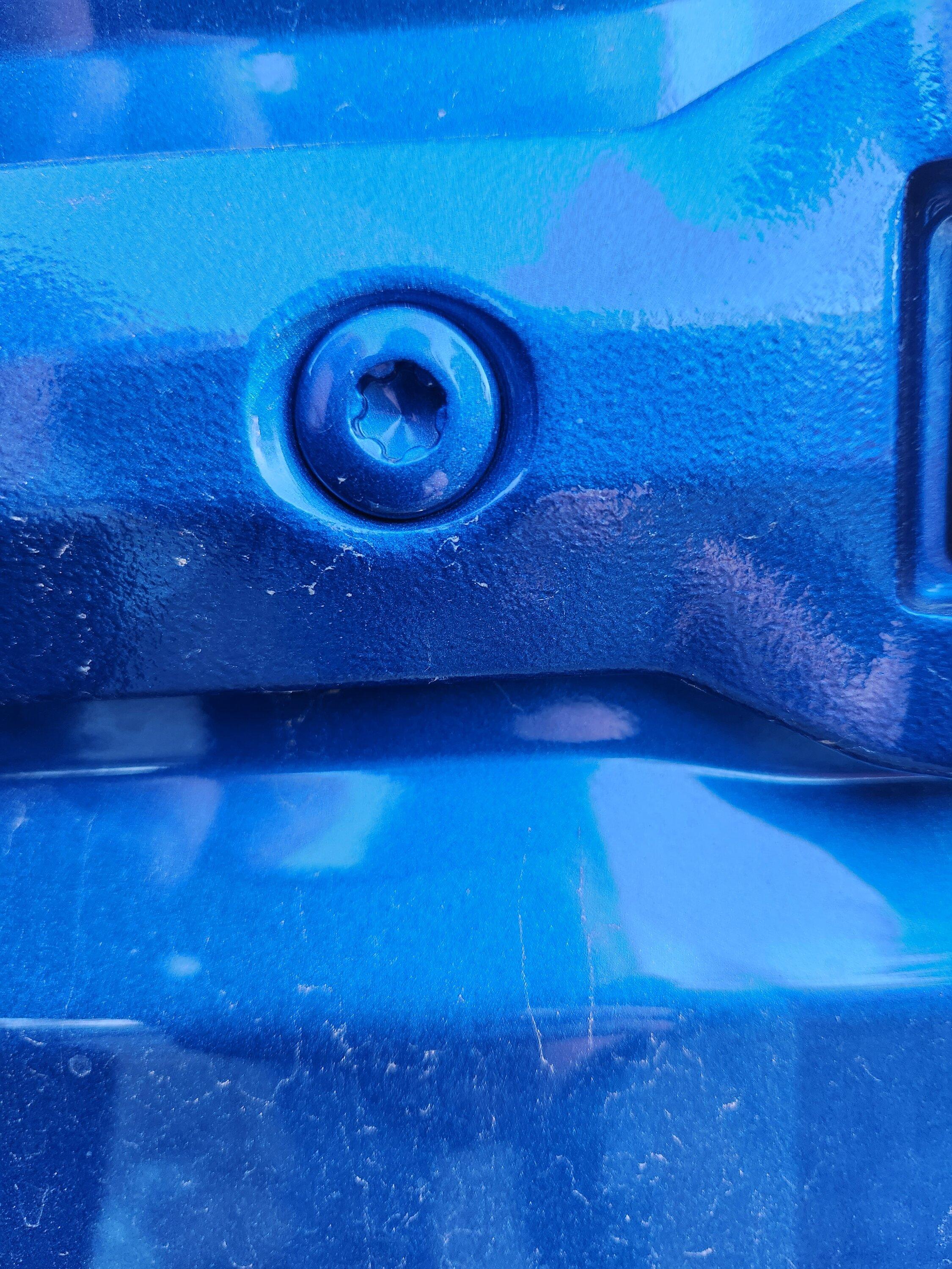

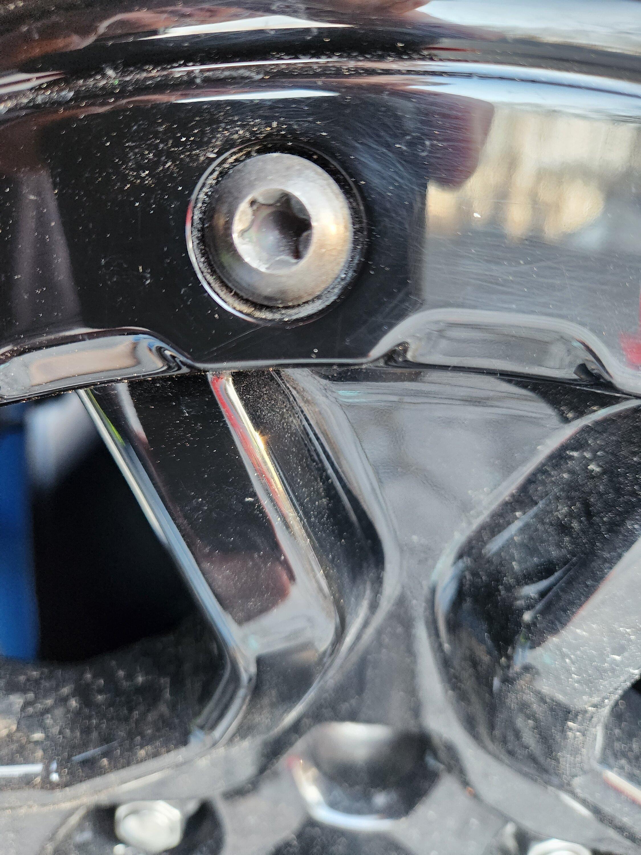

Mine all came out fine too. Cracked by hand with a ratchet and then zipped out with a 1/4"' impact. I could swear I used a TP45 though.
So your comment had me wondering. I took some pics of the front bumper, tailgate hinge and beauty ring bolts. After closer inspection, I can see the difference between the Torx and the Torx Plus.
Very frustrating though. The torx Plus fasteners have a wider recess around the outer perimeter.

See pics.....it's like when we were converting to metric back in the day.....

Yep, you can definitely see the difference in the photos.
