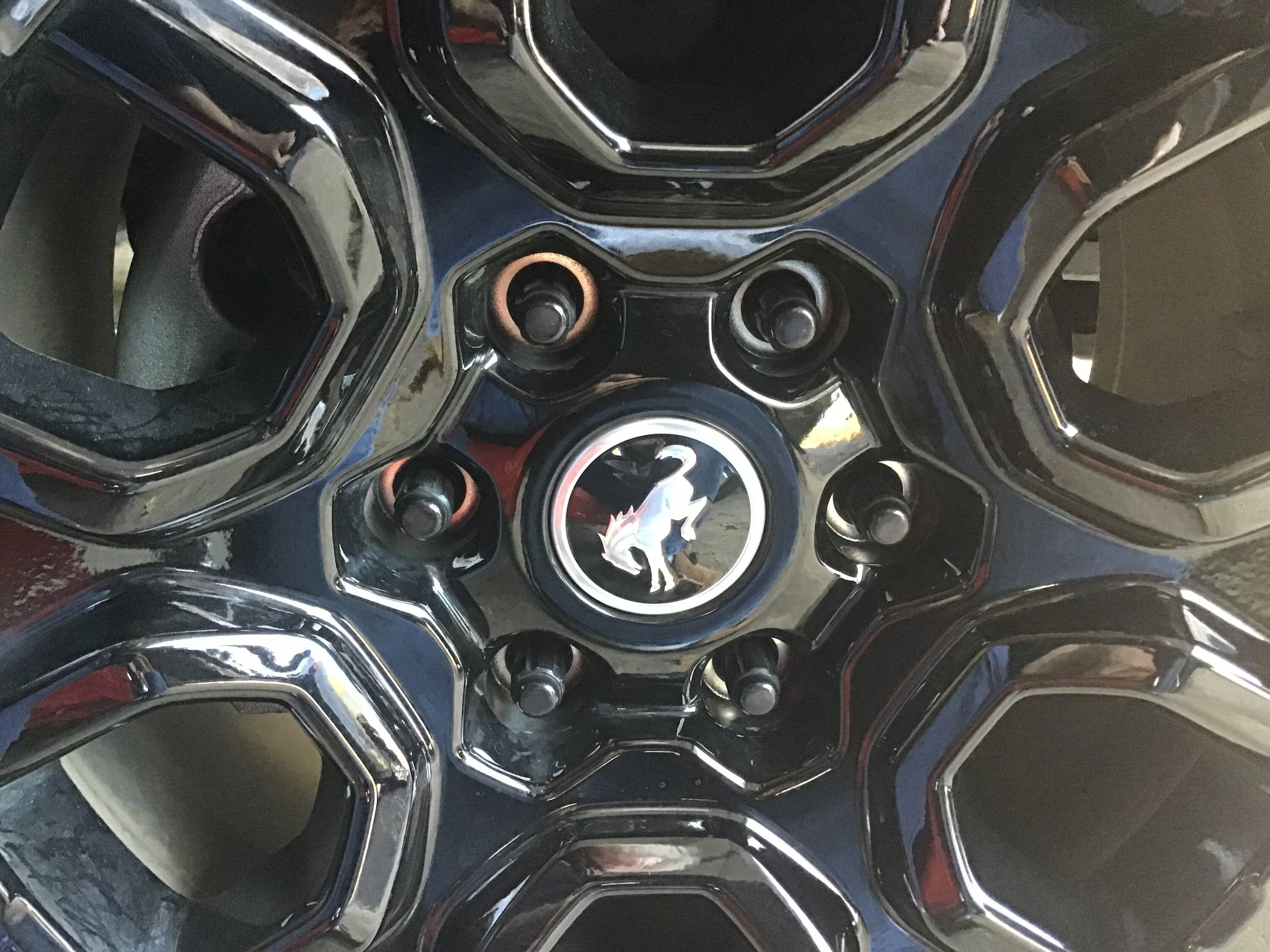

They work fine, but a small circle of the wheel shows around each one. You have to look hard to notice.
Ford Bronco Replacement  lug nuts IMG_3657
