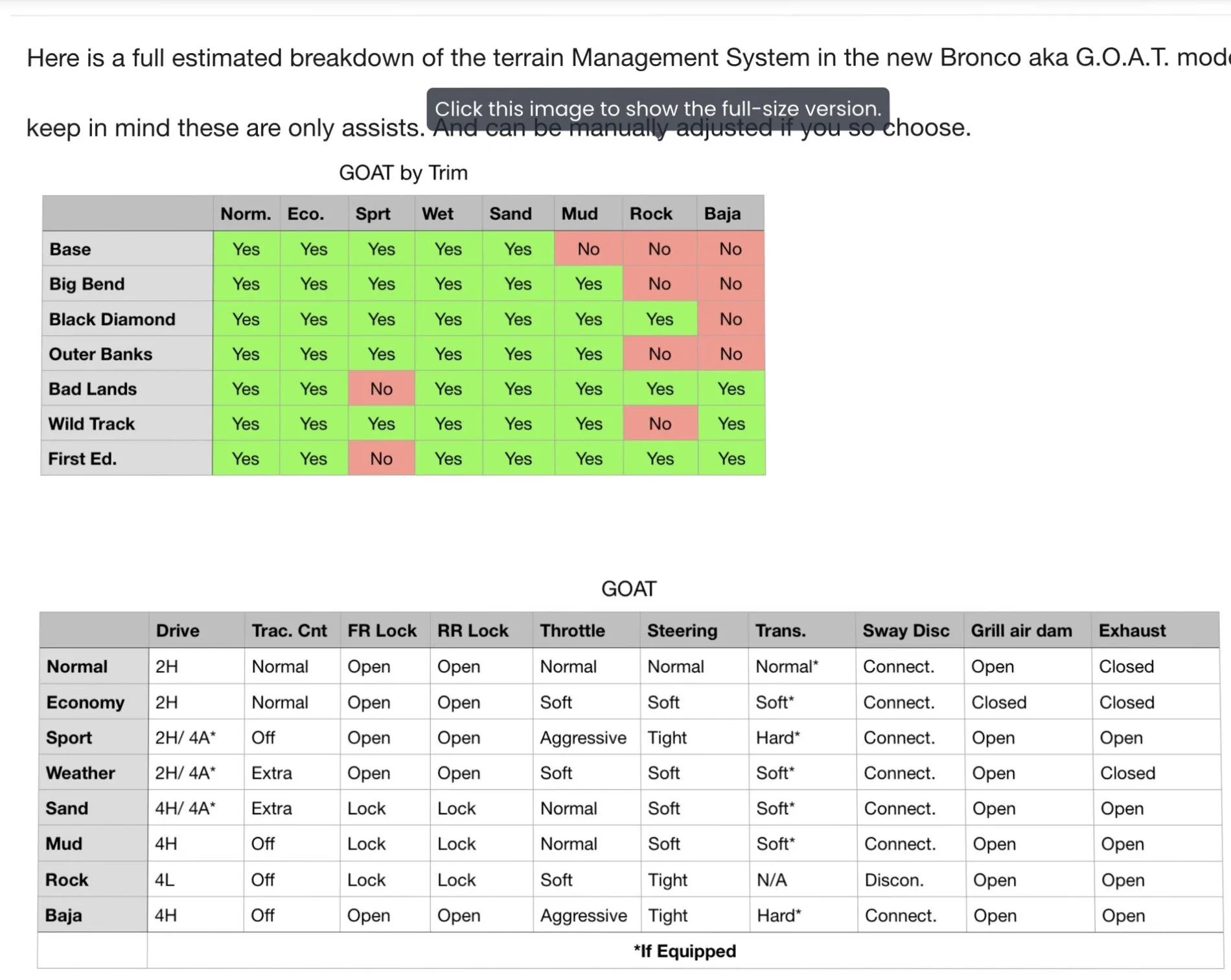

Sport is NOT just a 2WD Baja. We know that the Baja mode specifically alters traction control to allow for more slippage in sand (from an engineer at an event and Levine). We believe that Sport is intended for pavement and traction control is tuned appropriately.
I really wish people would stop pointing to that chart as gospel on GOAT modes. It was a guess made by a forum member, and we know that some of it is not accurate. (For example, it lists Baja as completely disabling traction control.)

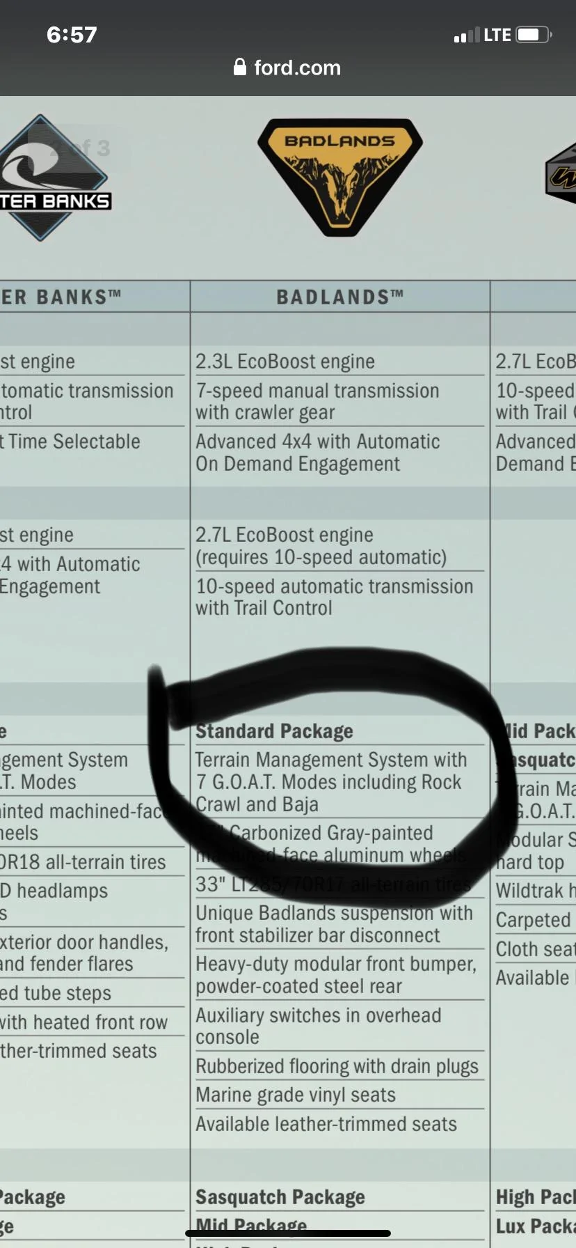

As to the OP's question, I'll admit I've been wondering if it will be possible to enable Sport mode on a Badlands via Forscan or some other means. As far as we know, there is no mechanical reason BL shouldn't be able to make use of the Sport mode. Even if there is some software limitation only allowing us to have 7 modes, I'm sure many would gladly trade Eco for Sport.
Thinking about this more, I wonder if they only set up Sport mode for use with 32s or 35s, and that's why it's not available on the BL?
Like you, we are all speculating on this, so it's hard to lock anything down until we have confirmation with an actual Bronco in-hand. We can only go by the information we have and extrapolating on other things.
And I'm sure Levine knows all about this..He hasn't steered us in the wrong direction before....:rolleyes:
Some good points there....with the best being that someone made up that chart, with their best guesses. I am hopeful that there is some way to get to sport like performance in the Badlands.

That's what I thought, so it has to be in a mode...Normal, granted according to the made up chart, has the exhaust closed. It would be crazy if you had a vehicle and couldn't run it full out with open exhaust on the street. It doesn't look like there would be any way to do it if you didn't have Sport.
The Bronco has selectable exhaust? The Raptor does not have that. Typically on vehicles with selectable exhaust they are vacuum operated. Normal mode would leave it closed unless you get on it hard. At that point the vacuum overrides the setting and opens it up. In Sport mode the exhaust is fully open all of the time. That is how it works on our Audi and BMW's.

Has anyone ever gotten any clarification from Ford on this topic at their recent Q&A's? Why no Sport mode for BL and is there a way to program/tune it? Like others I feel it is a huge mistake on Ford's part to not offer a Sport mode on a $55k vehicle that is perfectly capable of running it and most people would use it daily (if they don't care about mpg). This is a no-brainer Ford!!!
