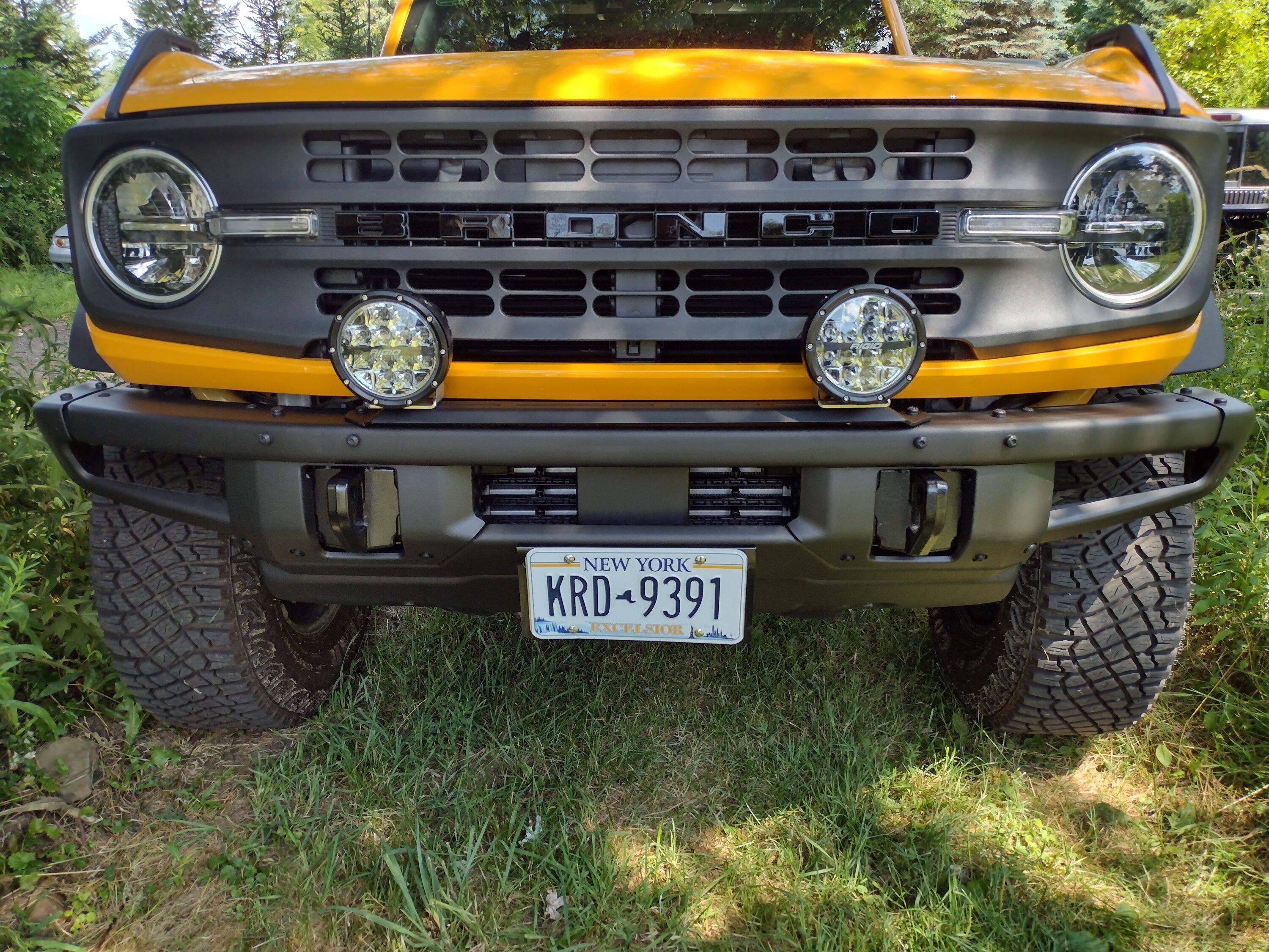

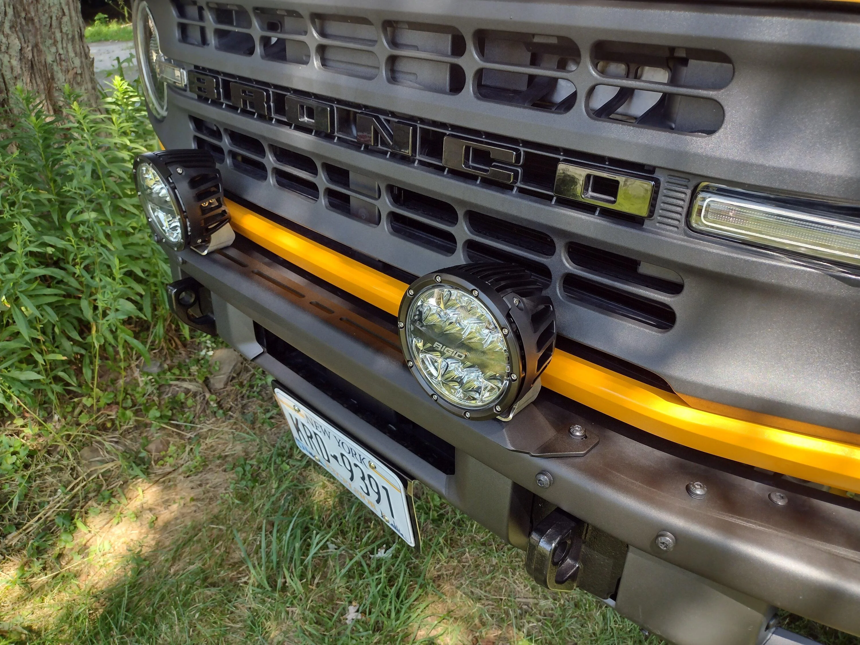

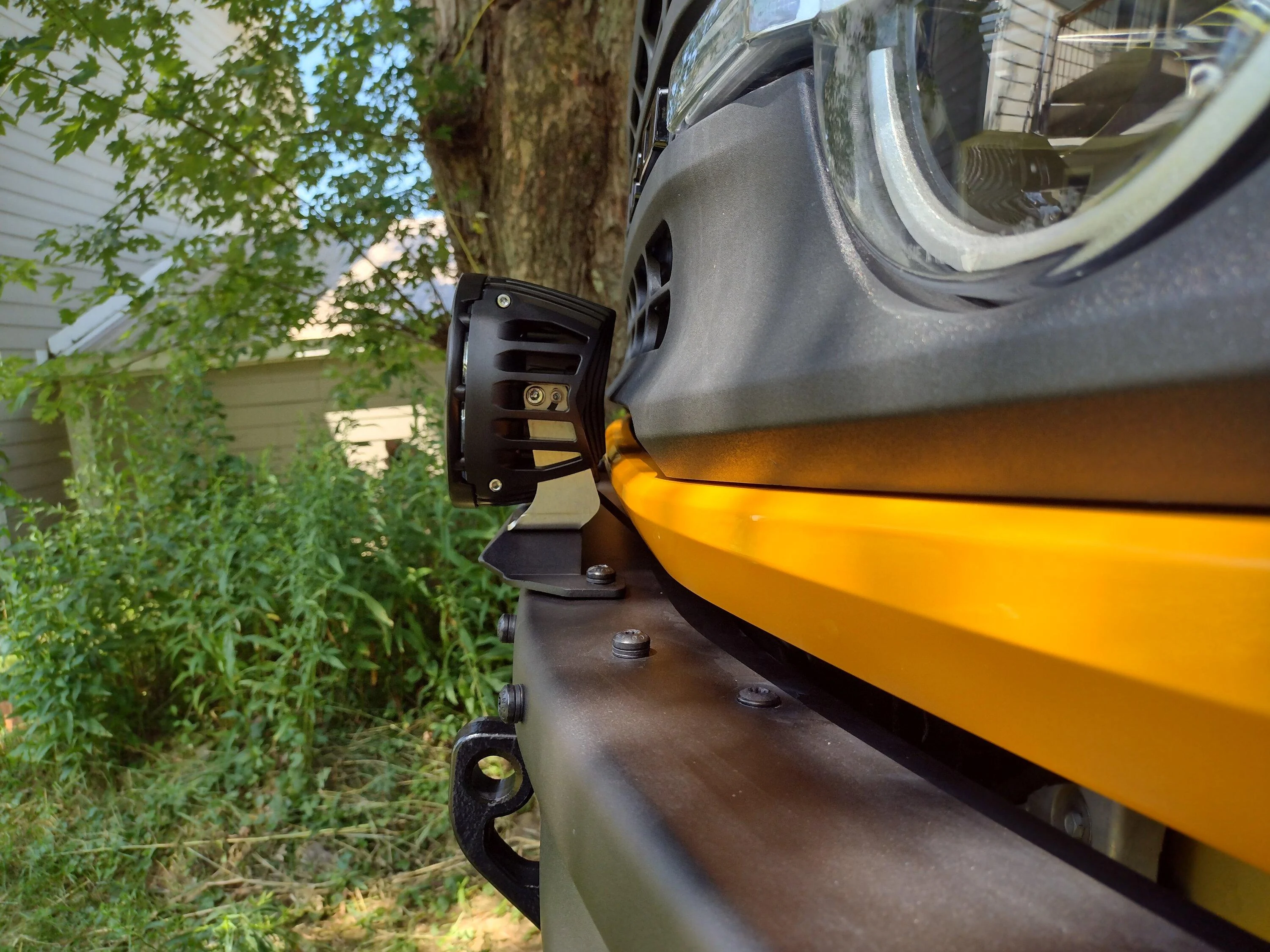

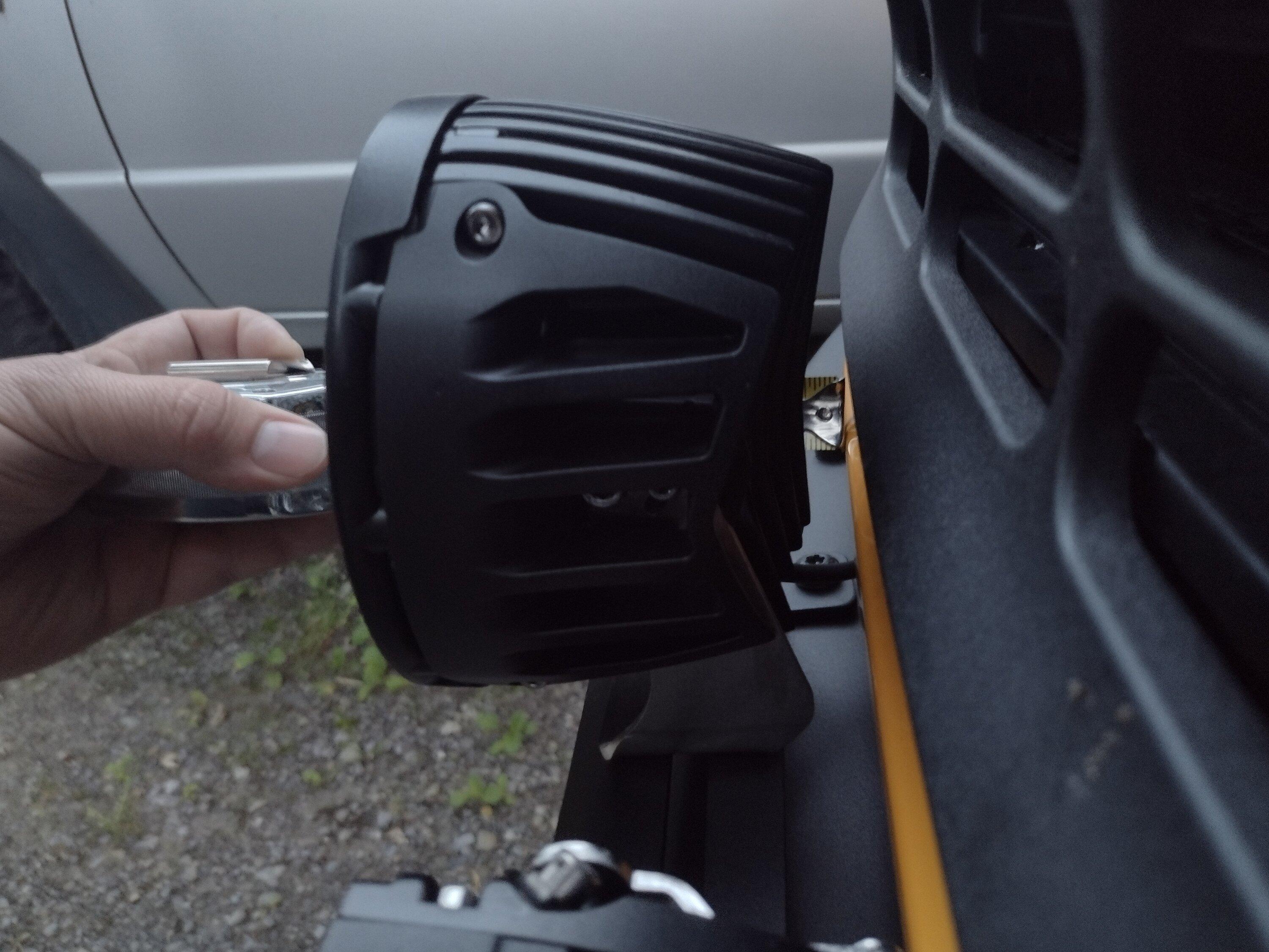

Ordered up a set of Rigid 360 lights for my bumper. I knew that the 4 inch Rigid ones seem to fit ok, by that preproduction photo that I'm sure many of you have seen. The 6 inch will not bolt directly to it. Not enough room. So I ordered a mount from Greenlane Off-road. Super beefy looking. $150 CAD, I think it came to about $130 US with shipping. So far, just mounted. Hopefully get them wired this week.

Man that is tight! I do like the look of that mount though. Would look good with a push bar. Be sure to post pictures of the light output at night once you get them wired up!

Will do. Yeah, there is not much clearance there. Once they're aimed properly, I'll have to post another shot of the clearance, maybe with some actual measurements as well.

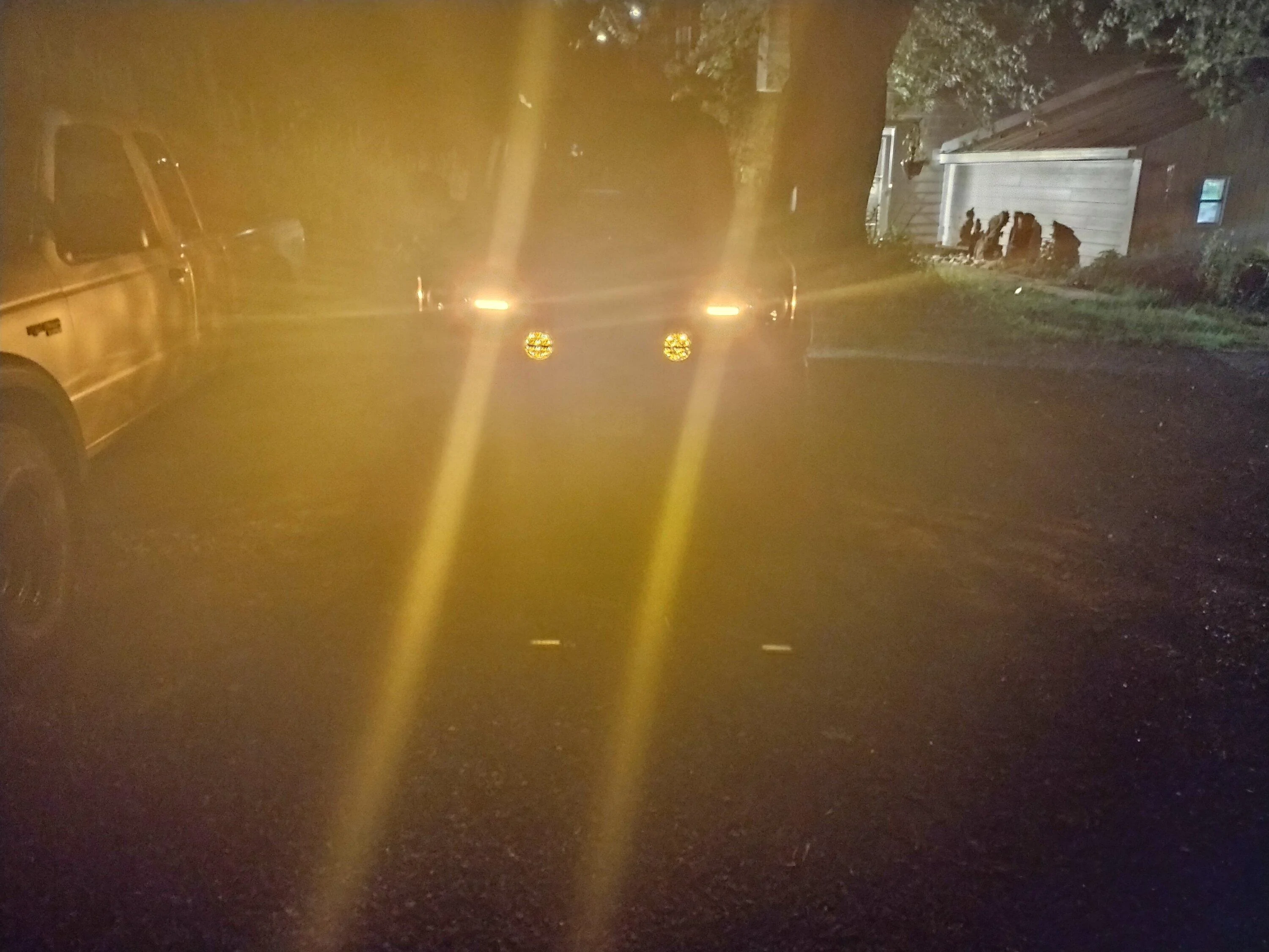

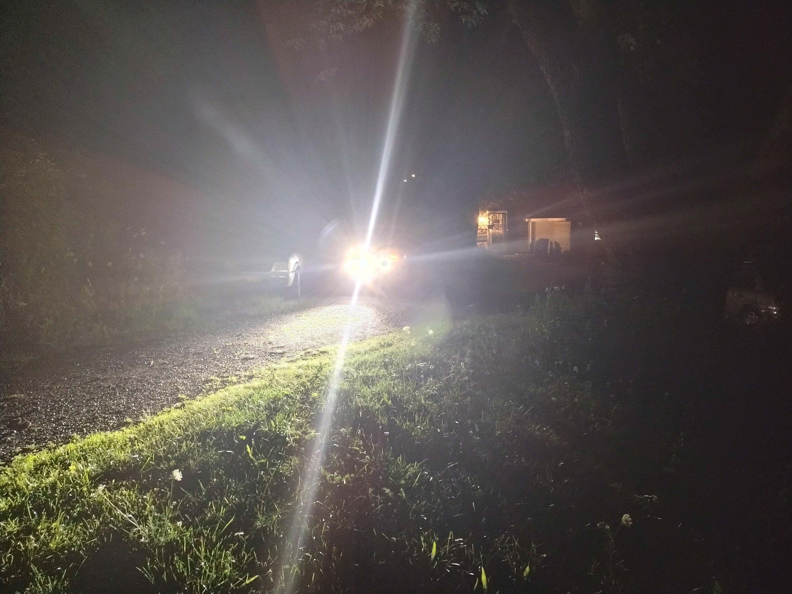

Will post a night shot later tonight. The amber backlighting isn't super visible during the day, unfortunately.

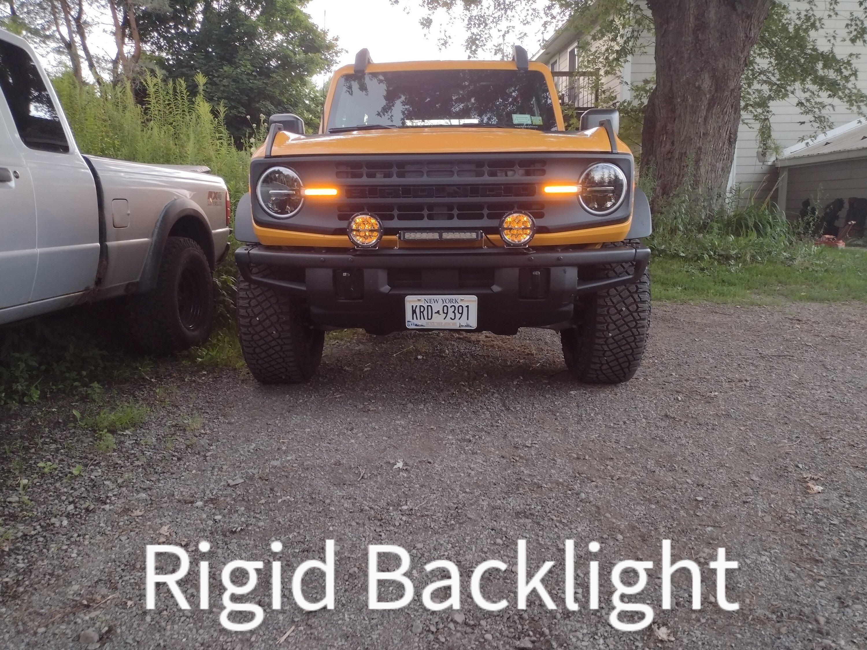

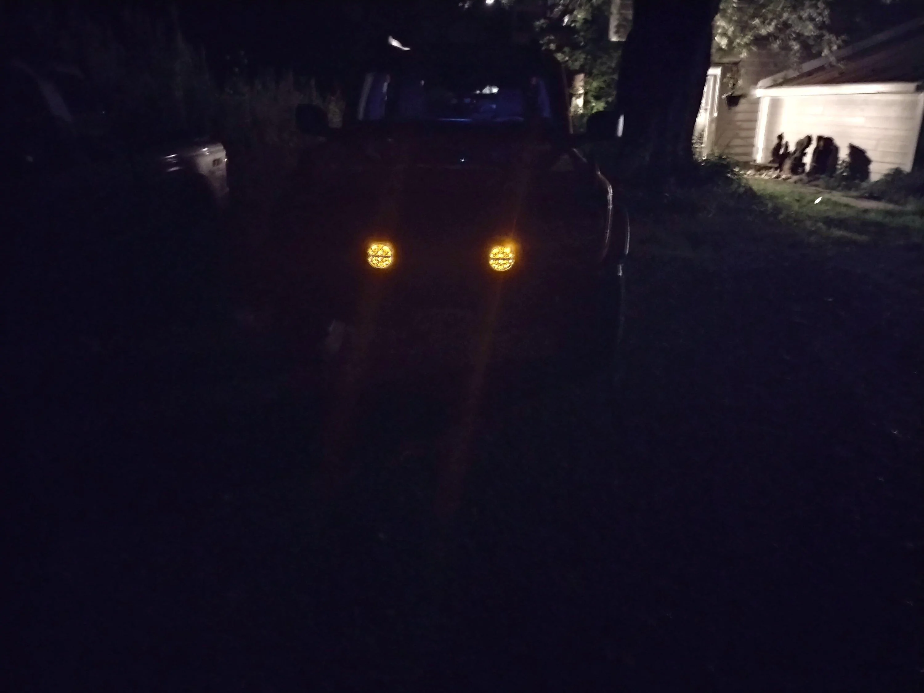

Backlighting & parking, just backlighting, and rigid off-road.
My driver's side lamp has an issue that I'll attempt to diagnose today. It's only a fraction of the brightness off the passenger side. I'm sure there's a poor connection somewhere.

It was a poor connection at my ground. Just unbolted it and shifted it a little. Works awesome now!

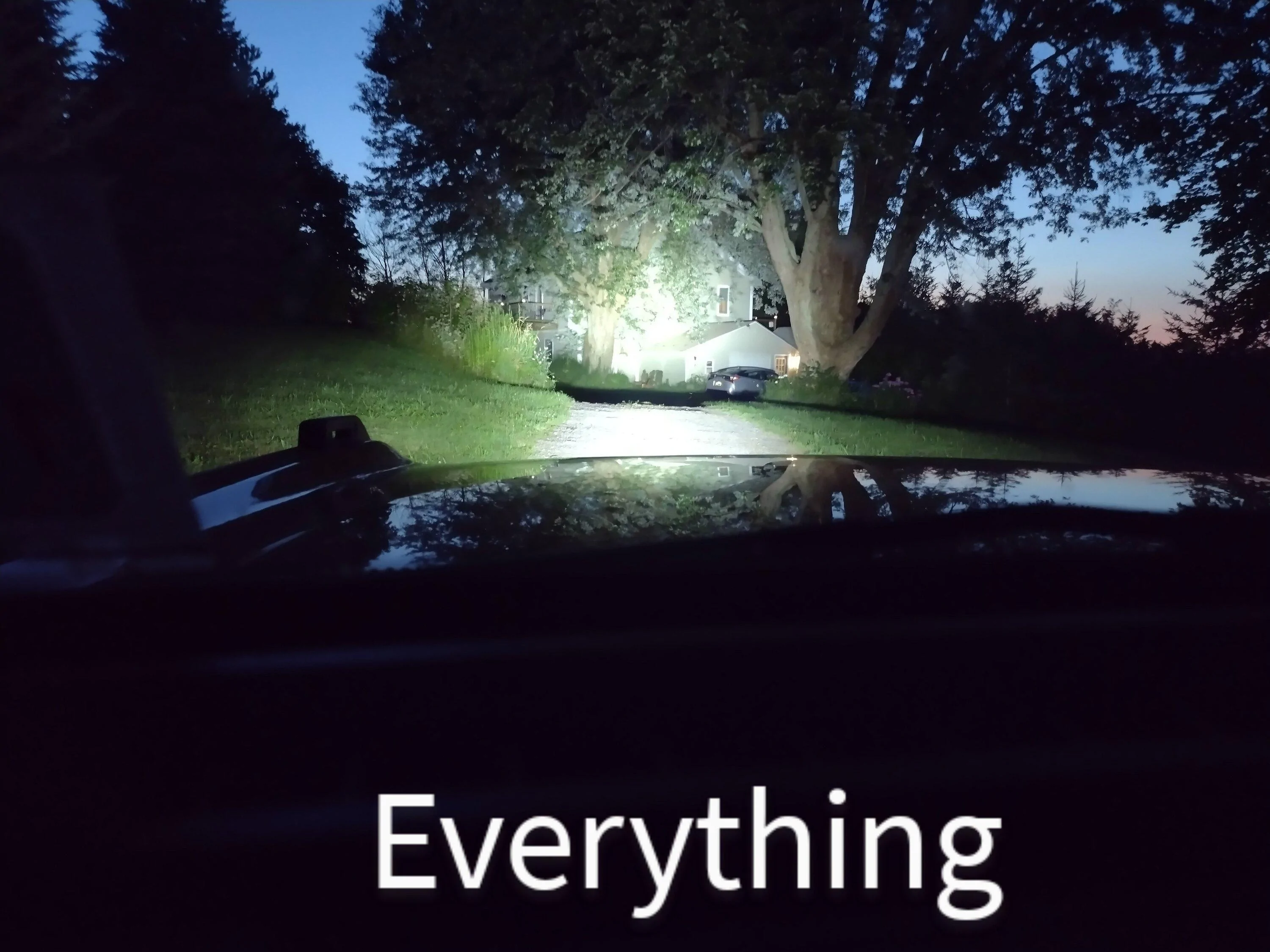

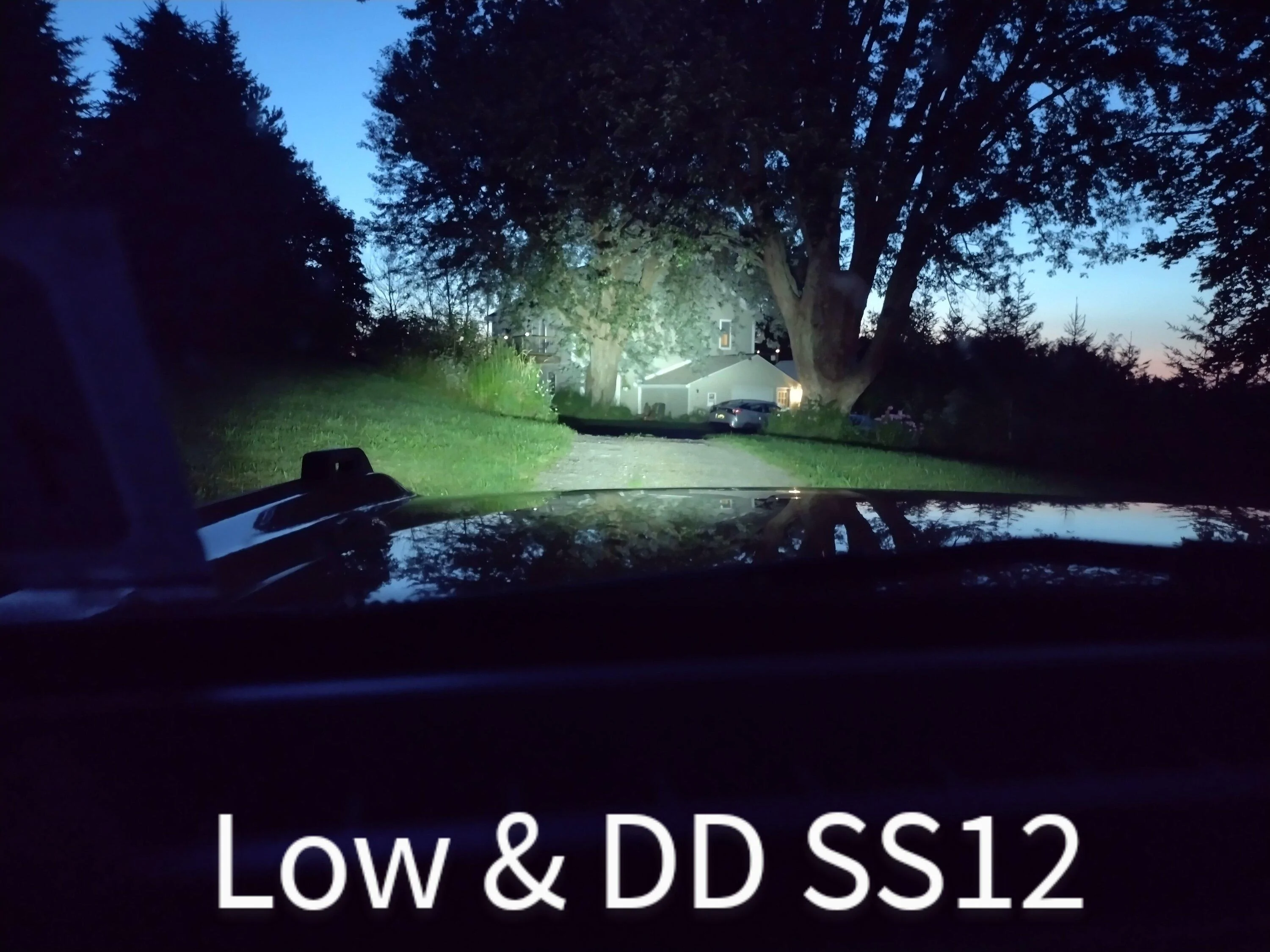

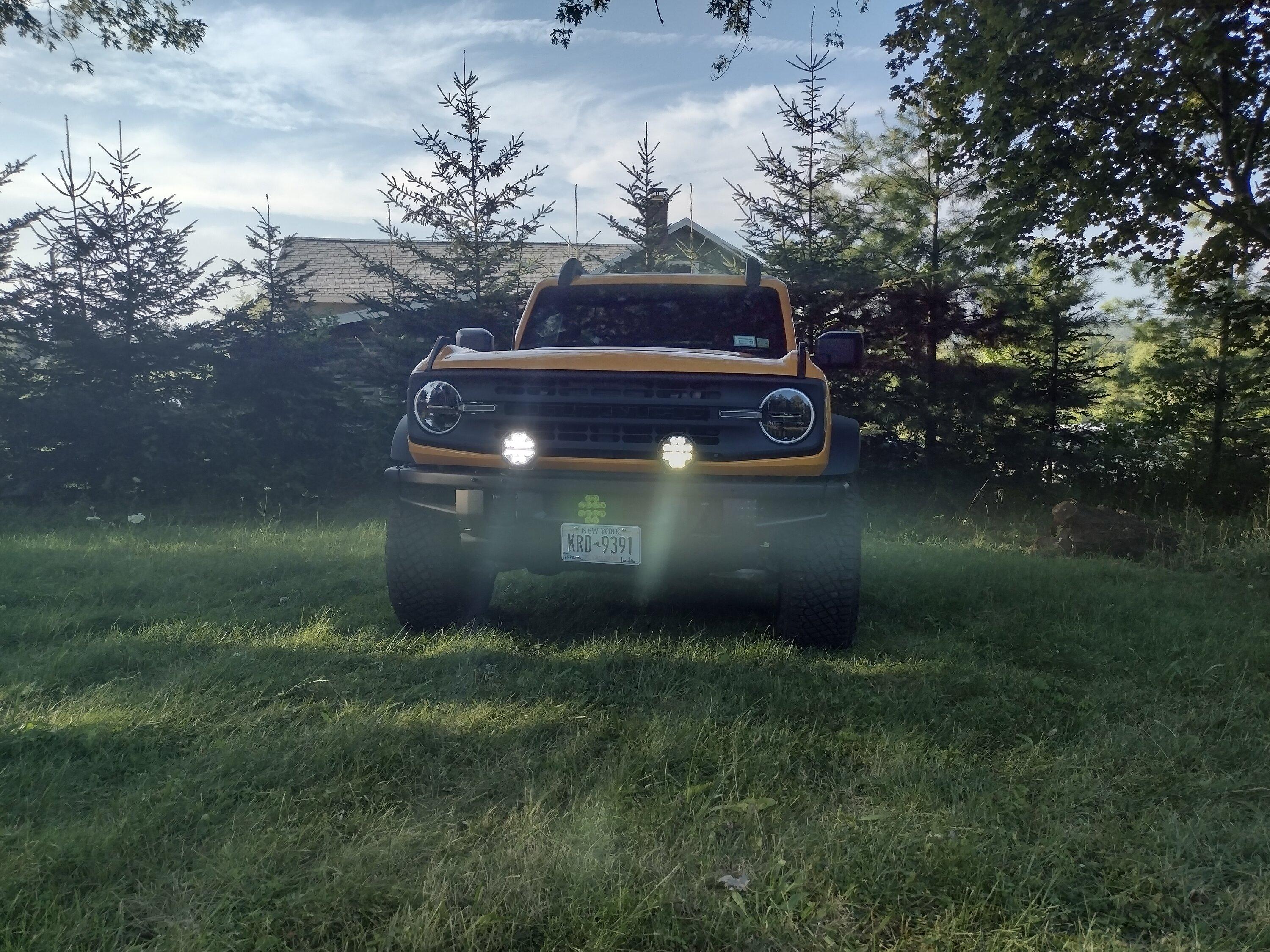

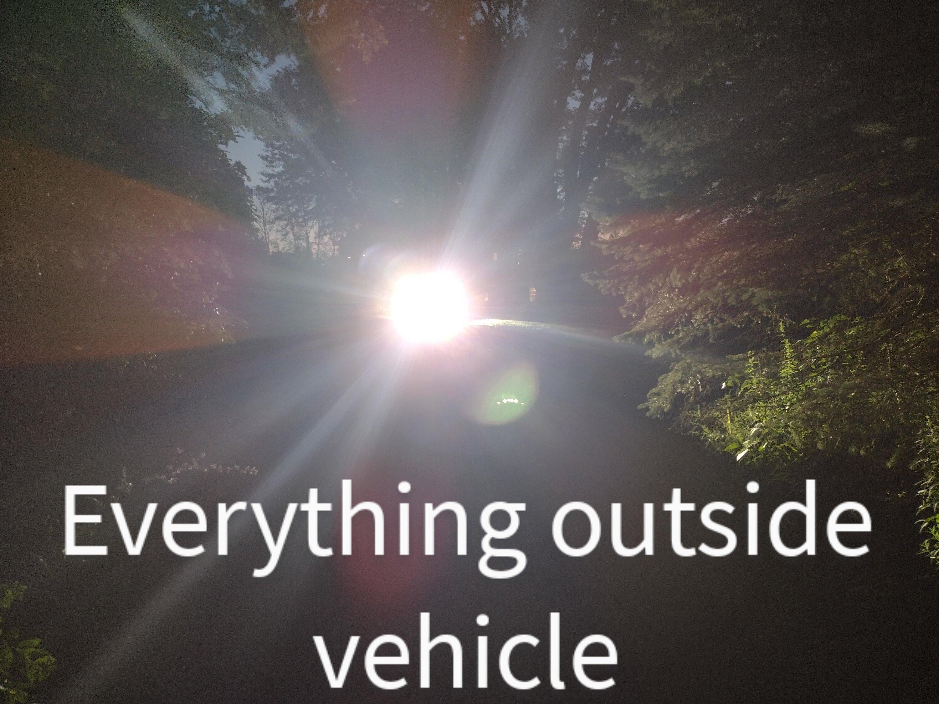

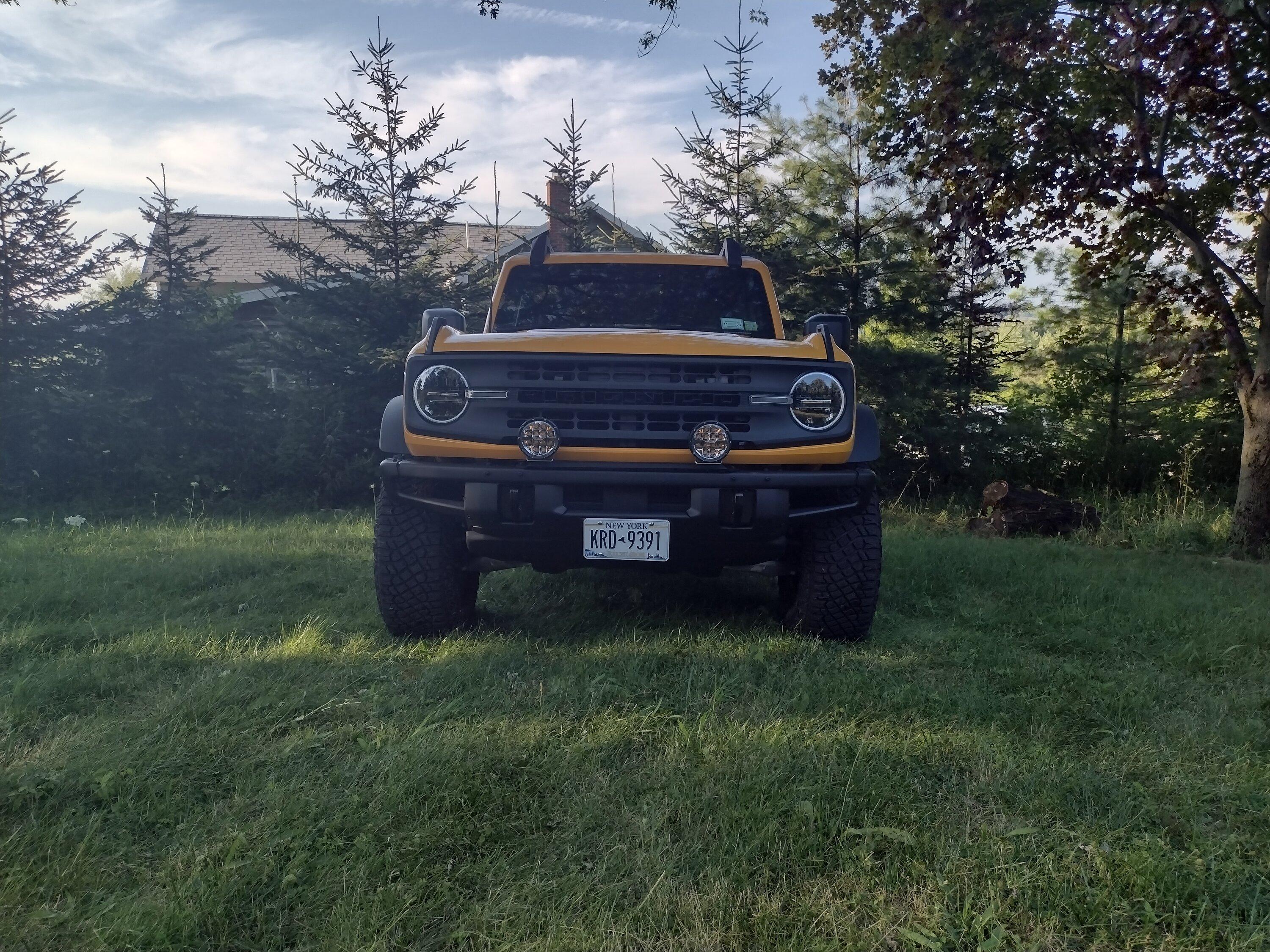

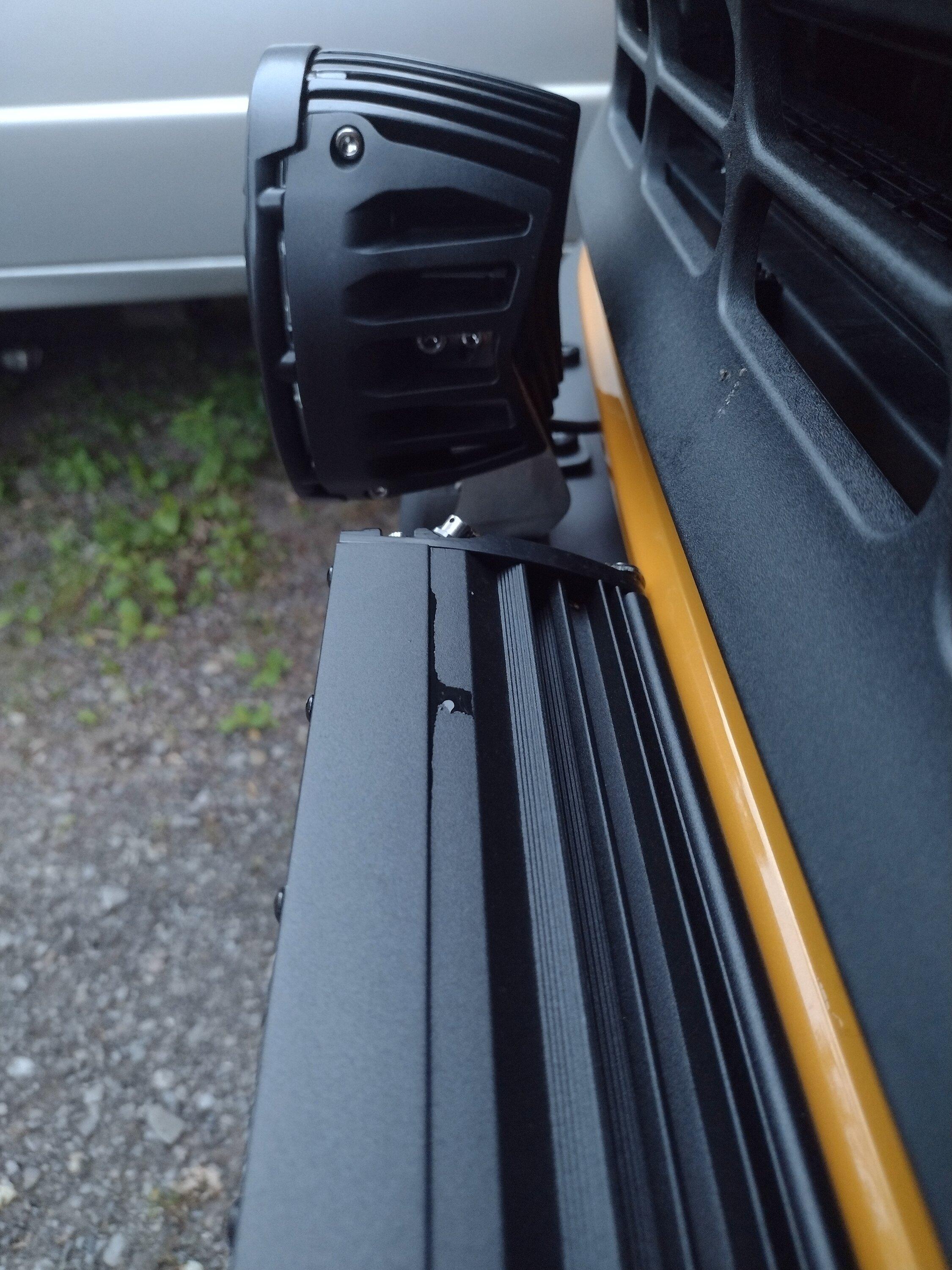

Got the Rigid 360 6" Spots and Diode Dynamics SS12 DOT Driving mounted and aimed.
The tree in the background is about 200 feet away, and the shot outside the vehicle at the end is also about 200' away

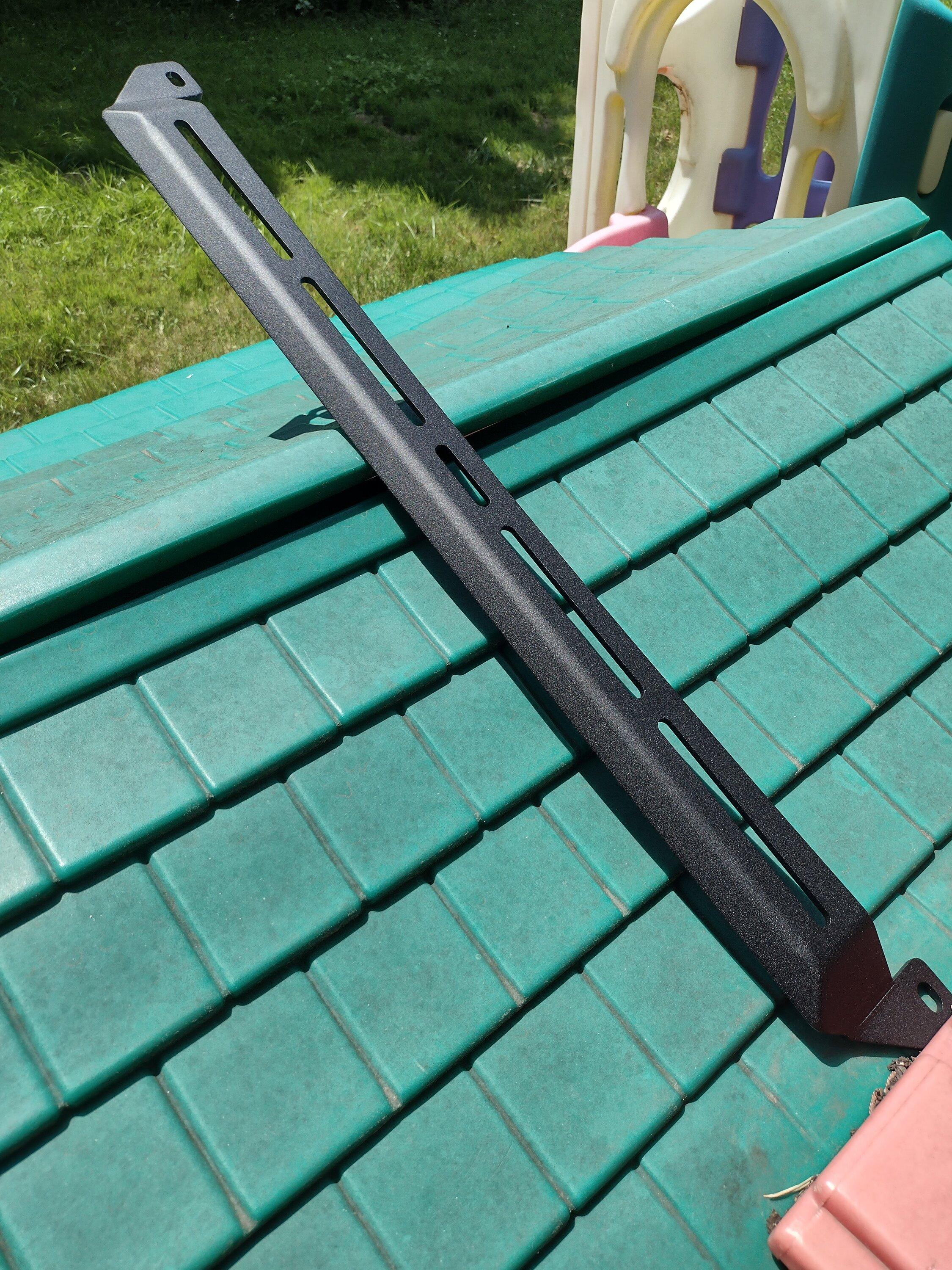

Forgot to post photos between lights and grille. About 7/16" behind Rigid & I can slide a dollar bill behind the DD.

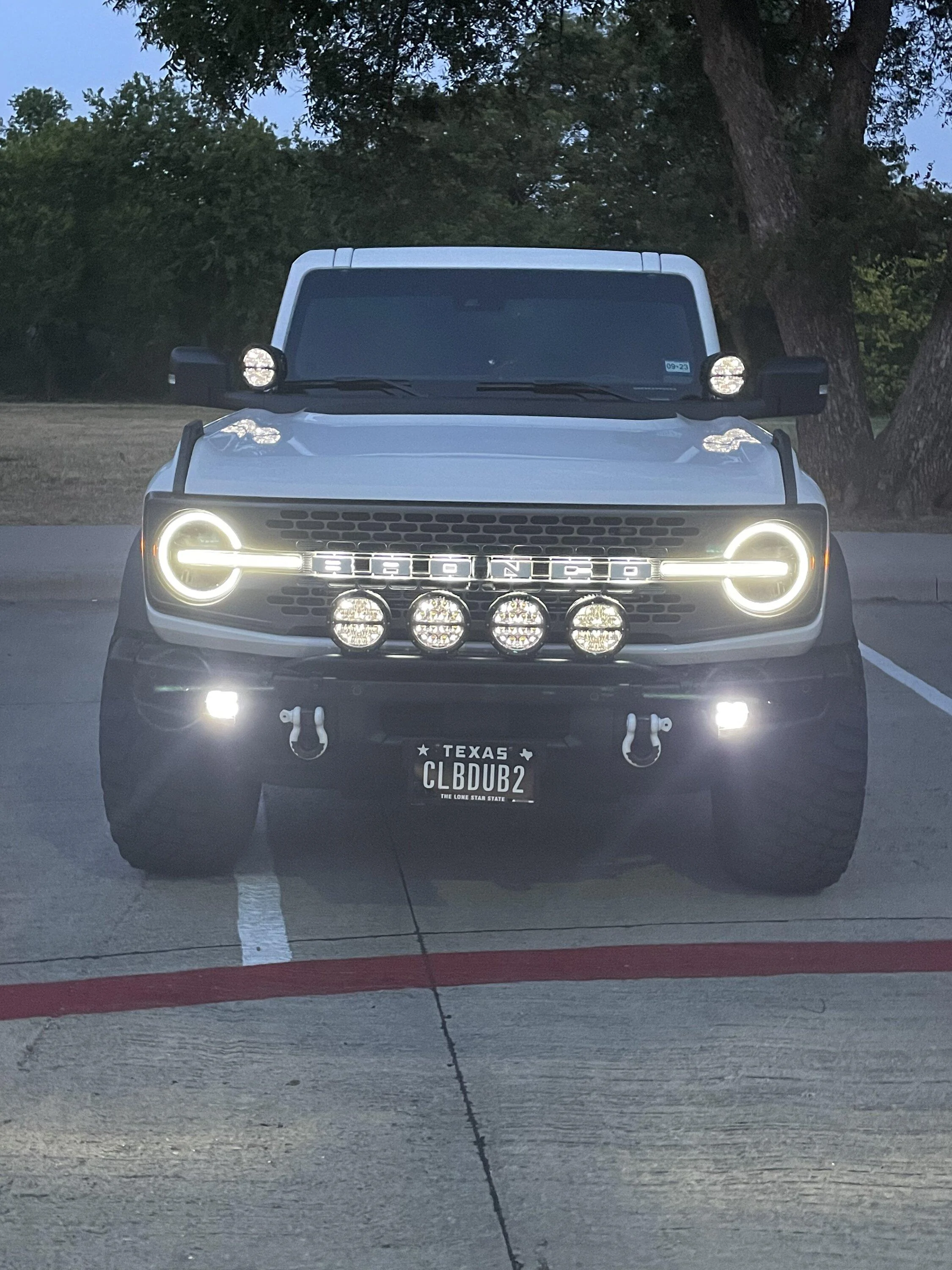

Looks good. I went with the Zroadz bar. Had to modify it a little to get the rigid to fit.

That's an awful lot of white there. Looks good though. I like the slim appearance of the Greenlane mount.
