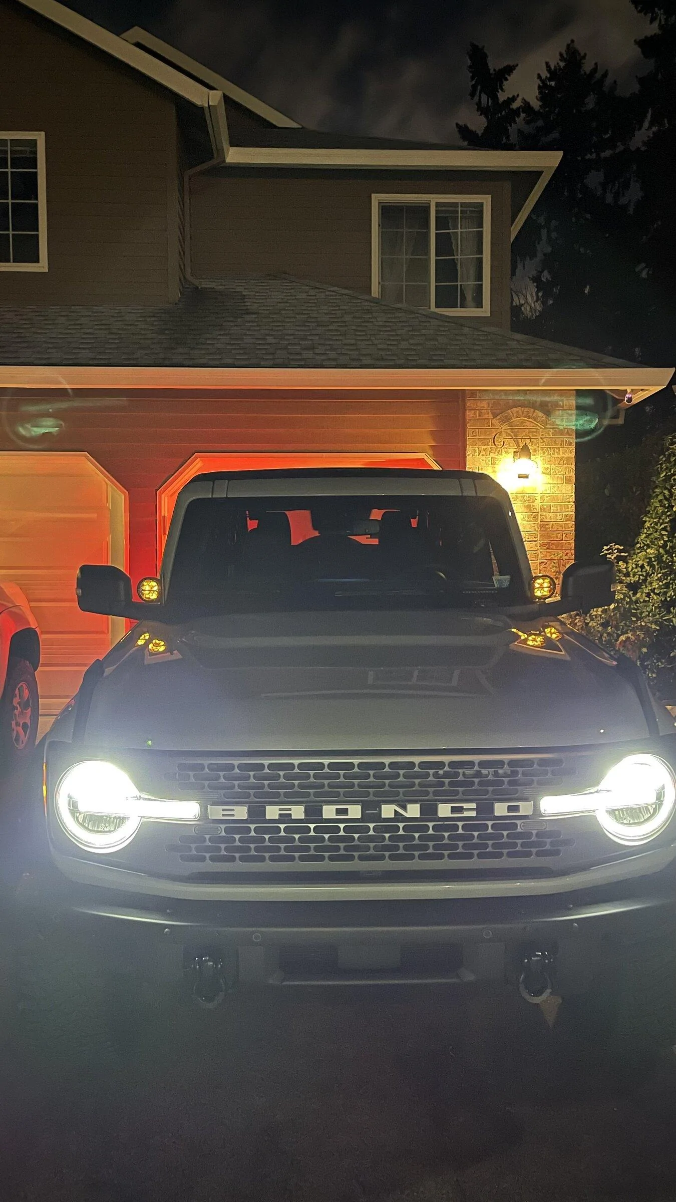

Thanks all. I went ahead and got everything hooked up and installed. If anyone have any questions reach out.
Ford Bronco Rigid 360 pod with backlight 094CA044-06DB-42BB-A243-BE7E9A8A026B
Looks good! Did you have to buy anything outside of the kit (brackets, washers, screws, wires, etc?). If you did, can you post links to everything you bought?
Also, what AUX switches are you using for the main lighting and for the backlighting.

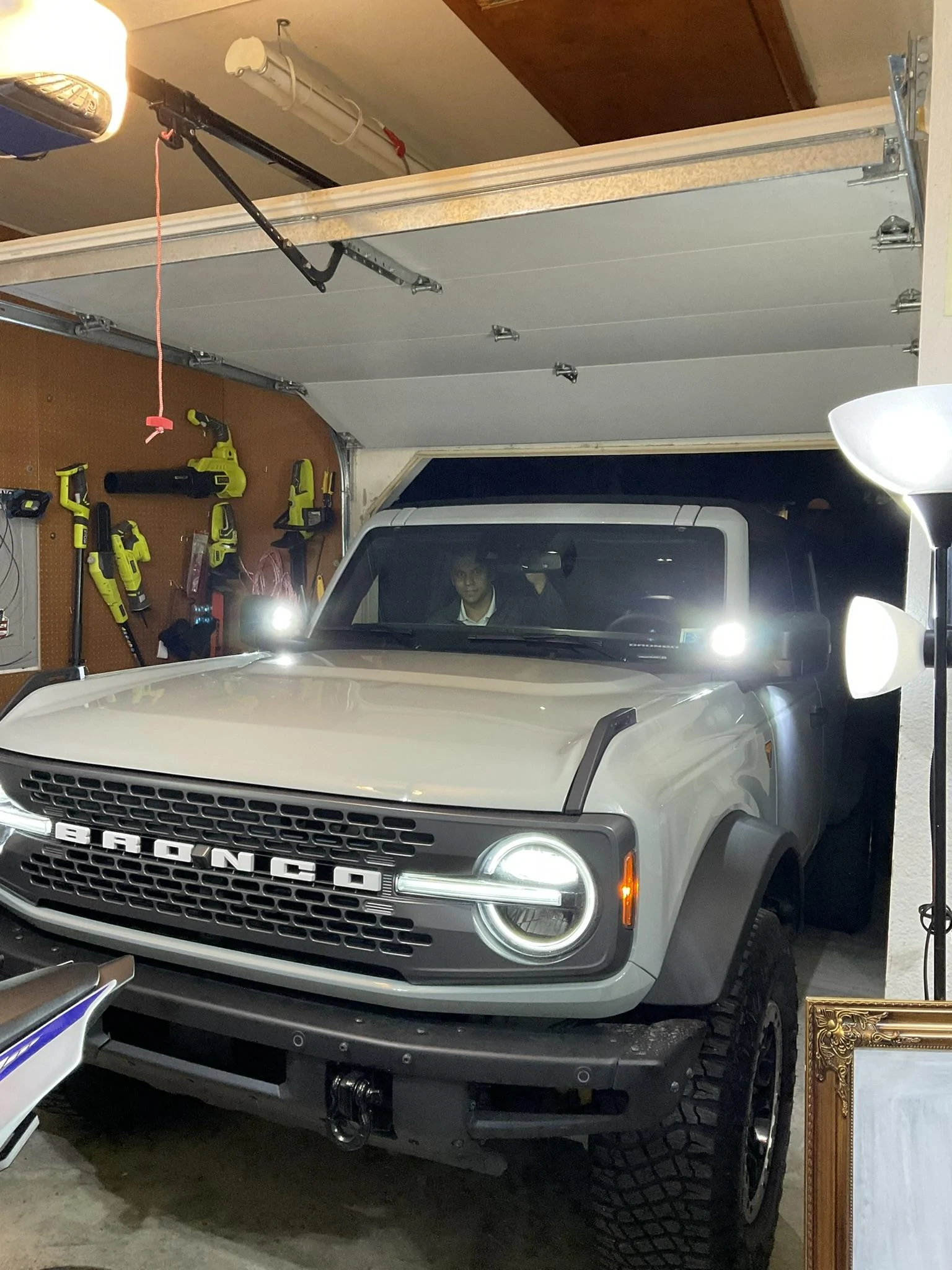

Ford Bronco Rigid 360 pod with backlight 3C929612-C165-44EB-BAFF-11CDBE758F24

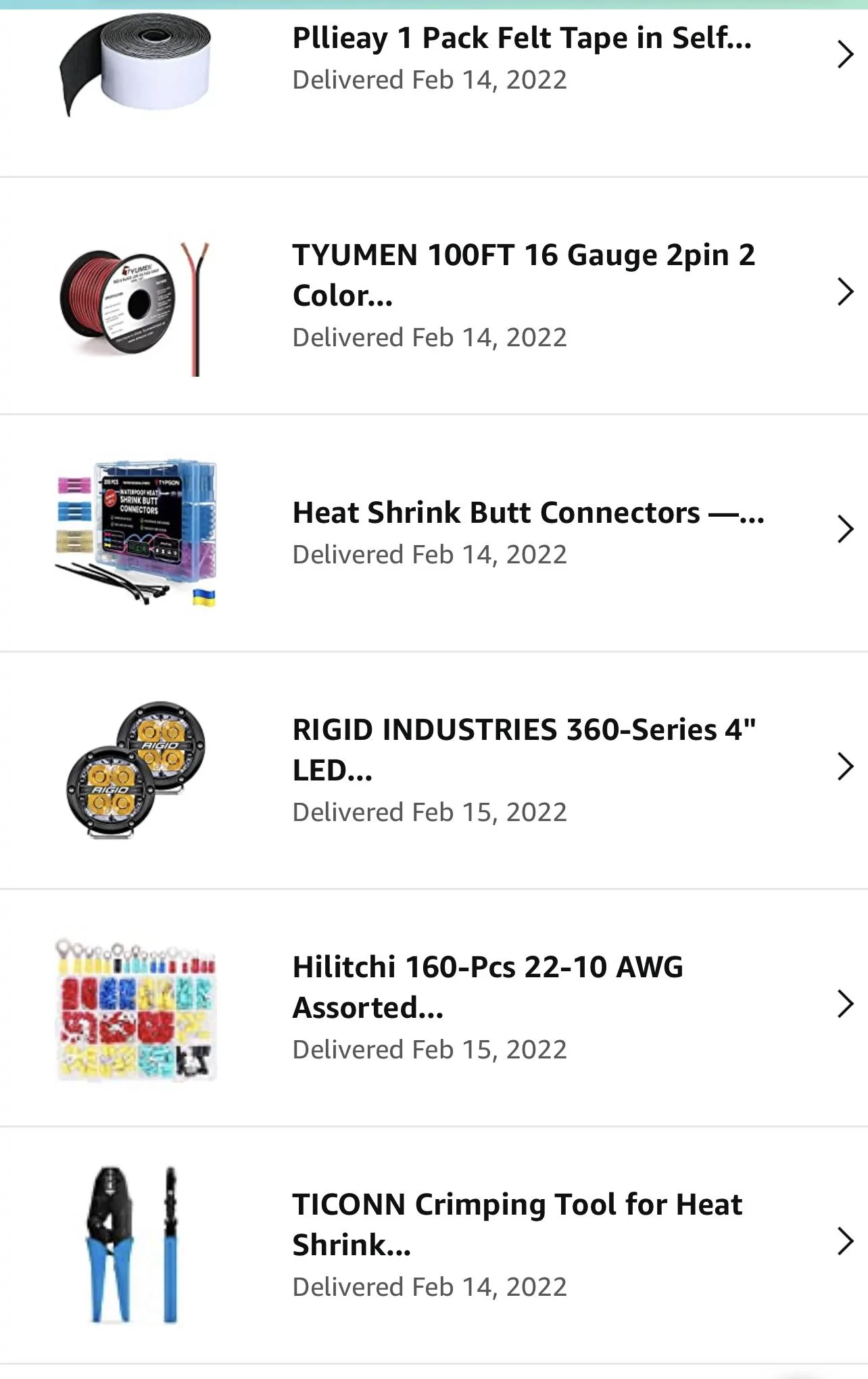

Looks Great! I finally got my Bronco earlier this week and I'm ordering the Rigid lights soon (not the Ford performance because I want the backlight). What did you buy separate from the Rigid lights to make this all work? Just wire (what gauge) and connectors?

I see you got a 2-pin 16 gauge wire. Doesn't the Rigid light have 3 wires for hookup? Two wires for the light and one wire for the backlight? How did you hook up all 3 wires?
