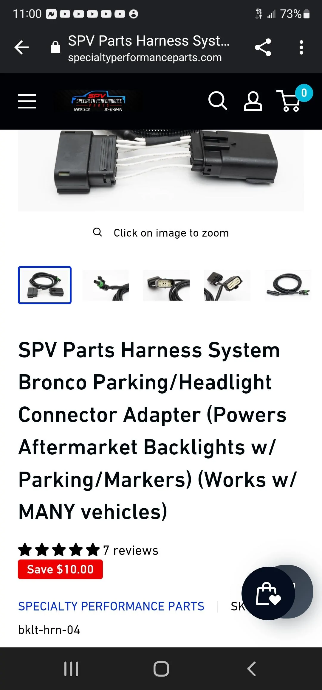

Have you looked at this yet? Plug and play harness from SPV that hooks directly into headlight and the backlight feature works whenever marker lights are on. I just recently installed this with my Rigid lights and I am very happy how it turned out! I will be taking some pics this week to post. John with SPV is very helpful if you have any questions.
https://specialtyperformanceparts.c...s-w-many-vehicles?_pos=9&_sid=2e73d015f&_ss=r
Oh man I think this is exactly what I am looking for! I will have to reach out to John thanks for the heads up!!!

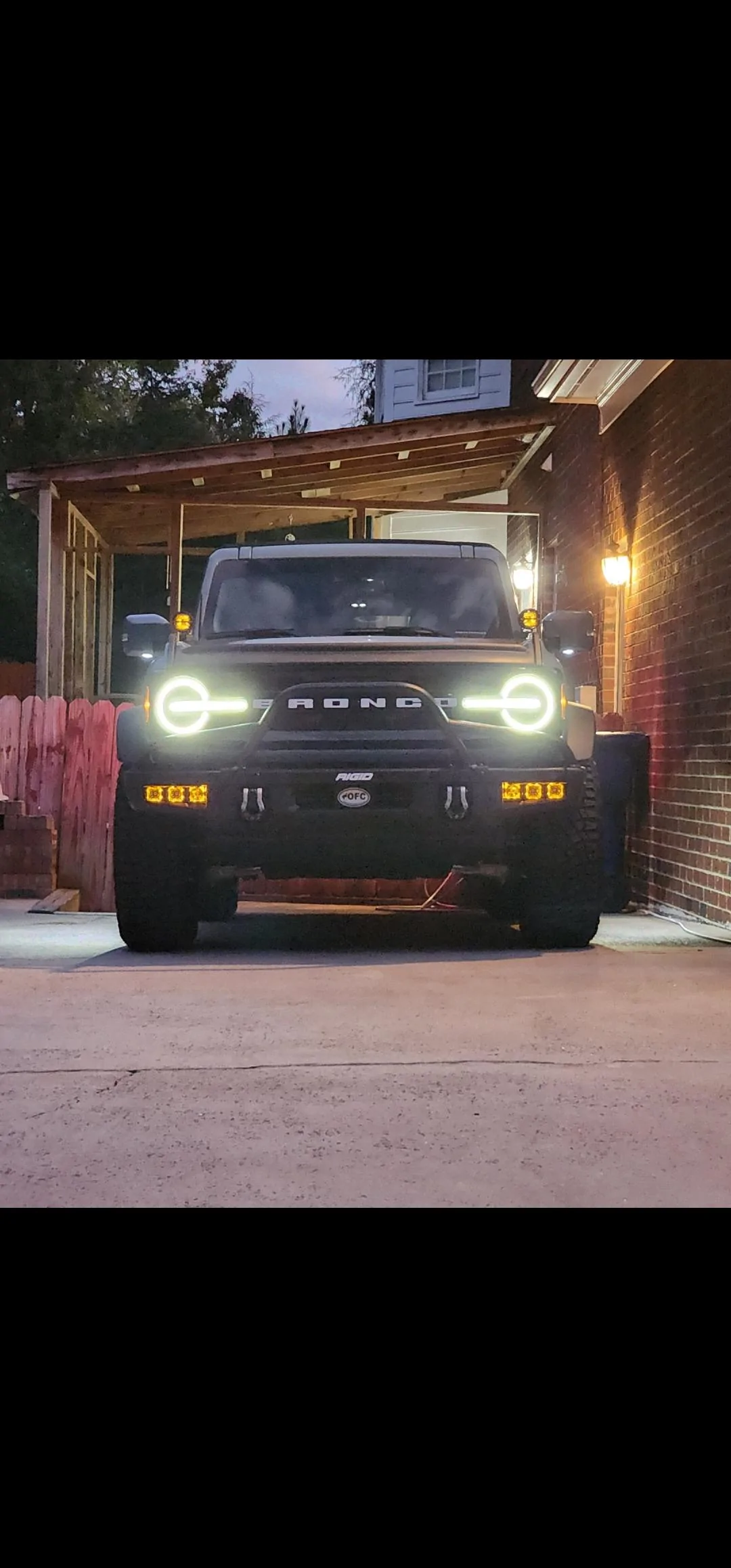

Here's a link to John's utube channel and there is a few great detailed videos on installs including that marker adapter and installation of rigid fogs and ditch lights.
John is extremely helpful and SPV is a great place to purchase from. He helped me during my install to answer questions I had and he also went out his way on a weekend to call me when I had another question for him. Customer service with SPV is beyond awesome. John is also the owner as well.
Here is a pic on how mine turned out. The amber backlight works directly with marker lights. So when you hit the unlock button on key fob your backlights will come on. I really like how easy the install was with that marker adapter!
I can’t get this link to work at all

Works when I click on it. Maybe just go to Specialtyperformanceparts.com and search for there bronco parts. Pretty easy website to navigate. That part particular is the marker light harness adapter.
