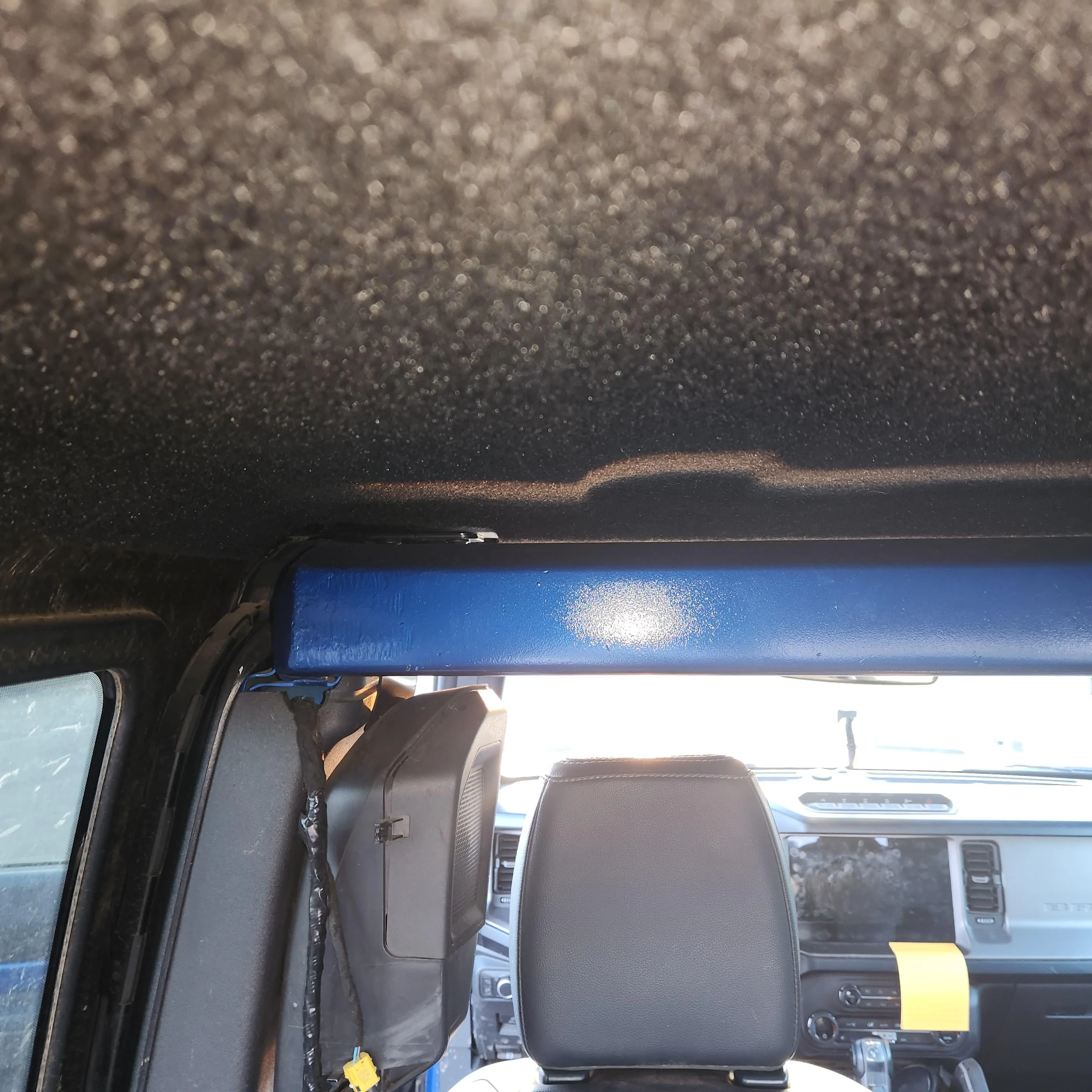

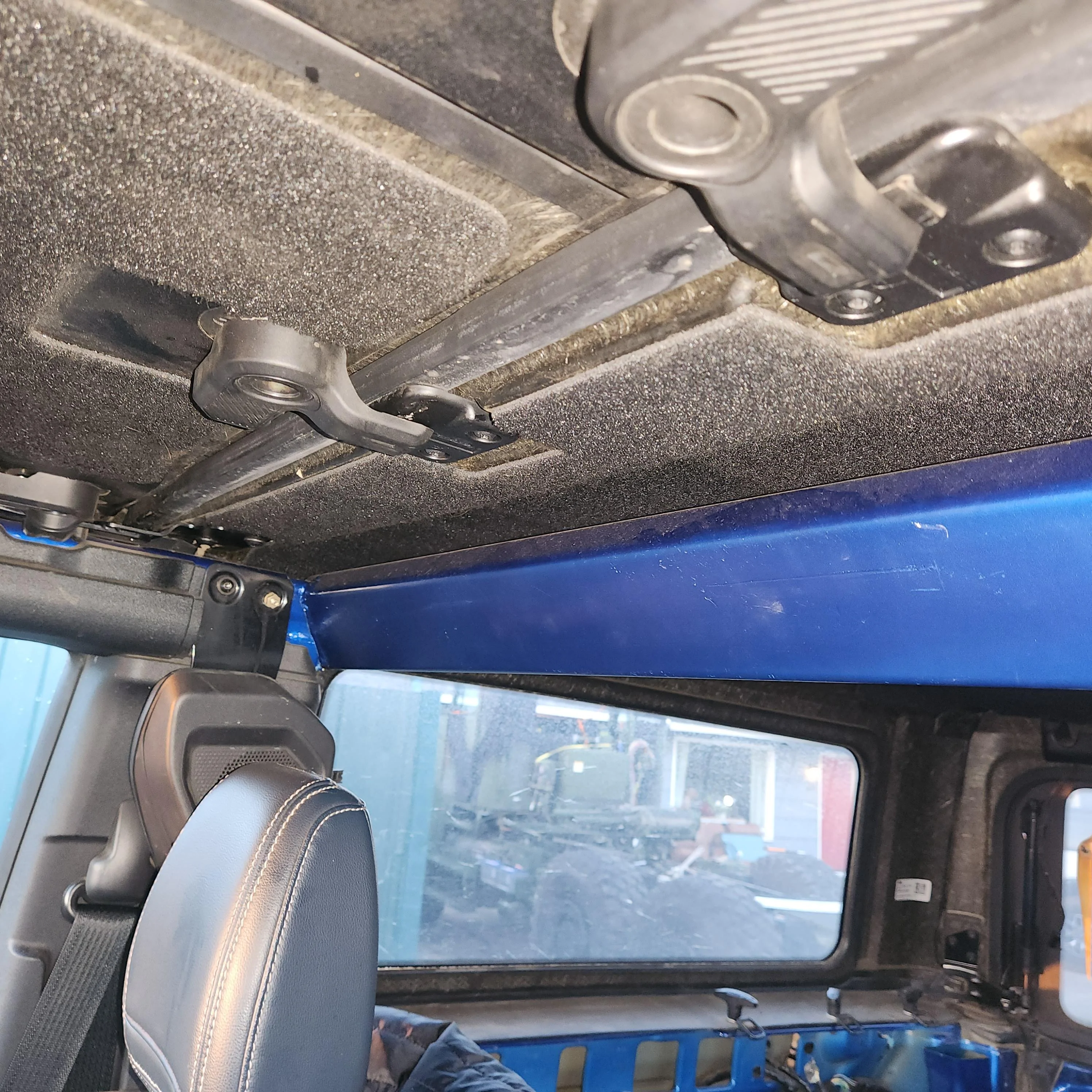

I have experience with this. All the naysayers are clueless. I hacked off mine behind the B-pillar and used a factory rock slider for a new cross bar. Made 'inserts" at both ends so the crossbar slides into the existing roll br stubs. Added aircraft bolts for rigidity. I say go for it build it however you want!!! On my half cab, I can still use the original top too, and it has ALOT more space back there w/out the goofy roll bar.
It's plenty strong and looks great.
HAHA!! I KNEW Someone out there did it !!
So you didnt just relocate the back cross member forward, you cut the roll bar off from the back of the seats in a 2 door - and then fabbed up a new cross bar behind the seats??
MORE PICS PLEASE!!!
Top-Off pics? Interior from the rear Pics?
Anything!! THANK YOU!!!!
