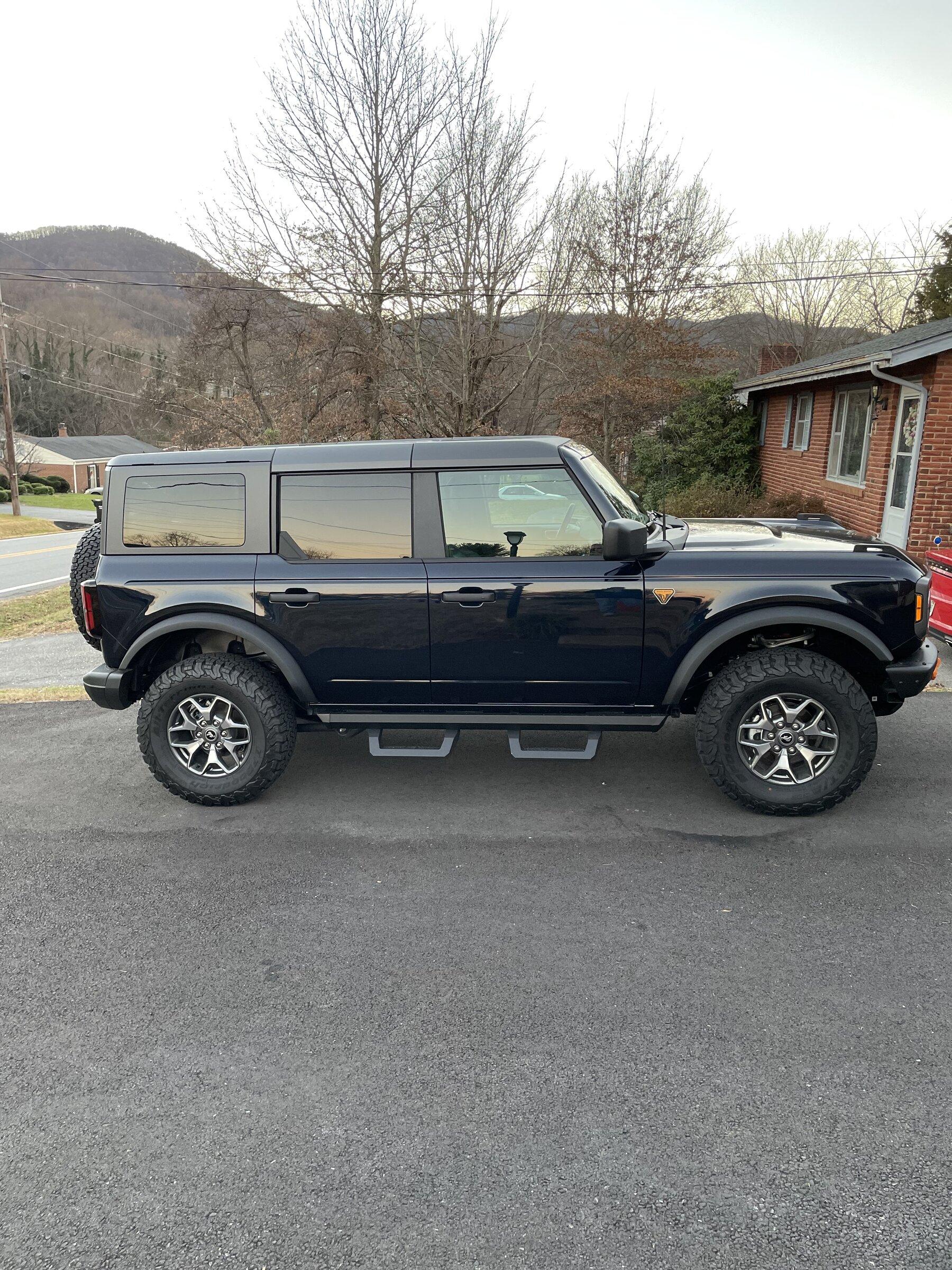

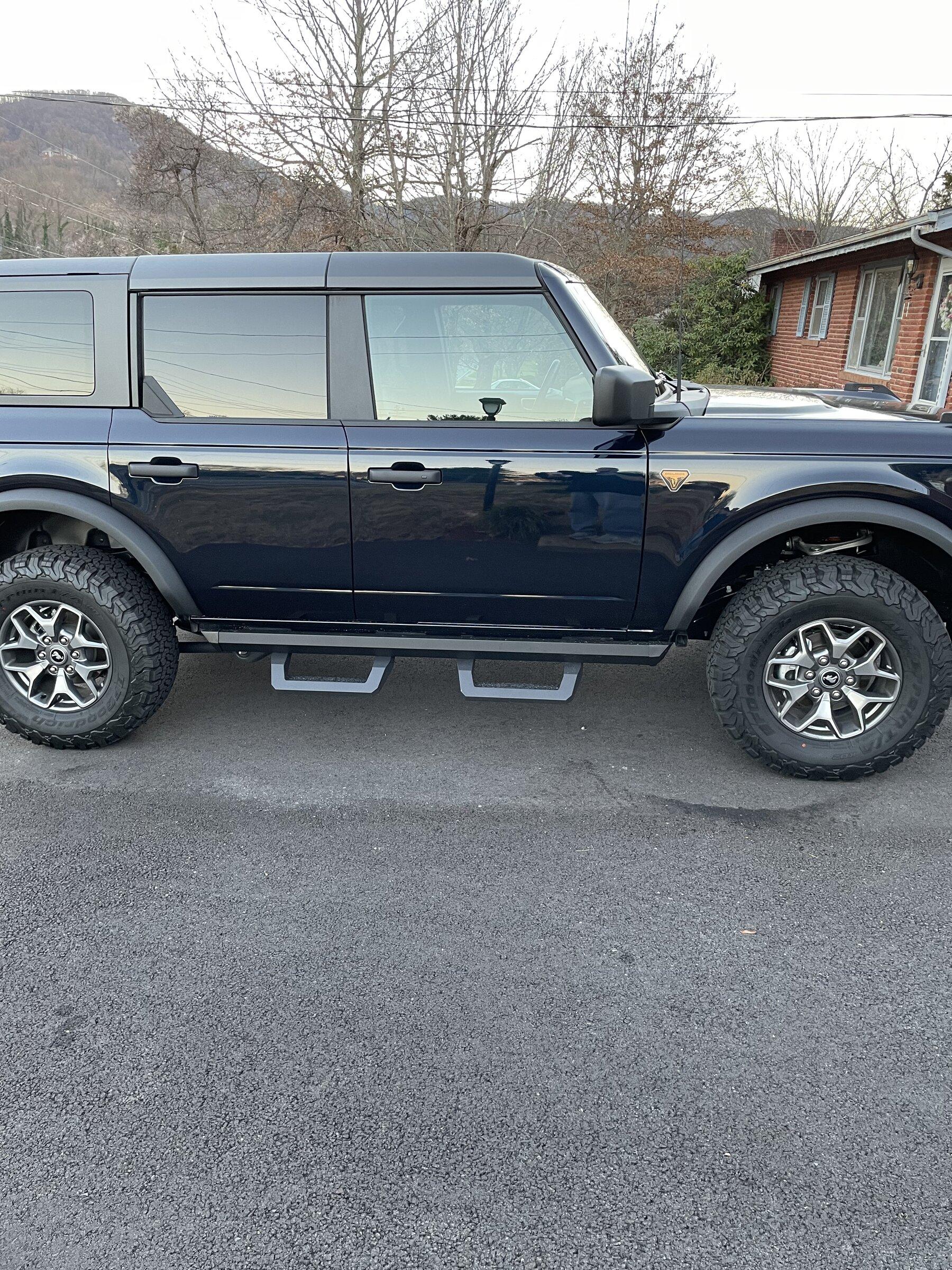

I installed the Sr2 rails with steps. Family could not get up into the Bronco.
super easy to install. Mounts to same holes as factory rock rails.
I will post pictures tomorrow.

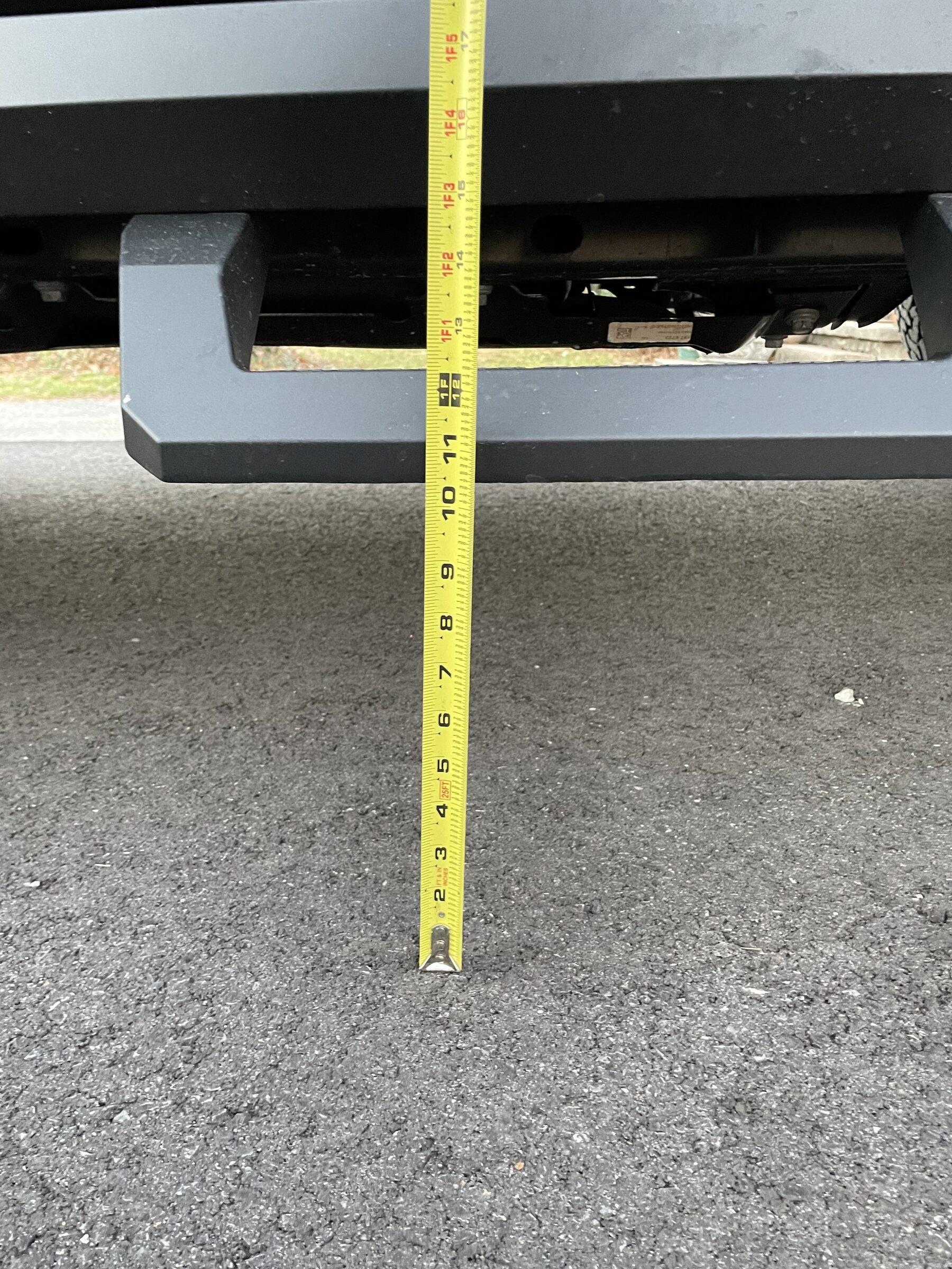

Great timing as I was just looking at these on line. When you get a chance, could you please post pics and provide some measurements, especially to the bottom of the steps to see the ground clearance? Thanks!

The steps are 10 and 1/2 inches off of the ground.
They are adjustable side to side so you can put them in the exact spot you want.
Also they are removable, but you have to take the whole bar off and apart to remove the steps. So if you are planning to remove steps for off road use. You will have to take time to remove the whole thing.
Hope this helps.

Is it the photo or is the lowest point of the step below the centerline of the axle? That is going to severely reduce the breakover.
It’s the angle of the photo. The step bottom is even with it.

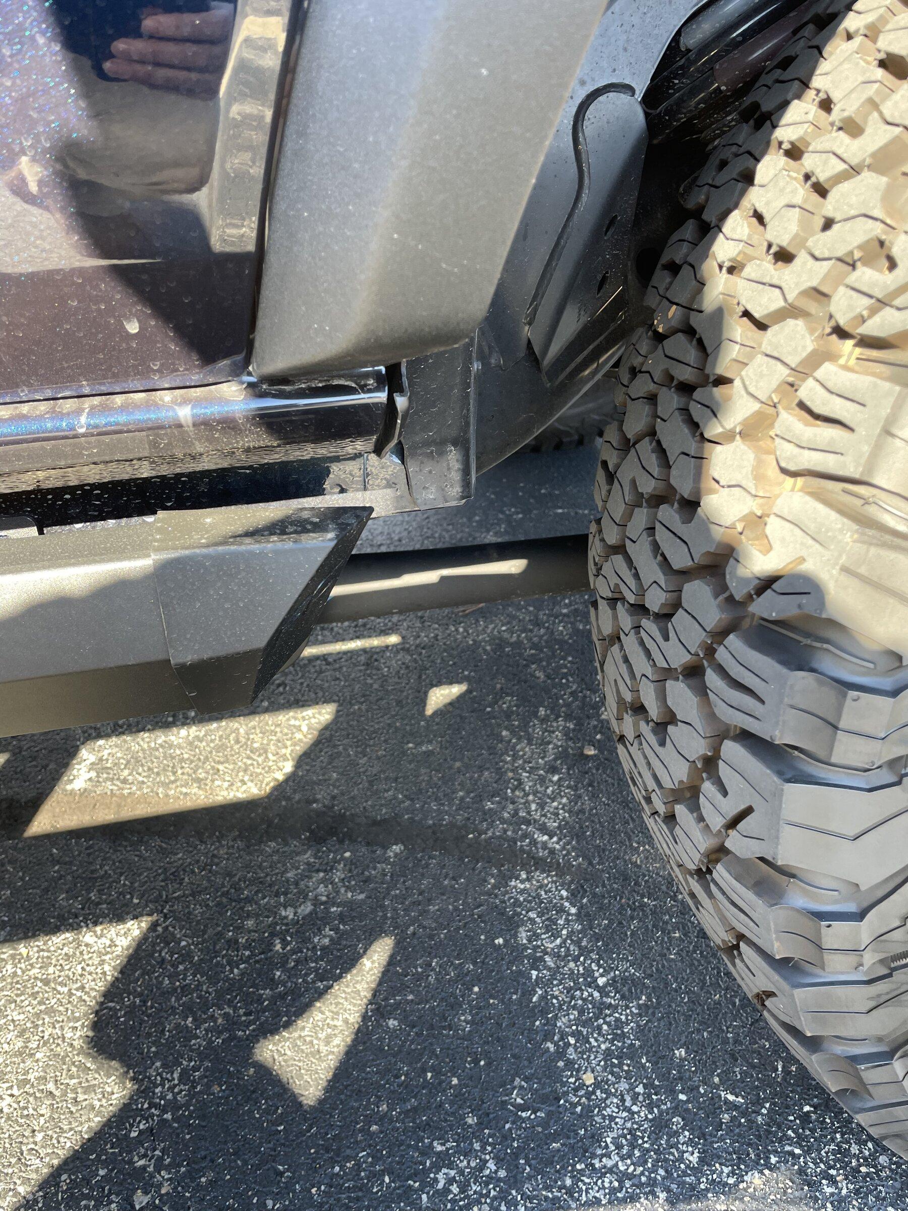

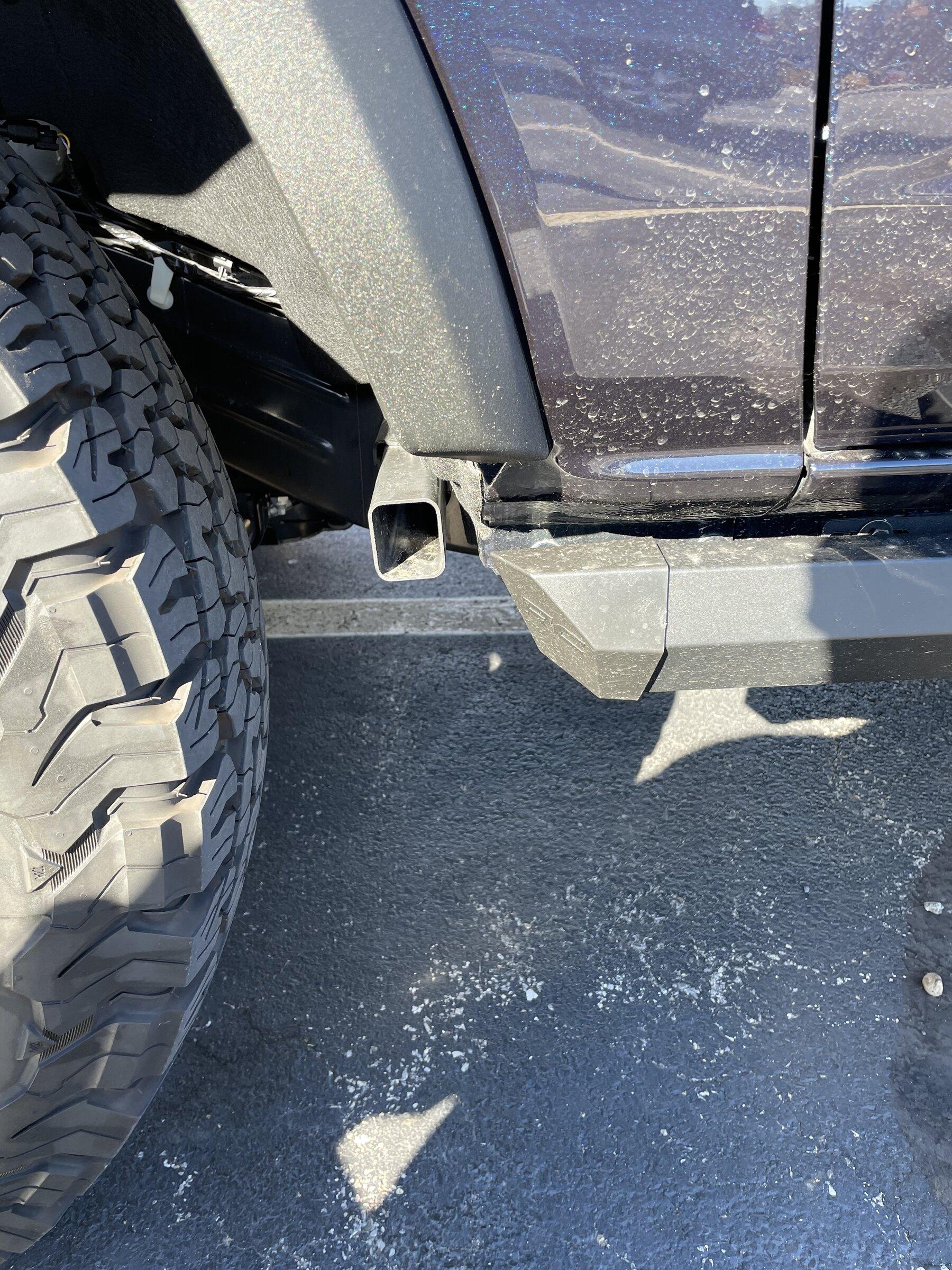

I was thinking about getting these...I am one of those fools buying ($$$$) the Gatorback mud-flaps WITHOUT the rockrail holes, because I want a cleaner look...I will be removing the rock rails but was thinking about these steps and wondering if they would fit with the non-hole Gatorback flaps....any thoughts on this??...love to have your input.
Perhaps a closer picture of the back that front wheel would help me if you have a chance
Much appreciated!!

I’ll post a picture tomorrow. Too dark now to get a good view. But from what I know by my install, they should work. The rails are adjustable front to back. I have mine pretty close to centered. But you could move them back to the rear about 3 inches and still look good. Also the front end cap could be removed to give another inch if you butt it up to the mud flap.

Top one is front wheel and bottom one is back wheel. So you can see more clearly. There is room to move front or back a few inches.
