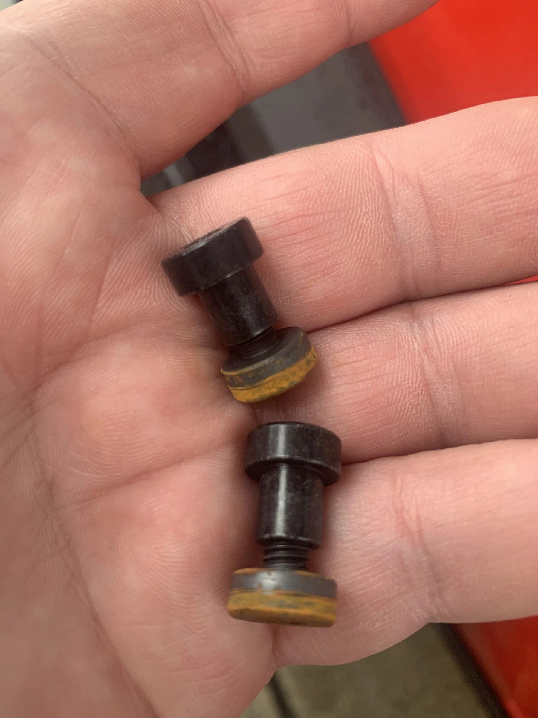

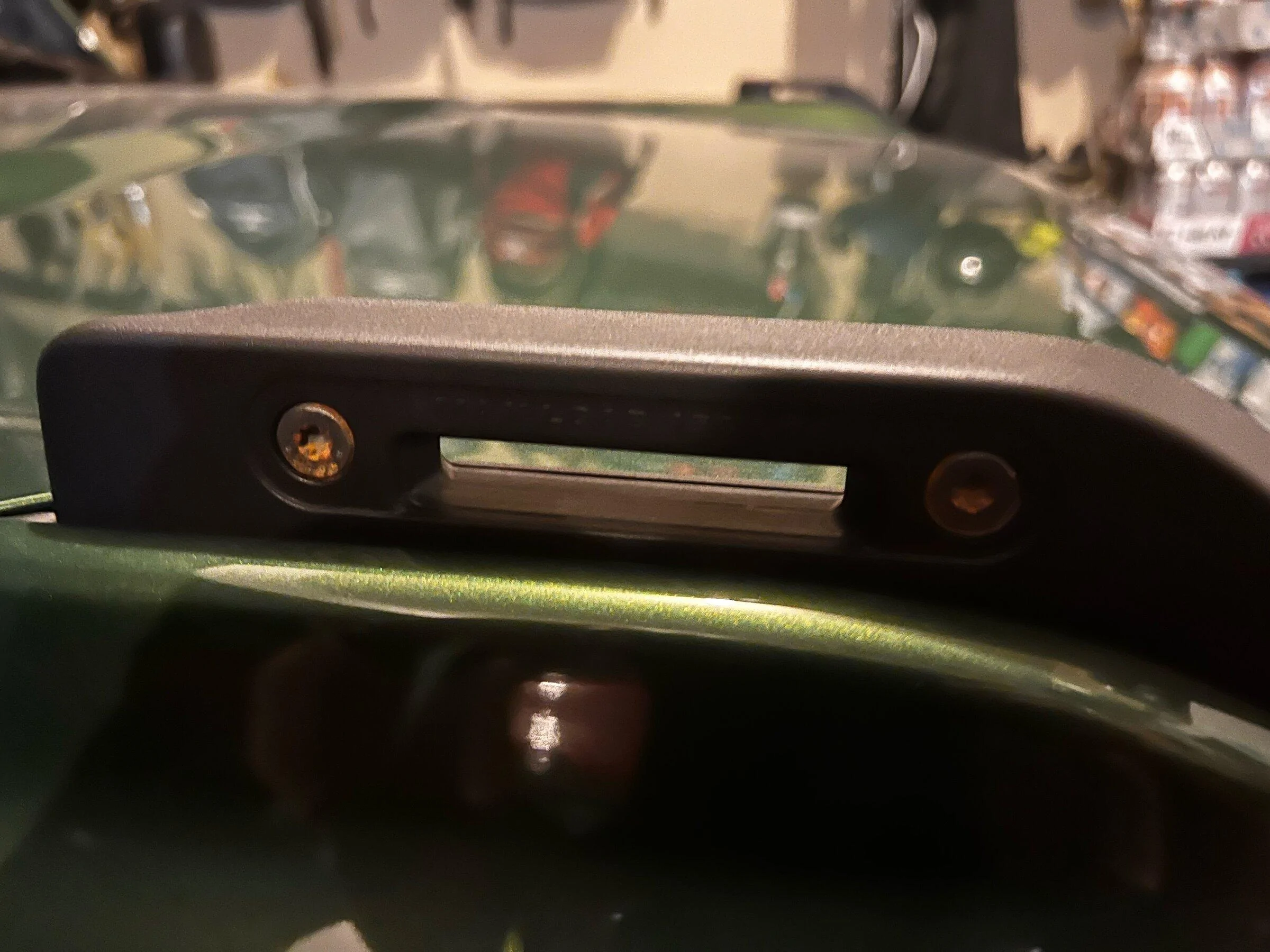

Picked up my 4dr wildtrak on Thursday 3/3 and today I noticed the same issue! Has anybody gotten an answer from the dealership yet?
I picked mine up on 3/4. Asked the dealership to order replacements before signing the paperwork. They said they can't get just the bolts. They need to order the entire trail sight assembly. I bet that requirements changes soon.
I took my screws out when I got home, sprayed them with rust remover, scrubbed with brass wire brush, and coated them with Fluid Film. They'll look fine until the replacements arrive.

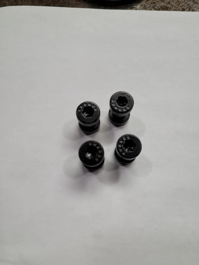

Mine were doing the same, rusted at pickup. It wasn't worth the gas to drive back to the dealer.. I ended up sandblasting mine and putting them in with a batch of powder coating I did over the weekend.
It won't take much to rattle-can them as well. If you go to the hardware store, good luck finding a flush-mount hex stamped 'bronco' :)

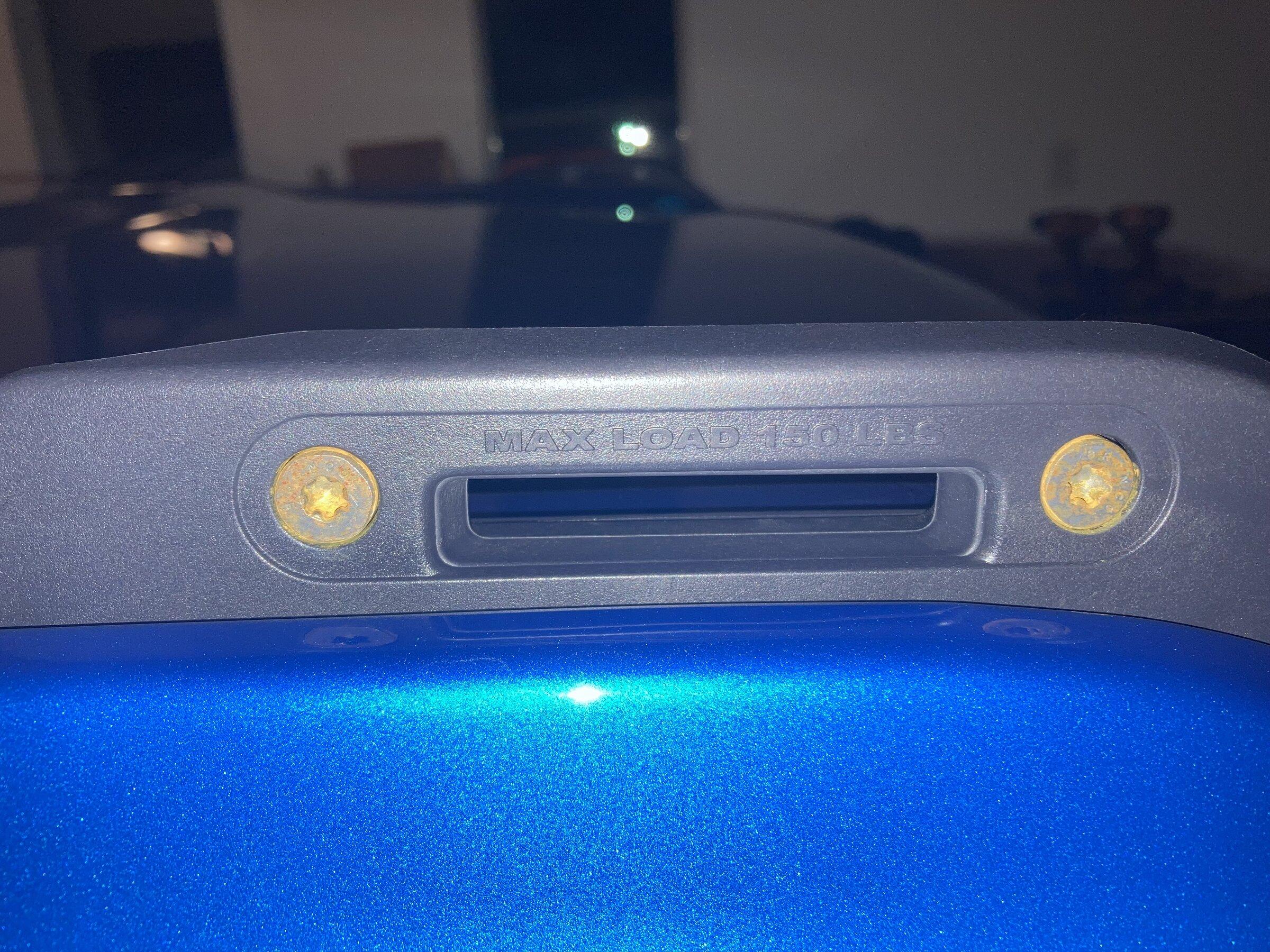

@Ford Motor Company this isn't a one person issue. Picked up from the dealership on Tuesday 3/15.
