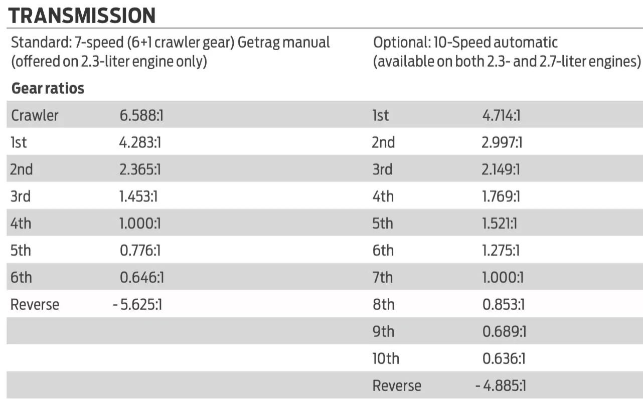

It’s all about matching the gearing to the tire size to get a decent highway RPM and giving it the torque to start rolling off the line. Keep in mind that CAFE fleet fuel economy standards drive many of these choices. I’d surmise that engineers designed the system to use the ultra low gears compared to what was done 30-40 years ago because of the significant overdrive gearing available in today’s transmissions, .636:1 in the automatic and .646:1 in the manual. These very high overdrives require lower axle ratios to maintain drivability in their top gear on the highway. I think the 3.73 in the base automatic is too high for the highway, but the 10 speed can compensate. Looking at the first gear ratios of 4.714:1 in the automatic and 4.283:1 in the manual explains why the base auto comes with 3.73 and the base manual with 4.46.
With an automatic transmission axle gearing is more critical, because the transmission is programmed to operate within certain parameters that are dependent on a specific tire size. Too big of a tire without enough gearing is more drivable on a manual because the operator can engage the clutch slower and get it rolling and rev it higher before shifting.
As for the older Bronco’s, they came stock with a 28.9” tall tire and usually 3.55 axle gearing and in the case of a C6 or T-18, a 1:1 top ratio. The E4OD was a .71:1 ratio overdrive. As a person that built multiple FSB’s, axle gearing was certainly more critical with the E4OD automatic than my T-18 manual. My 96 was a dog on 35” tires, regearing to 4.88 was the solution. On my 87 on 35” tires I regeared from 3.55 to 4.10, it wasn’t as significant as I thought it would be and I was running 3200 RPM at 75 mph. The truck was certainly easier to get going from a stop with the lower gearing, so it saved clutch wear. The T-18‘s 6.32 first gear wasn’t used on the street, like the crawler gear on the new Bronco. With the M5OD‘s .080:1 overdrive I still would recommend 4.56 as a minimum gear with 35” tires, 4.10 isn’t enough. I always wanted to do a ZF5 swap in my 87.
