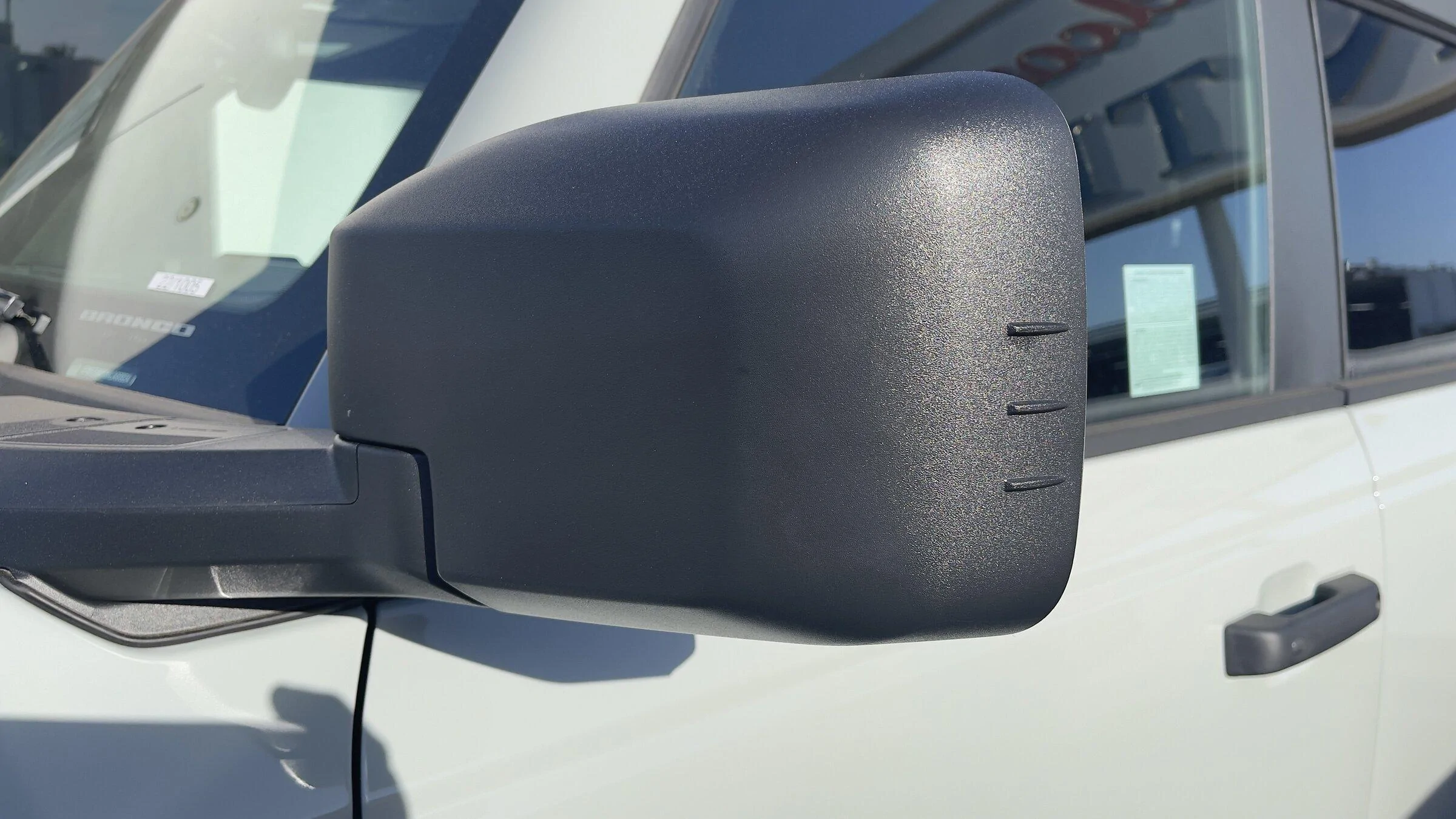

So I saw this at Galpn about a month ago and forgot to post it. Do new Broncos get this type of side mirror? With the fins? Note, it's also one piece.

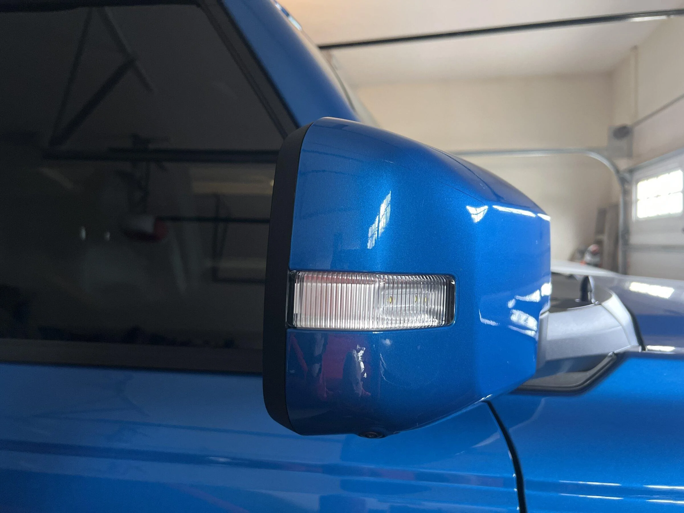

I was at the dealer for an oil change and saw this. But of course nobody knows what the fins are doing there. This is probably the fix for the whistle. I asked the parts department and they don't know shit. He actually asked me if I had a Bronco Sport. I'm going to schedule it for service and see if I can get them ordered.

The ones I posted above are a one piece. Note those ones are two piece. Painted vs. MIC I guess?

So a new mirror design on recent builds that does not include the indicator lamp?
Ford Bronco Side view mirrors whistle image
Maybe you don't need the fins. Does your Lux have the mirror whistle?

I do have a whistle, haven’t driven enough for it to bother me nor have I attempted to locate the source. Whistle occurs regardless of the position of the top so I assume it’s the header area, grill or mirrors.
