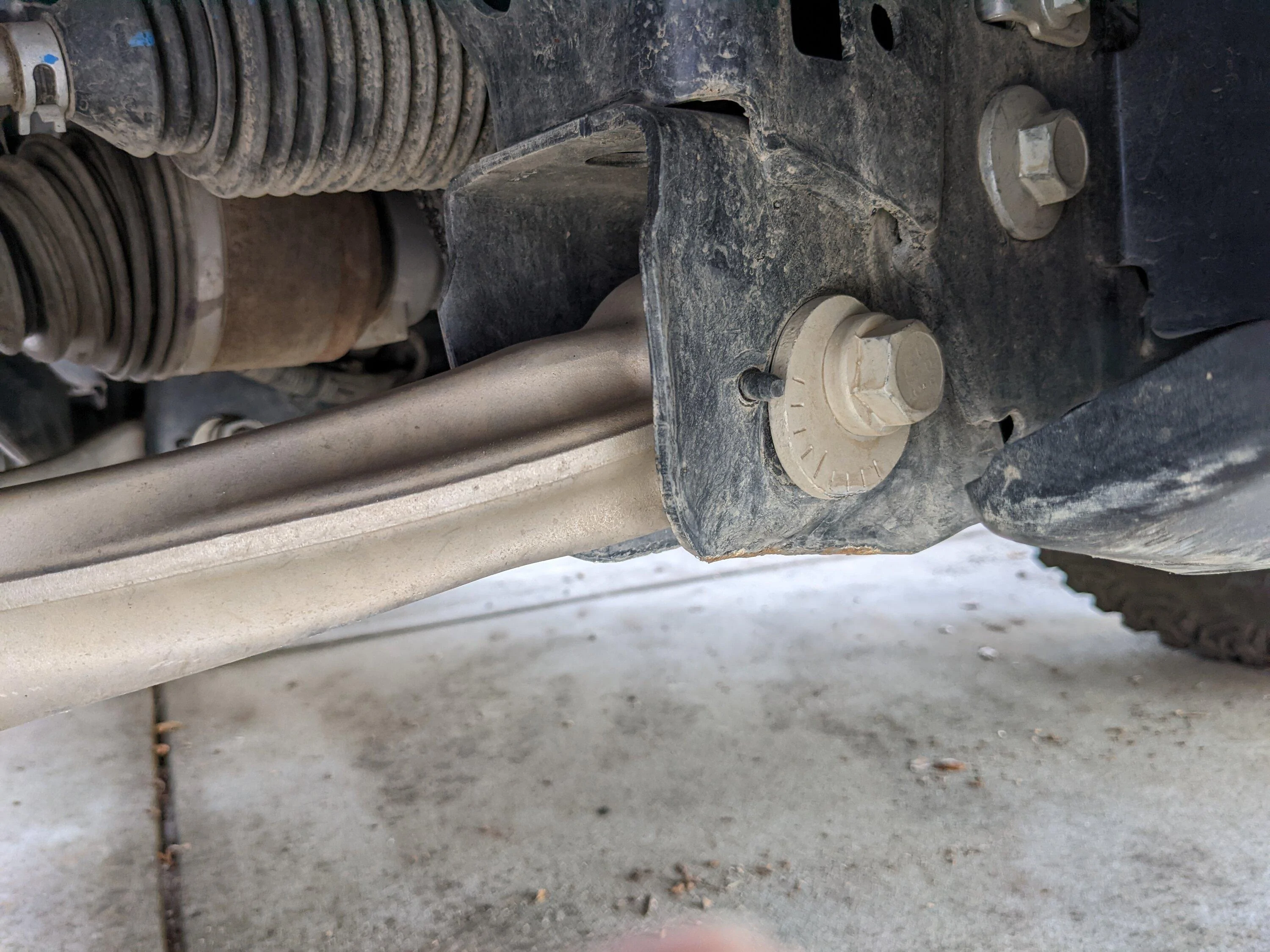

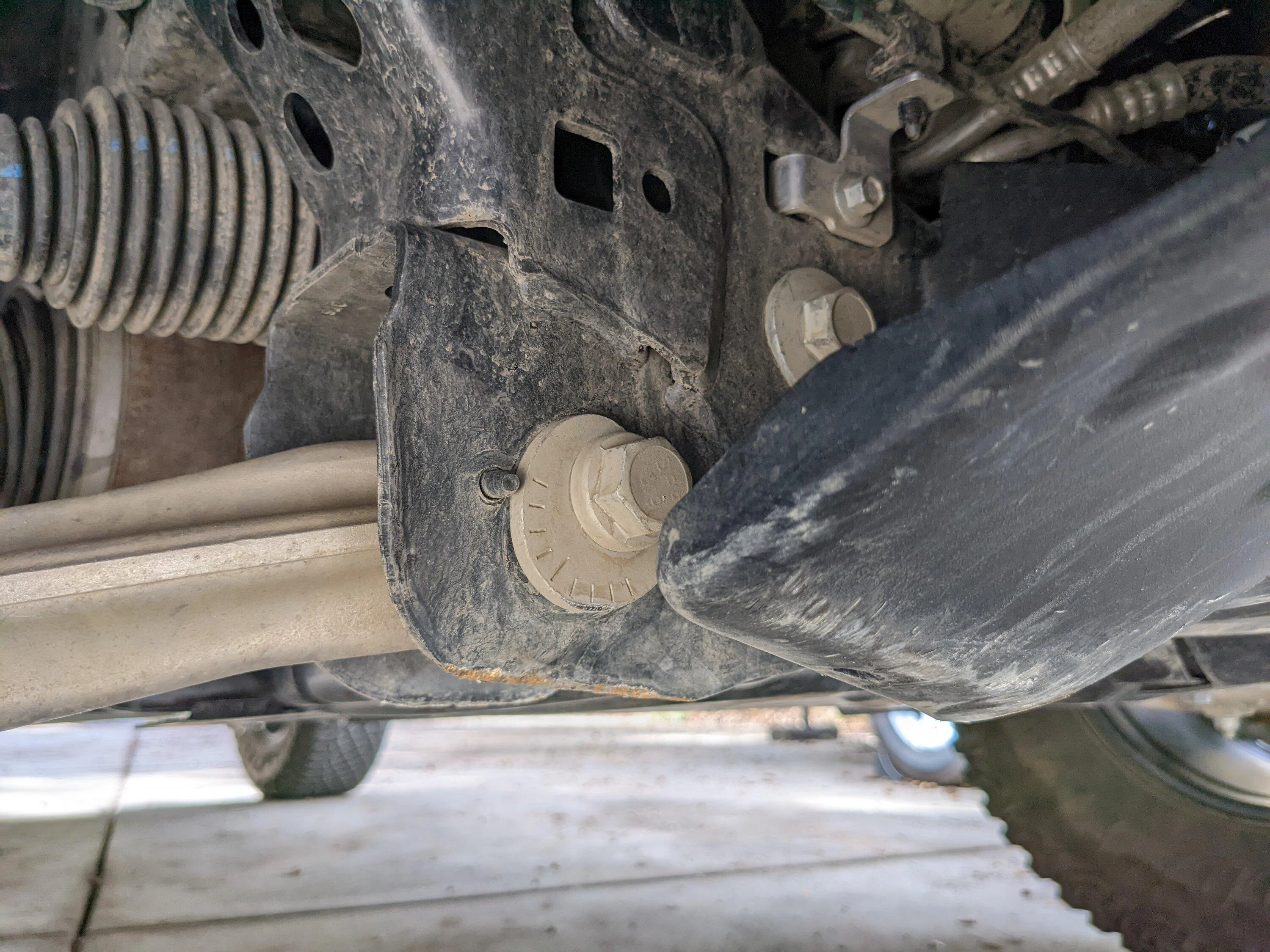

My passenger-side LCA bracket (where cam bolts are located) was badly bent during the last rock-crawling outing... to those who have a JCR or ASFIR (any RCI users out there?) engine skid installed, do either of these extend aft and is strong enough to protect the LCA brackets? The OEM bash plate apparently wasn't, as it bent/flexed on contact with the rocks, which continued aft to land hard enough on the bracket as to deform it just below the cam bolt - see photo below.
Thanks to members for any thoughts/comments, and to the OP for bringing up the topic of aftermarket skid plates.

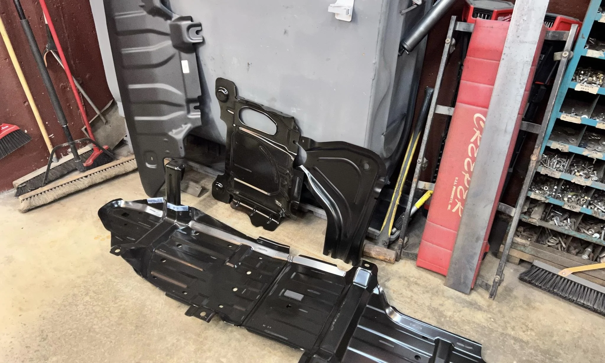

I had the modular bumper as an option on our OBX and it came with the steel lower skid and engine skid. I wanted the transfer case and fuel tank skid but really didn’t like the aftermarket ones I looked at. Up here in Canada I could buy the complete skid pans (4) from Ford for just the price of the tank skid from Ford So I bought the complete set. Stamped 10 gauge and super strong imho.

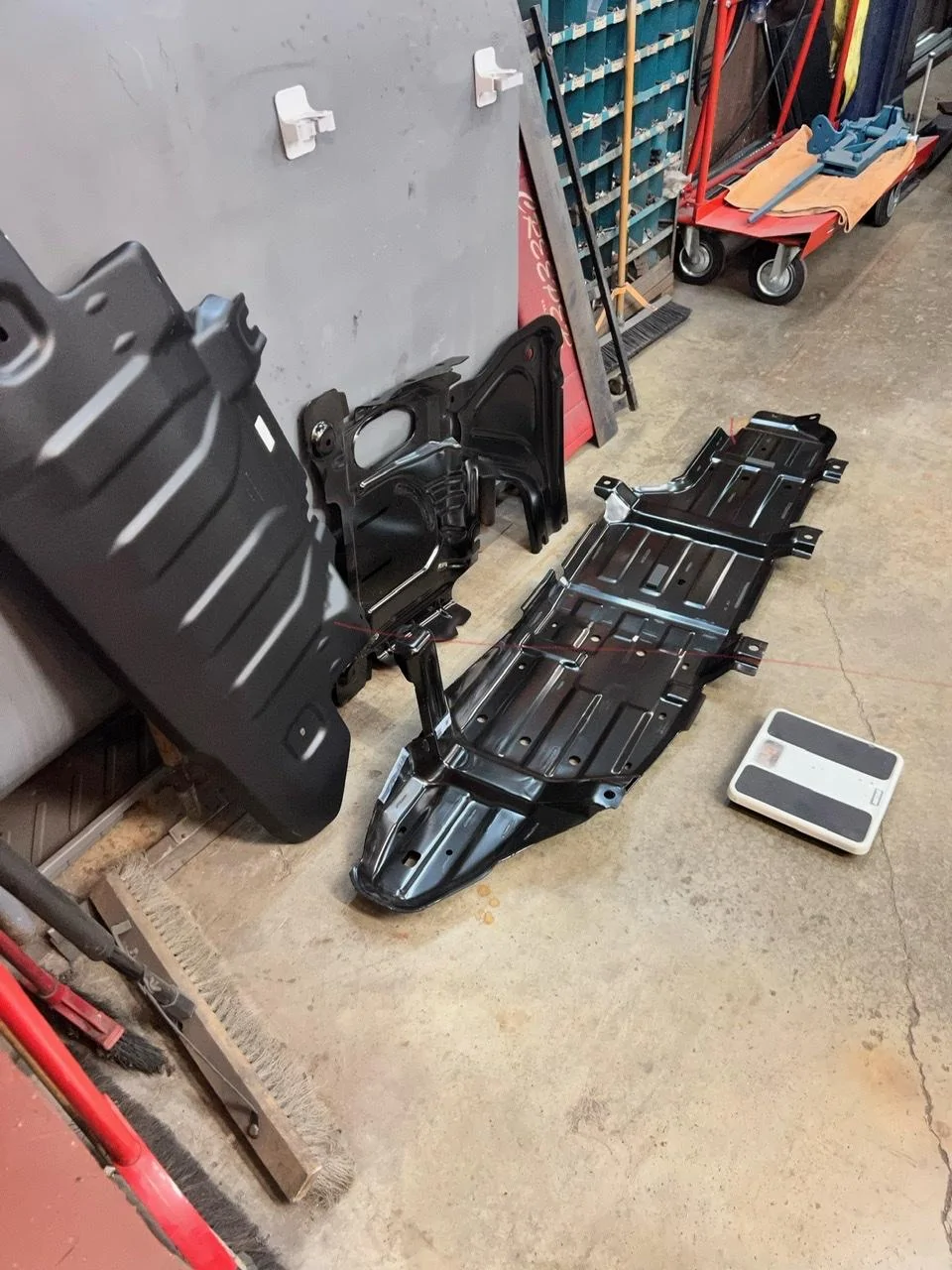

Would it be possible for you to weigh the front three skid plates before installation? Considering replacing my steel ones with aluminum to save weight. The gas tank skid is not an issue for me since my two-door already has one.

Sure. No problem
Front guard 20 lbs
motor guard 9 lbs
transfer case guard 10 lbs
fuel tank (4 door) 68 lbs

Awesome, thanks!
