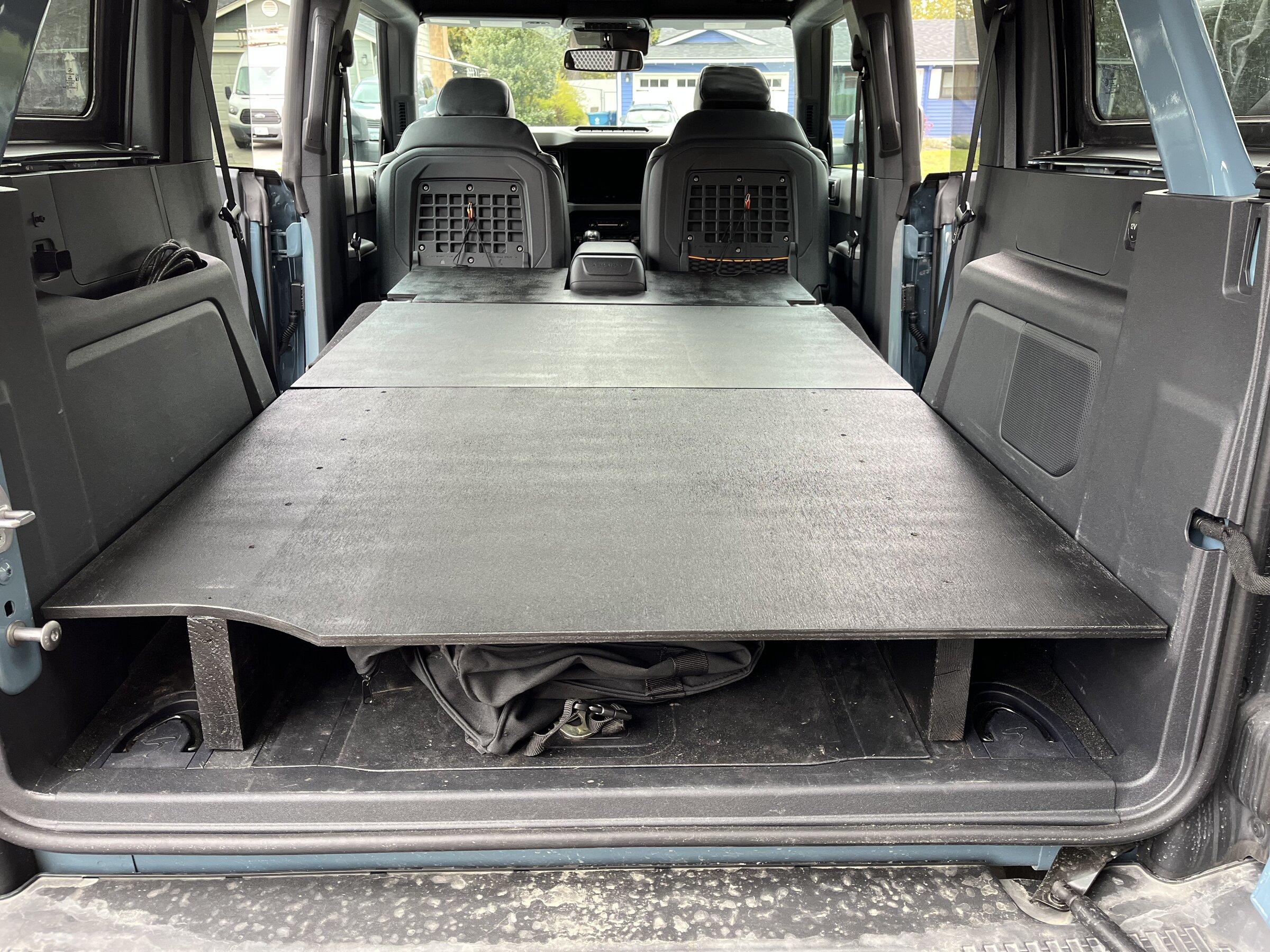

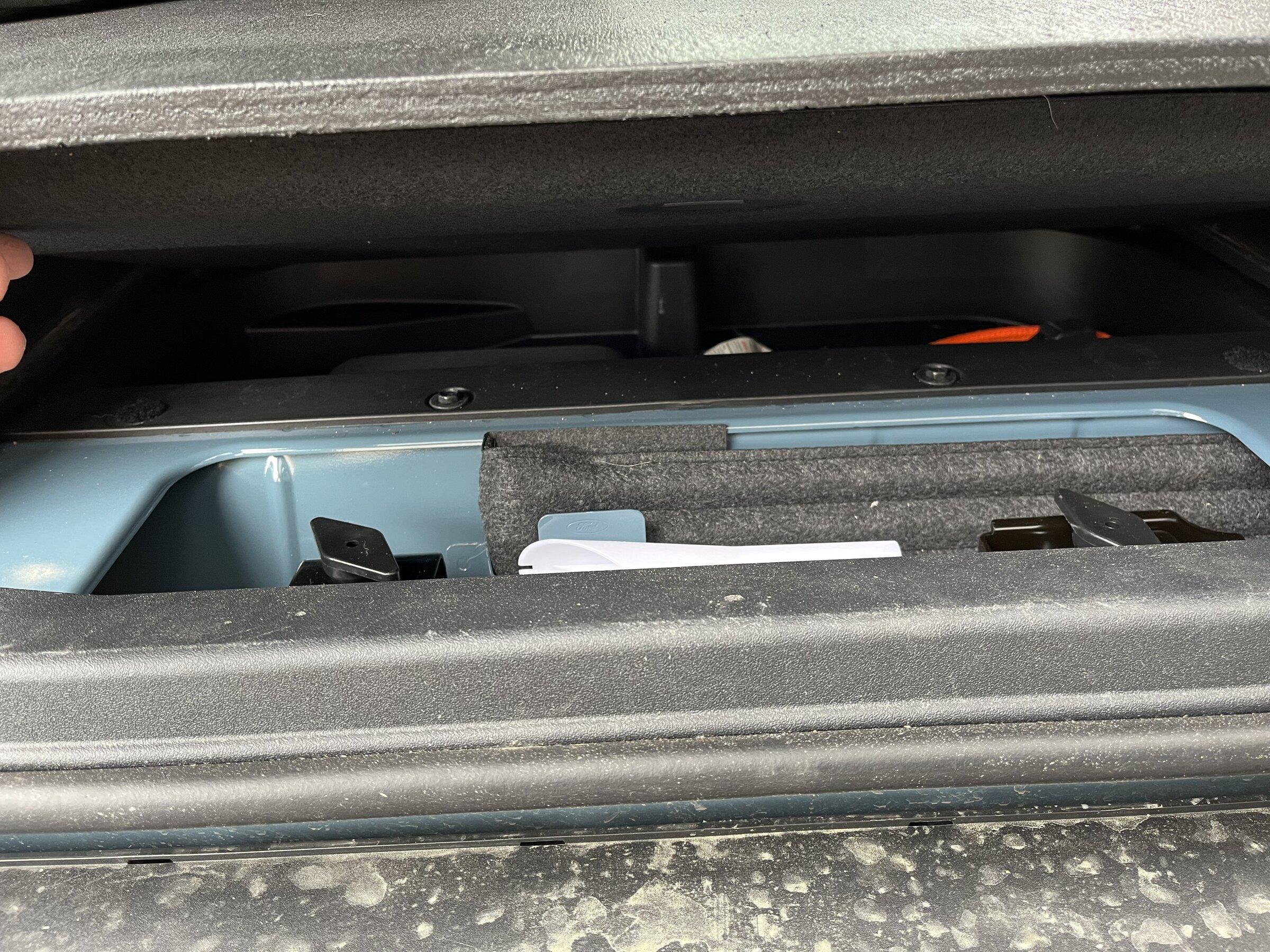

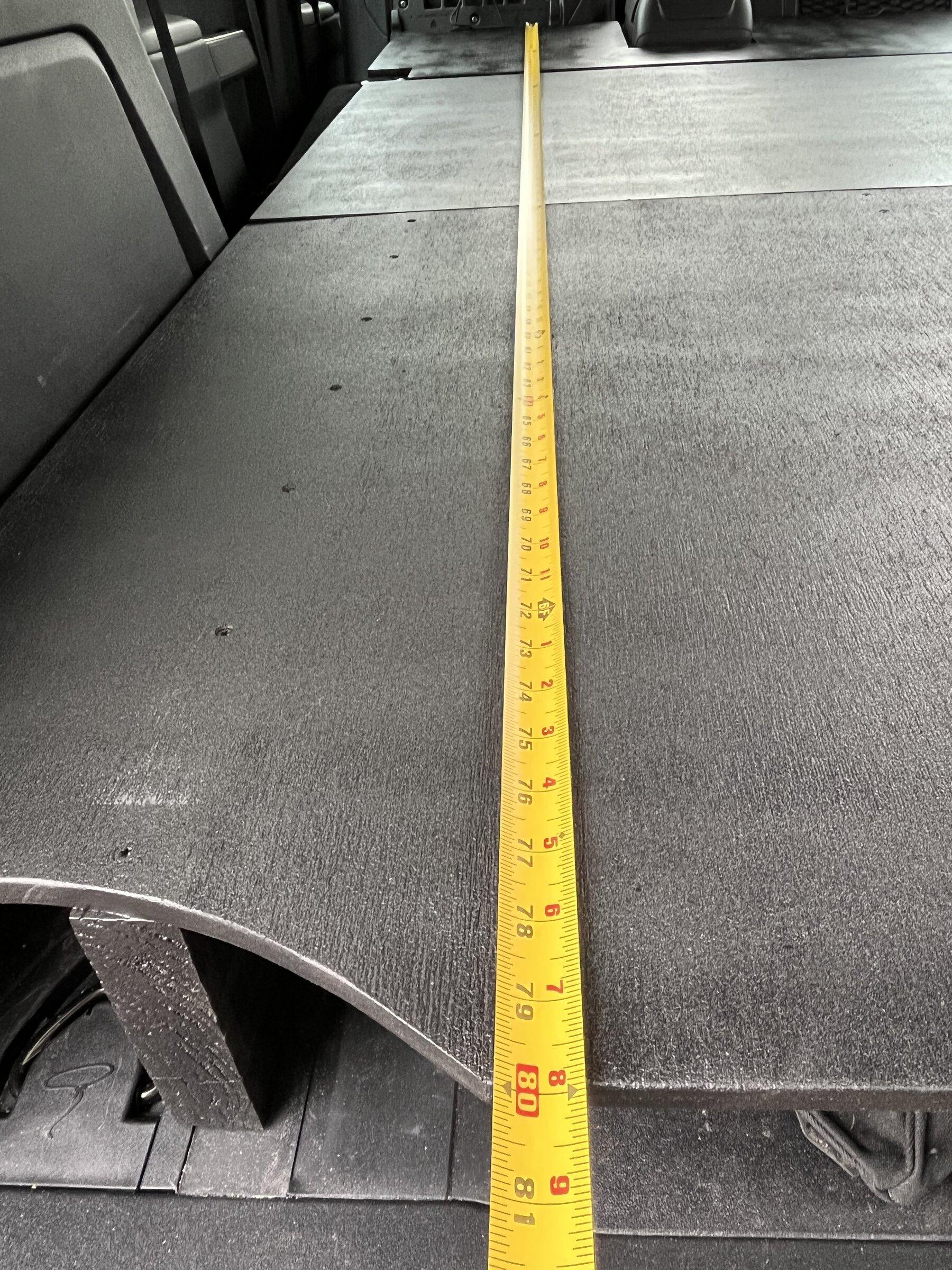

It’s not a bend. It’s actually cut to clear the bulge on the left side of the swing gate that houses the lock mechanism and the vented, plastic access panel.
Ok... makes total sense... I dont have my Bronco Yet so from the picture it just looked warped

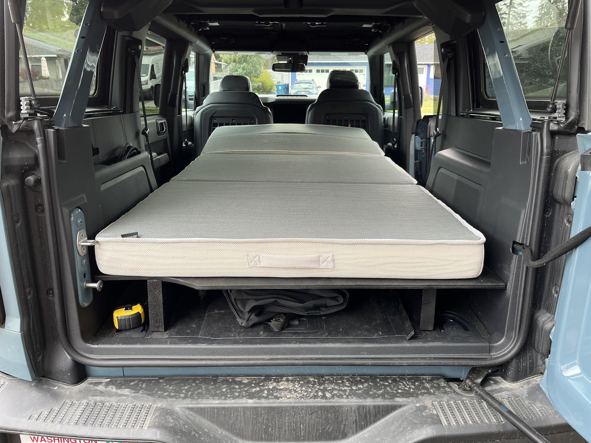

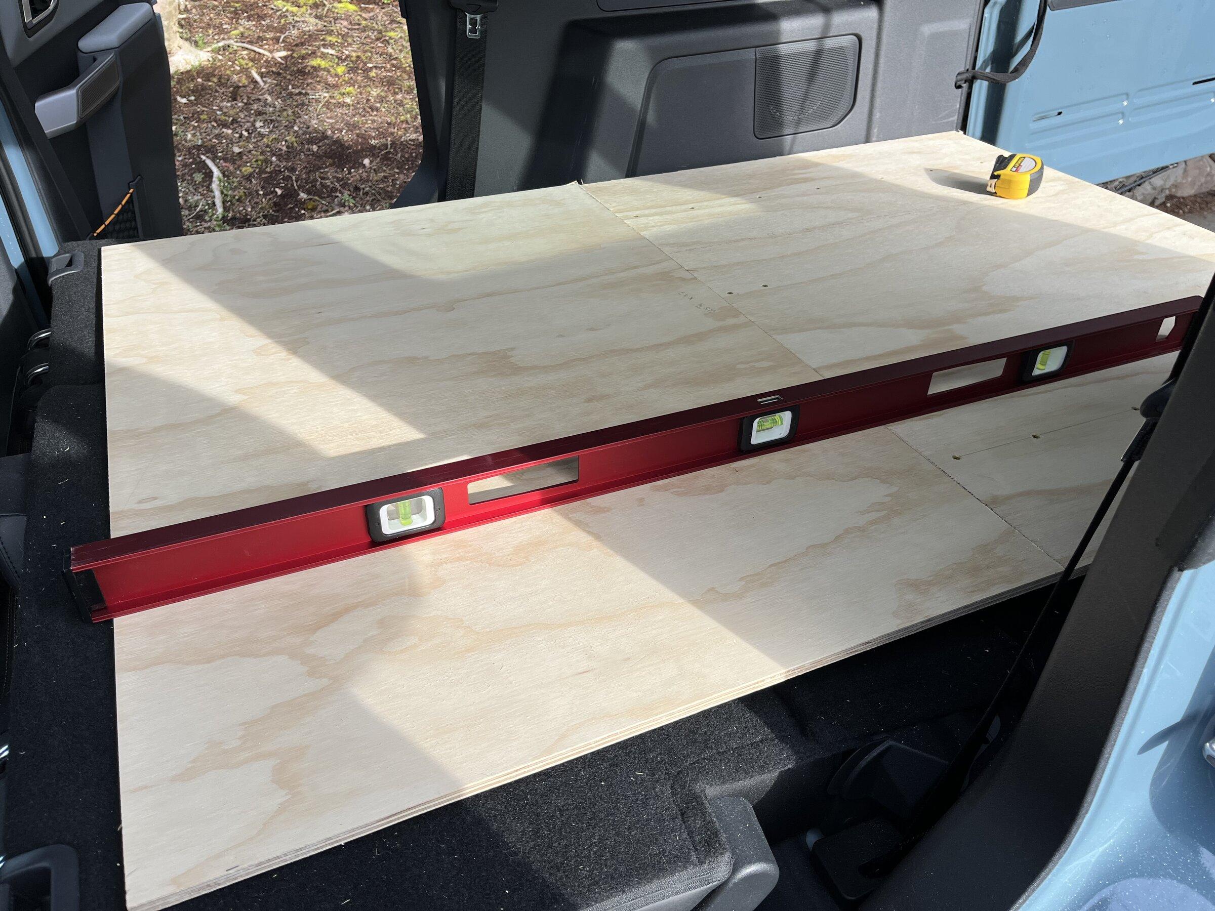

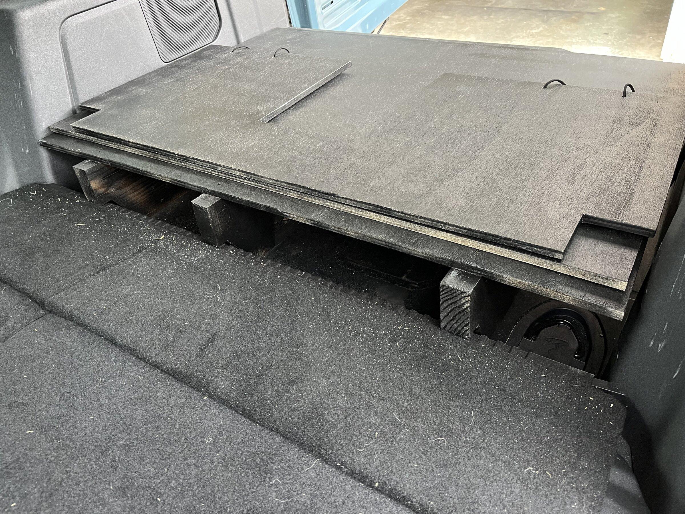

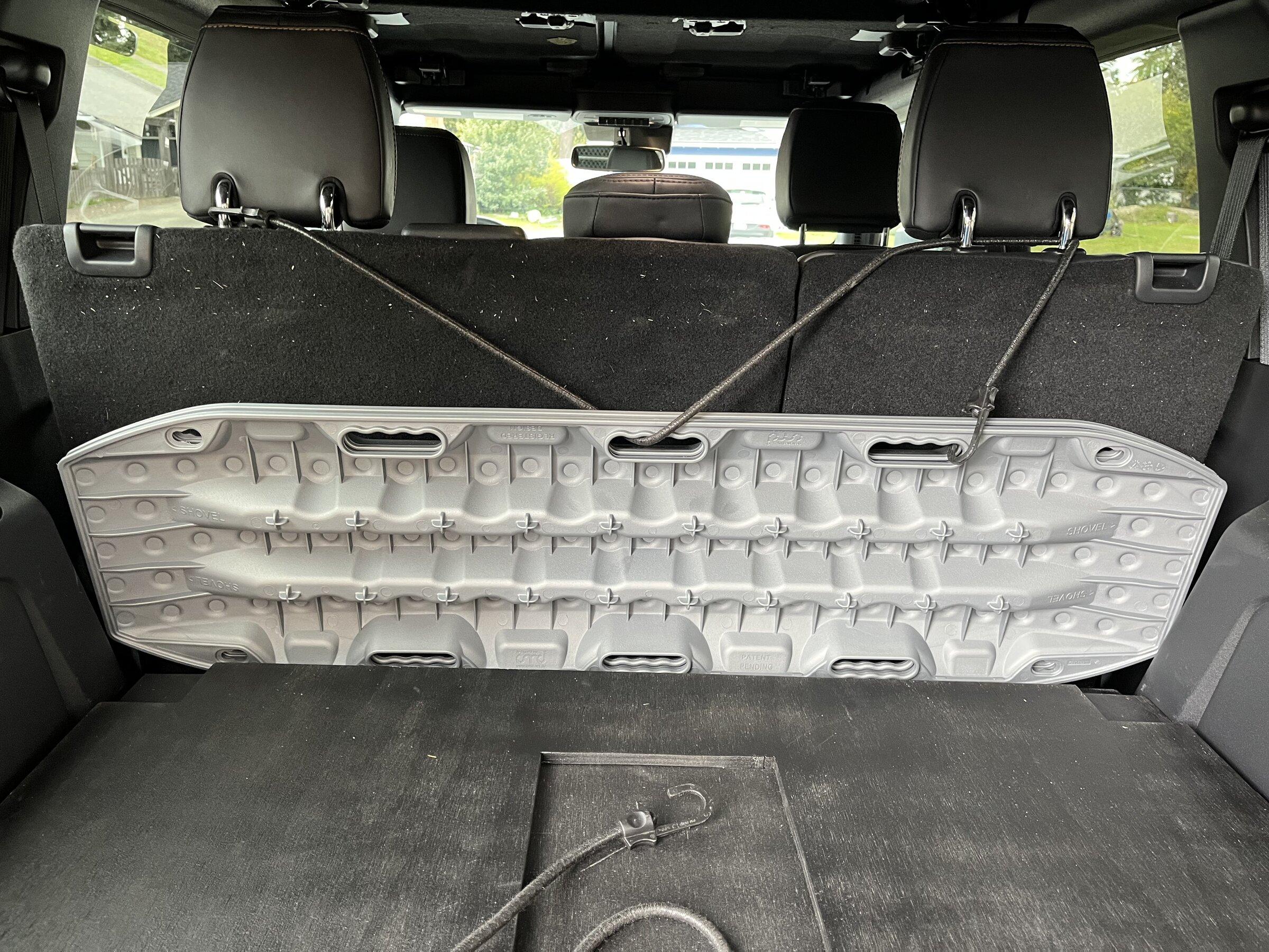

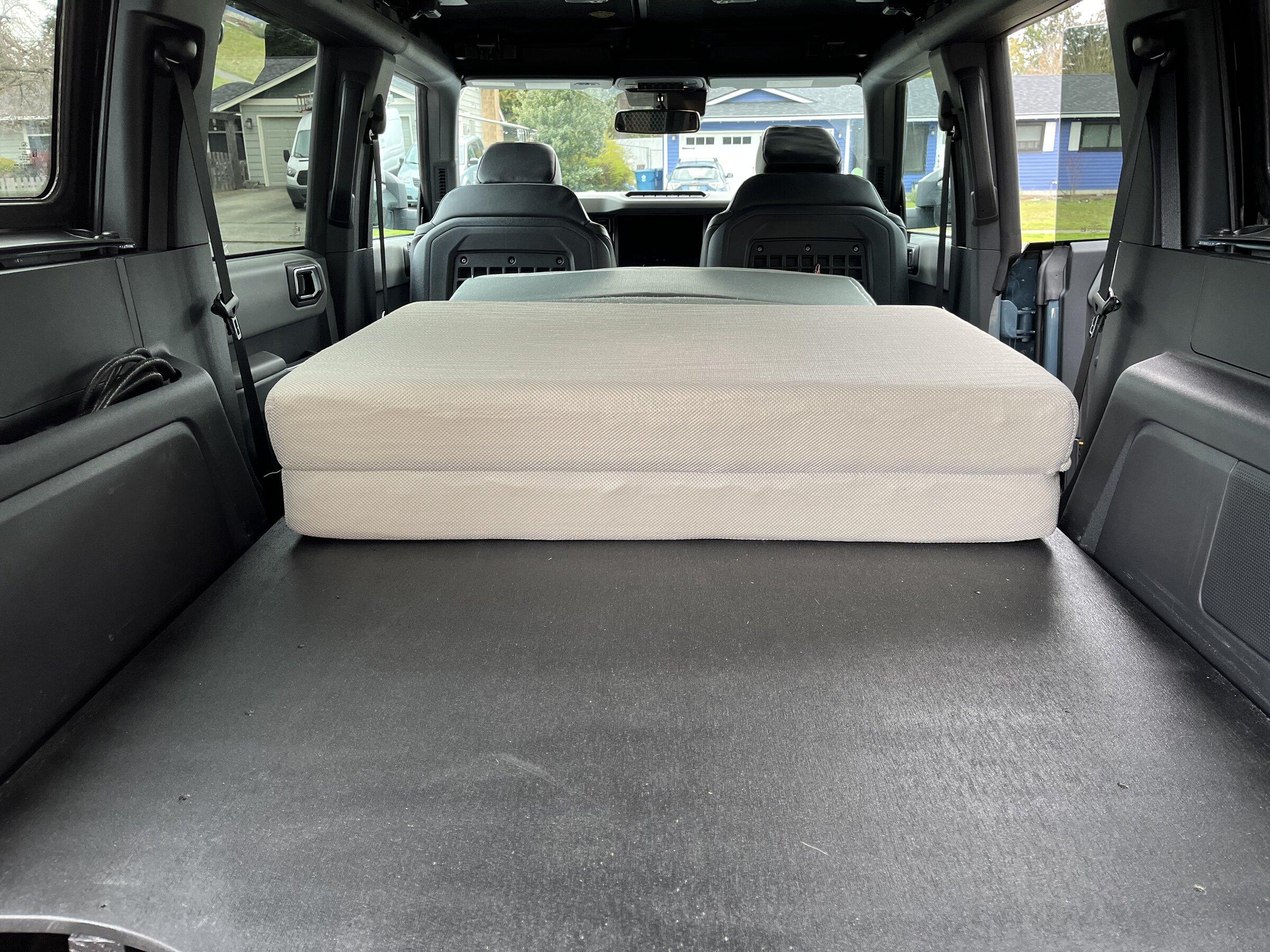

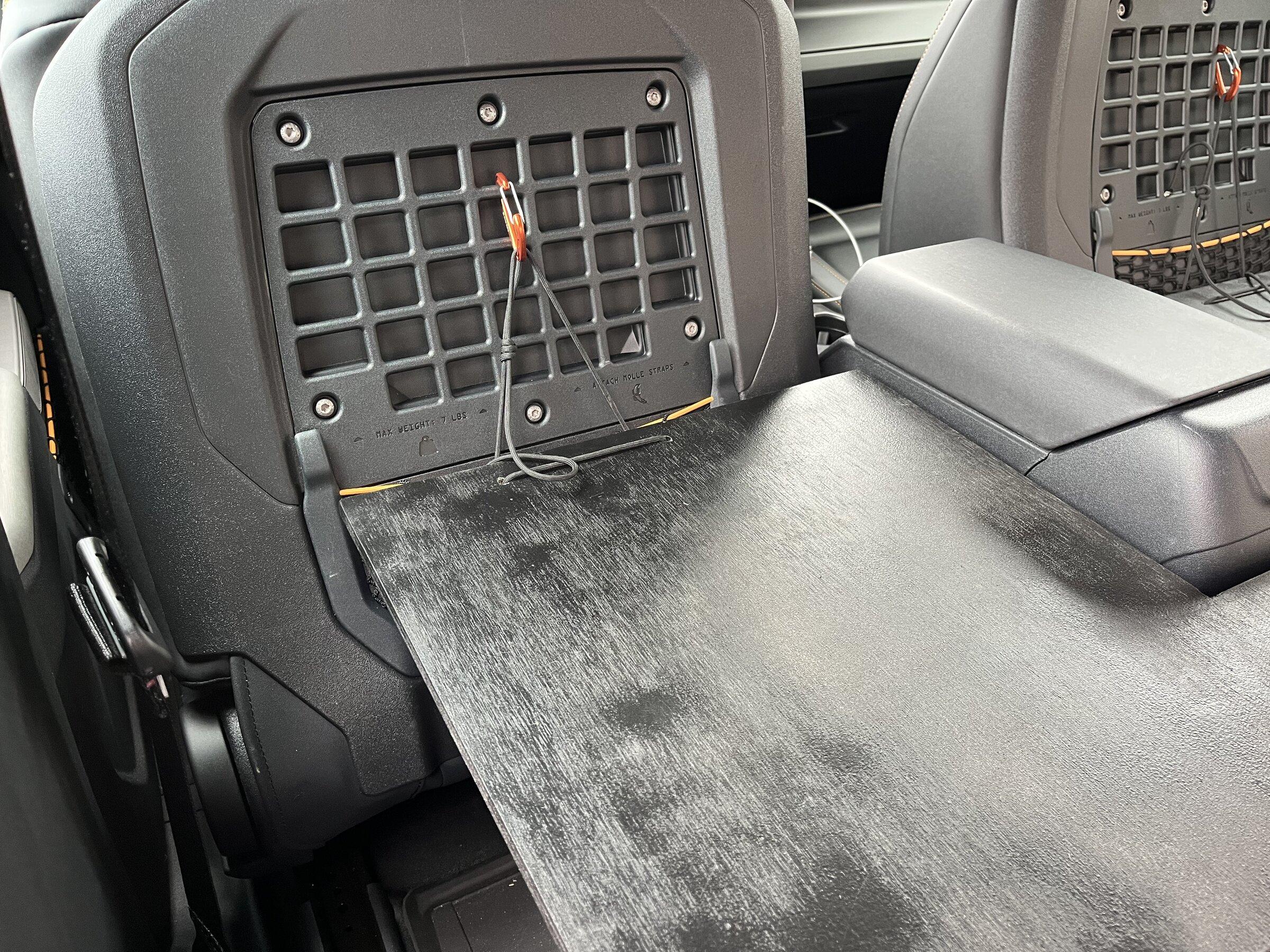

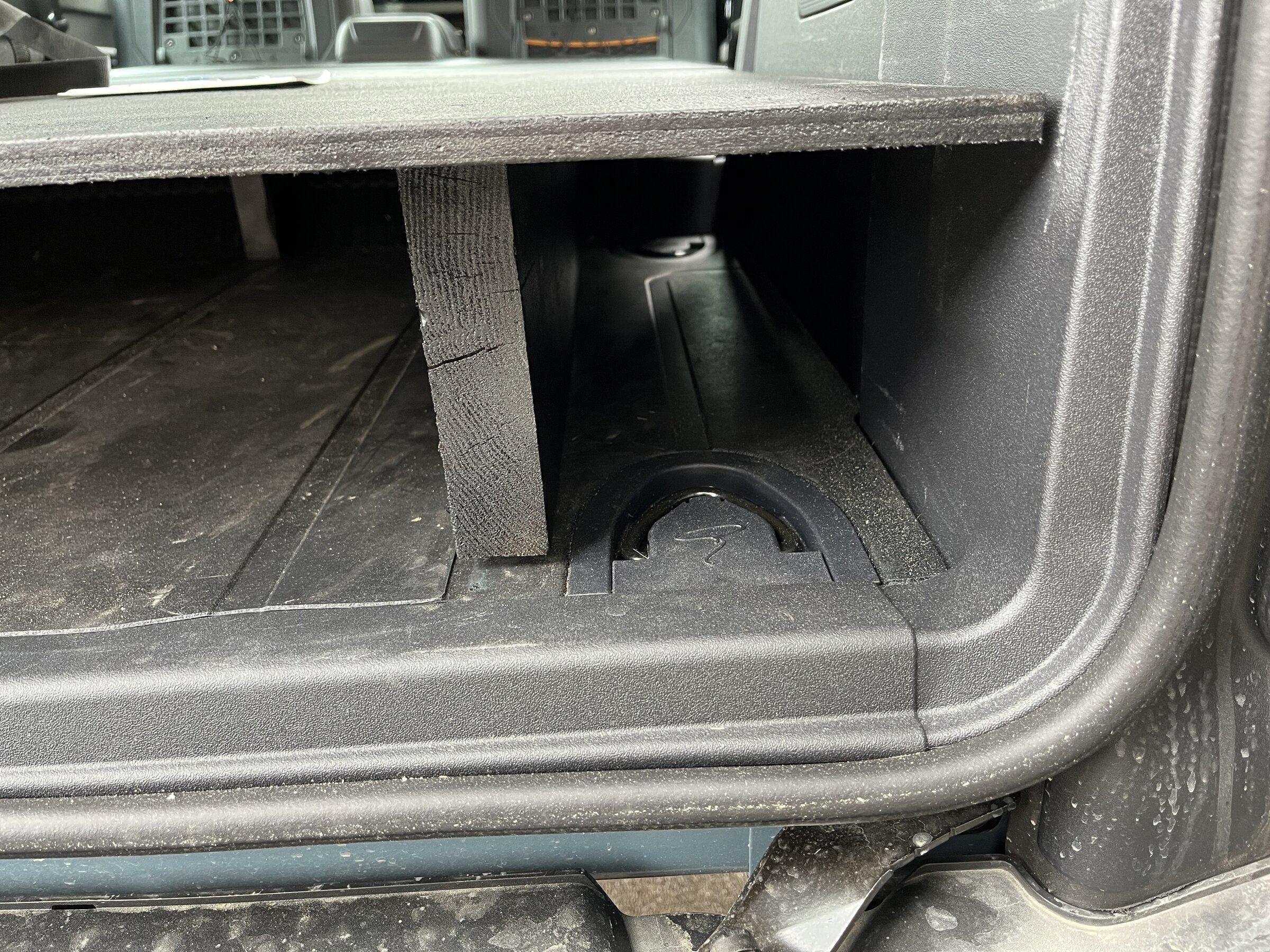

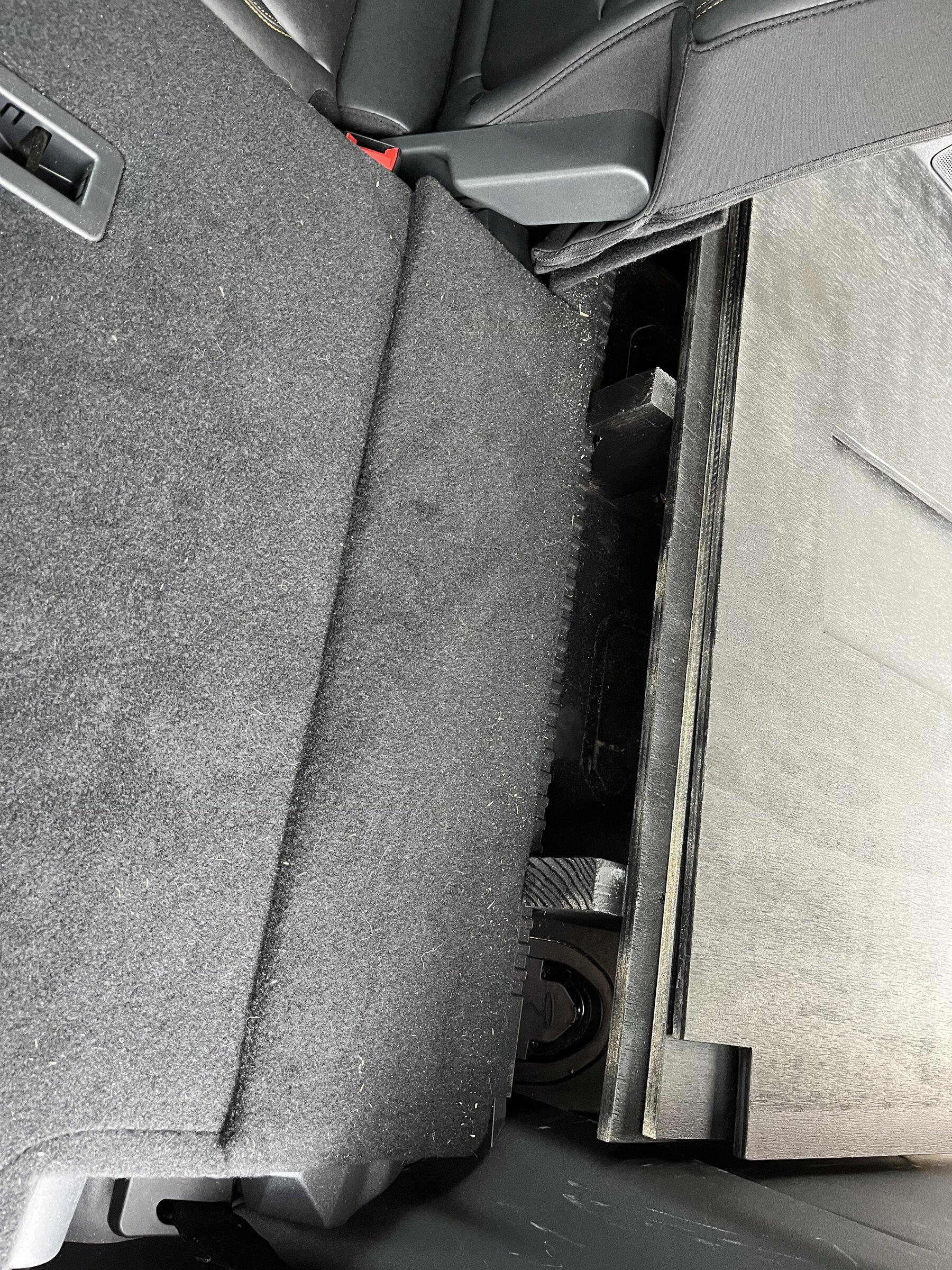

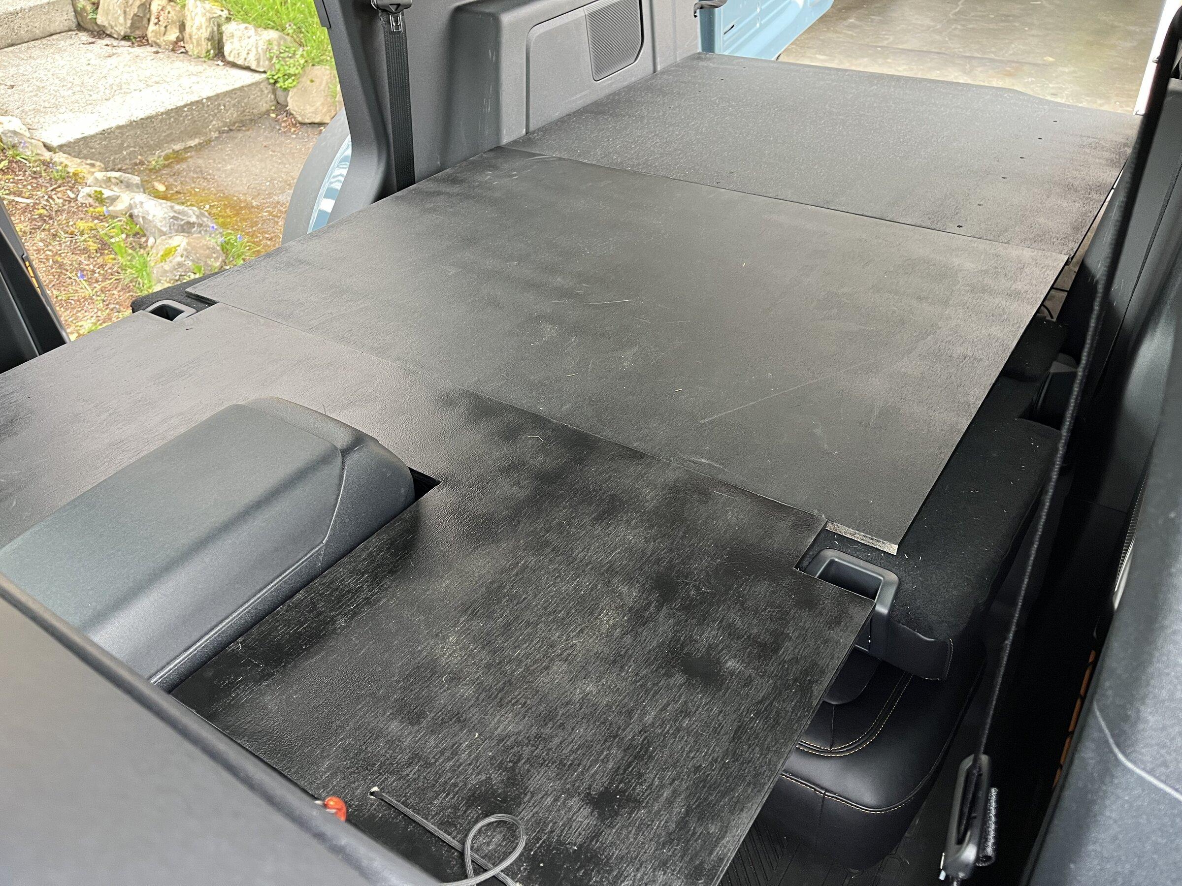

Hello everyone. I built a platform for sleeping/camping in the rear of my 4 door badlands. I saw the idea on the forum and made a few changes. I didn’t hinge the platform because I wanted the wood to be modular and useable for other things if needed so the pieces just fit in instead of hinging open/closed. I used 1/2 inch ACX plywood and coated it with a few cans of Harbor Freight truck bed coating. I used old scrap joists and ripped them down to 6 inches wide for the base to be level with the top edge of the back seat when folded. Finally, used a slip knot with 550 cord and d-clips on the back seat to support the final piece. I made cutouts for the plastic handles that fold down the back seats so that everything is resting on the seat back itself which seems to be pretty sturdy. Overall, I’m happy with it. I’ve got 80 inches of sleeping space with the seats all the way forward. I have a foam camping mattress that is super comfy and fits perfectly. I’ll probably cut a chunk out of it to rest level over the center console. The whole thing comes out easily enough if I need extra space. I added a third support under the platform and braced it with a 2x4 to prevent side to side movements and to add extra support underneath if I ever make a 60/40 split. The platform doesn’t seem to flex at all when I sit on it. I was hesitant to go with the 1/2 at first but it’s solid and saved some weight over 5/8 or 3/4 inch.
Great build!!!

I've considered doing carpet, still might. Hinging it to a "z" fold is also something I had considered and was my original plan but moving the pieces around works well for me now. Still may make those changes at some point. I rounded off the sharp edges with my orbital sander when I was all finished. The couple of scratches you see happened during the fitment process but they seem to rub off ok. The plastic scratches easily though for sure.

I normally sleep in my tent. This is an option for quick overnighters, or very cold weather camping up here in Washington. I used to sleep in the back of my Ranger with a Softopper canopy.
