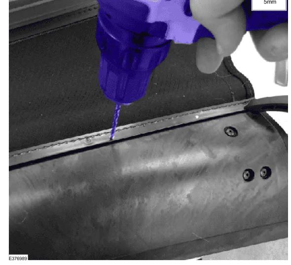

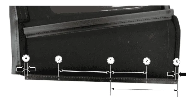

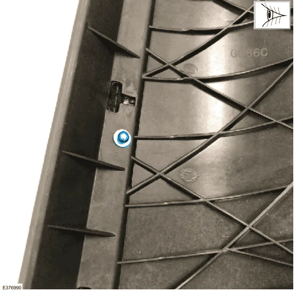

They showed me the diagram for how it is fixed. There is a piece of fabric that is folded underneath. That is where the clips are located. They drill holes in the fabric and push the rivets through into the plastic.

For whatever reason the copy and paste function doesn't like the TSBs. This is not the complete procedure so don't get worked up about the proposed fix. That said, we've had one with this problem which was replaced before the TSB came out. Basically, they fold the fabric back and rivet through the seam which is then folded back over hiding the back of the rivet. Cheesy? Maybe but this is how they want them fixed now. If this isn't a durable repair the procedure could be modified or scrapped in favor of a replacement if a new design is made.
