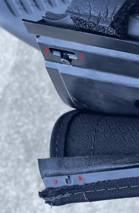

So how excatly did that work, I'm confused on how to attach the wire? Sorry if it's obvious lol
Basically just drilled very carefully with a Dremel on the red marks and ran some wire through the plastic on the cloth side, then fed the wire through the plastic side and twisted it tight.
Oooh I see. That makes a lot of sense. I had t really messed with because I didn't want to make it worse! But will need to do this. No leaking through the tab holes?

So long as you don't drill through the cloth, there should be no leaks because the repair is under the cloth.
