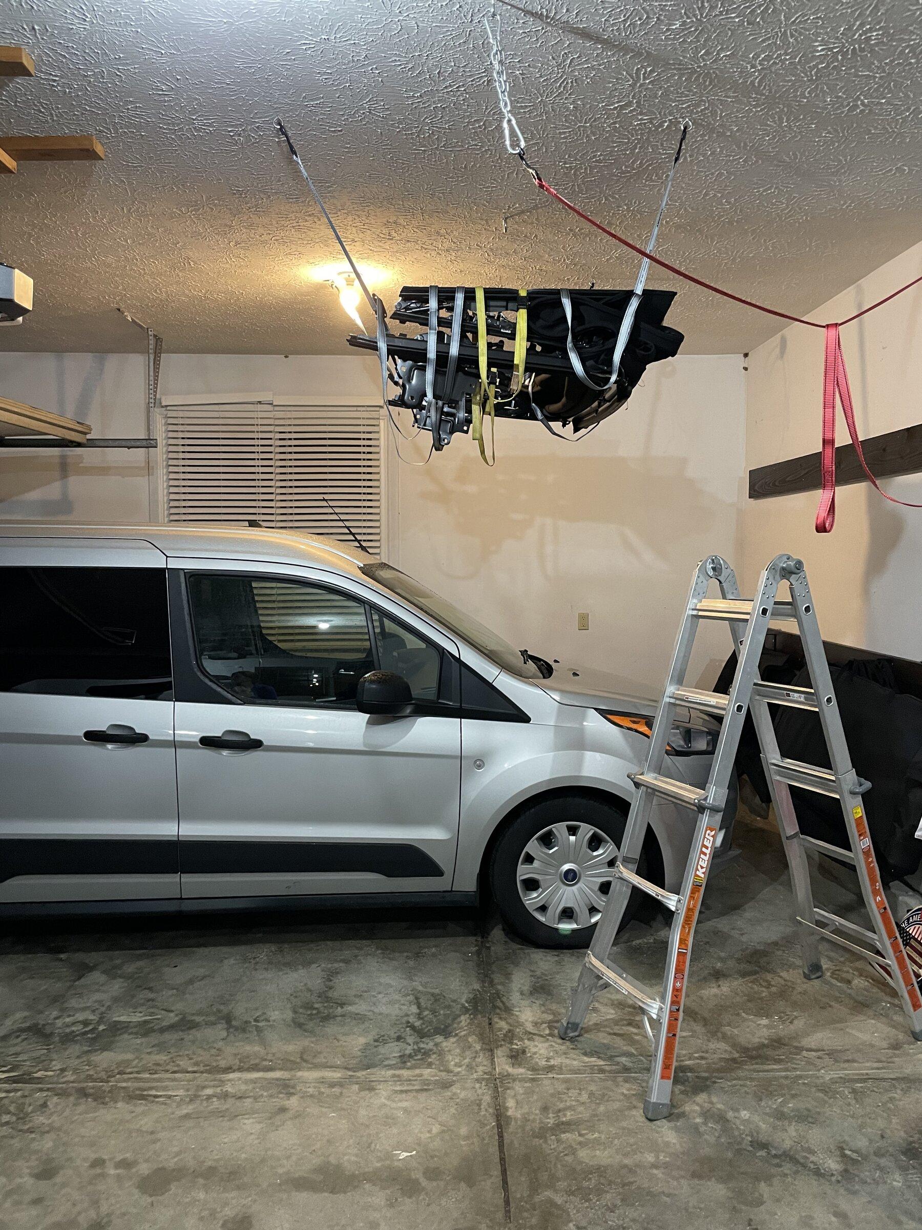

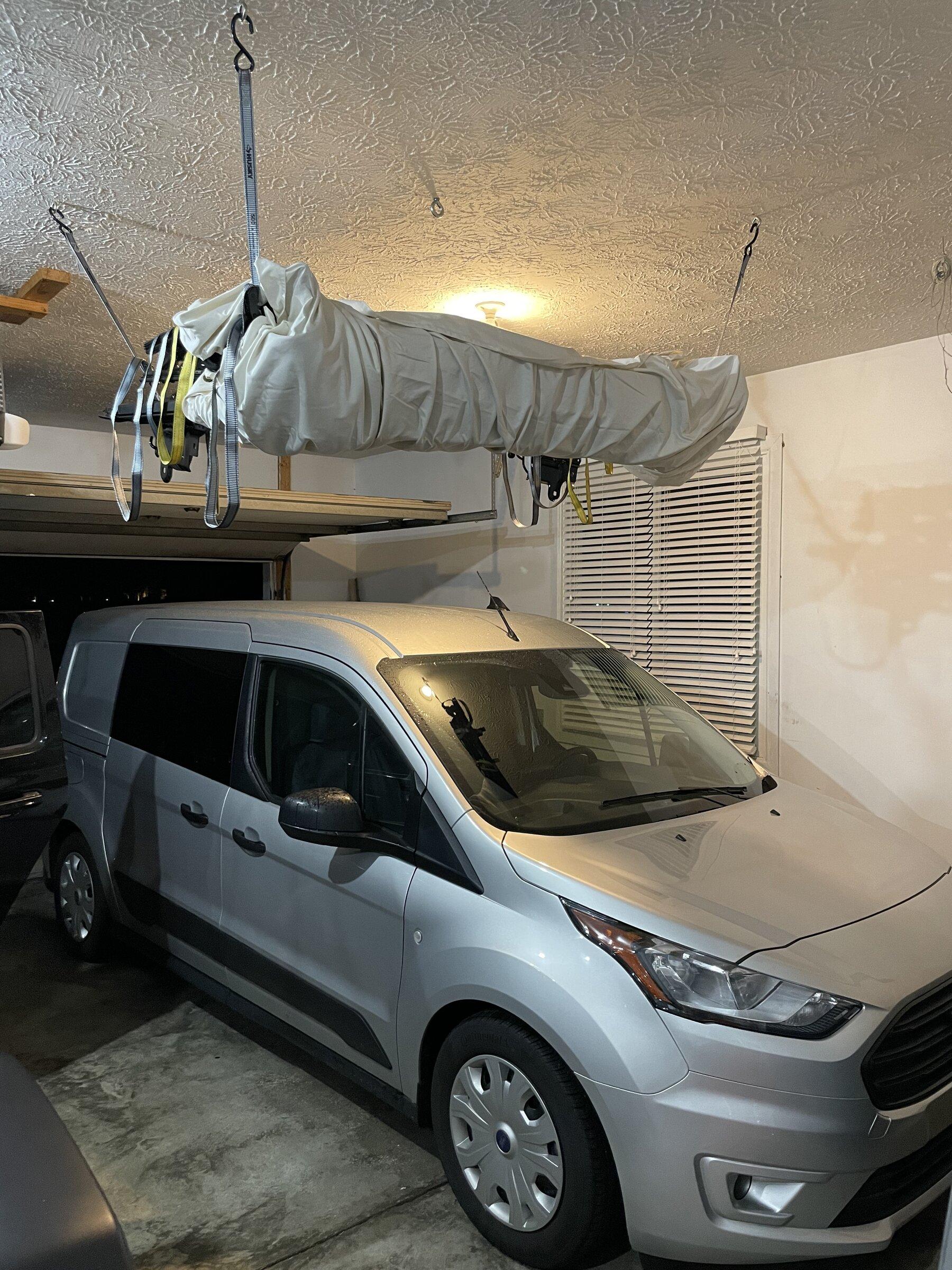

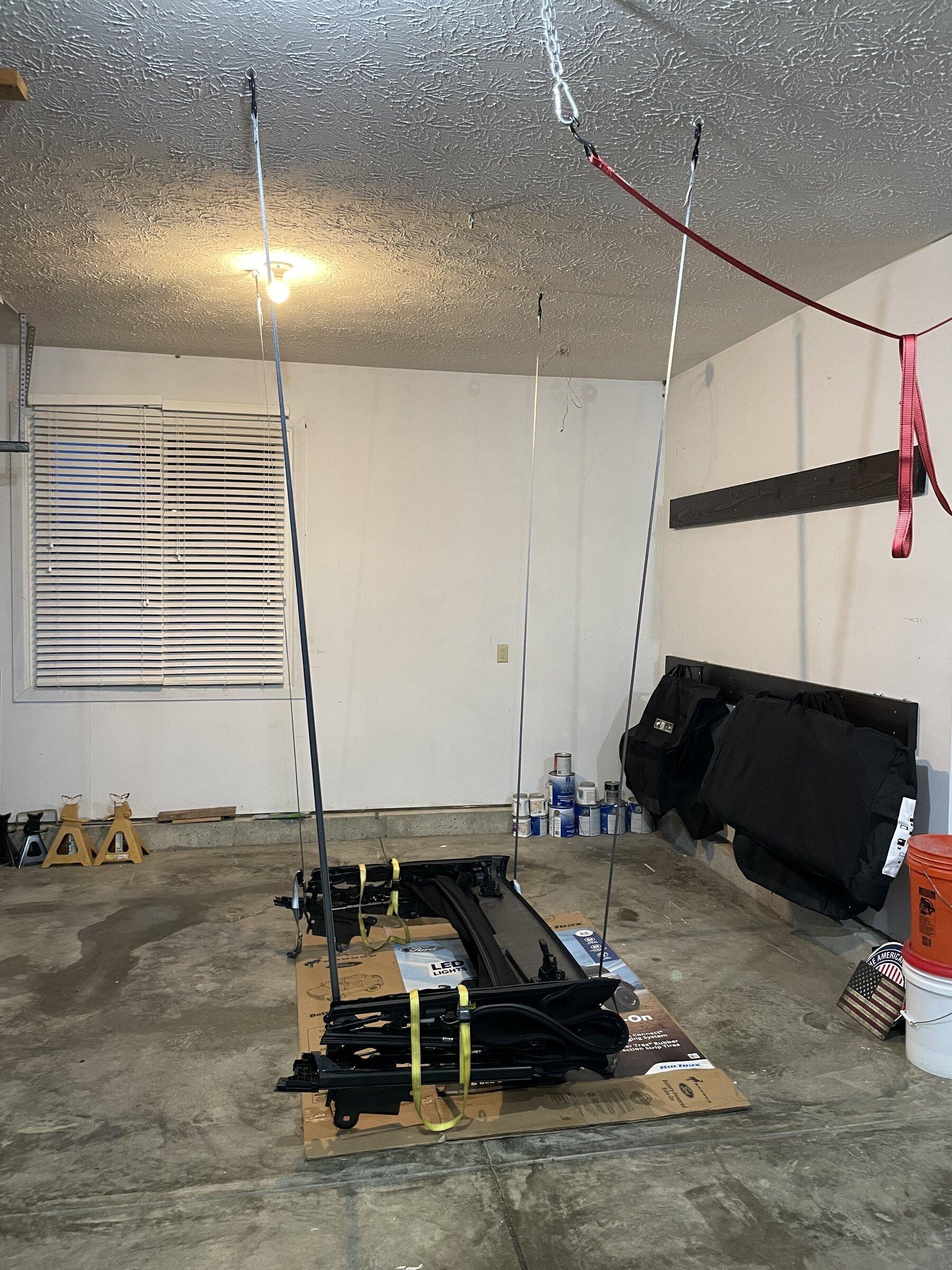

I hoisted my soft top last night with 4 straps 10’ long. I hooked the front straps in the slot where the alignment pen would go. I hooked each back strap to the corner molded piece. Worked pretty good and was easily able to get it up. I don’t have a bronco yet to see how it is putting it on or off of it but from the ground it was simple and quick. I wrapped it in a sheet to keep the dust off for now until my bronco arrives and I can switch from the hard top to the soft
