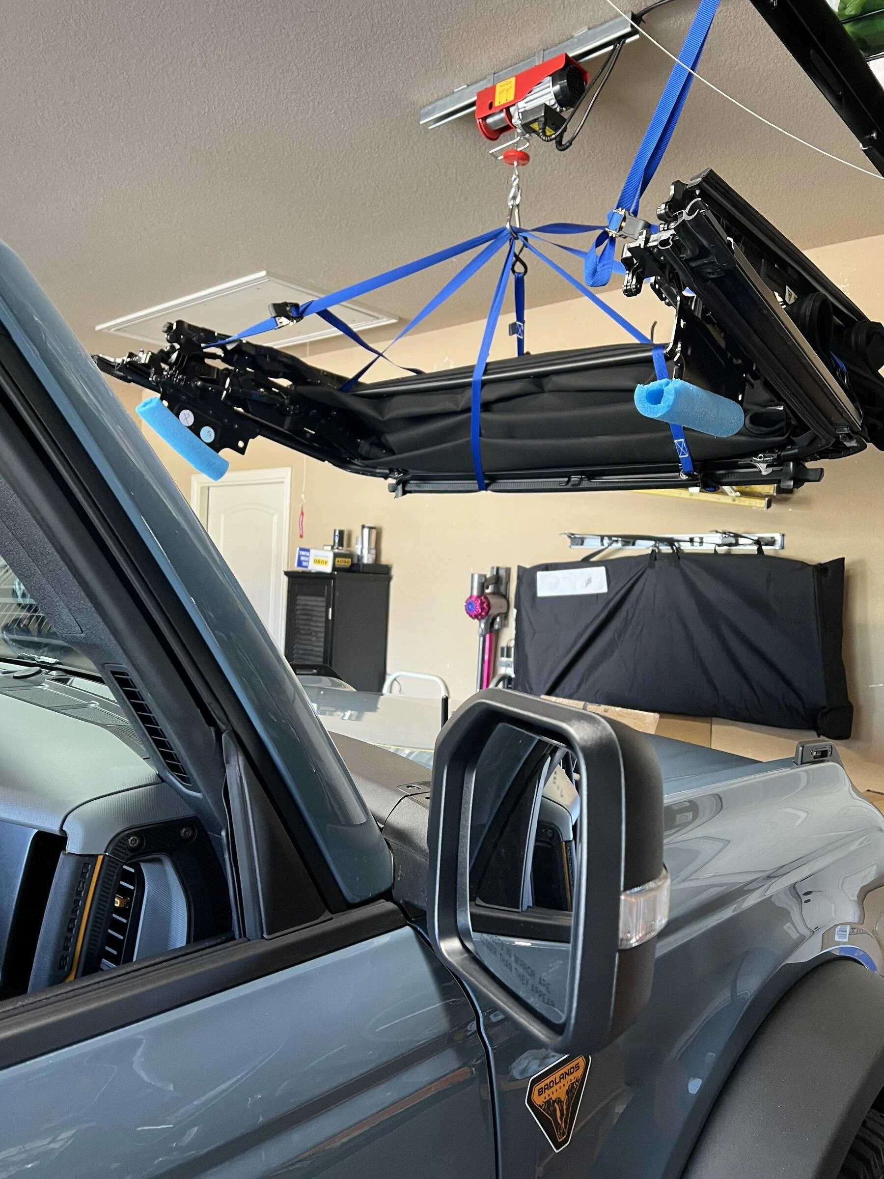

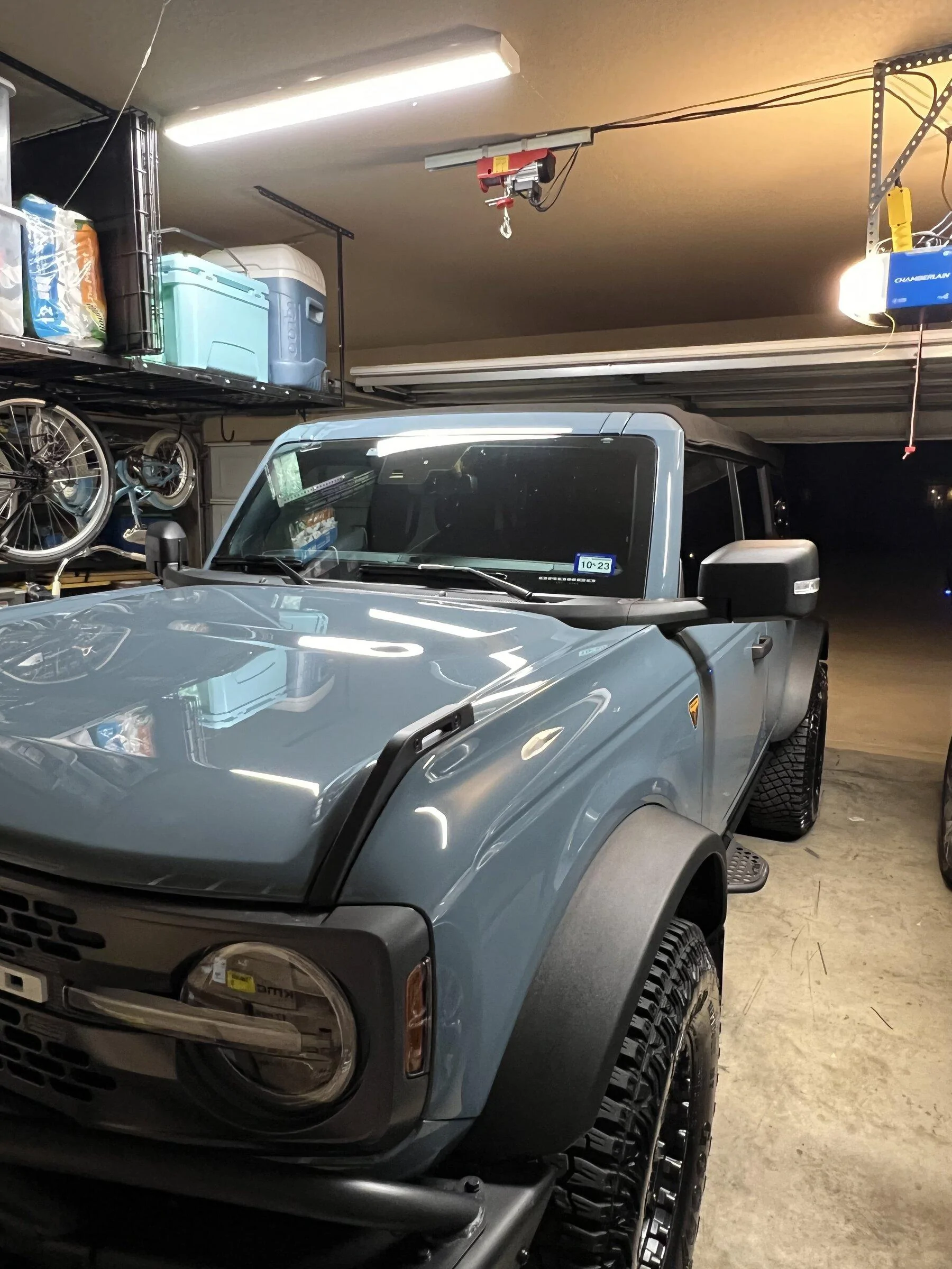

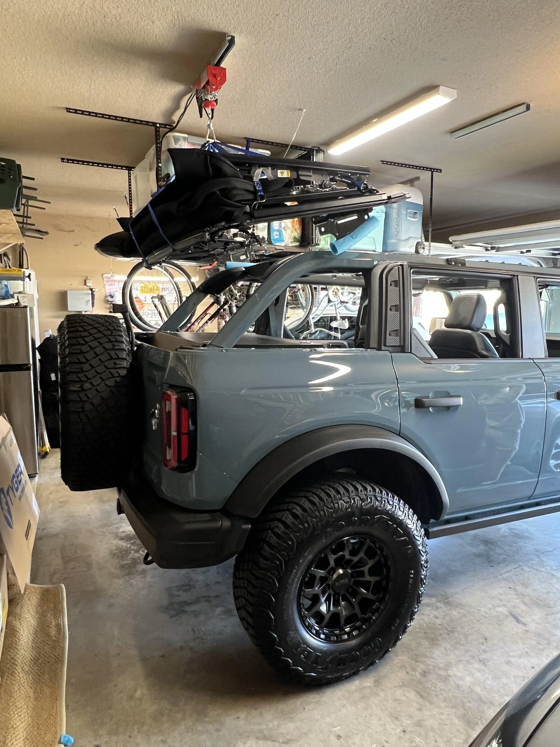

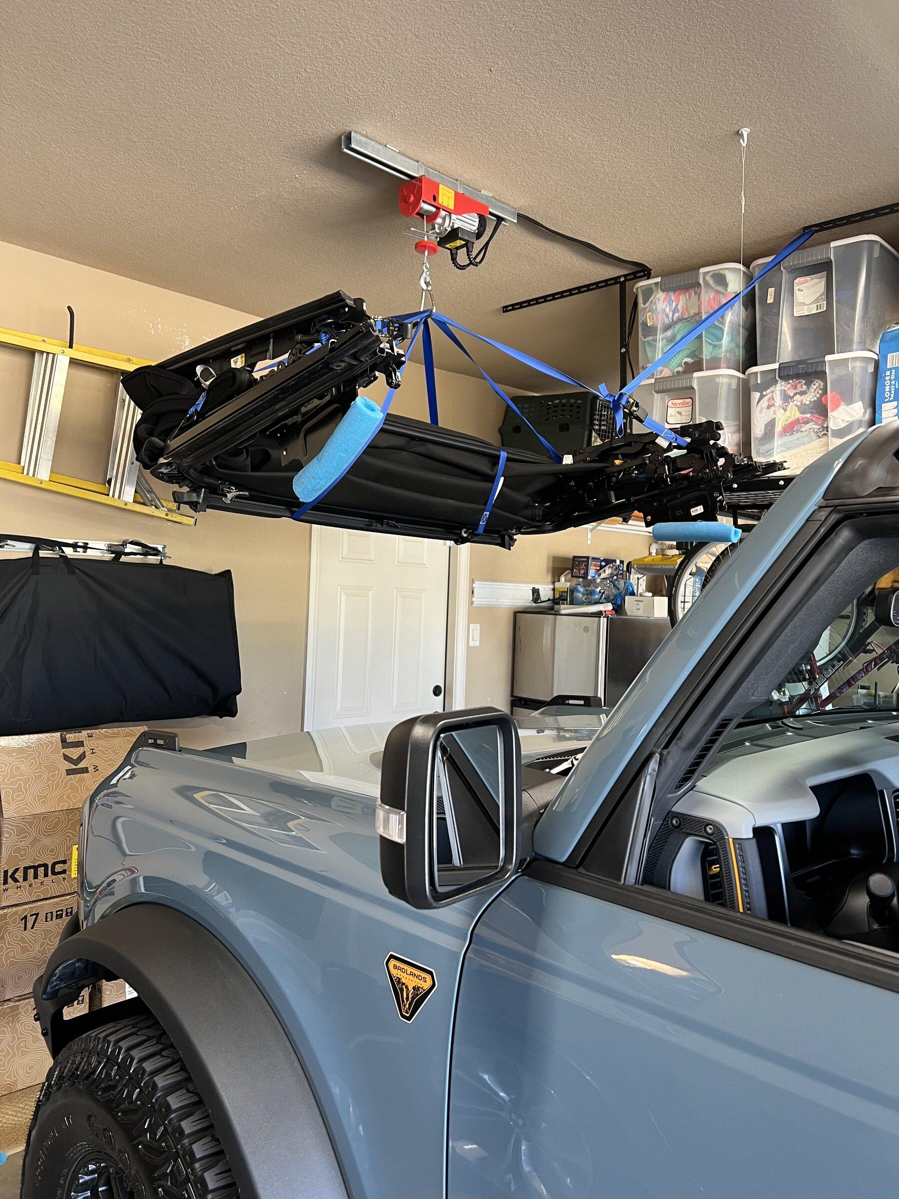

So here was my first attempt. I did have to relocate the winch because I didn’t factor in the sag of the straps. Figuring out the CG took some trial and error but I think I got it. Wrapping the roll bars in towels is key to prevent scratches on the way up.

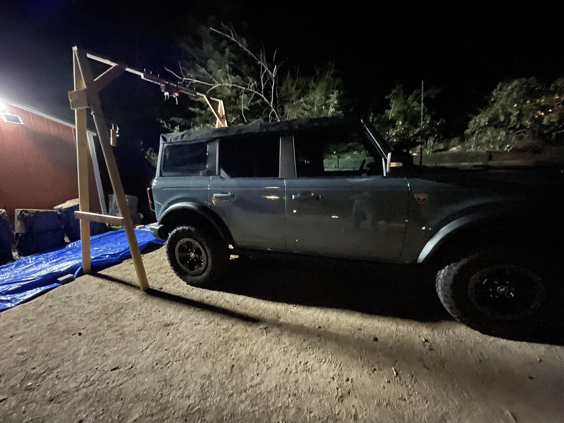

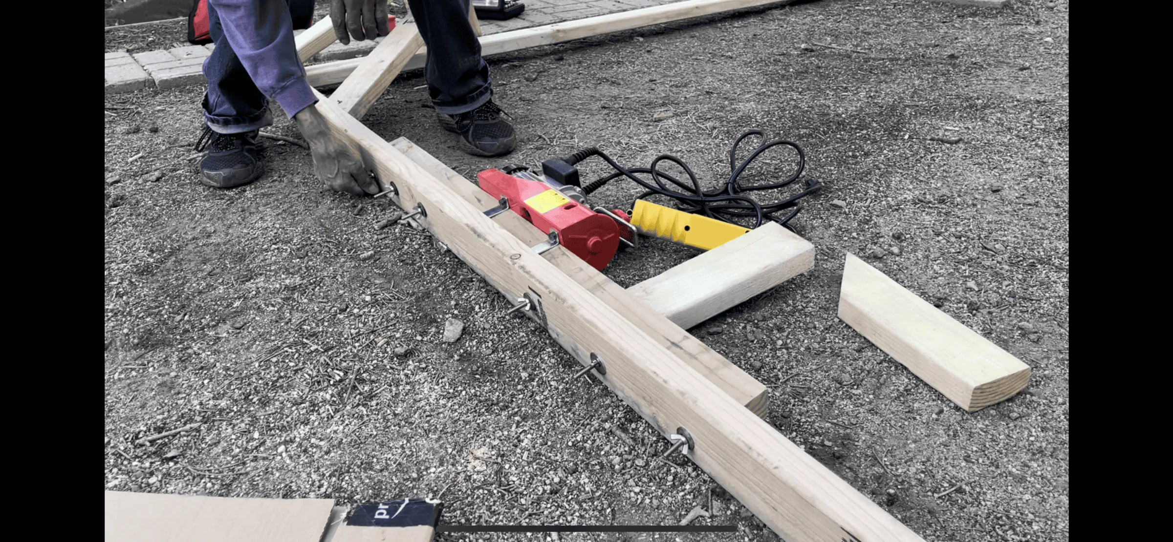

Seeing this is one point of lift, I’ve decided to copy and modify a version of a wood support system that I have found on YouTube, where Jeep owners have used to back up under and hoist their hard top off with straps. I plan on mounting this hoist under the top support beam (simulating where the hoist is mounted on your ceiling) and trying the same thing. I have a long driveway with no garage and nobody at home that can help me lift off my soft top. My neighbors are elderly and cannot help me either. So this seems to be my only option and determined to make it work. I just have to wait for the foot of snow to melt and for warmer temperatures before I attempt to build this.

I built it and lifted the top off. I didn’t like how it lifted, so I put it back down and put the top back on. I’m going to play with it more. It’s about the strap placement, that will make it better. Barely had time for one lift before it got dark. Going to try again tomorrow.
