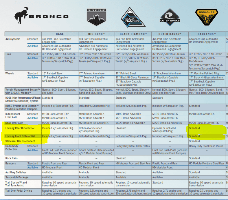

Are electronic lockers standard on Badlands? It says they are included with the Sasquatch package, but I can’t find where it says they come standard on the Badlands.
Ford Bronco Squatched Badlands question 1604431575848

I know, late to the party, but you can only get to a 97:1 crawl ratio with the granny low of first gear, the 3.0 t-case and 4.7 differentials. Crawl ratio is the multiplication of first gear, t-case and differentials. So, I guess that's my long way of saying the 4.7 is available with the manual transmission because you the only way a Bronco has the crawl ratio it does it with that combination.
You can't get the Sasquatch with the manual, but the Badlands with the manual comes with the 4.7 differential ratio, so you can get the manual and 4.7, but with the Badlands.
