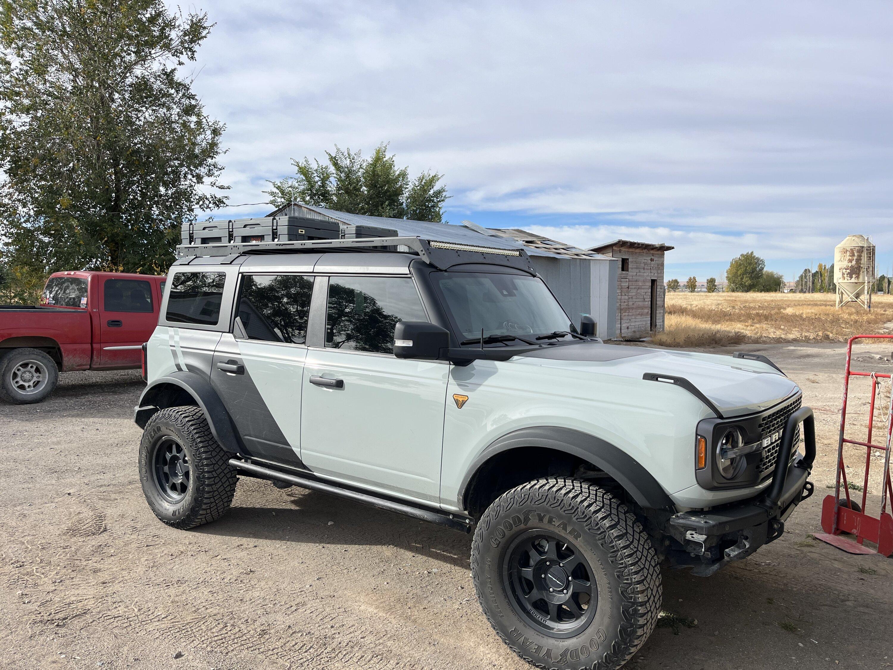

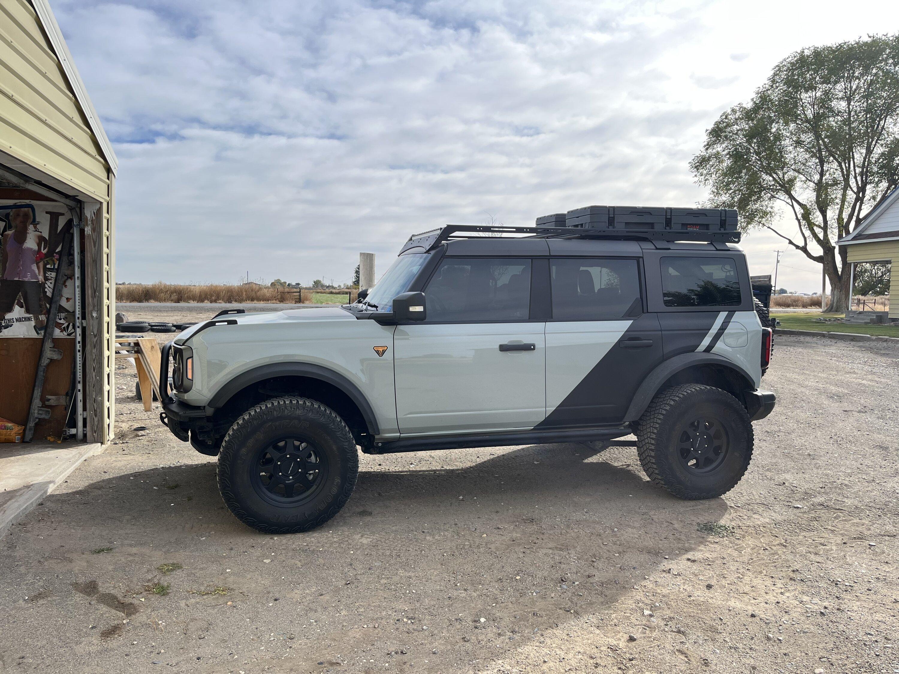

Good afternoon everyone! I’ve got a rather annoying squeak coming from the rear, most forward mount on my Trail Rax roof rack. Not even on a rough trail, just my country roads. Wondering if there’s anything y’all would recommend checking. Obviously I’ve tightened everything down. Happens with or without a load, but exacerbates with my boxes on top. I can send a recording of the noise if it’d help.

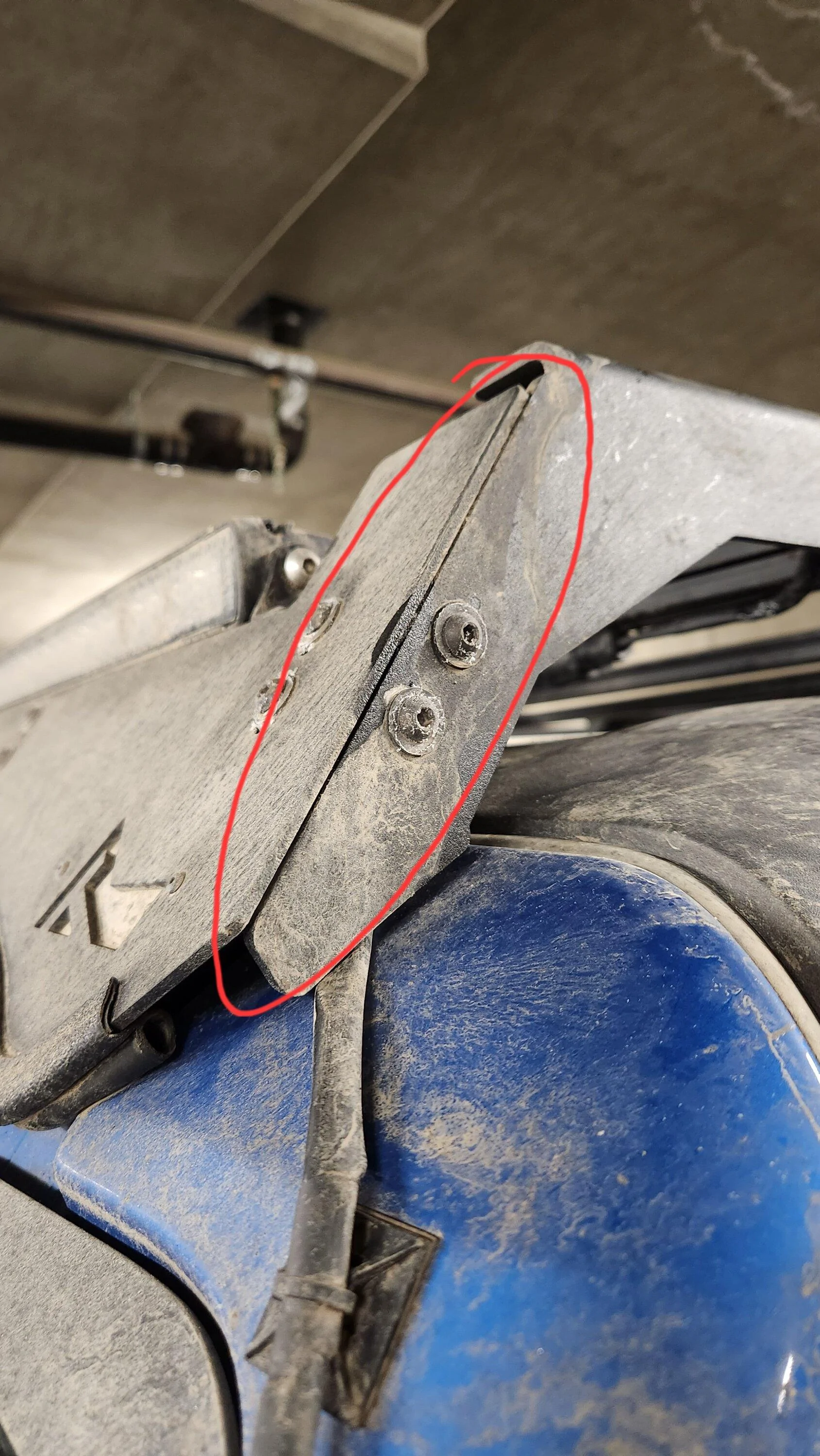

I had a squeaking coming from the front of my TRMR rack when I first got it, figured out it was the fairing rubbing slightly against the side rails.
I put some felt on the side rails where it contacts the fairing so it's not just metal to metal and the squeaking went away. Hope that helps!

The edge that's circled in red is where I found the squeaking on my rack to be coming from.
I just used stick on velcro (the soft part of it) and cut it into strips to fit the edge. As soon as I applied it and took it offroad for a test there was no more squeaking.
