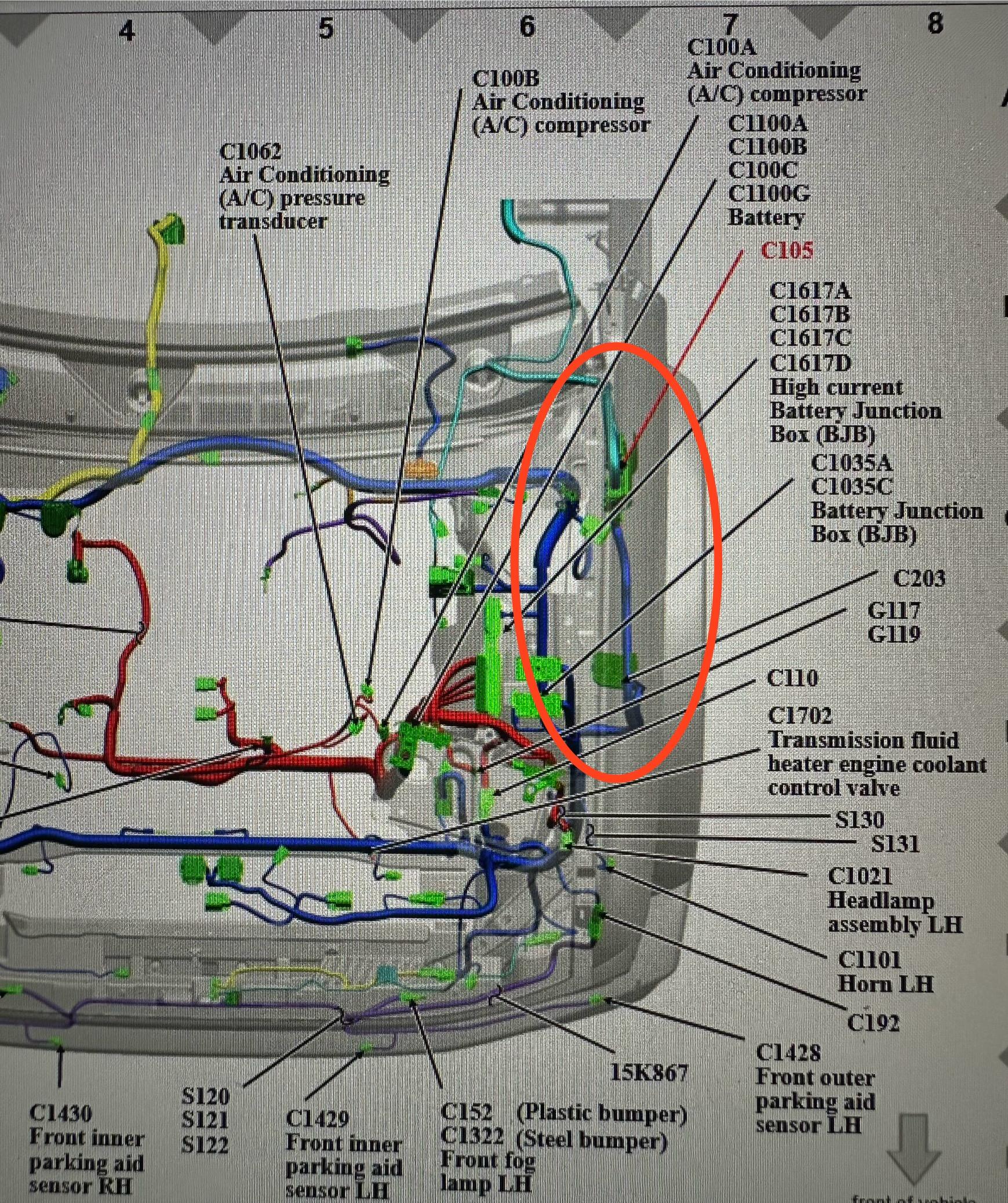

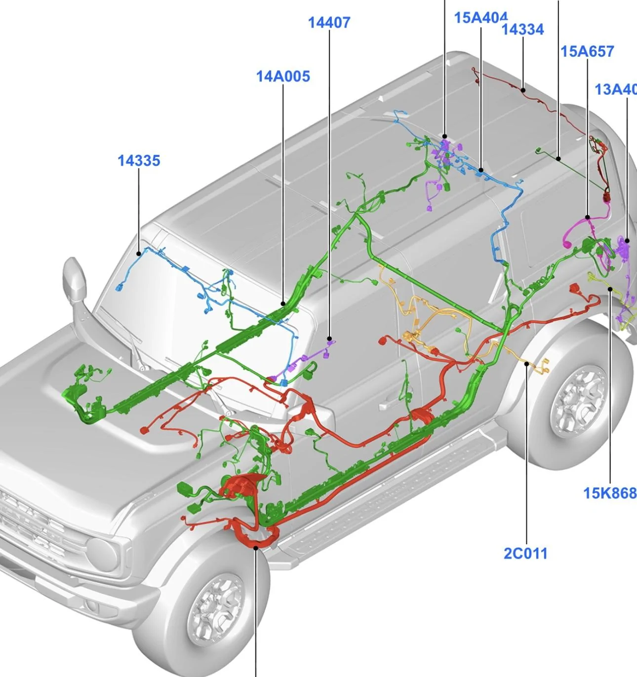

Yeah that’s difficult to go off of. Some of these DTCs I can’t even find in the workshop manual which is odd.
My best guess would be to look under/near the LF fender liner or even in the engine compartment near the EBB area. There’s a large connector that has the circuits for the fuel tank pressure sensor and fuel pump control module that you have DTCs for. This is also an area where I could possibly see typical rodent activity. Connector C105 in the first picture, then the red harness in the second picture is where it runs from there I believe.

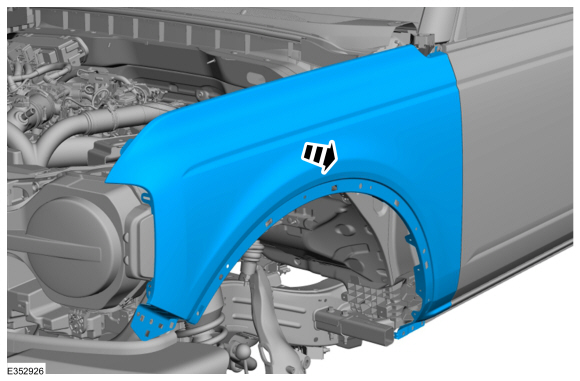

Hahahahahaa I found it FINALLY
Does anyone know how to take the driver side front quarter panel off?
Tex
Tex
Cliff
Nov 15, 2021
1,382
2,437
San Angelo
That's exactly where it was! I found it right before you posted, that exact connector has some wires chewed through, fortunately it looks to be an easy repair if I can get the quarter panel off.

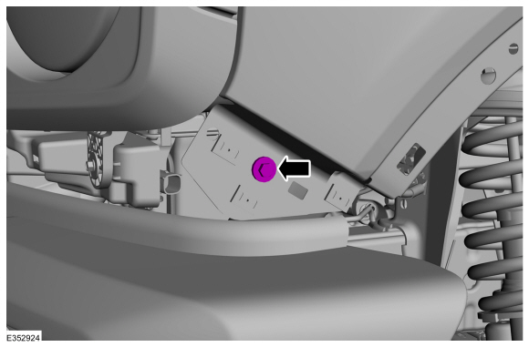

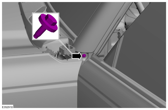

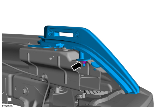

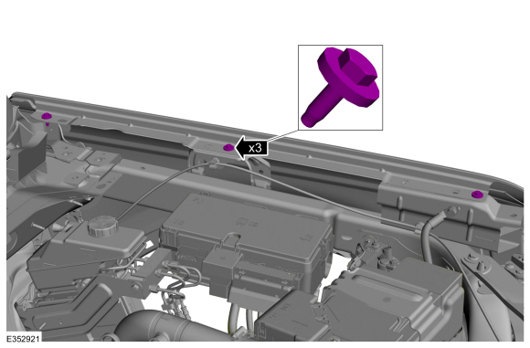

501-02 Front End Body Panels
2022 - 2023 Bronco
Removal and Installation
Procedure revision date: 05/24/2021
Fender
Removal
NOTE:
Removal steps in this procedure may contain installation details.
NOTE: LH side shown, RH side similar.
  1. Remove the front fender moulding.
    Refer to: Front Fender Moulding (501-08 Exterior Trim and Ornamentation, Removal and Installation).
  1. Remove the fender splash shield.
    Refer to: Fender Splash Shield (501-02 Front End Body Panels, Removal and Installation).
  1. Remove the exterior mirror.
    Refer to: Exterior Mirror (501-09 Rear View Mirrors, Removal and Installation).
  1. Remove the lower fender bolts.
    Torque: 80 lb.in (9 Nm)
Ford Bronco {thread} {filename}

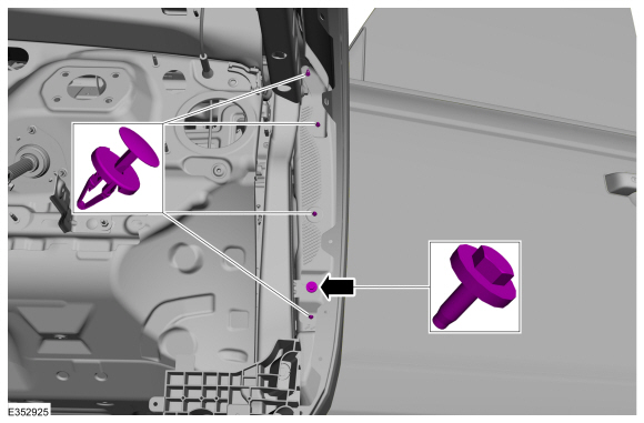

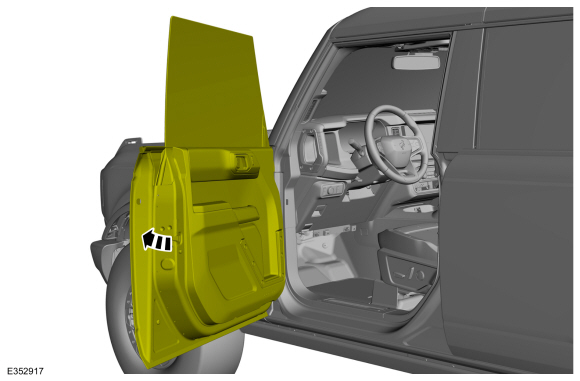

  1. Open the front door.
  1. Remove the bolt.
  1. Remove the pin type retainers and the fender bolt.

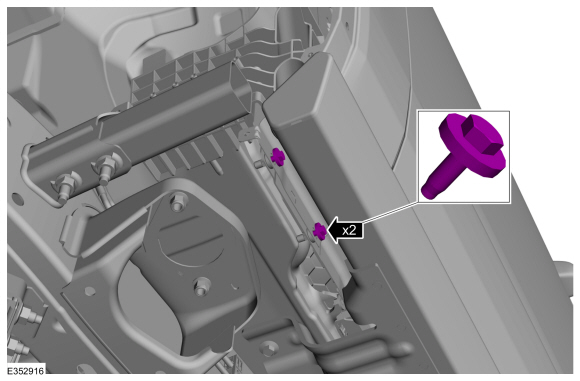

    1. Remove the bolt.
      Torque: 97 lb.in (11 Nm)
    1. Remove the nut.
  1. Remove the nut and remove the exterior bodyside grab handle.

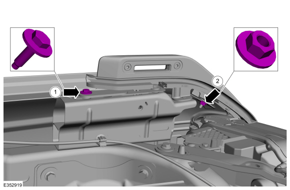

  1. Remove the upper fender bolts.

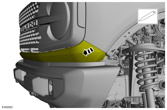

  1. Using a suitable tool position aside the lower corner of the bumper cover.

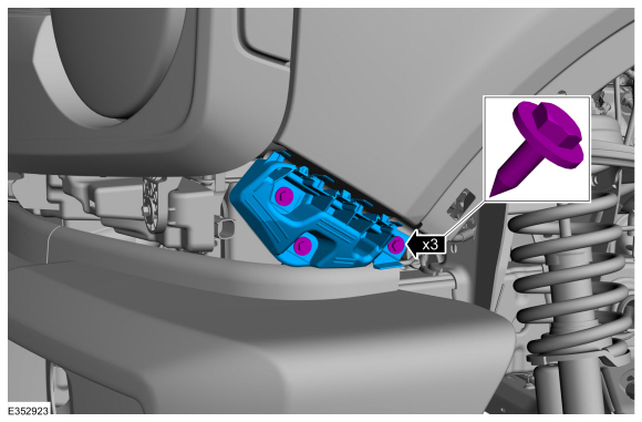

  1. Remove the bolts and remove the bumper cover bracket.
    Torque: 17 lb.in (1.9 Nm)
  1. Remove the bolt.
  1. Remove the radiator grille.
    Refer to: Radiator Grille (501-08 Exterior Trim and Ornamentation, Removal and Installation).
  1. Remove the fender.
Installation
  1. To install, reverse the removal procedure.

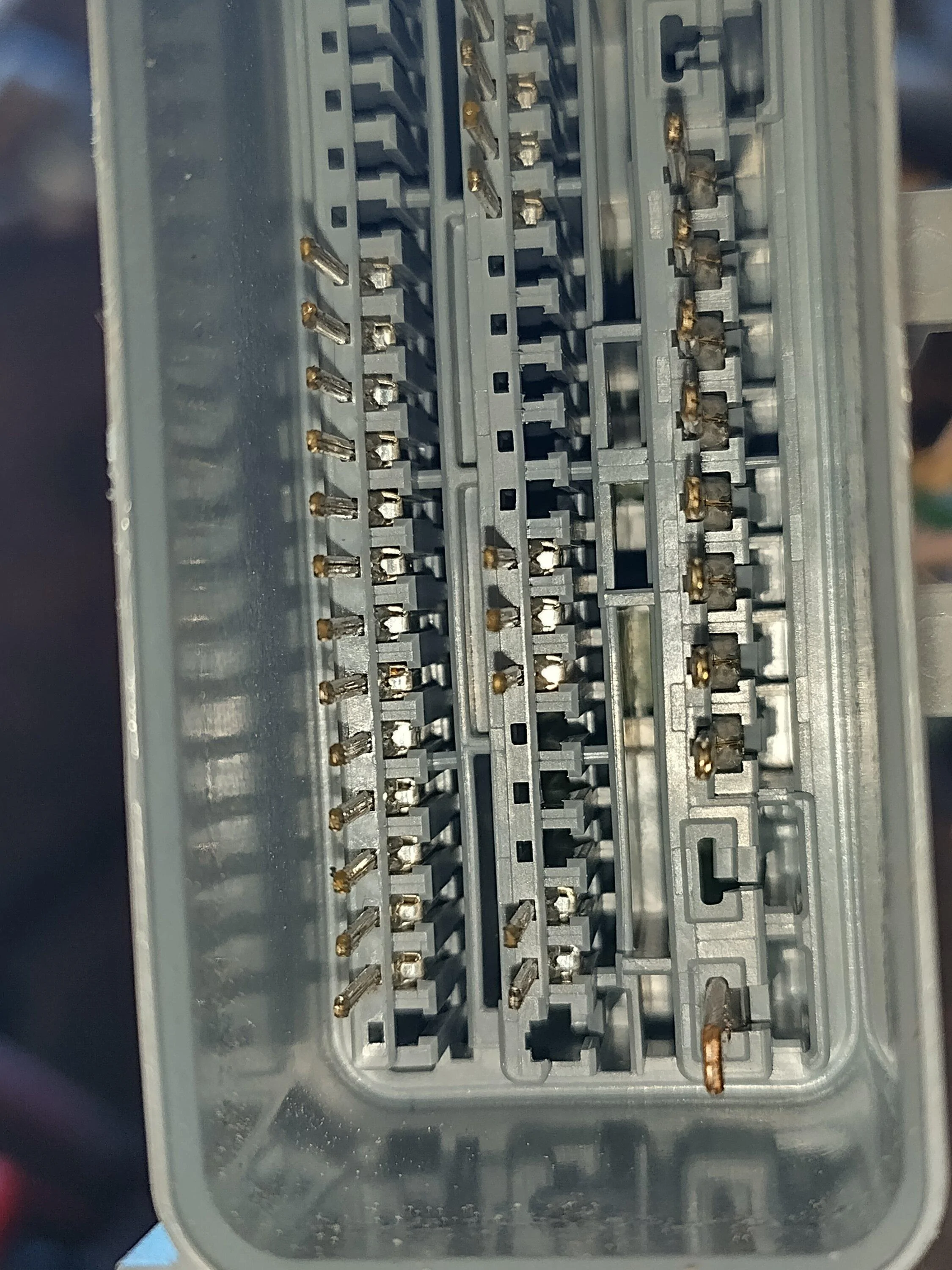

Ford Bronco Squirrel damage (wiring) IMG_20231231_141619_HDR
Anyone know how to de-pin these connectors or what kind of tool is needed?
I'm thinking that little plastic tab toward the back is something I have to pry away from the pin to release the lock, but I'm not particularly interested in prying on random stuff that may or may not be designed for it lol
Edit: I gently lifted it away with one of my lock picks and it released with ease. Now it's just a matter of re-wiring all that damage 😑

In case anyone needs to re-pin one of these connectors, it's actually quite easy if you have a thin enough tool. In my case it was a lockpick because that's what I had readily available, but a micro size flathead screwdriver or a pick or whatever will fit can do the job as well. You need to move the locking tab away from the pin and it'll easily slide out, I've highlighted a few tabs in this pic:
The wires on the opposite connector are color coded identically, so you shouldn't have any trouble getting the pinning wrong if you reference that, but maybe take a few pics regardless just to make sure before digging in. The total damage for mine is 15 factory wires that need spliced or otherwise repaired (13 on this connector and 2 on a different one), and three aux wires that I installed for lights and whatnot. I've got plenty of work ahead but it certainly could've been worse.
