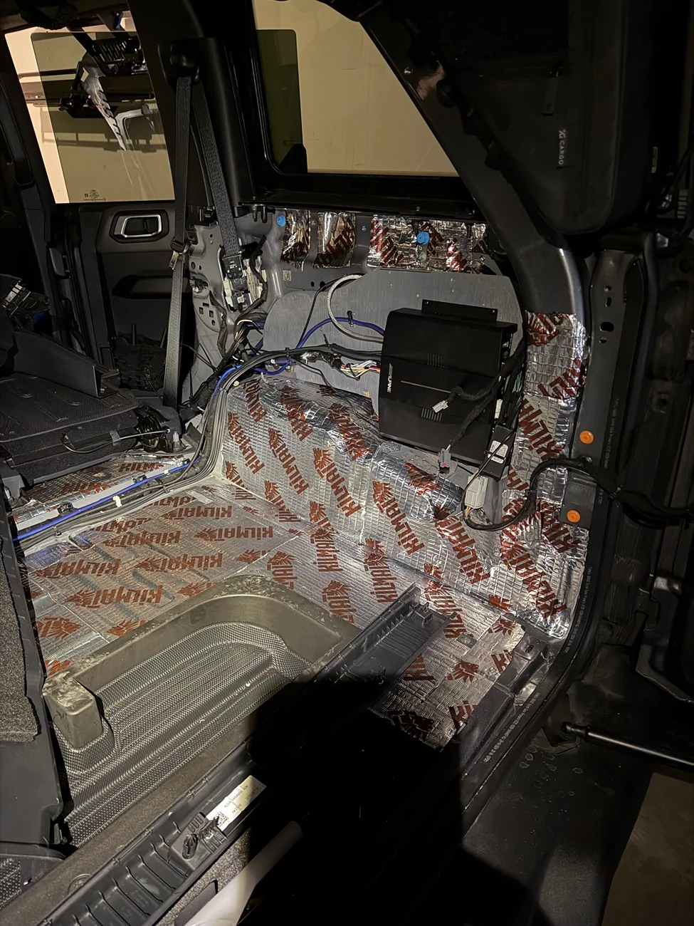

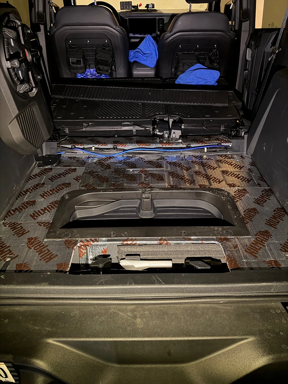

It’s actually pretty complex and like another user suggested fairly expensive to upgrade your system. First thing is it the B&O center channel sub system or standard 6 speaker. I have 24 Big Bend SAS, non B&O system.
There a number of ways to mod, I would stay away from the kicker 200.4 plug and play system that is out there. The front dash speakers are wired in parallel to the side panel speakers below. So the resistance to these speakers are 2ohms if using factory wiring. I rewired my dash speakers so that they are now 4ohm load. Kicker 200.4 doesn’t drive 2 ohms without overheating. It’s easier to find an amp that drives 4 ohm loads, and factoring limited install space behind the rear cargo side panel and that a sub is totally necessary to complete the upgrade and that you need a DSP to correct sound. Also need Forscan to turn of the factory EQ and send full signal to the outputs, as the rear pods when upgraded to 6.5 coax will not get proper signal until Forscan used. So the pod upgrade isn’t worth much until Forscan is used. I used the Apline PXE C80-88. 8 channel amp with DSP. 50 watts to each 6 channels at 4 ohms. 150 watts for channel 7&8 output to sub. I used a dual voice coil SSV SUB and rewired each voice coil separate to get 4 ohms to each voice coil. I used sound deadening panels from Amazon. The entire result is amazing. I love it!
