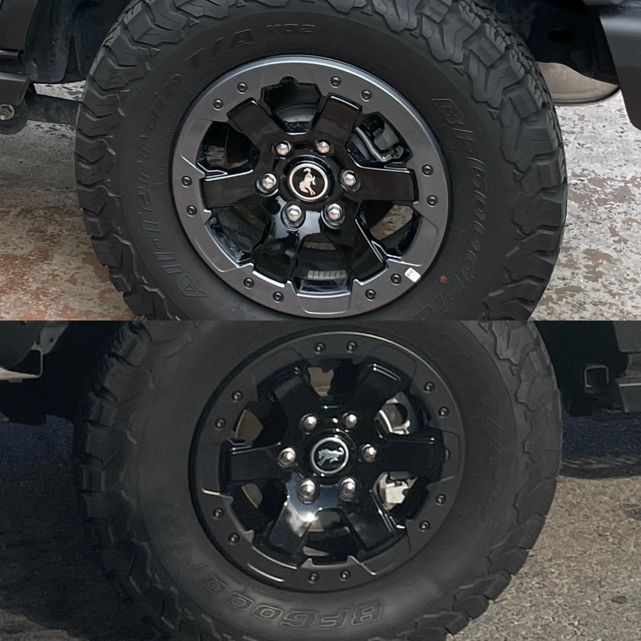

Was curious if anyone had the same nightmare of an experience as I did trying to take off the beauty rings. I plasti-dipped mine in all black, but getting them back on was not a fun experience. Two of the bolts stripped completely, can't even unscrew them off now if I wanted to.
Any tips on how to remove a stripped bolt from the beauty rings would be helpful.
And 3 of them won't even screw in all the way now. No idea why these are hex bolts. So frustrating :(
