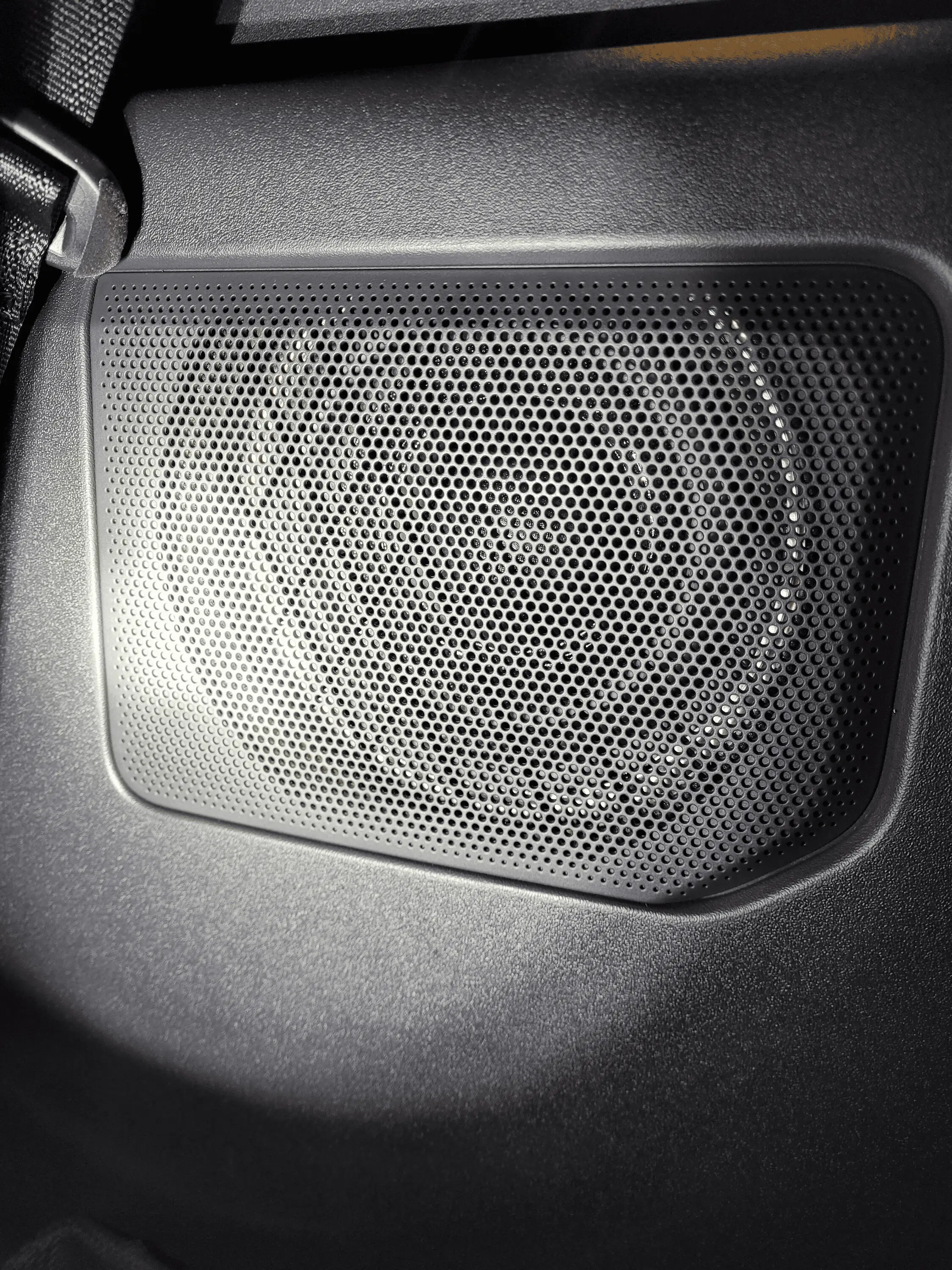

Here is what the fake subwoofer/grille looks like. Yours was probably deleted. Might want to cancel that appointment...

I will have to check that. It was built in early 23. Why would they leave off a subwoofer and give a $250 credit? It sounds awful and there is no $250 subwoofer. If this is the case, is the wiring still there? Can a replacement speaker be added and simply plugged up?
Ford Bronco Subwoofer not working DizzySpeedyDipper-max-1mb
yep, I think you are right. Thanks Ford! 🤬
