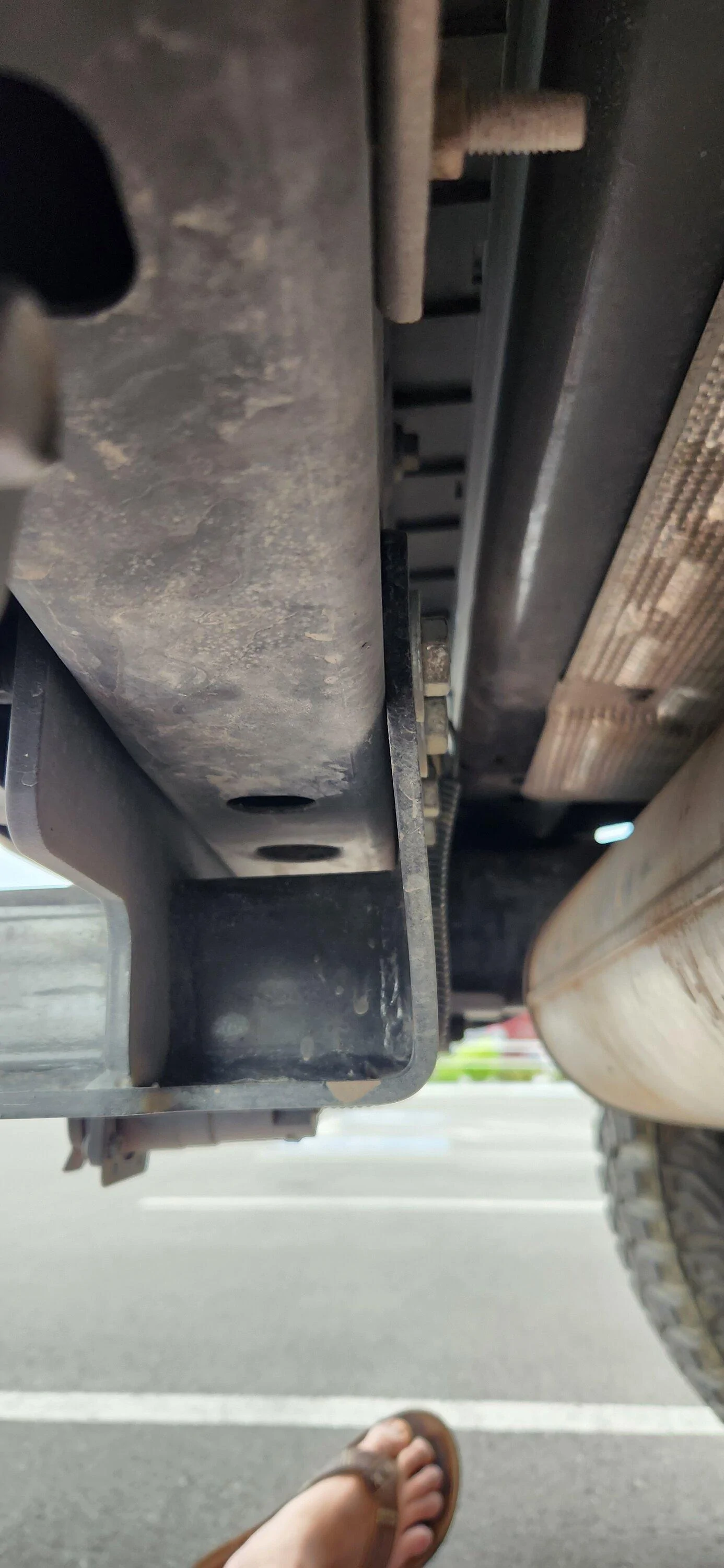

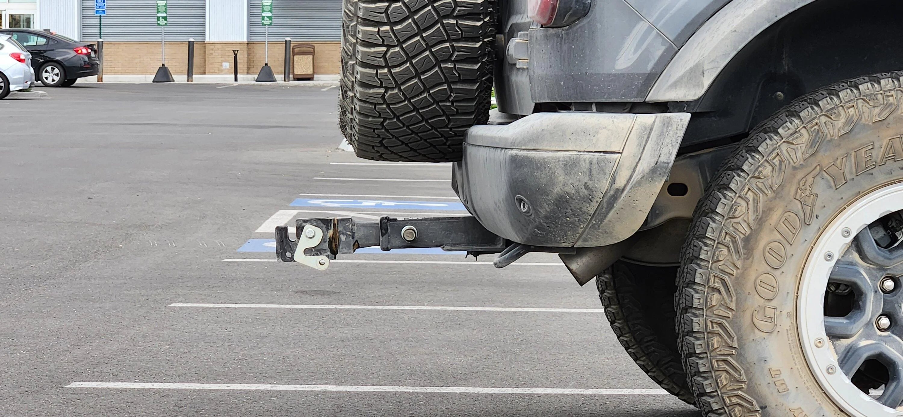

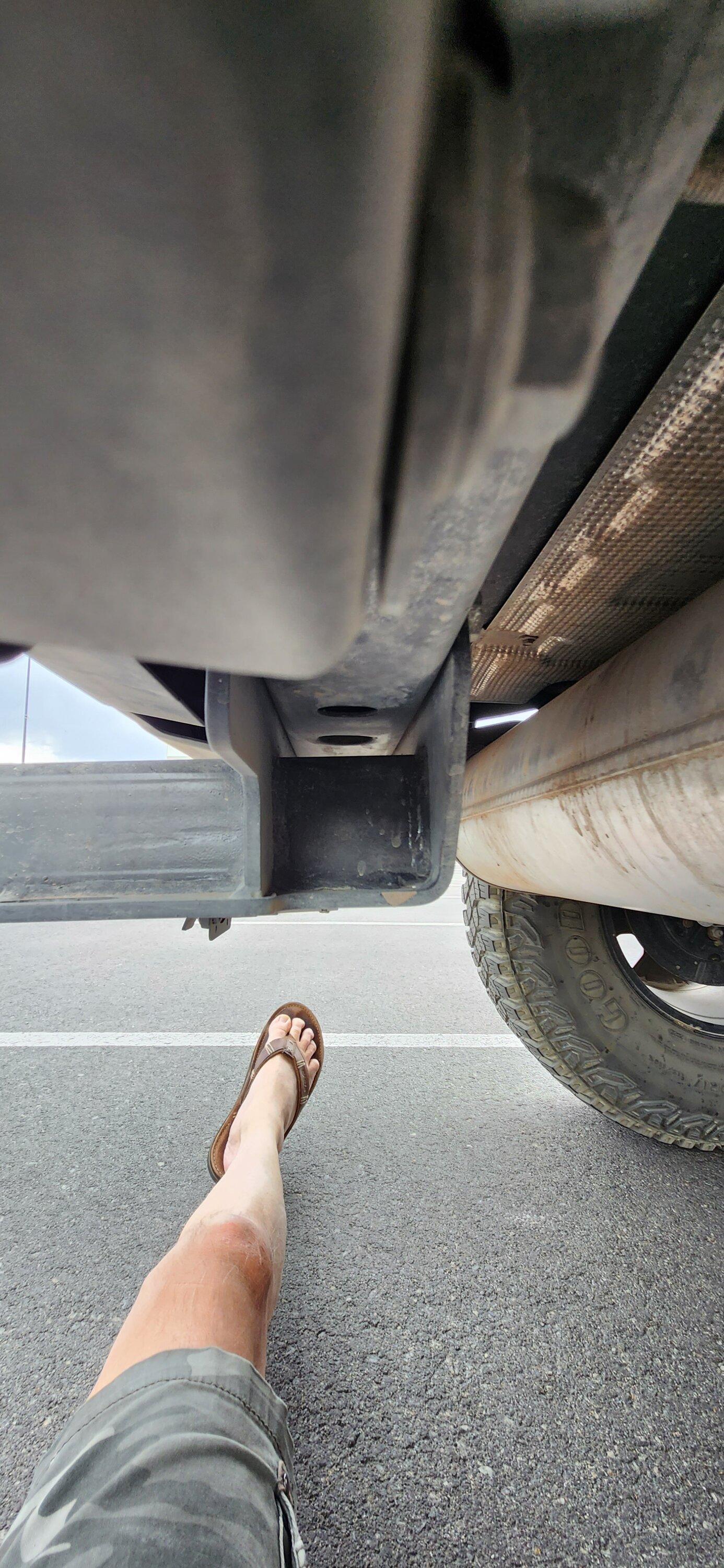

Trip to Moab with off-road teardrop, approx 2,600 lbs fully loaded. Think I bent the hitch. Can see in first pic the hitch is pointing down when it was level previously. Can't tell from hitch receiver bolted on frame pics where the issue is. Cross-member looks fine. Hitch receiver has a very minor bend in back but that was there when I originally installed due to gap between receiver and cross member when tightening bolts. Thought about spacers but didn't do it and the receiver closed the gap upon bolt tightening resulting in a slight bend in the receiver wall against the frame. But this was all in specs of install. Can't tell where new bend is.
Took it easy on her, was my first trip. Mostly fire roads. There were some minor technical sections but took it slow and easy. There was one washout dip on a paved road that came up suddenly when I was going about 15-20 mph that bounced things around a bit.
Questions, how do I confirm no damage to frame cross-member? If that is confirmed maybe I can warranty hitch and install with washers to close gap. Any other hitch receiver/frame cross-member strengthening solutions yet? Thanks in advance.
We have the exact same problem---I have an expedition trailer and was using an extension and had the same crumpling in the inside of the rear of the frame cross member. Got it straightened with reverse force (ugghh, hopefully not weakening it too much). I bought a new hitch because it was bent too, but it simply tightened up into that crumple. Looks just like yours. I'm now seeking to reinforce somehow. I'm in NorCal too. How did you tackle this?

I had to have the rear crossmember of the frame that the hitch attached to replaced. It's not overly complicated, it's just cut out and a new crossmember welded in. You can have the frame laser measured to confirm if you need it done. Runs about $1,500 to have it replaced. Don't have your insurance cover it though bc they f'd me at renewal, bastards. Also, the hitch that I use has a 1/8" to 1/4" gap between it and crossmember when bolting on. If that gap is not filled with washers or a fabricated piece of metal then the hitch will bend to the crossmember when tightening that can create a fulcrum when under pressure that may make it easier to bend the cross-member. Just an fyi. It may have played a role in my issue.
