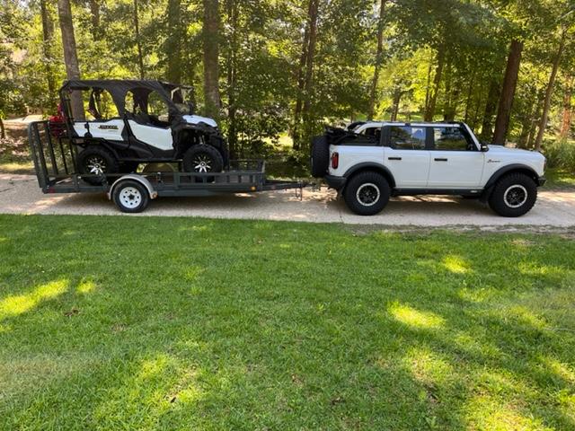

I have pulled my boat it has trailer brakes (This was 55-60mph max) and Drove my Honda Pioneer 600 miles to Windrock and Royal Blue (This was 80max mph) No issues
Ford Bronco Sudden stop, bent hitch. IMG_9771
Ford Bronco Sudden stop, bent hitch. IMG_9805
