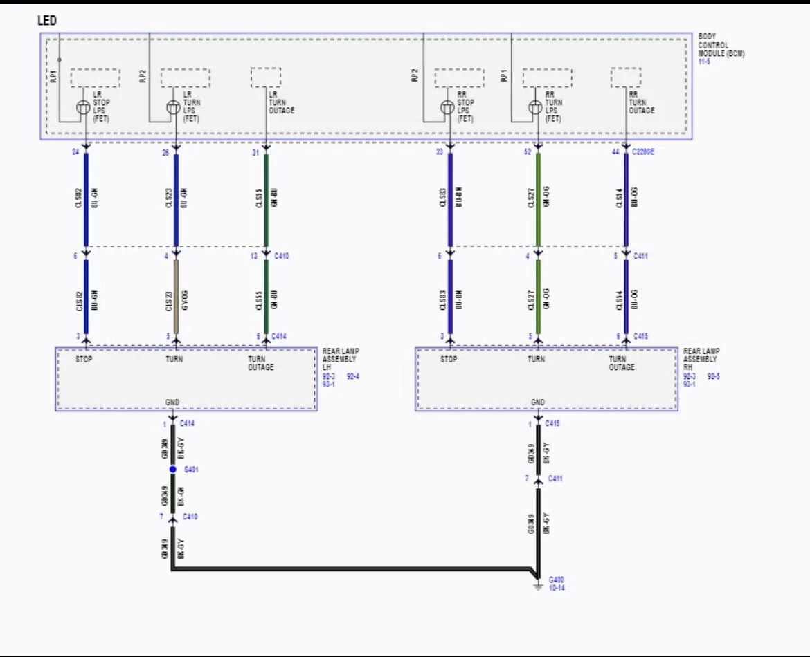

Hi Guys and Girls ,
I recently ordered the XKglow spare tire light as my third brake light. However while trying to install It I did not know which color went with what ( reverse /right signal/ left signal) for my bronco. Does anyone know which color goes with which. Please let me know you are my only hope obi-wan
https://store.xkglow.com/catalog/pr...ke-running-reverse-and-turn-signal-functions/
I messaged them they said they were making one for the bronco. But best of luck to get it to work.
