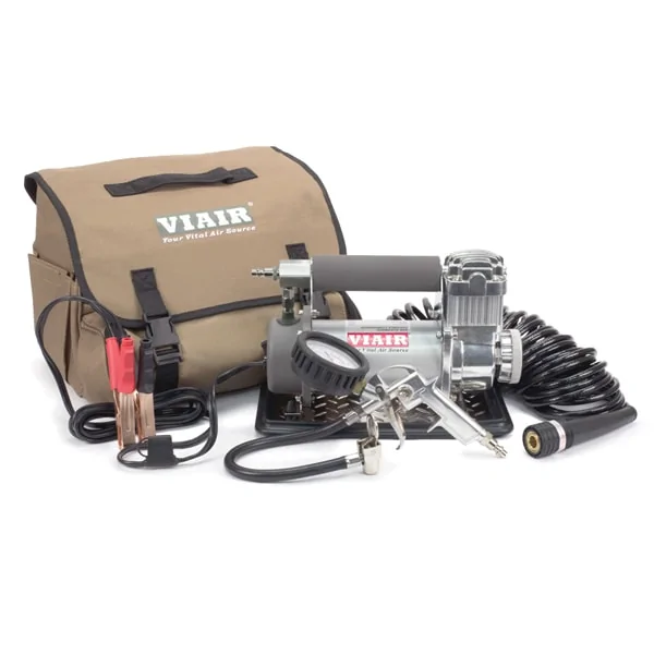

Arb dual will fit above the oem muffler. It goes in front of it on the big flat spot.
I’ve been running a knock off arb dual in that spot for 6 months. No issues.
If you take the oem exhaust out you can fit a air tank in that location.

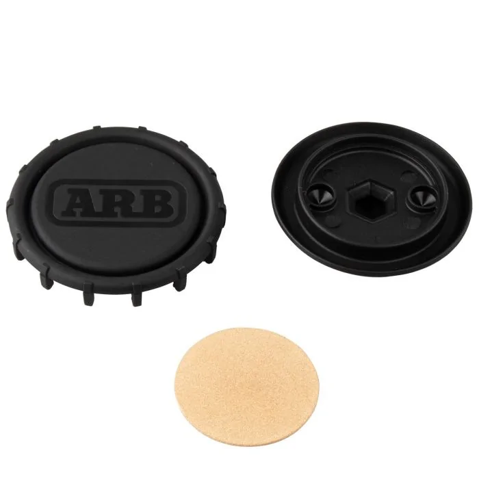

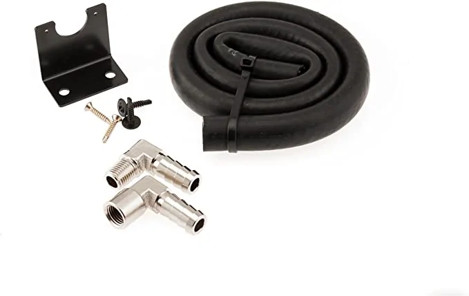

ARB makes filter relocation kits. I posted about it in another thread, so that is an available option if you are intent on installing the compressor in the undercarriage.
ARB compressor filters are very simple — sintered bronze filter disks inside plastic filter housings — and they’re very easy to maintain.
Simply remove the filter cover from the filter housing to expose the sintered filter disk. Remove the disk and place it under running water for a quick and thorough cleaning. If the compressor is used often, best practice would be to clean the filter during every engine oil change.
And if the filter location is not ideal, simply relocate them back inside the cargo bay…
I'm not set on the location... and I was half joking about a snorkel kit. I'm also torn between the advantages of a built-in system versus a portable something.

Weird thing is, nothing hits that spot.
I have a legit Arb dual under the hood, second knock off was added for more flow/back up. Arb is 150psi cut off. Knock off is 100psi. Both are fed into a 3 gal air tank. Both have run at the same time for 6 months with no issue. Both get used multiple times a weekend.
Is the knock off as good as the Arb? Not sure. Have both run without issue? Yes.
$335 for the knock off. Or should say unbranded version.
