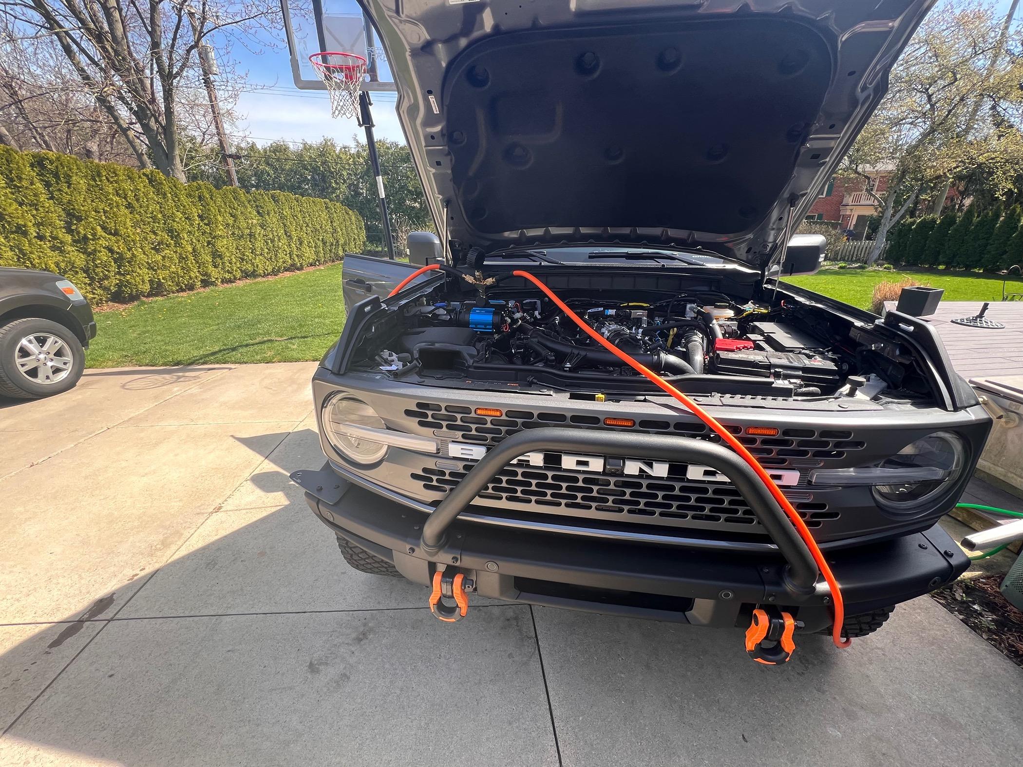

OP, kudos on a nice neat install, but if yours gets as hot as my engine bay mounted twin does, I think you’re a fire waiting to happen. The reason I bought the ARB twin is the 100% duty cycle. It gets really hot by the end of airing up the second vehicle in a row on an 80 degree day.
In the pic below at Sand Hollow, the fasterflate chucks would burn one’s hands by the time the jeep was aired up.
Please be very careful. Take care.

Ditto on that. Mine is mounted exactly the same in this photo. I also pump up 4 tires at once which takes 15-20 minutes. I need to let the fittings cool down before removing from the compressor. And that is in 60F ambient temperature. Would be even worse in summer or southern heat.

Thanks for the heads up. I’ll be doing some testing on the compressor after the 2.8 gallon tank is installed to see what I’m getting on temperatures. Both with the drawer/slider closed and open as open provides a whole bunch of cabin air. Also looking at auxiliary fans for pushing and pulling out of the enclosure. I’ll post updates when completed
Worst scenario would be to spring for the DV8 metal tub, with its larger size and and higher cost, but inability to melt. I also have the ARB single in my engine bay, and it gets quite hot during inflation, along with the fittings. Compressing air produces heat, true for all my previous compressors. Will also be interesting to see if your off-brand compressor lasts.
