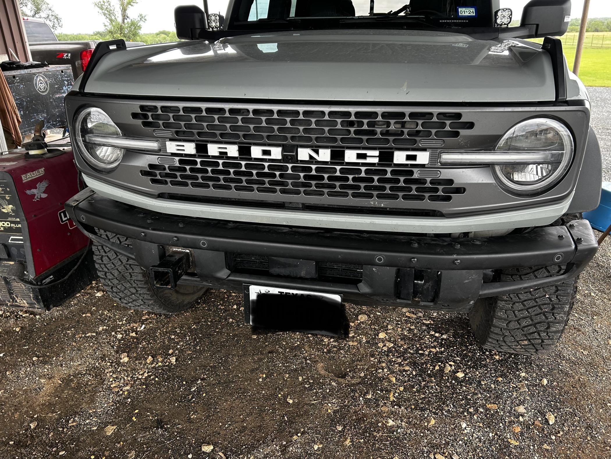

Does anybody have the dimensions of the front tow hooks? specifically the plate width and height which mounts to the frame. I am trying to create a plate to install in the tow hook location with a receiver hitch for a front mounted deer feeder.
I just haven't taken mine apart yet to measure.

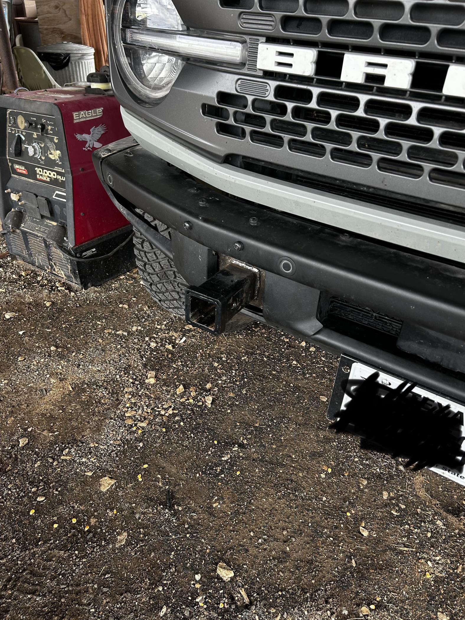

Really just need the dimensions so I can find a piece of plate metal the right size.

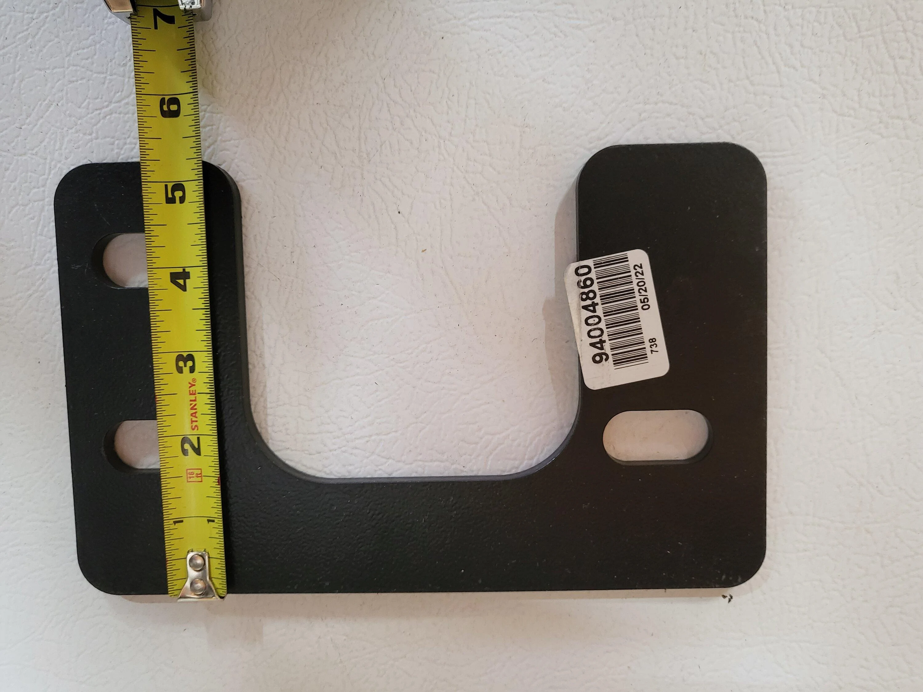

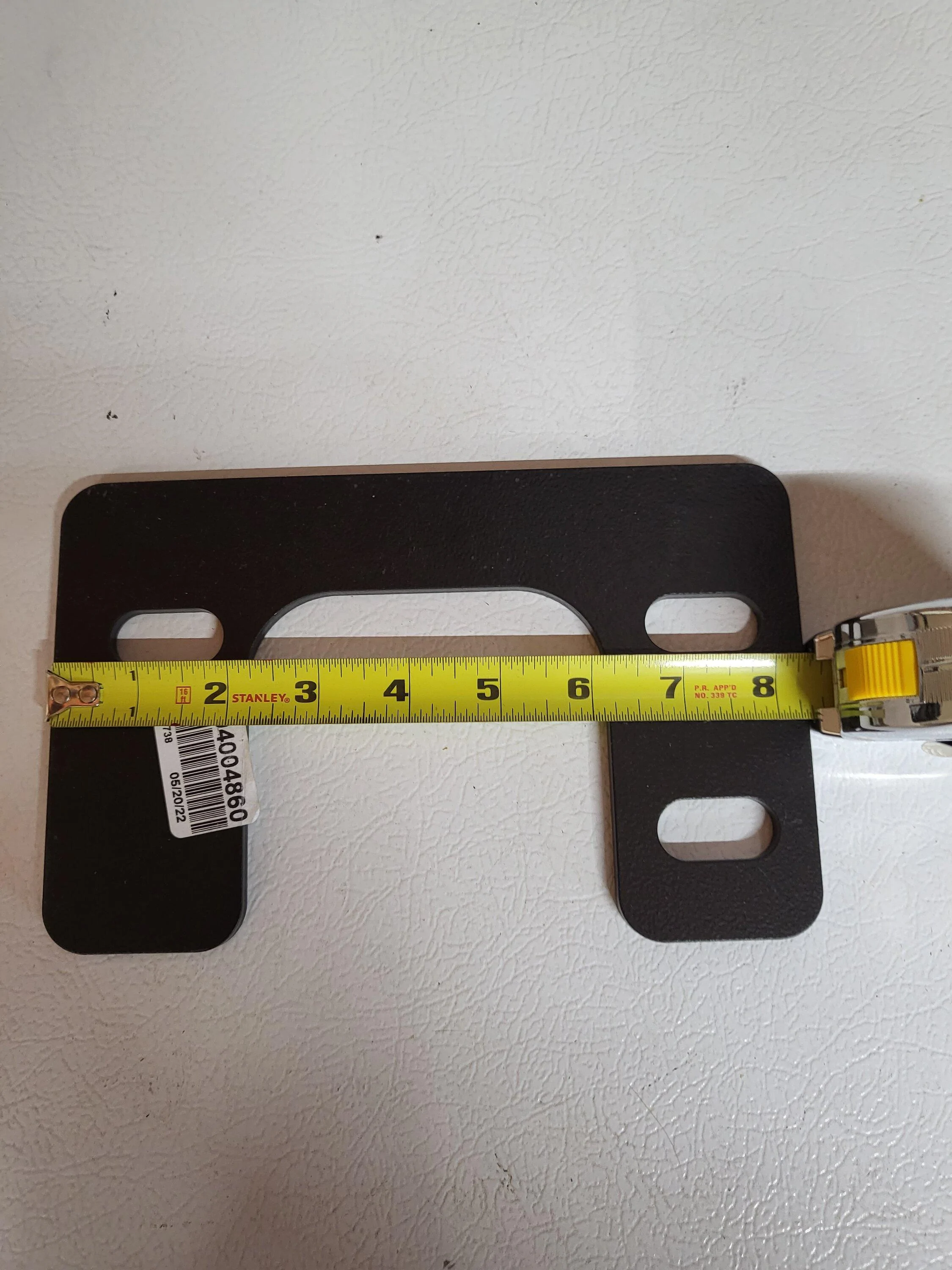

Sorry, it is
Ford Bronco Tow Hook Dimensions 20230518_154423
Ford Bronco Tow Hook Dimensions 20230518_154411
the smart ass in me. RC sent these plates for a winch mount that go in the mod bumper tow hook area. 8 3/8 x 5 1/4. Might be able to order from RC, Part no is on sticker.

Sorry, it is
Thanks a ton!

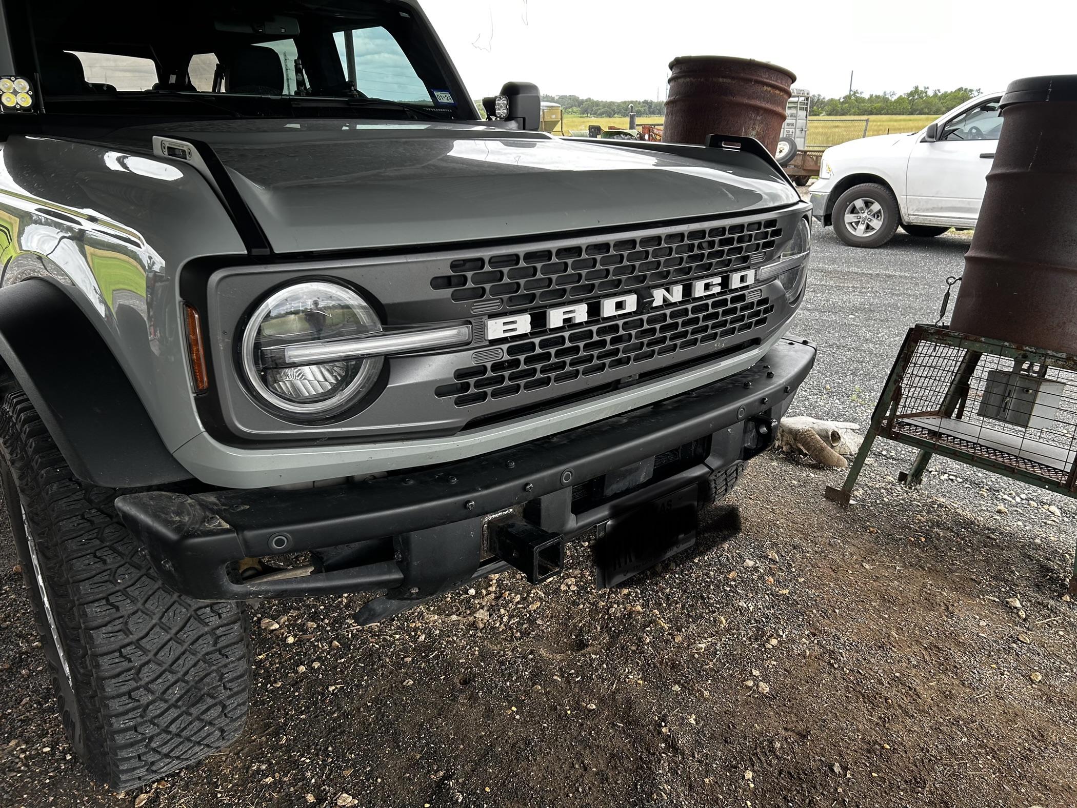

Ford Bronco Tow Hook Dimensions CDB4479E-2332-4615-A2BB-F9A5C059258E
Ford Bronco Tow Hook Dimensions B19CB604-D450-4220-B367-3F89ECB25107
Ford Bronco Tow Hook Dimensions 719CA1C3-5D1B-4765-B88A-337AC889BAD6
Ford Bronco Tow Hook Dimensions 0175B003-7868-48C8-99B5-CD816F1E6B08
Ford Bronco Tow Hook Dimensions FD0211CB-EBA5-4C92-828A-0991703A5813
Ford Bronco Tow Hook Dimensions 138CFDA4-DA72-4D1D-8574-A4CD79611AA9

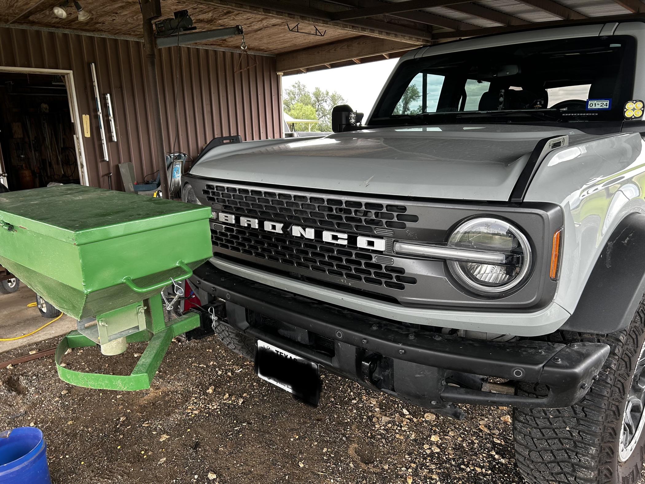

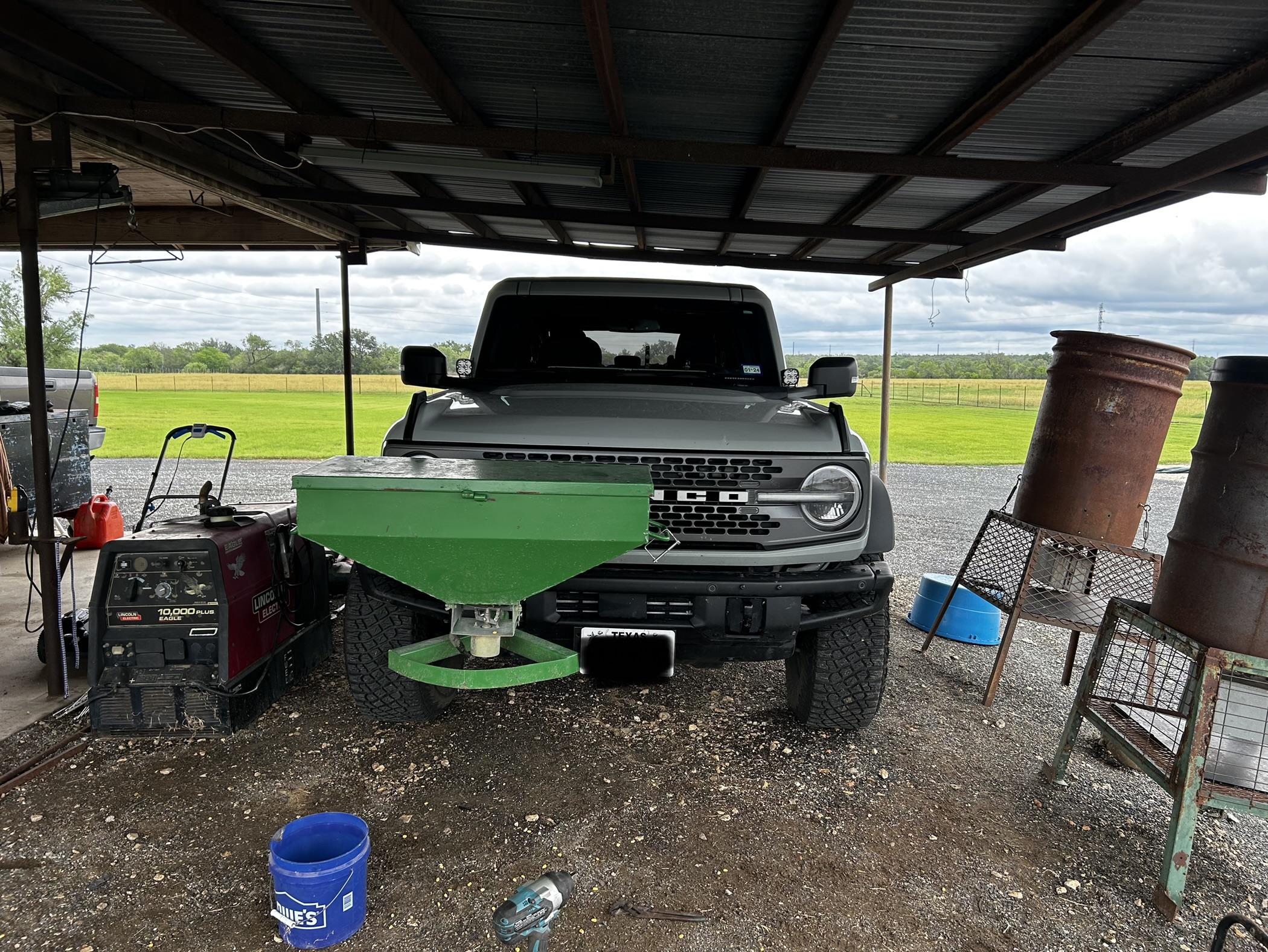

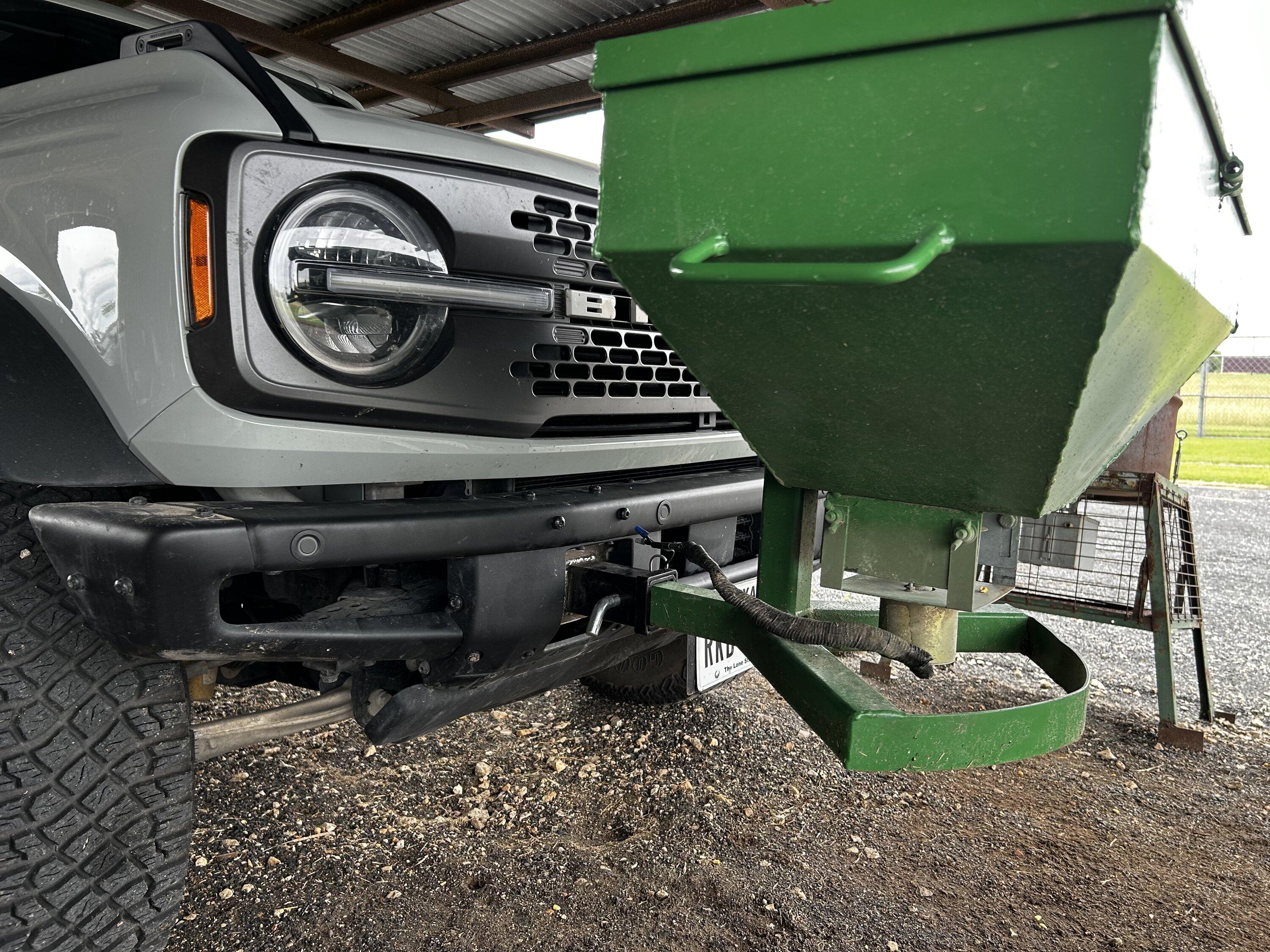

turned out pretty good
