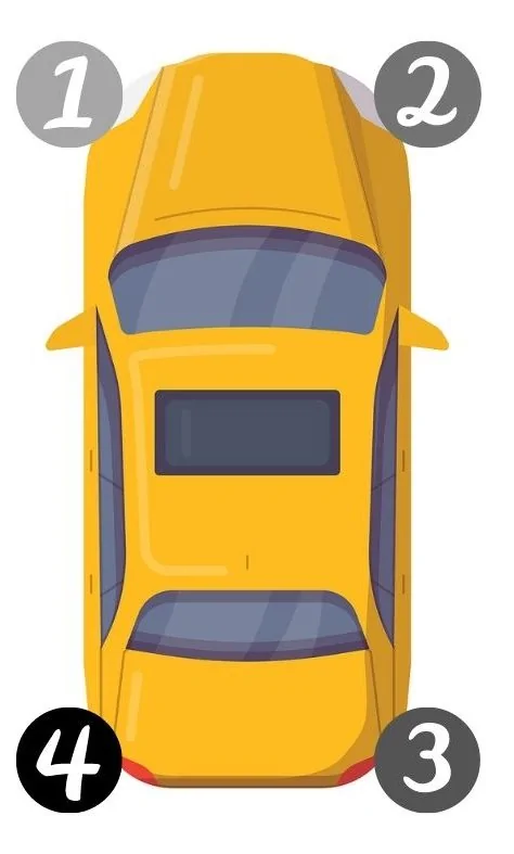

Part 1: Activating Tire Pressure Monitoring System Reset Mode
  1. Place the ignition in the off position and keep the key in the ignition.
  2. Without starting the engine, turn your key to the ON position.
  3. Quickly switch the hazard flashers on then off 3x.
Note: Once your vehicle enters TPMS reset mode, the horn will sound once and a message will appear in the information display. If this does not occur, repeat the sequence.
Part 2: Re-Training Your Tire Pressure Sensors
  1. Decrease the air pressure in the driver-side front tire until the horn sounds once.
  2. Decrease the air pressure in the passenger-side front tire until the horn sounds once.
  3. Decrease the air pressure in the passenger-side rear tire until the horn sounds once.
  4. Decrease the air pressure in the driver-side rear tire until the horn sounds once.
  5. Turn the ignition off.
Note: If at any point in the re-training process two short horn beeps are heard, the reset procedure was unsuccessful. Please try repeating the sequence from PART 1: Activating TPMS Reset Mode.

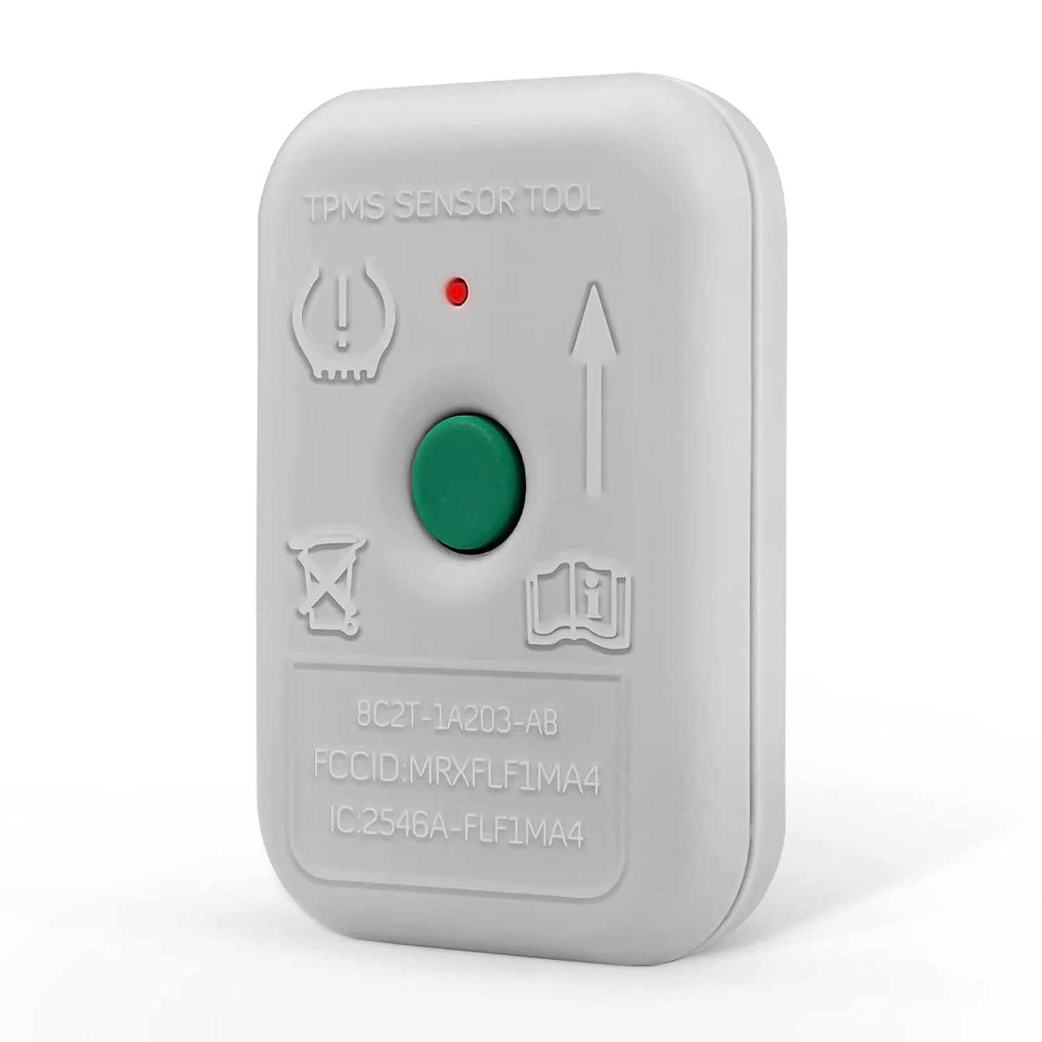

I am starting to think they have to be programmed. Can they be programmed after install?
I bought new Schrader (oem part numbers) sensors when I did wheels/tires and the Bronco would not pick them up. The dealer wanted $199 to program them so I checked with several tire shops. They all wanted $30-40 a tire to program them but since I wasn't even sure if they were transmitting, one shop went out and checked them for me (at no charge). He was getting a signal from all of them so I went and bought the generic Ford TPMS19 tool off Amazon and went through the procedure to relearn the sensors and it worked fine. Here's a link to the tool Amazon.com: OBDMONSTER TPMS Sensor Tool TPMS Reset Sensor Programming Training Tool Tire Pressure Mointor System TPMS19 (8C2Z-1A203-A) : Automotive and it was around $13. Ford charges over $50 I think. You may want to go to a tire shop and see if they will check to verify your sensors are transmitting.

2022 Bronco
Thank you for the information.
