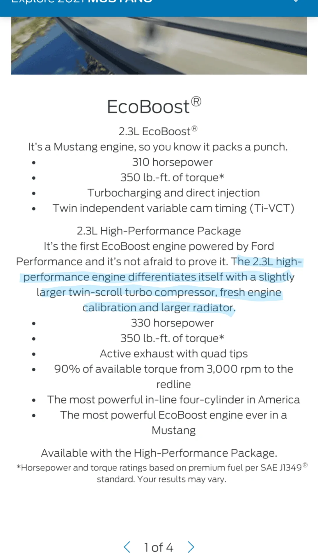

The cars use a very different tune and some with a slightly bigger/better twin-scroll turbo as well. At least the High Performance Package Mustang does for sure, per the Ford literature. Focus RS had many different parts due to transverse layout, and wayyy different goals. They crave higher RPM where as a truck needs grunt down low, coming on sooner and flatter through mid-range.
With newer variable timing engines, it's easy for the OEM to shift power curves around for it's intended application. I've thought about the potential for upgrading to the Mustang HPP turbo down the road after warranty is up, as long as it doesn't harm the low end too much.
