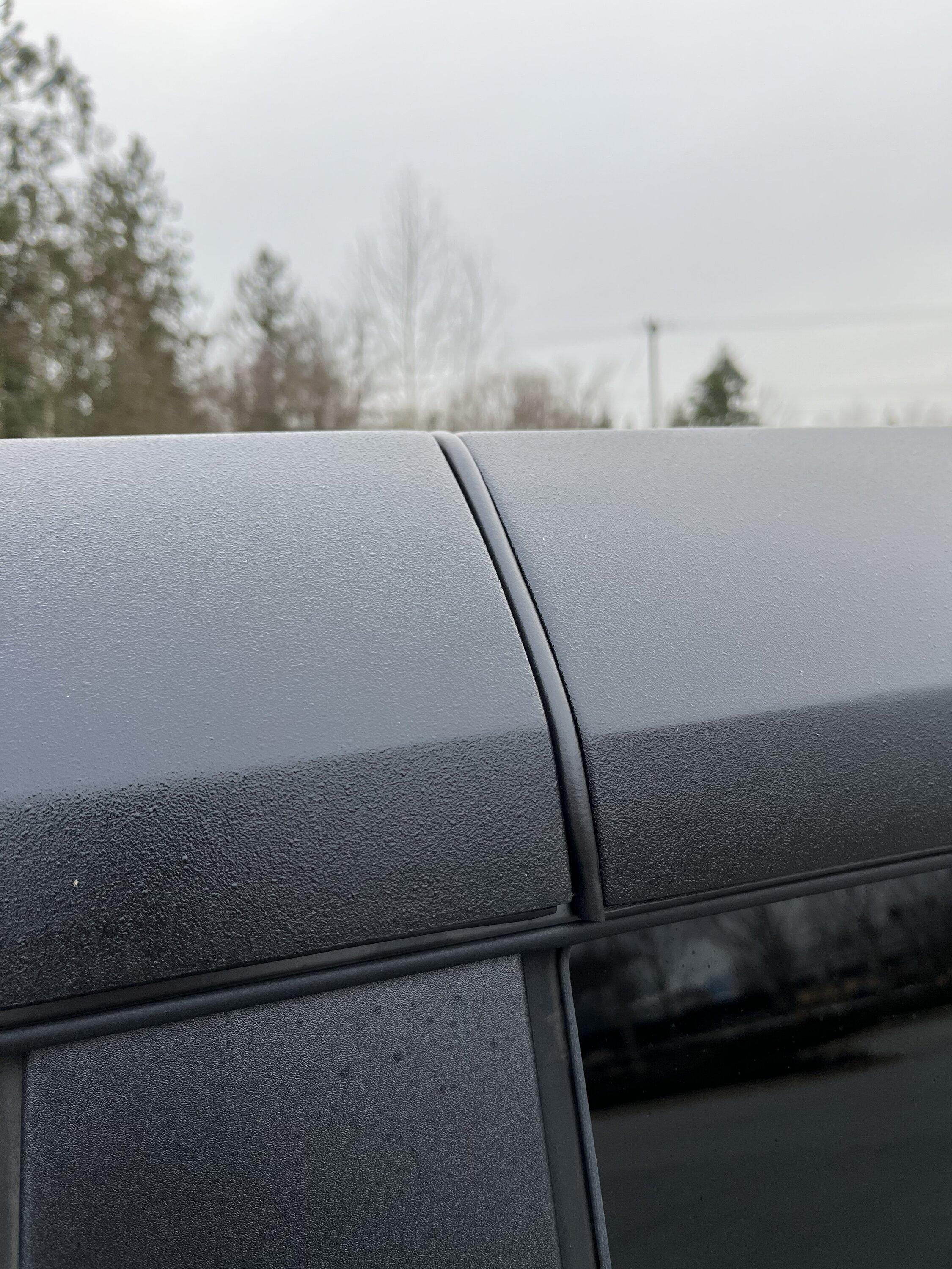

The installation took two people, but it was pretty simple and no major issues. The most time consuming part was adjusting the latches for the targa top – They do seem very secure, and that was one of the concerning points for me initially. I’m happy to say that early days, they seem very good and secure. You may find the paint on the targa top latches prevents the nut from adjusting easily - This was a bit of a pain point, but with some elbow grease you can get it going. Once the paint starts to come off a bit, it's much easier. One suggestion might be to not paint the threads, since they're covered by the latches anyways.
Once the top is installed, you will find there's a bit of a smell - It's just your standard "newly made" product with all the fun glues and epoxies and whatever else is on it. It's not overwhelming, but you will smell it and I anticipate it'll dissipate quickly. Also, you will notice in my pictures below that the top is shiny and you can see some fingerprints from the installation. I did not wash the top after installing it, but pretty certain a lot of that sheen will come off with a good wash using soap and water, and some of Mother Nature's rain :cool:
Please note: I do need to adjust the latches a bit further, so I know some of the pictures below show the targa top not pulled all the way down yet.

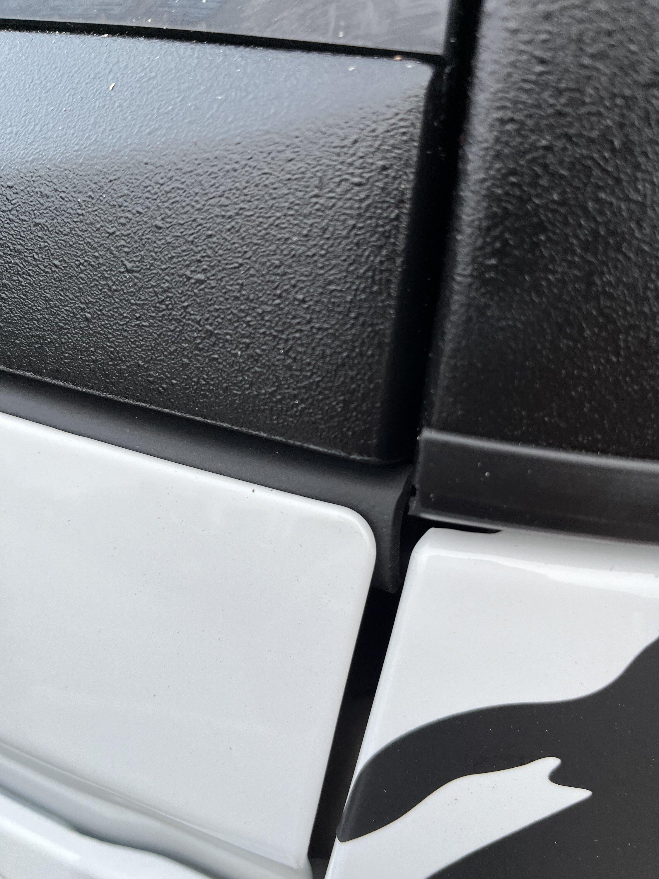

  • The rubber angle pieces that stick to the door don’t seem to stick as well as one might have expected. I cleaned the area, and removed the adhesive backing. The one closest to the door handle is not nearly as secure as the inside one is. Likely will need to re-apply a better 3M tape. Pictures below. On a related piece, there was form attached to these pieces, but I’m unsure if it was supposed to remain or pull it off? It was folded under a bit, so it was not clear at all. Some clarity on this would be appreciated. Pictures below.
TOR Response:
**Rubber Pieces:** The rubber pieces use 3M VHB adhesive, which sticks well initially and becomes even stronger over time, especially after being exposed to heat. If you ever lose one, we'll replace it for free. The foam on the rubber blocks isn't necessary, so feel free to remove it. We used foam initially to see how the blocks fit against the seals, but the final product doesn't include it. If you'd like, we're happy to send you a new set without the foam.

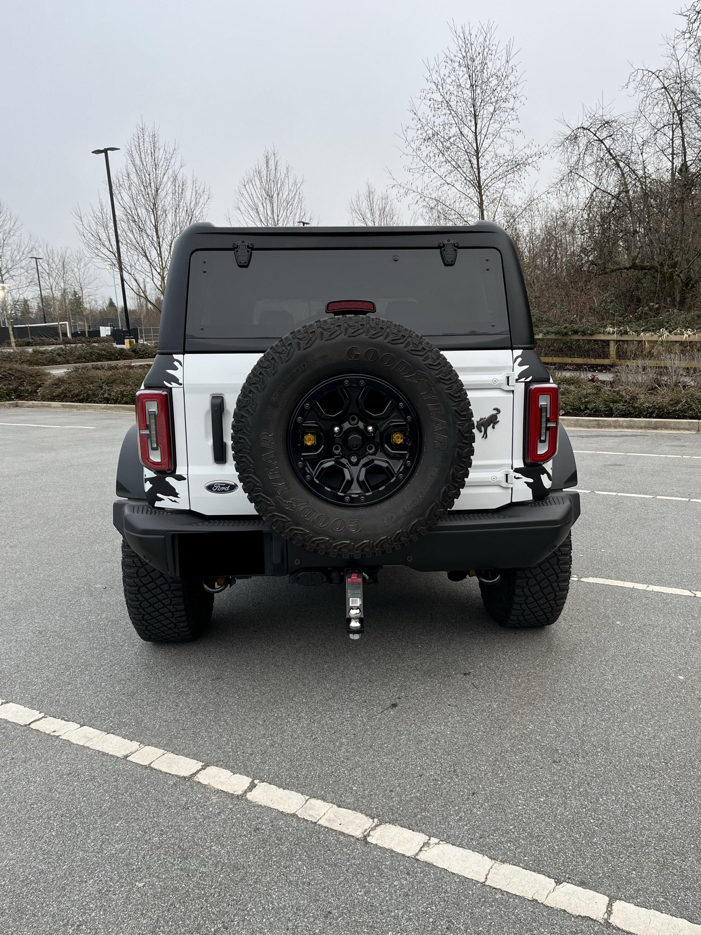

  • The rubber under the rear glass interferes with the cargo door, however, this was mentioned to me from Todd and a fix is already in the works and is being shipped out to customers who have already received their hard tops. This isn’t major, but you do have to open the door > 90 degrees to clear it. This will tear in pretty short order unfortunately, so hopefully the fix is just around the corner and easy to swap out. Pictures below.
TOR Response:
**Rear Glass Interference:** We've updated our design so that the tailgate only needs to be opened to 90 degrees to open the rear window, based on feedback. If you have the older design, we'll send you a new glass and lower fiberglass assembly for free. This update also reduces stress on the rear seal when closing the tailgate. All new hard tops will include this improved design, but we're also offering replacements to our early customers at no cost. The installation is straightforward, involving just two bolts, and we'll provide an installation video.

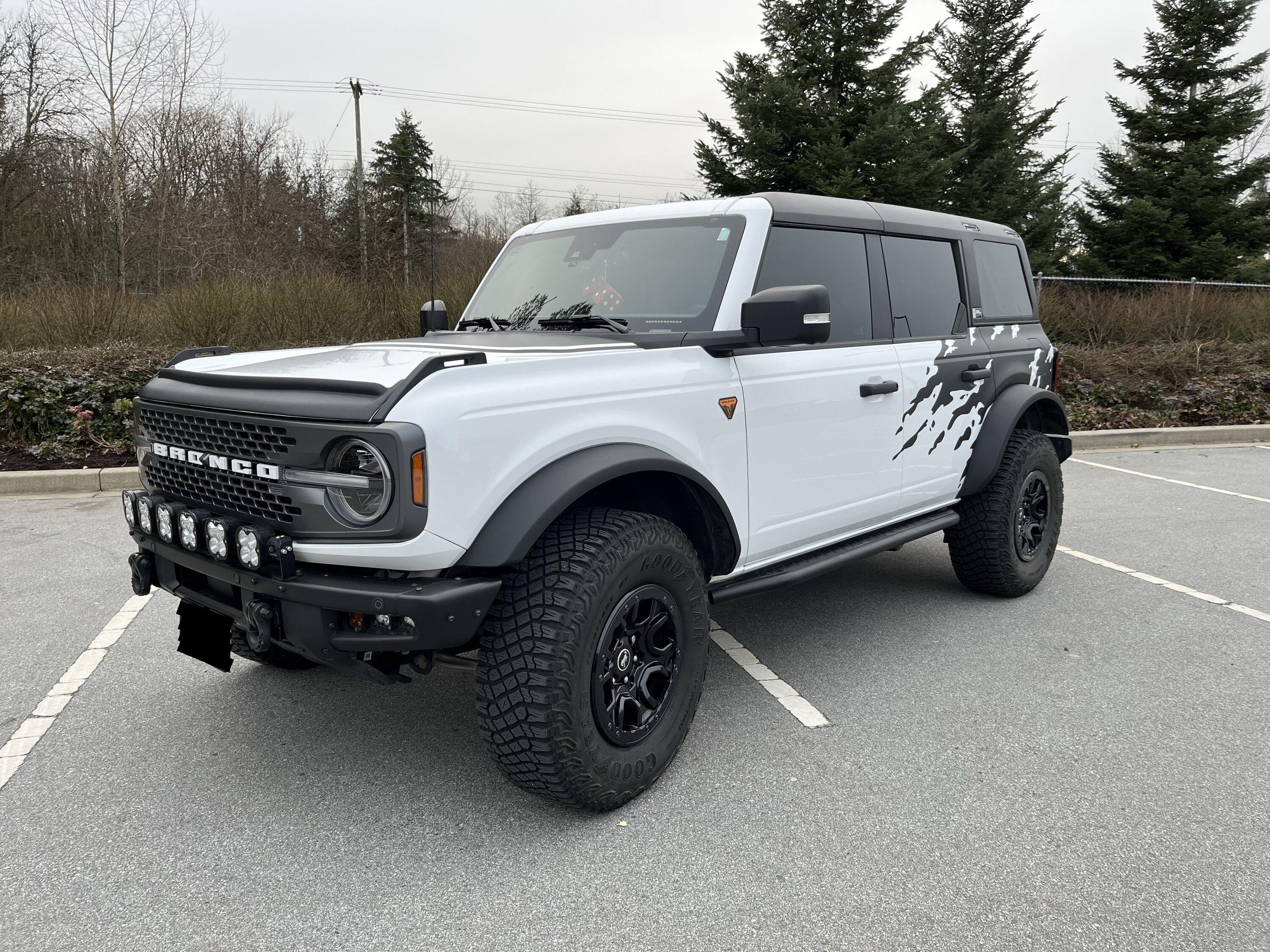

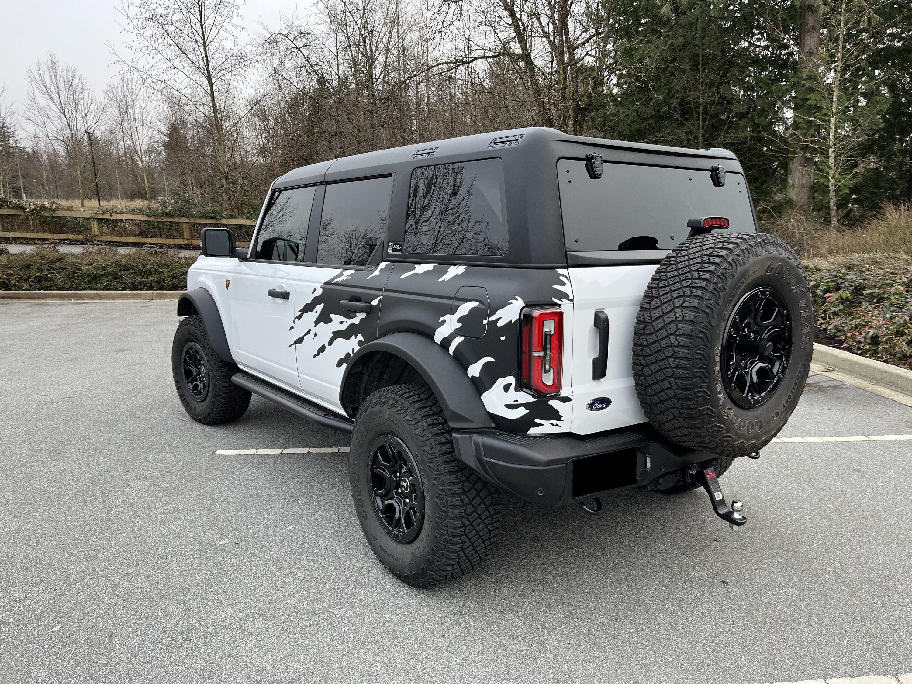

  • The window tint on the hard top is a little bit lighter than the factory tint. You can see this in my pictures. I'm hoping I can have my local window tint place fix this by adding some additional tint. @Turn Offroad - Can you confirm if the glass is tinted with film, or is the tint built into the glass?
TOR Response:
**Window Tint:** The tint is built into the glass with a 20% level, matching the original equipment manufacturer (OEM) hard top. If you want to add film tint, a professional should be able to match the OEM rear door glass closely with little effort.

Great review! Looks awesome with your theme. Kind of a bummer the tint doesn’t match, but like you said it’s a simple fix. Can you clarify better about your last photo / 2nd to last bullet point about the tailgate rubber? I have a MIC top, and you also have to open the tailgate door 90 degrees to lift up the rear window. But that’s just a function of it not clearing, and I think you are trying to say there is a piece of rubber catching or something. Thank you.

Thank you!
Ya, so that last picture you can see the rubber along the bottom of the glass? Well when you open the cargo door 90 degrees, it pinches the rubber. You need to swing it past 90 degrees. However, when you close the door it gets caught up in it again. It’ll likely tear over a short period of time - thankfully TOR acknowledged this before I received my top, and they were already actively working on a solution and would provide the solution once complete. I’m not sure what the fix is, but hoping it’s easy to install.

Got it! Makes sense now. Thanks for clarifying.
