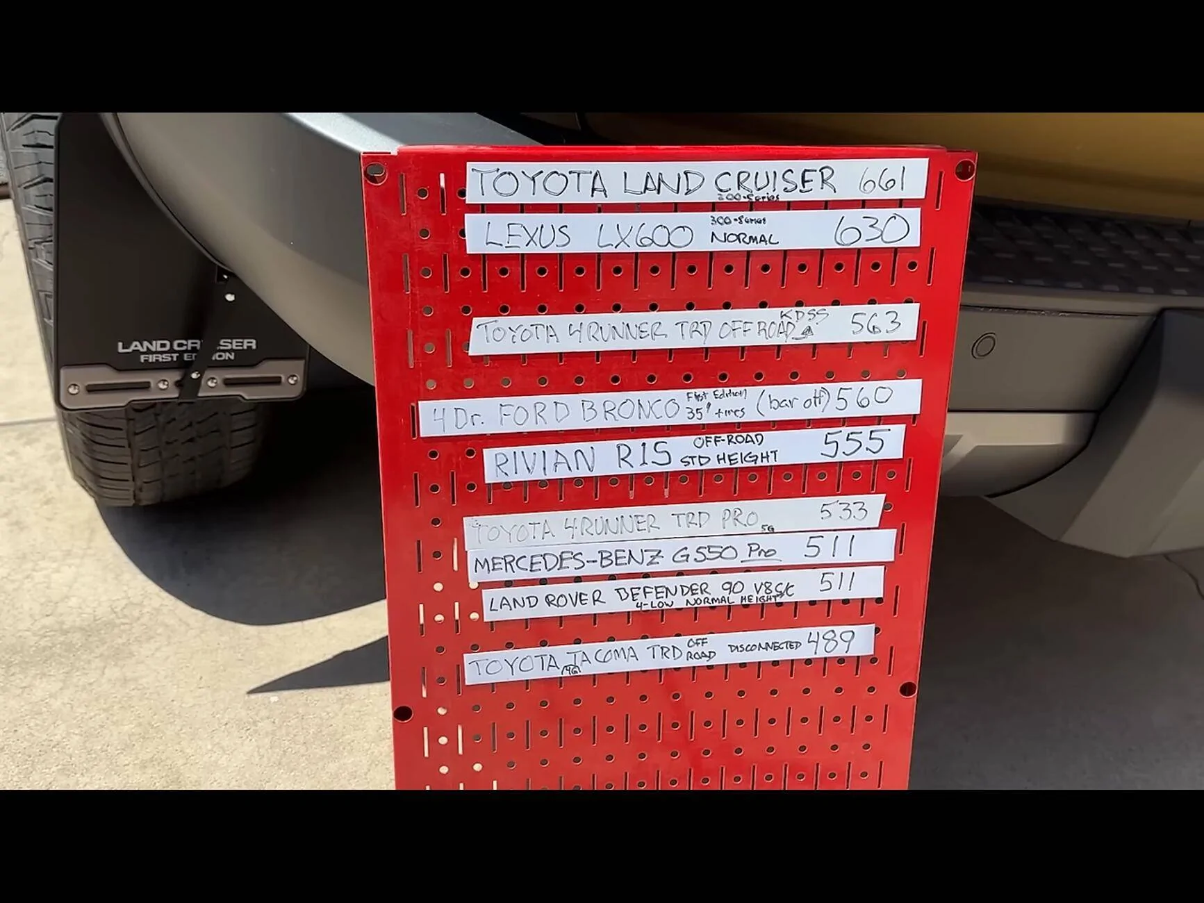

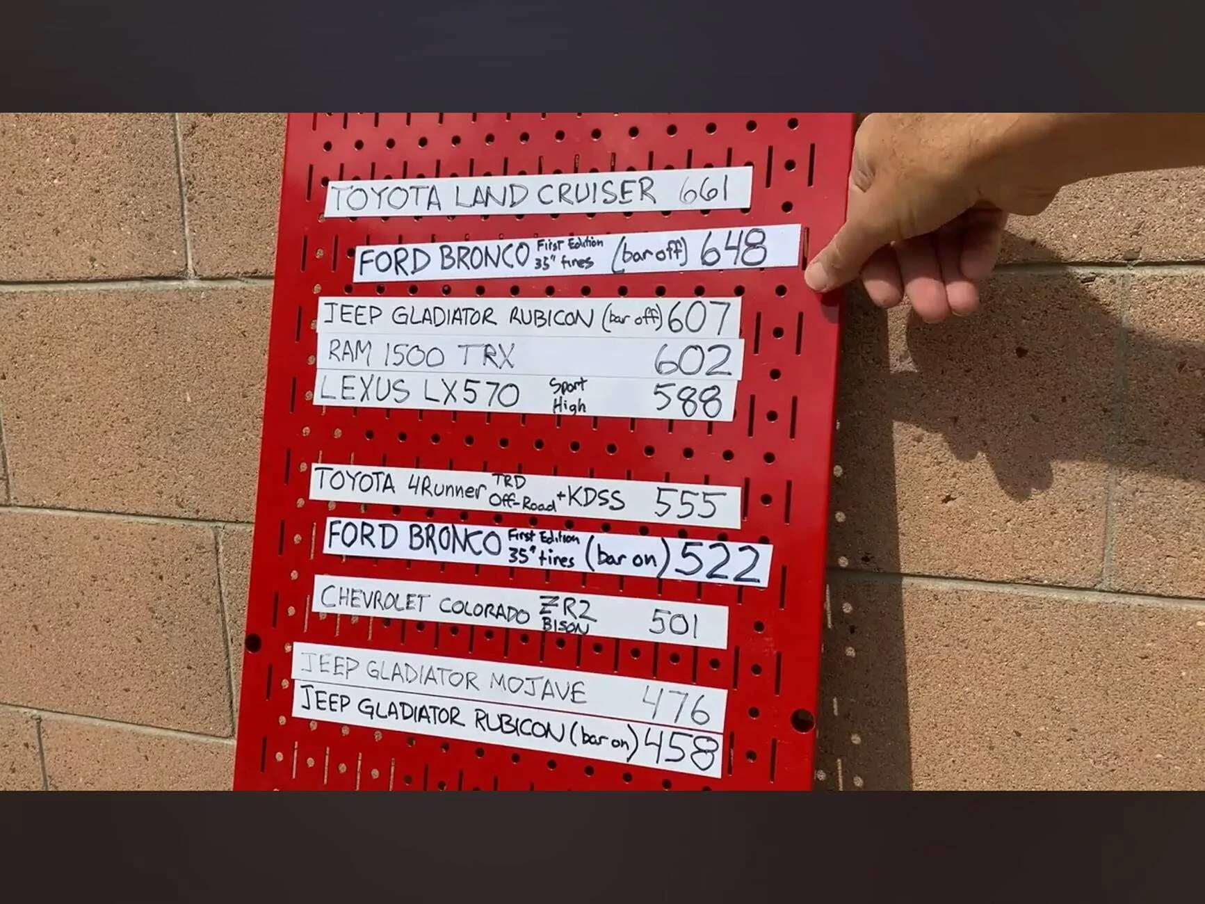

Isn’t the non Sasquatch about 2” less ground clearance than the Sasquatch version? The stock non Sasquatch tires are meh. At least the ones on the 2Dr Big Bend I owned before the Heritage.
Articulation is pretty good for IFS with the sway bar disconnected.

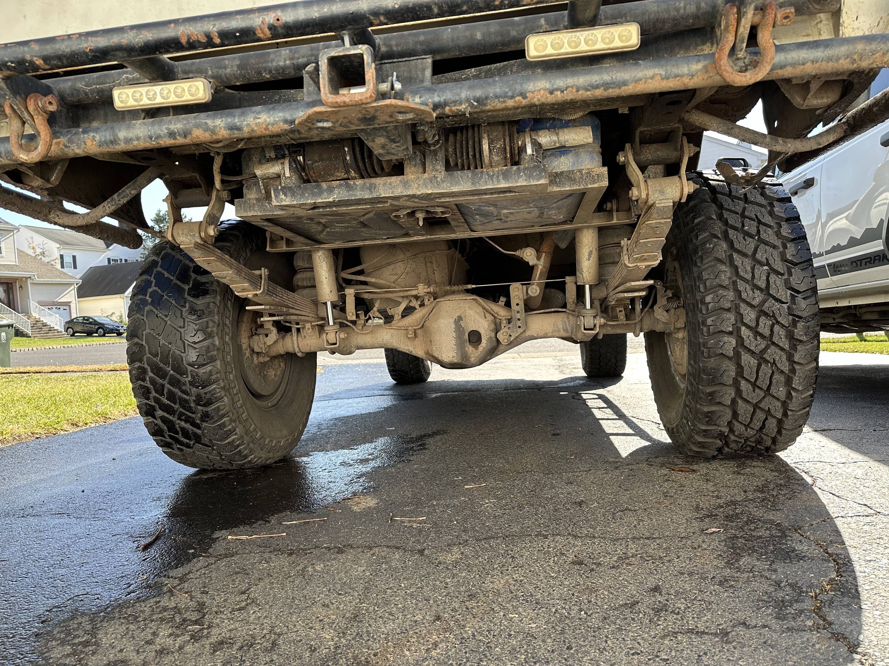

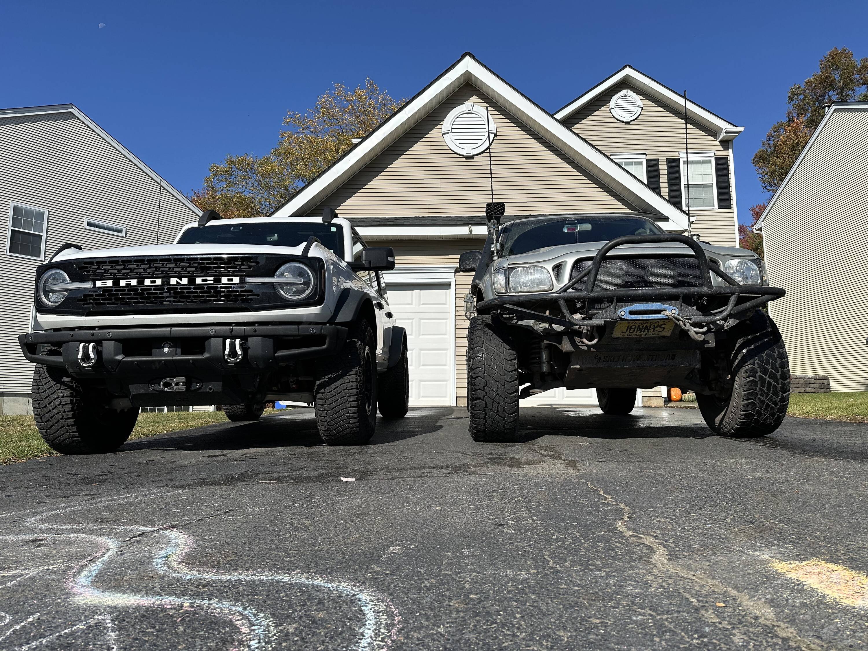

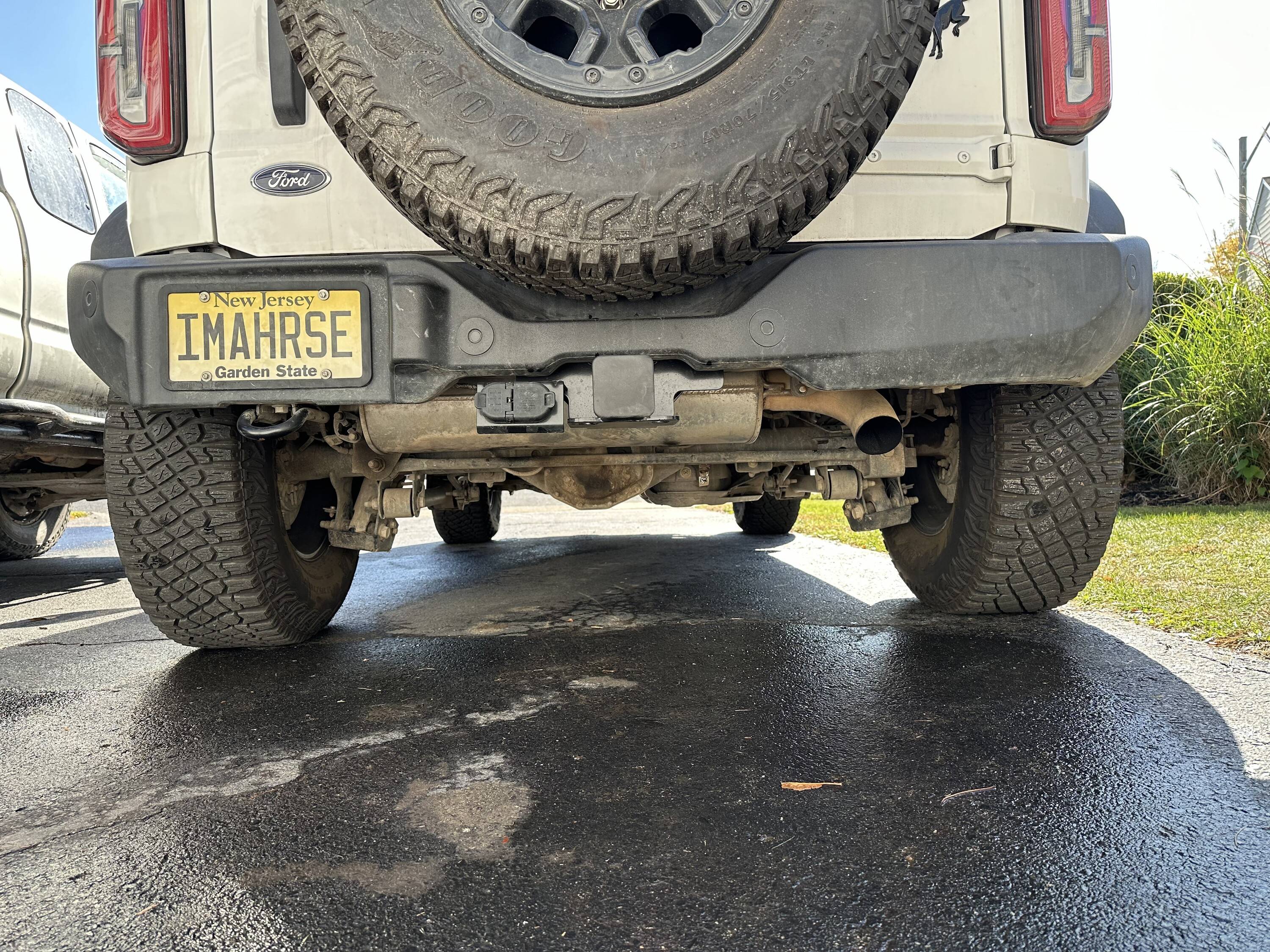

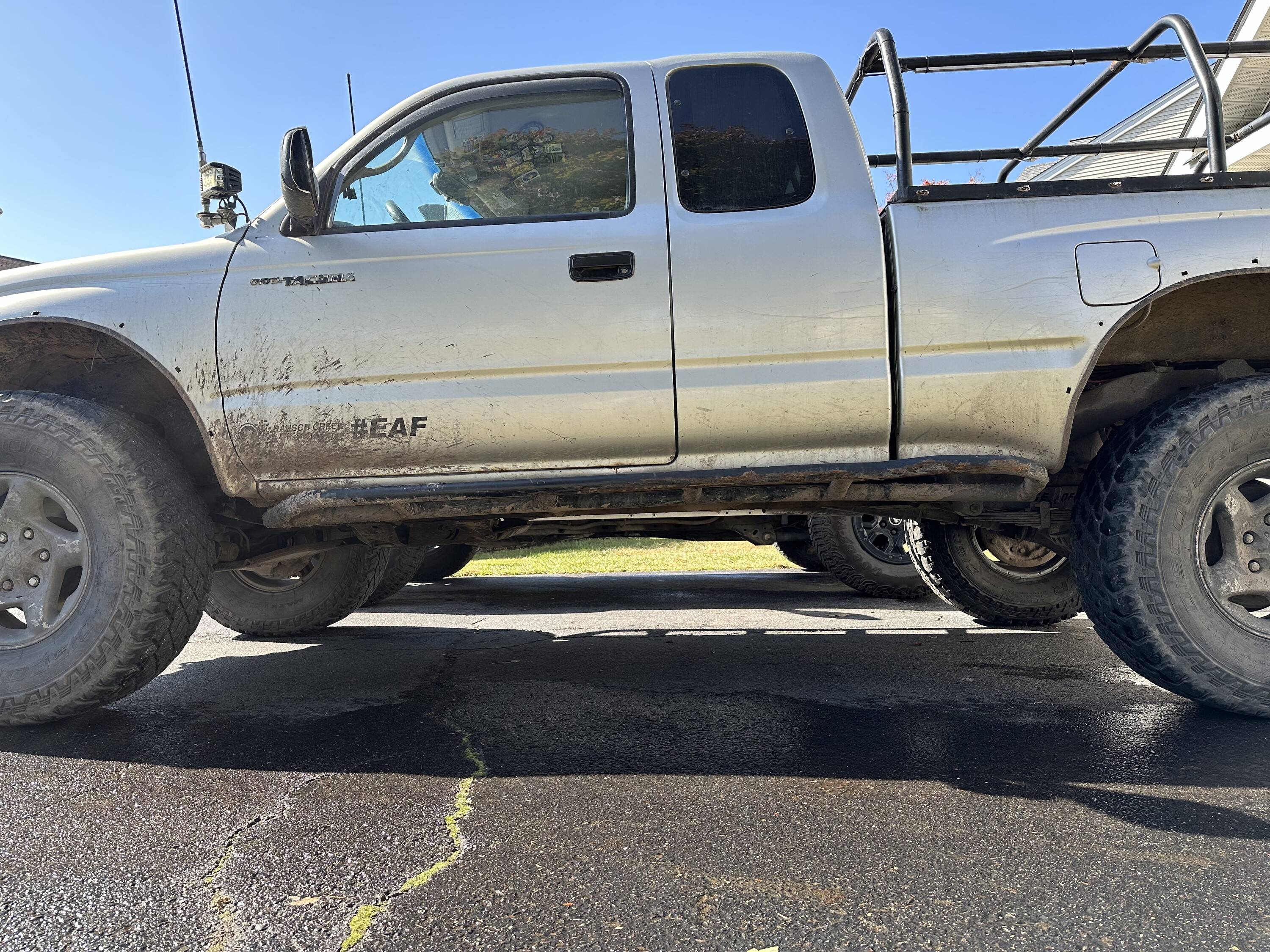

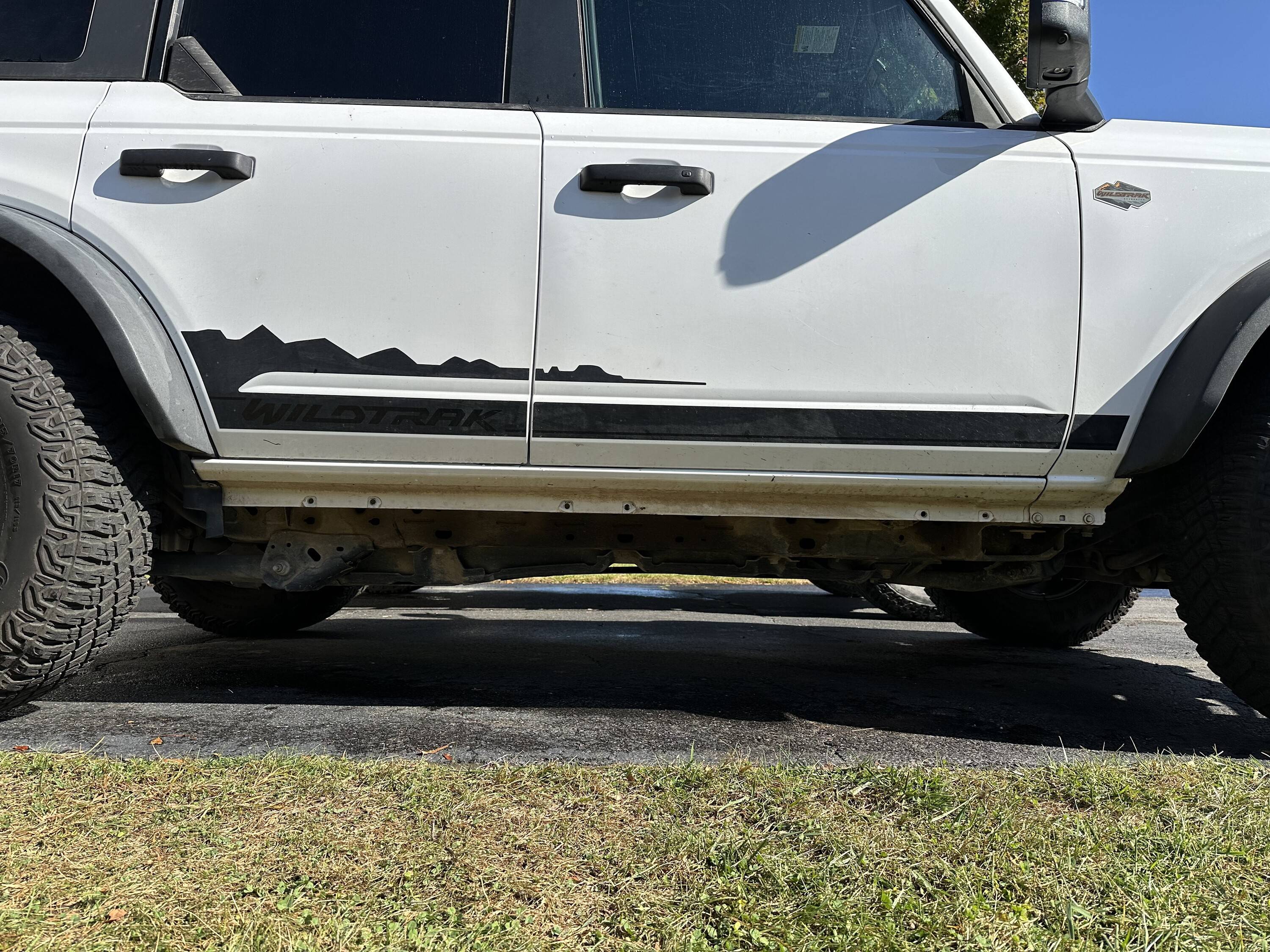

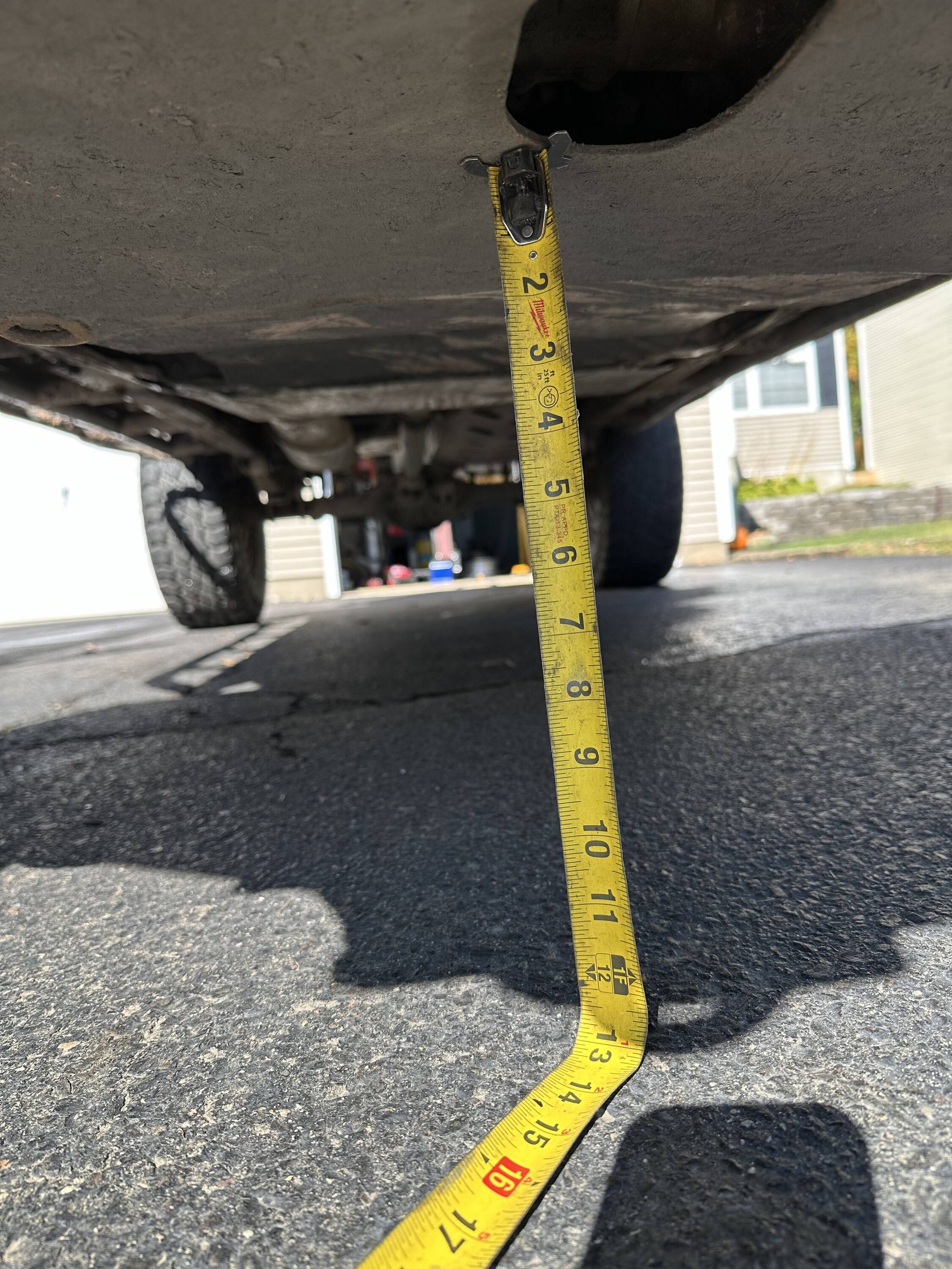

I think the first thing I noticed between my IFS first gen Tacoma that I put on 35's and the Bronco is the decreased ground clearance. Especially the link mounts and the crossmember in the center of the bronco. The IFS skid in the center hangs down quite a bit lower too.
I started typing this post with memory of what hangs lower but I figured it would be easier to have a quantifiable comparison since I can easily go outside and measure both for comparison.
My Tacoma is what I call my "IFS Crawler" and is sitting on roughly 1-2" of lift via ADS shocks, Dakars with AAL, and 315/75r16 Cooper ST Maxx tires. Clearance wise nothing additional has been done besides raising the gas tank above the frame which clearly helps from a side profile but it's definitely not the only reason the Tacoma clears things much better.
The Bronco is a mostly stock Wildtrak (So SAS package with more lift with the Fox shocks) with the only addition of shock skids and the hidden winch up front. Regardless of the hidden winch, the stock IFS skid that covers the front diff is lower.

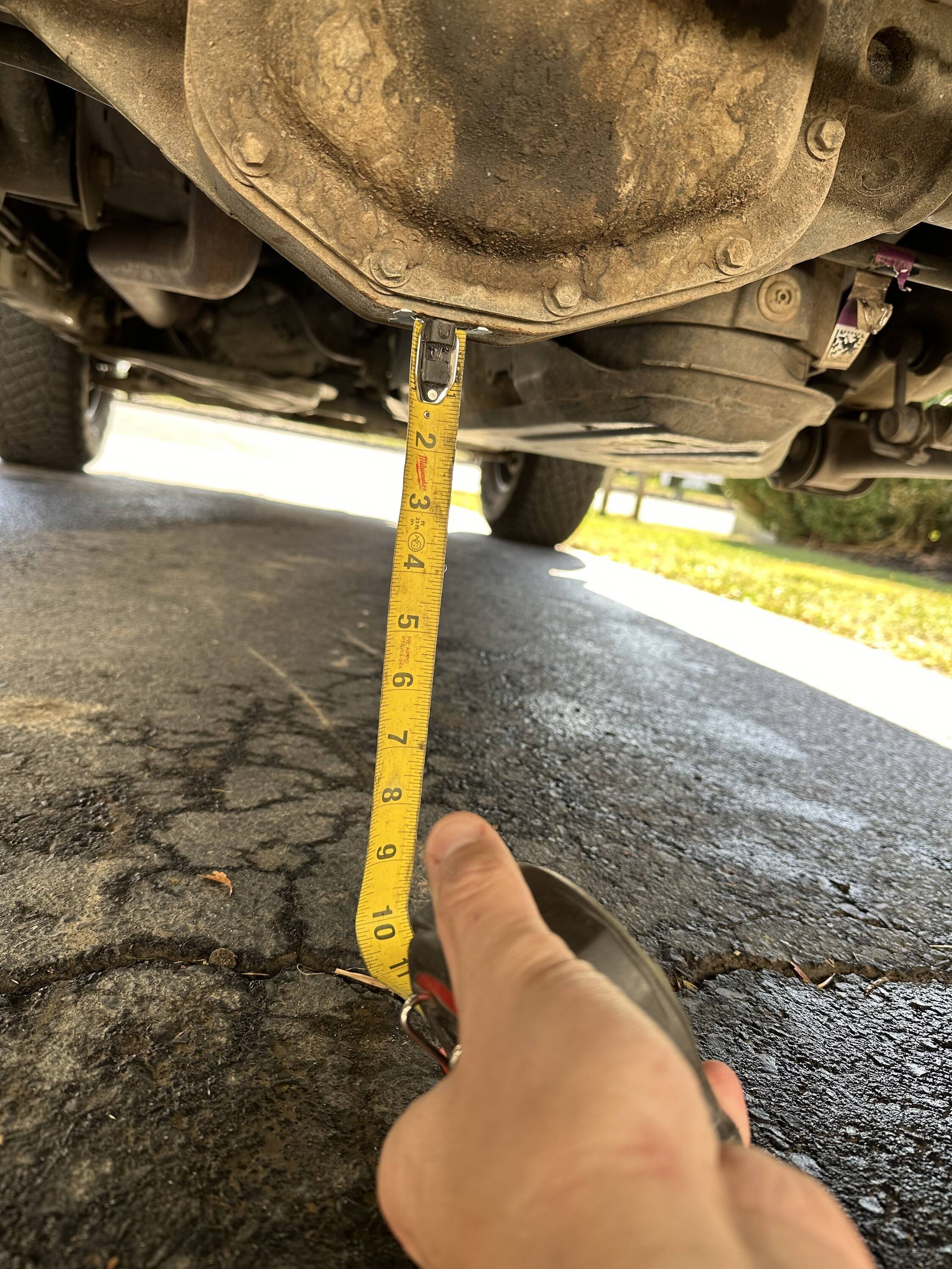

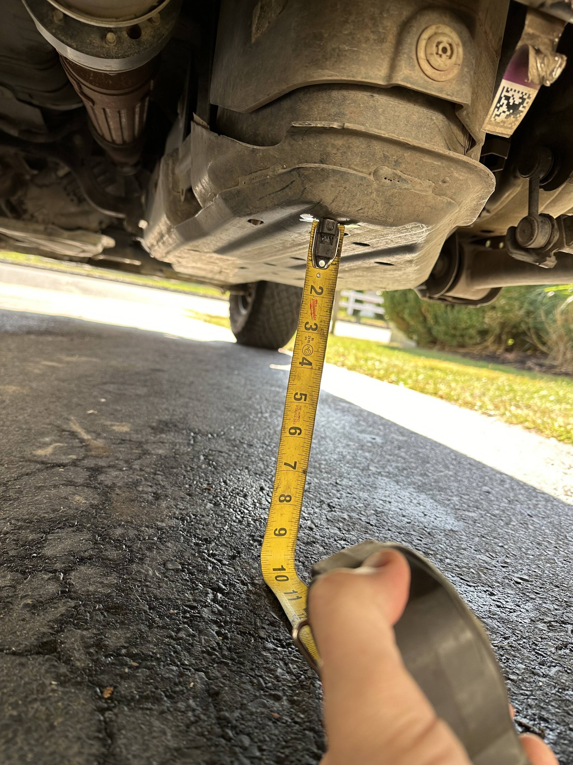

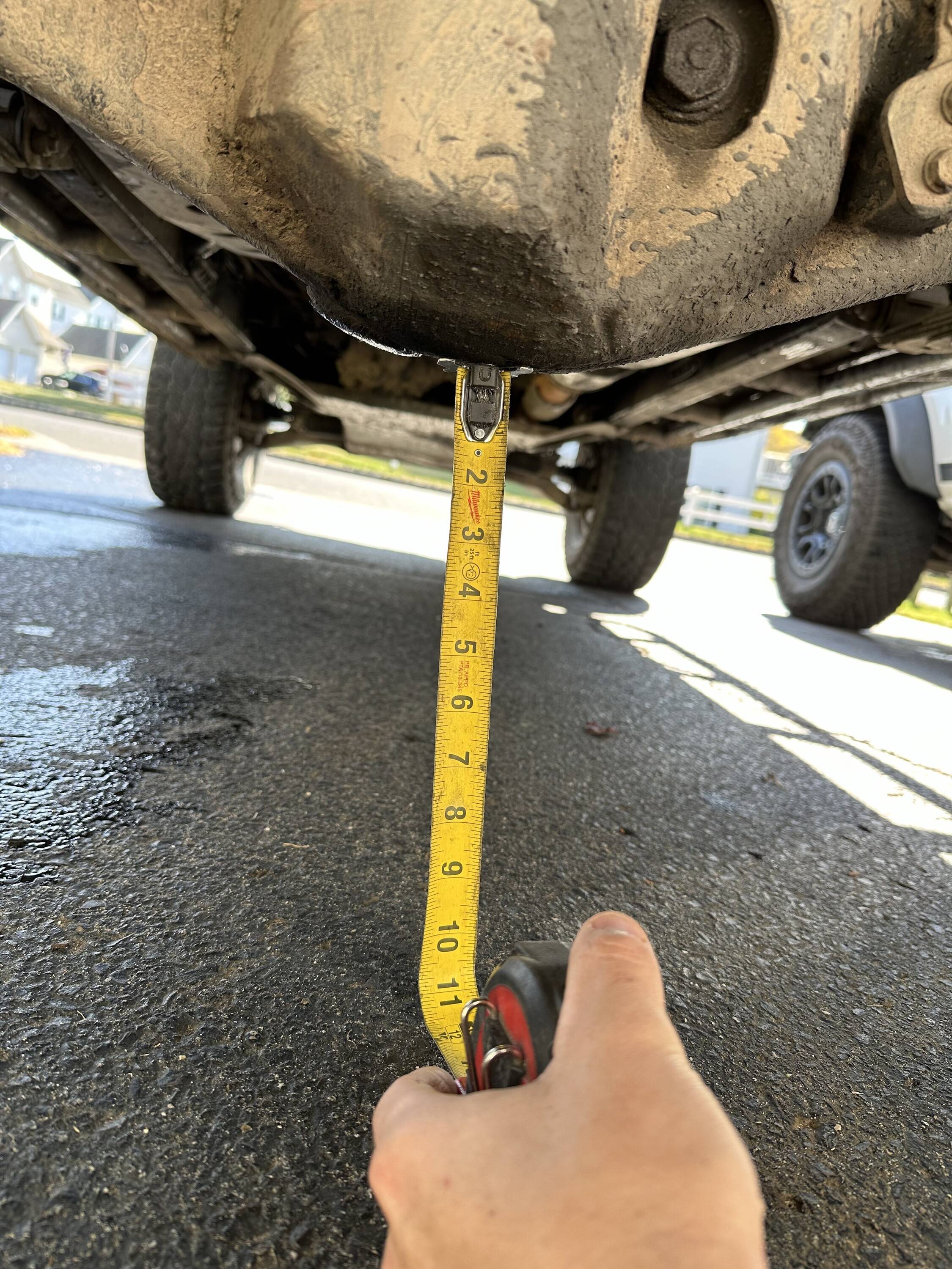

Rear diff measurement
Tacoma:
Ford Bronco Underwhelming Offroad experience 54088473734_6b3e53e44a_4k
Untitled by MJH Creations, on Flickr
Bronco:
Ford Bronco Underwhelming Offroad experience 54088145846_5f393ae071_4k

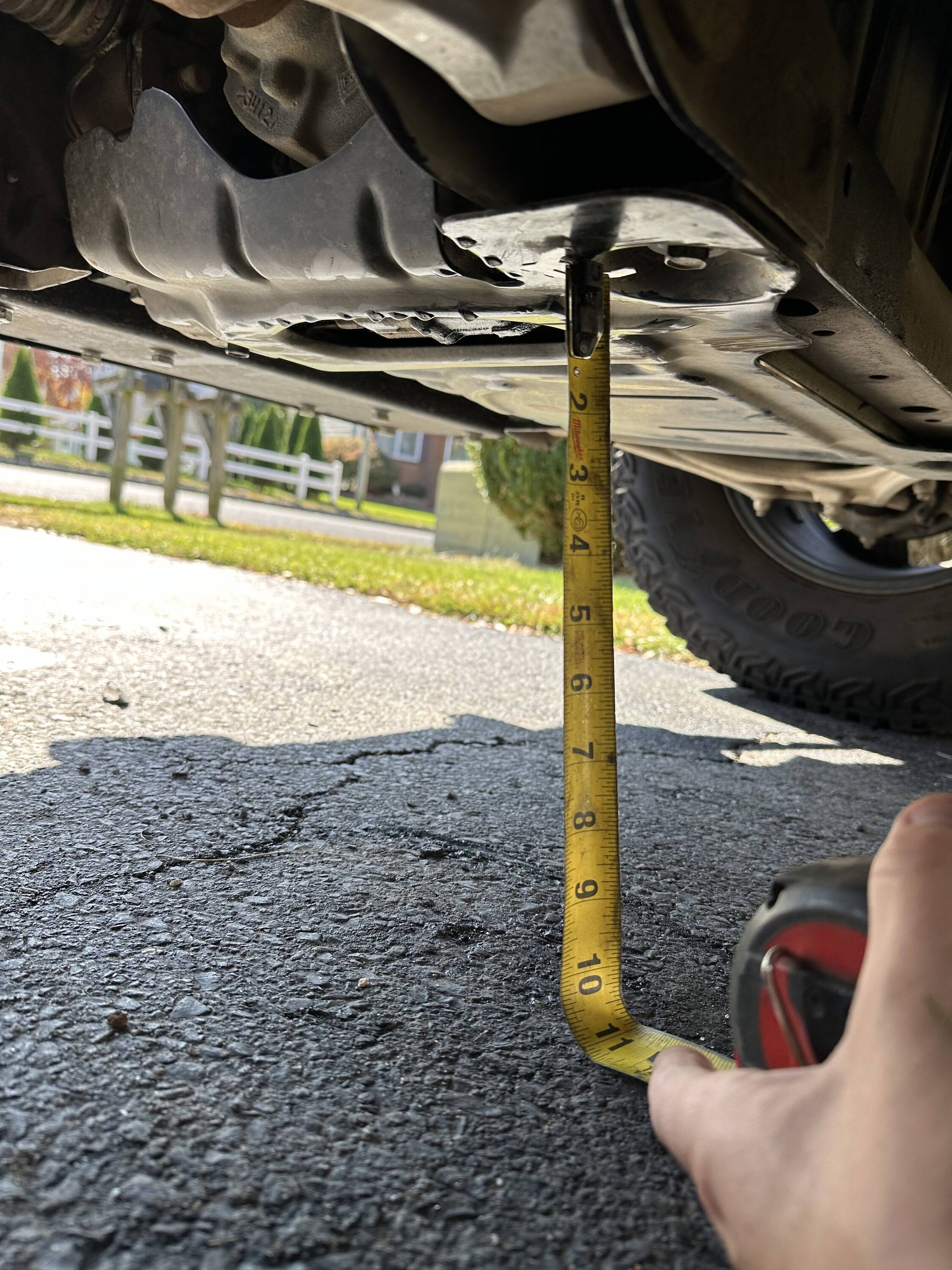

IFS skid measurement
Tacoma:
Ford Bronco Underwhelming Offroad experience 54088394818_8464af3f22_4k
Bronco:
Ford Bronco Underwhelming Offroad experience 54087266372_87f9dc9e71_4k

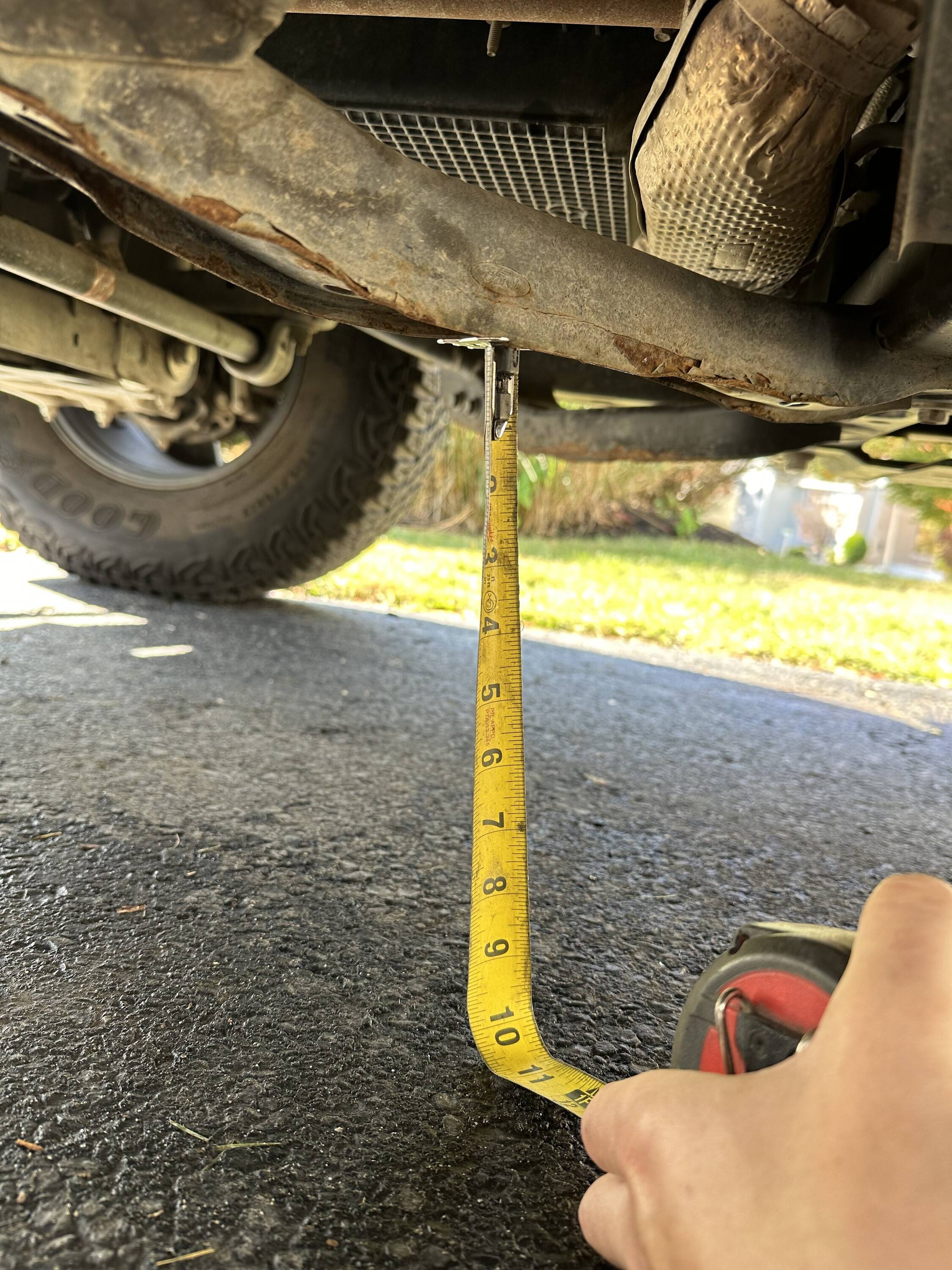

Other misc low points that the Bronco as that the Tacoma either doesn't have or clearly is better at
Gas tank:
Ford Bronco Underwhelming Offroad experience 54088395718_c882a197f3_4k
Center X brace:
Ford Bronco Underwhelming Offroad experience 54088600490_a677dcfb6d_4k

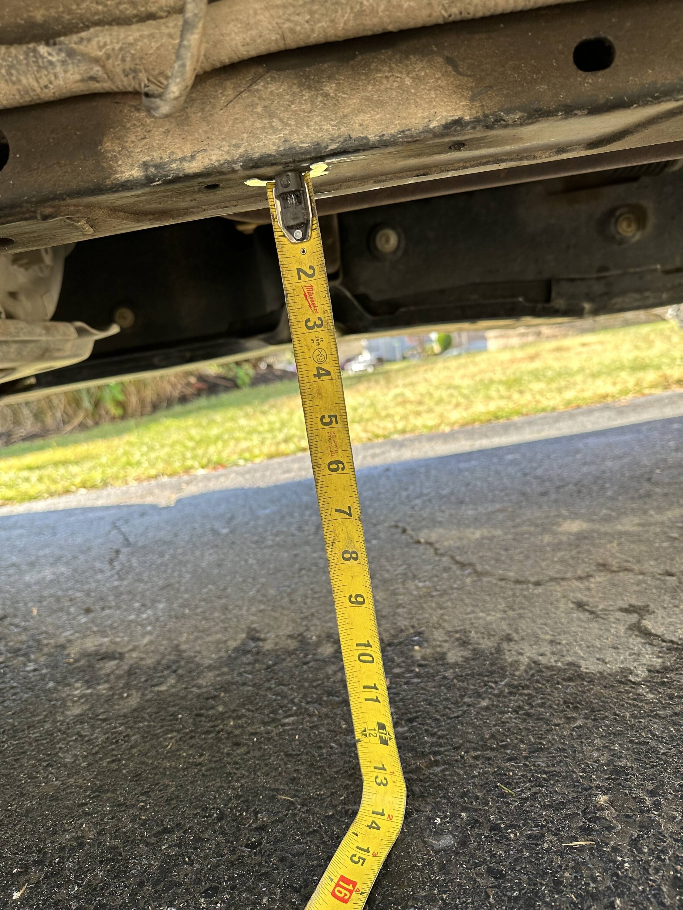

And finally frame height comparisons
Tacoma:
Ford Bronco Underwhelming Offroad experience 54088394838_4ee55d3cee_4k
Bronco:
Ford Bronco Underwhelming Offroad experience 54088601370_fdf29f5a16_4k
So the overall takeaway I observed is the Bronco has MUCH more things hanging down at roughly 9-11" off the ground while the Tacoma only really has the front IFS skid and the rear diff (with better numbers) Of course there are other things to take into account like breakover, wheelbase, etc. The nearly 6" frame height difference is wild to see too.
BUT the Bronco is basically stock from the factory and my Tacoma has been heavily modified over the years to even fit 35's (tubbing the firewall is so much fun :curse:), add lockers, regear etc.
So while clearance wise it can definitely be underwhelming it also lets me get almost double the range due to fuel efficiency and larger tank, is much more comfortable on long drives (creature comforts, drivability wise the Tacoma is absolutely great on the highway), and can actually fit the whole family.

The Badlands Non-Sasquatch is minimally lower than a Sasquatch, but higher than other trim levels. Also the tires I have mounted are the same size as the Sasquatch models got.
But I do agree, the suspension travel up front is pretty good for an IFS vehicle. If I recall the numbers correctly the Ranger Raptor has a bit more travel, probably due to the wider track it has.

Looking at your pictures... didn't you move your axles on the Tacoma to go on-top the leaf-springs as opposed to under? Wouldn't under be the default for a Tacoma?

I did the comparison mostly because I got the Bronco in a configuration that was as close to my modified Tacoma as possible. (35's, lockers, mild lift) which is why I figured they would be a good comparison. The wildtrak is lifted (mildly) and on 35's from the factory. Even still you can see because of component placement there are far more things that hang lower on the Bronco vs the Tacoma even in stock form.
As far as leaf springs go, only the 5 Lugs are SUA stock, 6 lugs like mine are SOA. In those photos the axle is under the leaf spring like stock, only difference is stock came with mounting plates while mine has a u bolt flip for more clearance. Regardless I wasn't even taking the Bronco's low hanging shock mounts into comparison since they are so tight to the tires.
