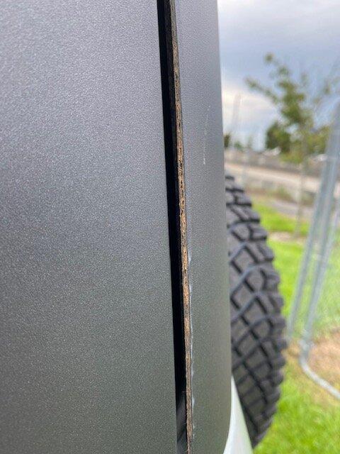

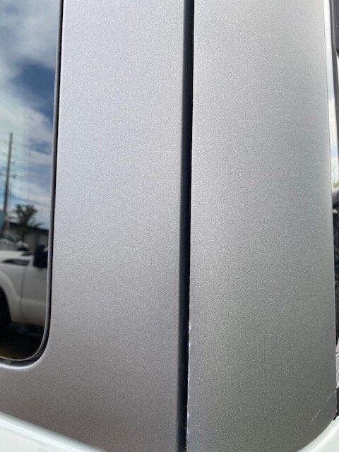

After reading this thread, I went back to our local Ford dealership to checkout the First Edition that just arrived for a retail customer. MIC top looked fine (no honeycomb). Edges don't look to good though. See first pic.

You're kidding by saying it looked "fine", right? That entire edge is delaminated.
I was referring to the honeycomb issue. I mentioned the delamination is bad. Yeah it sucks.
