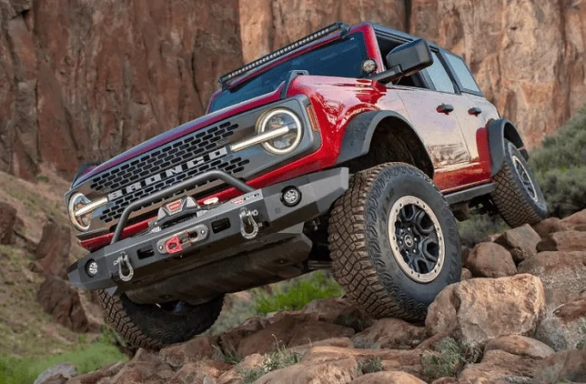

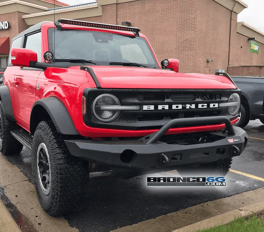

I'm strongly considering getting the Warn Elite front bumper for my bronco, but I'm concerned about the intercooler:

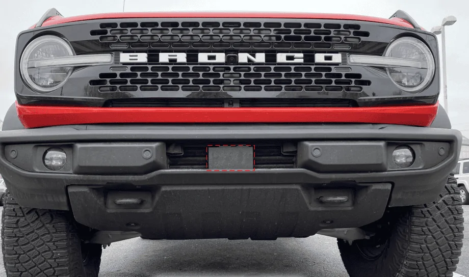

The question I have has to do with the winch position. It's lower than the 4WD and Steel Mod Bumper winch positions, and puts the thing right in front of the intercooler (red square is a sensor, behind that is the IC)
Ford Bronco Warn Front Bumper, Could there be Intercooler Problems? 1626986659744

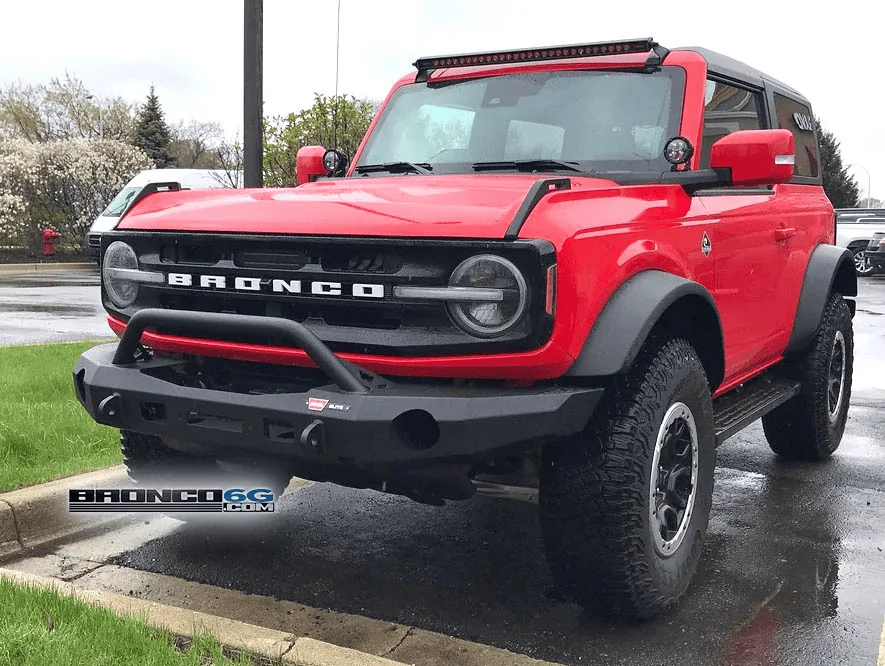

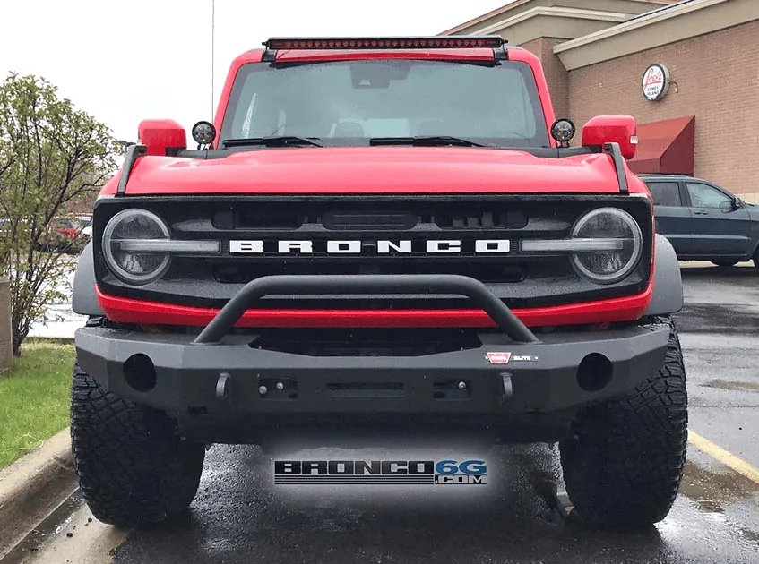

It does look like there might be some holes on the warn bumper below the winch to help airflow:
but given that the intercooler is already "cheap garbage" with "bad flow" according to the engineer in this thread (https://thebronconation.com/forums/threads/make-sure-to-upgrade-the-intercooler-first.4376/), the added air resistance of the winch seems like it could cause even more trouble. Don't get me wrong, even if the intercooler is fairly cheap, I'm sure it will get the job done in stock configuration (it's not a race car after all), I just worry that further restrictions like this bumper might cause trouble, especially since I'm in a hot climate.
Does anyone have insight into how much of an issue this might be? I'm not against doing an intercooler relocation; however, at that point I feel like I might as well get a more recessed bumper with a hidden winch if that space is opened up.

Yeah, the mod bumper is great aside from the stock winch solution. Hopefully someone figures out a way to improve that.
Personally I ordered the plastic front bumper with the base with the plan of getting something aftermarket. All I want is something steel with a reasonable winch mounting solution, but it seems like the intercooler location makes that pretty tough to pull off. I'd love something like this DV8 render, but I suspect things like this would require IC relocation. Fortunately (or unfortunately depending on your perspective), I don't have to worry about too many sensors up front since I have the standard pack.

You "might" be able to move the intercooler when you upgrade it...I'm just not sure about relocating the ACC. We may have to make a compromise. Trail cam or ACC.

the world is full of trade offs. you need to figure out what is the most valuable. the intercooler's efficiency probably will not be effected, since ram effect does not seem tom be part of how the engineers planned the intercooler. if it were, there would be ducts. there is probably plenty enough air being pulled by the cooling fans behind the radiator to provide for intercooler function. a slightly warmer intake charge will only result in a miniscule change in maximum power.

Yes, but have you seen a picture of a real one? Because the picture from Warn is a rendering.
The good news is that without the bull bar the camera might work, although there's no confirmation from anyone yet.
Unfortunately no. Was totally surprised to see it in stock without ever having seen an actual pic of it. But there are instructions!

The openings on the bottom of the warn bumper from the attached picture have more area than the stock bumper for airflow to the intercooler.
That's interesting insight regarding the ducts. If the ram effect isn't part of the design, I'd feel a lot more comfortable getting this bumper since it does seem that the downward-facing cutouts would provide plenty of air.
