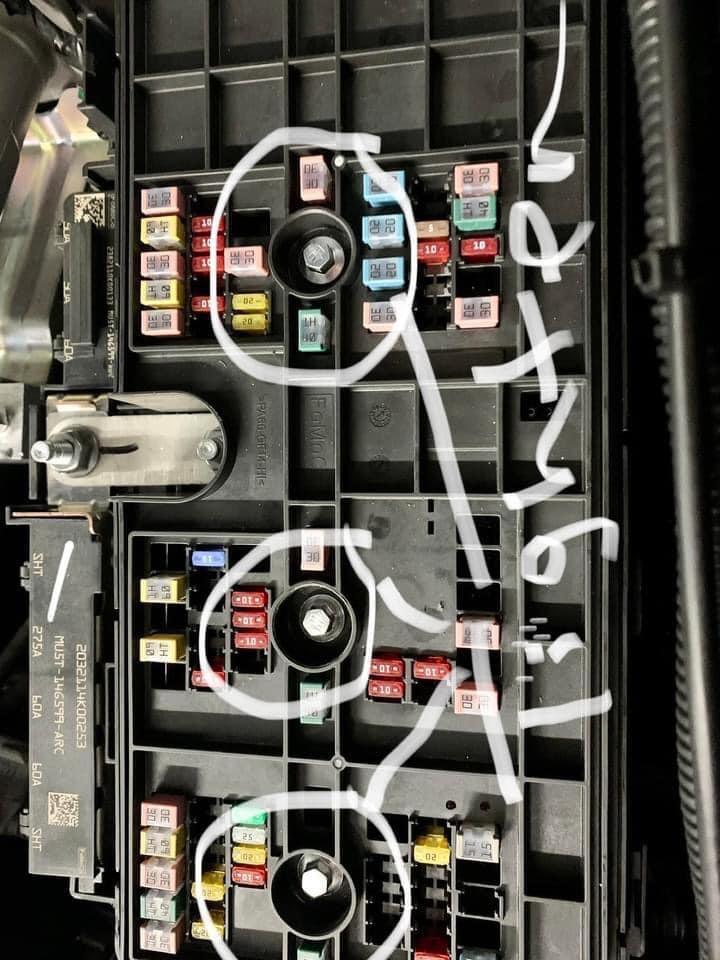

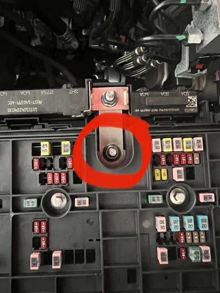

I would start with checking the battery terminals are on good and tight, all fuses are pushed in completely, and the fuse block bolts are tight. All of these are known issues that can cause electrical gremlins like your seeing.
