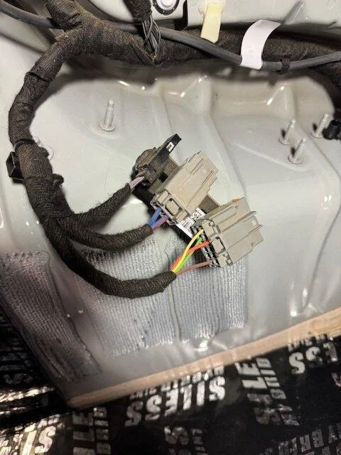

Had the rear drivers plastic panel over the wheel well opened up for sound deadening install and found these wire harnesses in there. Anyone know what they are for?

Tow module will bolt there and those three get plugged into it.
TY! Makes sense. Was the only option (tow pkg) that I didn't get.

That's where the ADV top gets plugged in. You'll notice it's empty.

Wait the truck is pre-wired for the tow module? My hitch came with a harness that goes back to the battery and needs to be spliced into the tail lights.

It's the tow module for the 7-pin

Couple of things, having just adding the hitch myself this past Sunday and adding sound deadening and sound proofing material in the cargo area....
1. Watch the 151 garage peeps take apart theirs, good tips: taking apart your Bronco
2. Only 2024s are prewired to almost plug and play the tow module (you still have to tell the computer)
3. Earlier Broncos, I believe you have to run the wires, not just connect plugs.
