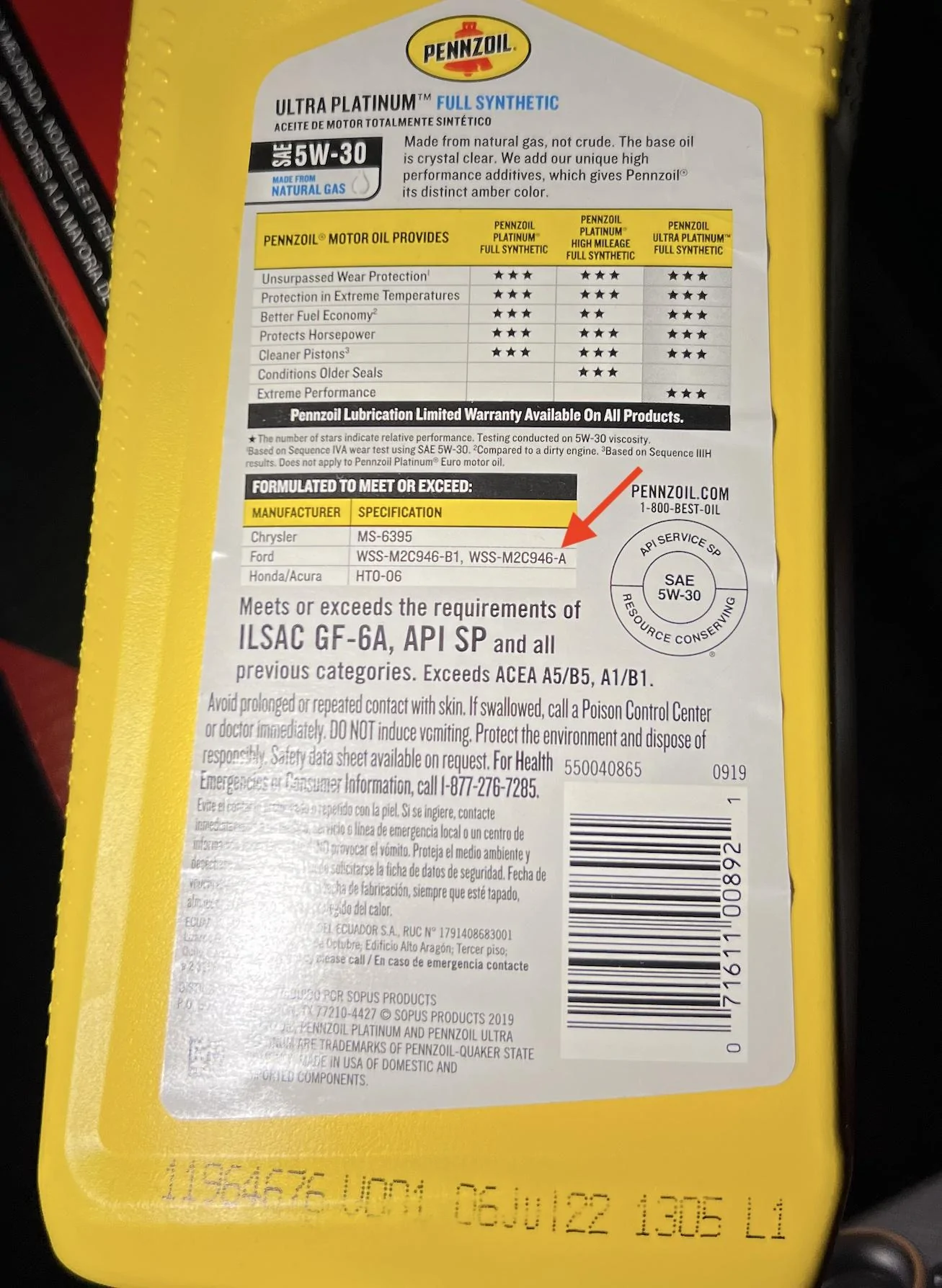

I swear the Ultra Platinum didn't meet the specs but the regular platinum did....but maybe that was for my jeep.
Edit... Yup, unless they changed it since I made my notes...
PENNZOIL WARNING:
Ultra Platinum meets Jeep but NOT Ford
Std Platinum meets BOTH MS-6395 + WSS-M2C961-A

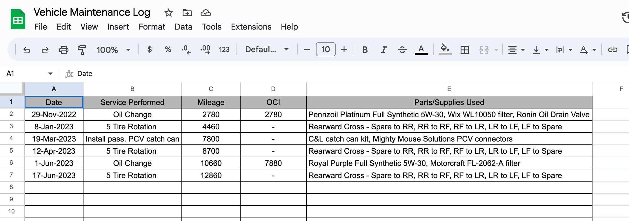

When are you guys doing your 1st oil change...and then following oil changes? Also recommendations on tire rotation?
jacknifetoaswan
JR
Sep 2, 2021
375
590
Charleston, SC
2016 Mustang GT/PP
I did my first oil change at about 2,800 miles, then second after about 8,000 miles. The recommendation from Blackstone Labs was to go 8,000 for the next change, then see what the TBN looks like and possibly go 10,000 miles. As for tire rotations, I go 4-5,000 miles between and do a five tire rotation.
PENNZOIL WARNING:
It does meet the specification.
What likely happened is you did your research before Pennzoil had a chance to test their oils and/or update their labels & website. The WSS-M2C961-A1 specification was released in 2020, so if the oil (or the label) was manufactured before 2020, obviously there is no way they could test the oil against a specification that didn’t yet exist.
Back in winter 2020/2021 I bought a 5qt jug of Mobil 1 Full Synth and an extra 1qt in the side for an oil change on a vehicle that required 6 quarts. Labeled looked exactly the same, only difference is the 5qt jug didn’t list the WSS-M2C961-A specification whereas the 1qt did. Obviously that was extremely confusing and I fell into a black hole of researching oil specifications online. Eventually gave up and asked my father (now retired Ford engineer). He asked a few folks that work on lubricants, and it turns out it was exactly the same oil. Just happened to get a 5qt jug that had the old label.
To be honest, I don’t know if the Pennzoil Ultra Platinum had a formula change or not, I suspect it was a simple label update like the Mobil 1. But I can say that the quart sitting in my basement that I bought last year does meet the spec.
