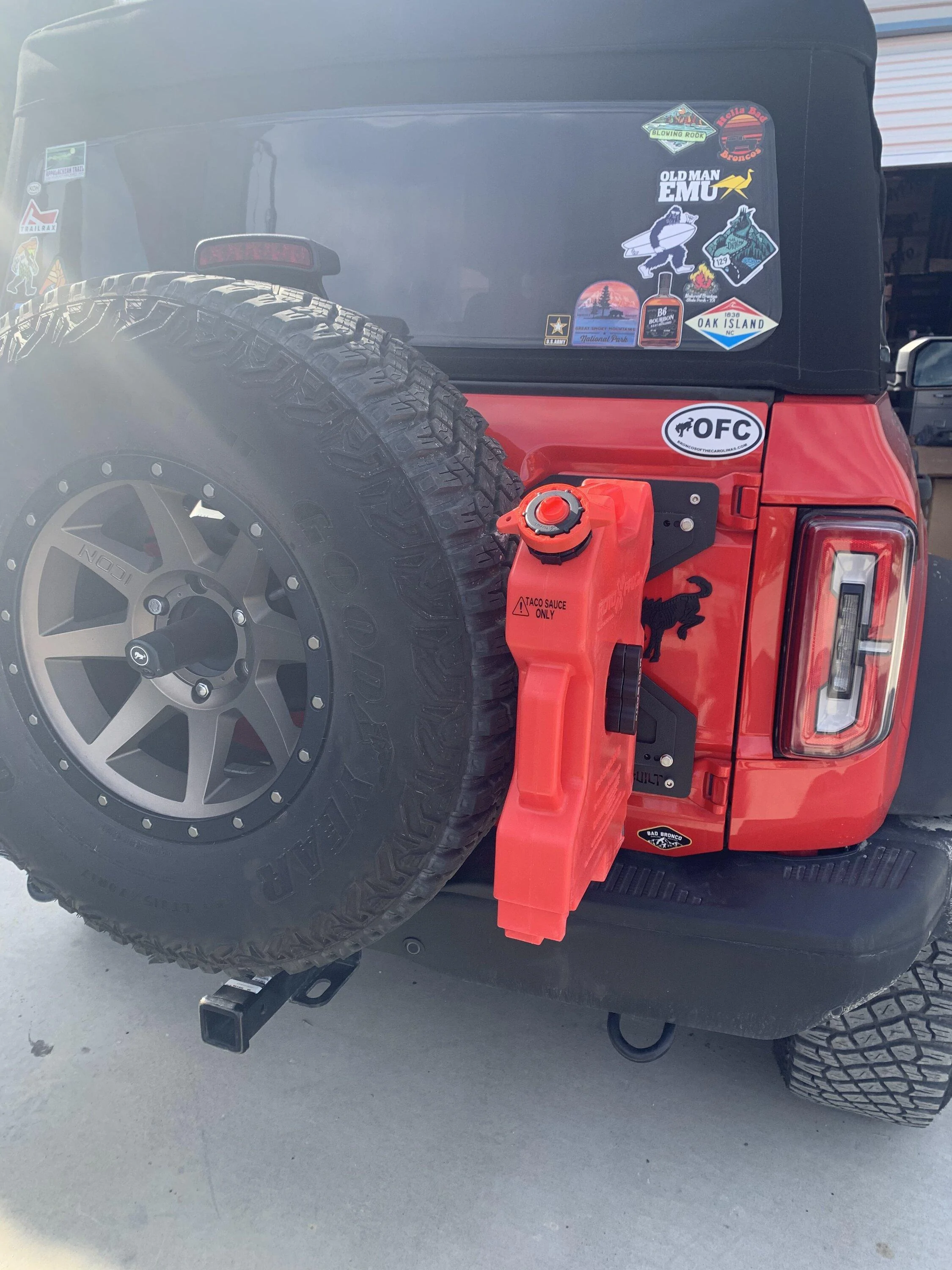

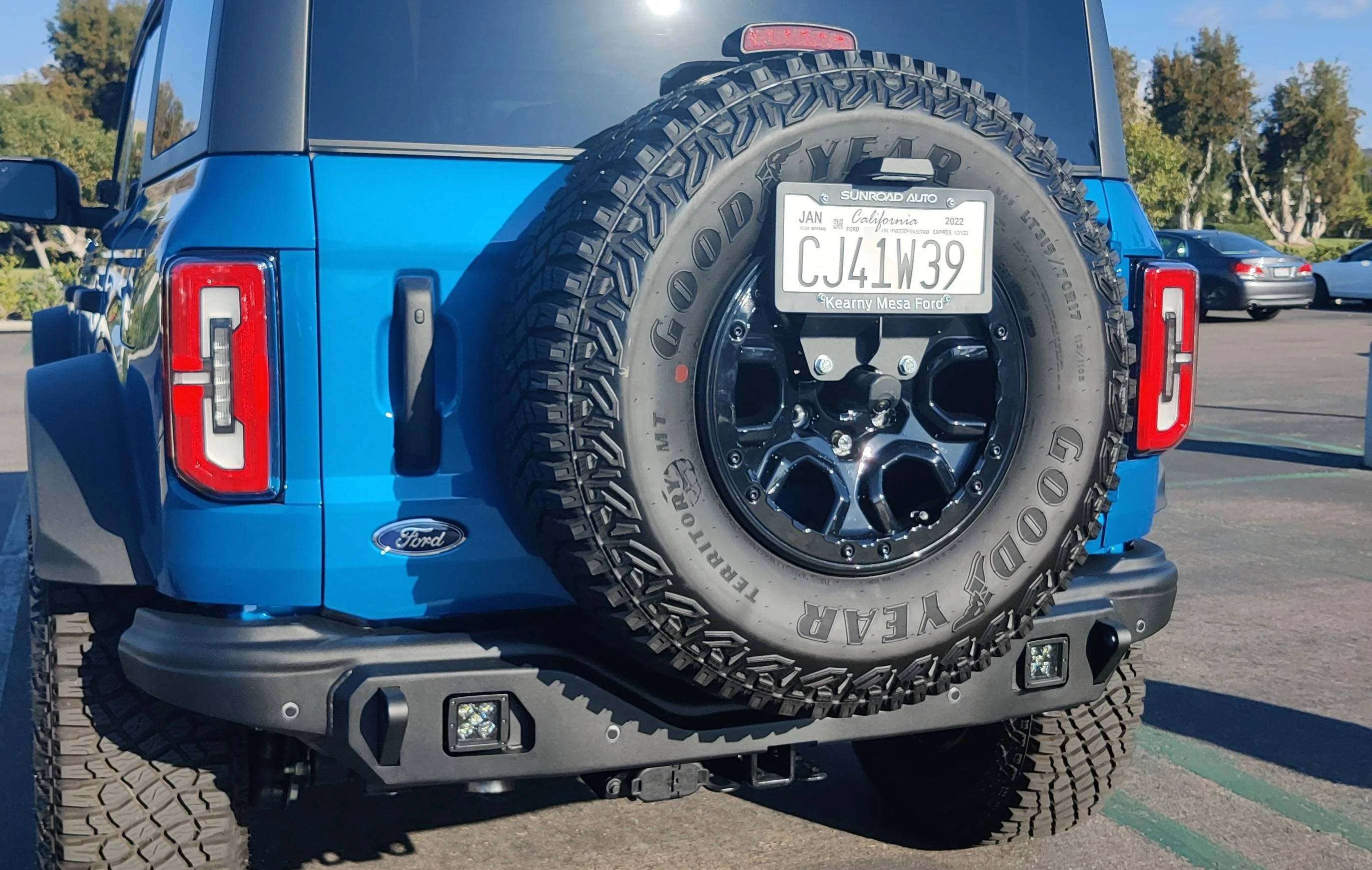

4WP rear bumper came with the relocation kit, all hardware and wiring was included
broadicustomworks
Aug 25, 2020
3,125
11,869
Hanging Rock, North Carolina

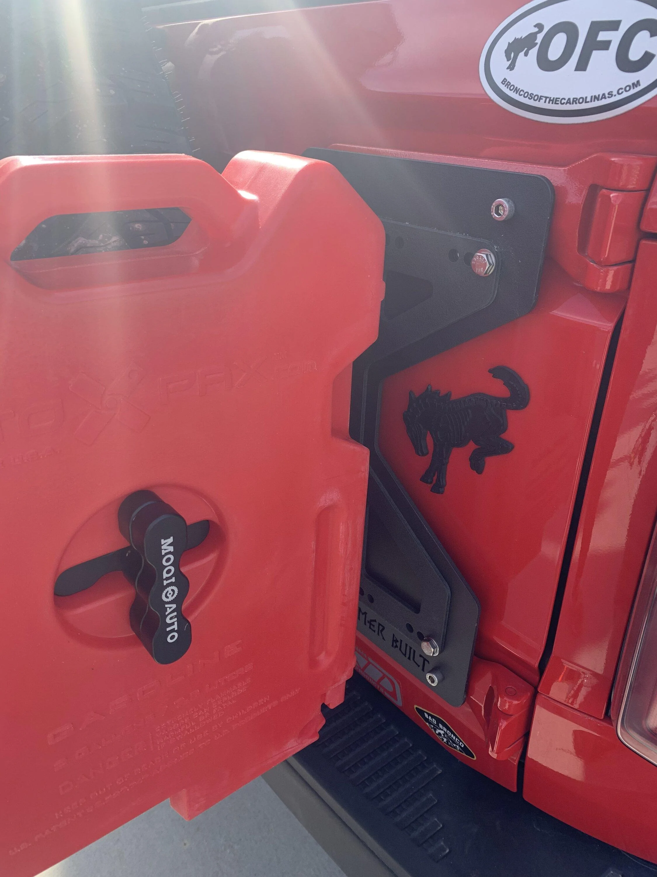

Hammerbuilt for the brace and the accessory arm.
Rotopax and off-brand pax mount off Amazon.
Everything lined up quite well without issue.
The only issue I ran into was the extension to mount two pax together. Also bought off of Amazon and found the thread pitch was not correct, so will be returning it and buying name brand extension.

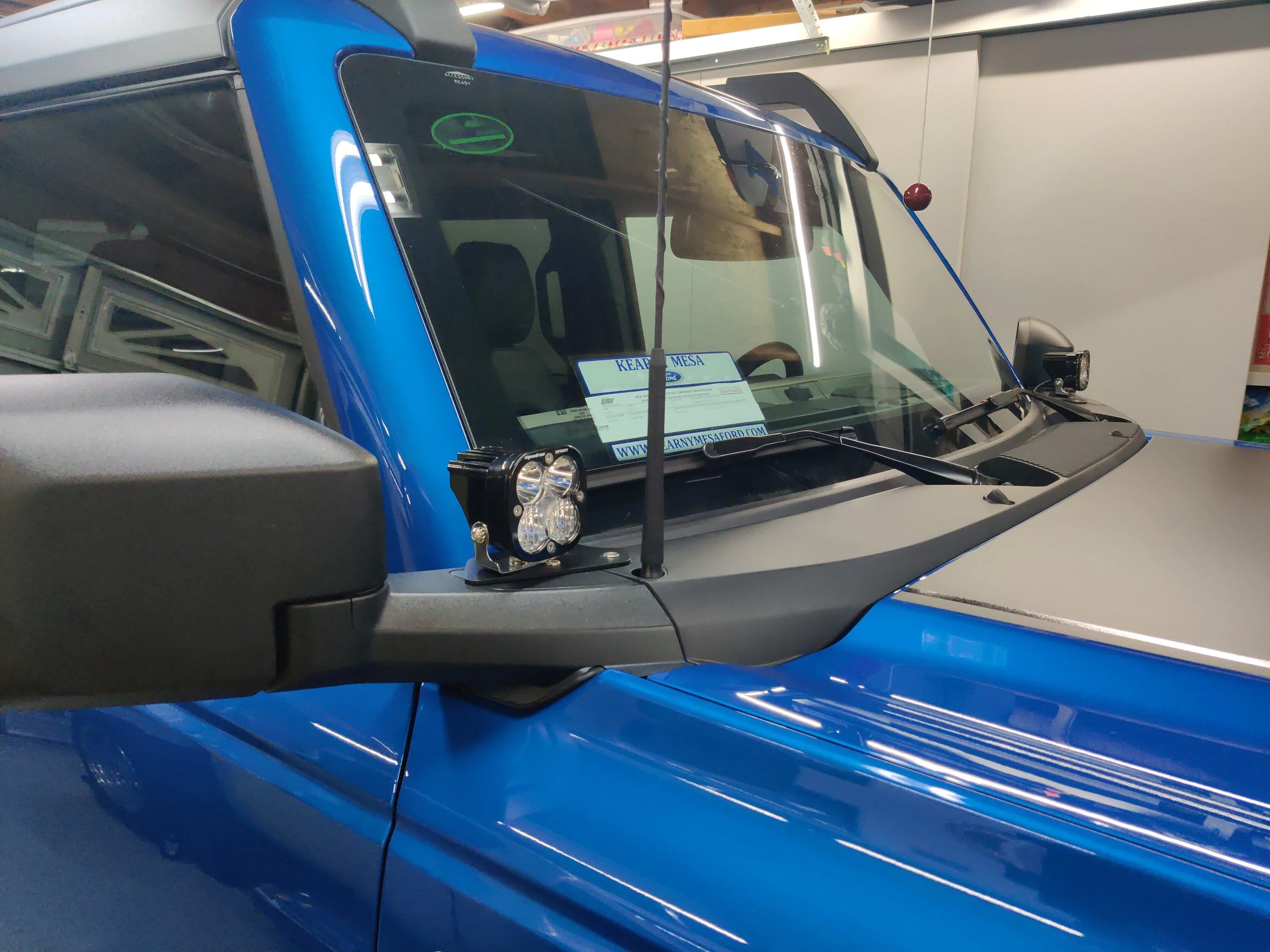

Installed the Trailrax full length roof rack with Heretic light bar on my 4-door today. Adjusted the angle of the light bar after dark and can now light up the night.
The light bar requires all the plastic covers to be pulled off the passenger side pillar and above the passenger door, plus the sun visor. I used upfitter switch 1, making connections above the visor, behind the dash mounted glove box, and next to the fuse box. Make sure the ground is tight using the side airbag attachment bolt.
