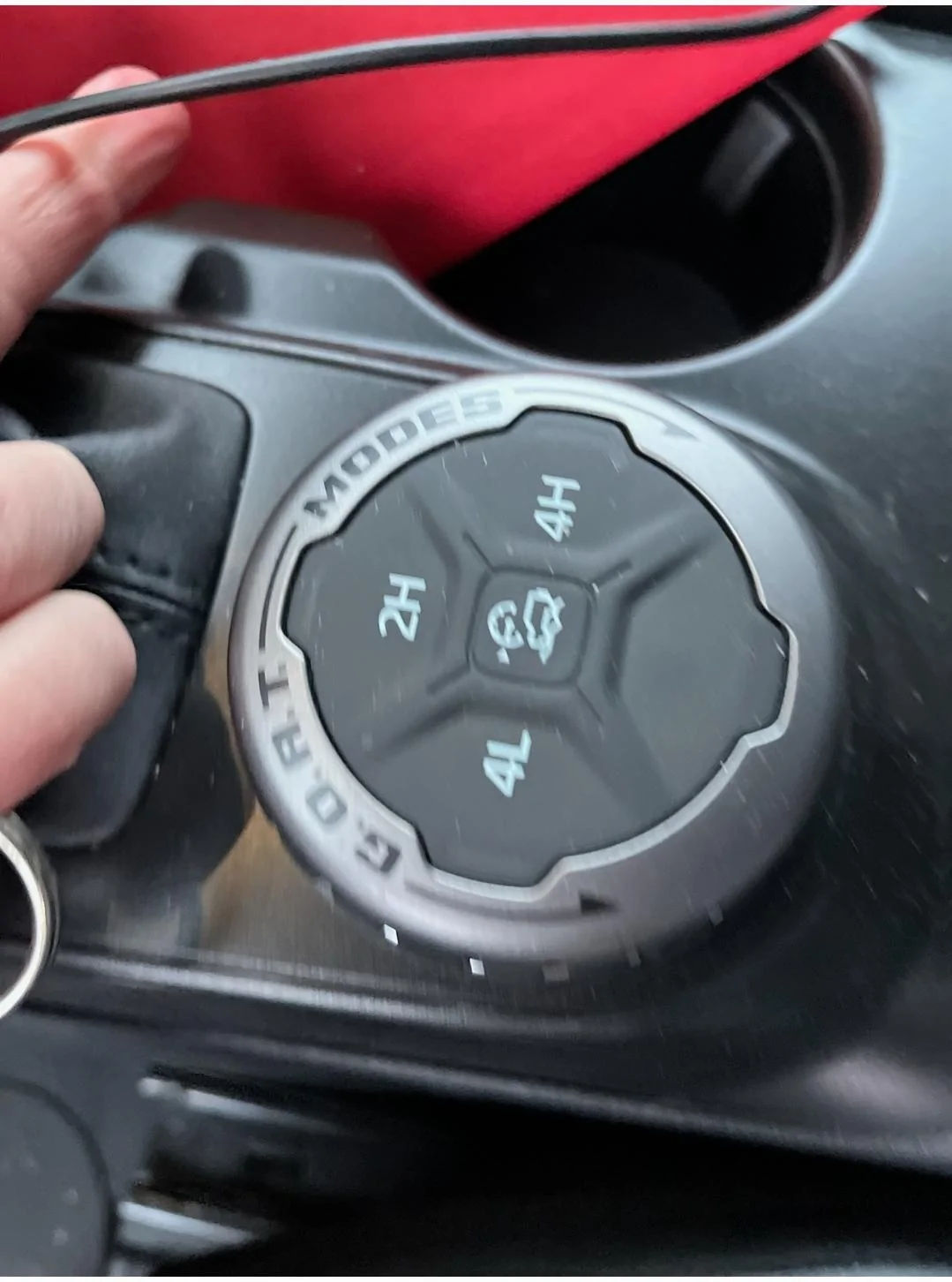

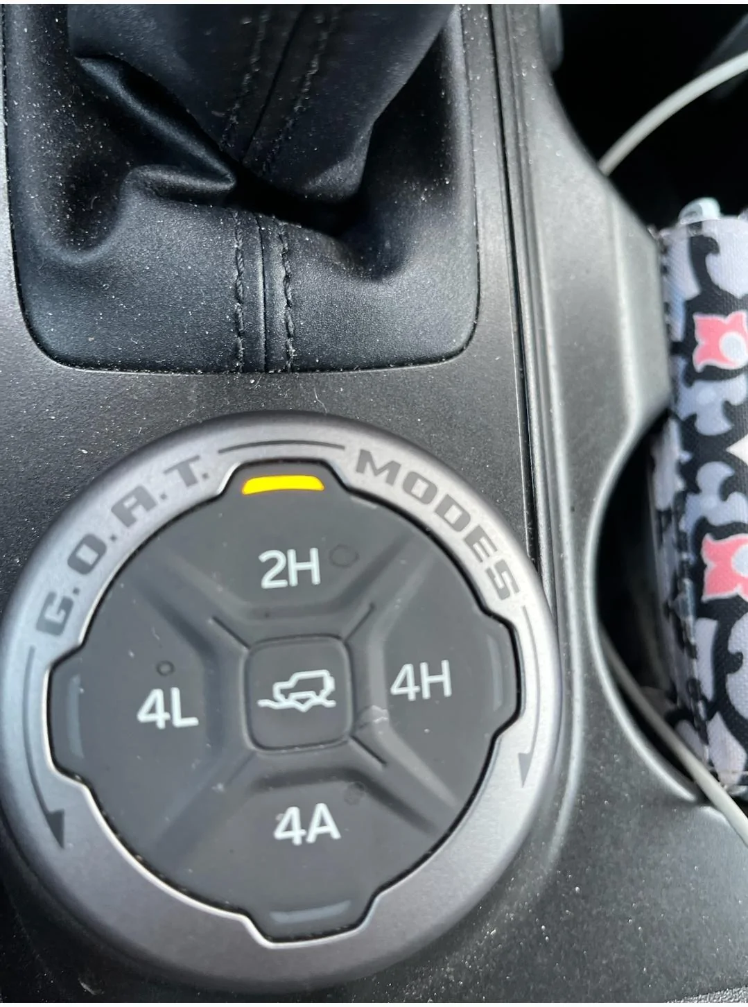

So i have one that's different in the 2 photos if the one is one pedal. How dose the other one work with just the bronco picture?
Dads_bronze_bronco
Feb 18, 2020
4,175
7,458
08 JKUR / x_x 00 TJ x_x
Do you have 7MT / there may be a third.
Anyway One Pedal I think is only on 2.7L 10AT.
Yours most likely is Trail Control if you have a 2.3L 10AT.
A 2.3L 7 MT will have Hill Descent Control in that spot.

So this one is my wife's 2 door Wildtrack 2.7 auto

This one is my Black Diamond non sasquatch 2.3 4 door auto

So you should have both Trail Control and One Pedal on that button.
And this must be the button for just Trail Control.
I understand how one pedal works. How does trail control work?
