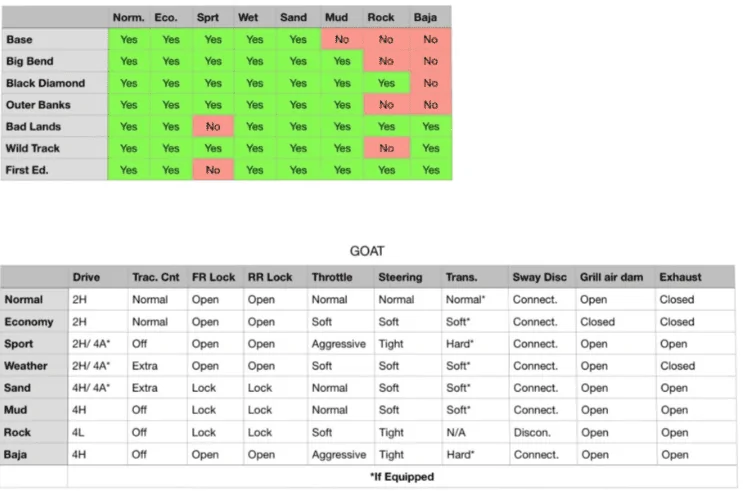

You can unlock all goat modes with Forscan.
Slippery mode is good for this, it dumbs down the throttle and shift points as well as puts vehicle in 4A if equiped (I am not sure if it it goes to 4hi without the full time transfer case).
Pretty sure this chart is accurate but I reserve the right to be wrong.
Ford Bronco GOAT modes - differences between Bronco models? 1665159282408

Ah, very helpful. Thanks!

Thatā€™s exactly what I was thinking about. I think Iā€™d like to have that right off the bat. I canā€™t imagine ever using baja, so that makes me think outer banks would be fine, or even black diamond.
Dont some GOAT Modes require a Rear Locker, &/or Front Locker?
For Example: If you have a Base Non-SAS, and no Lockers - WHat happens to the GOAT Modes that require / use a locker?
